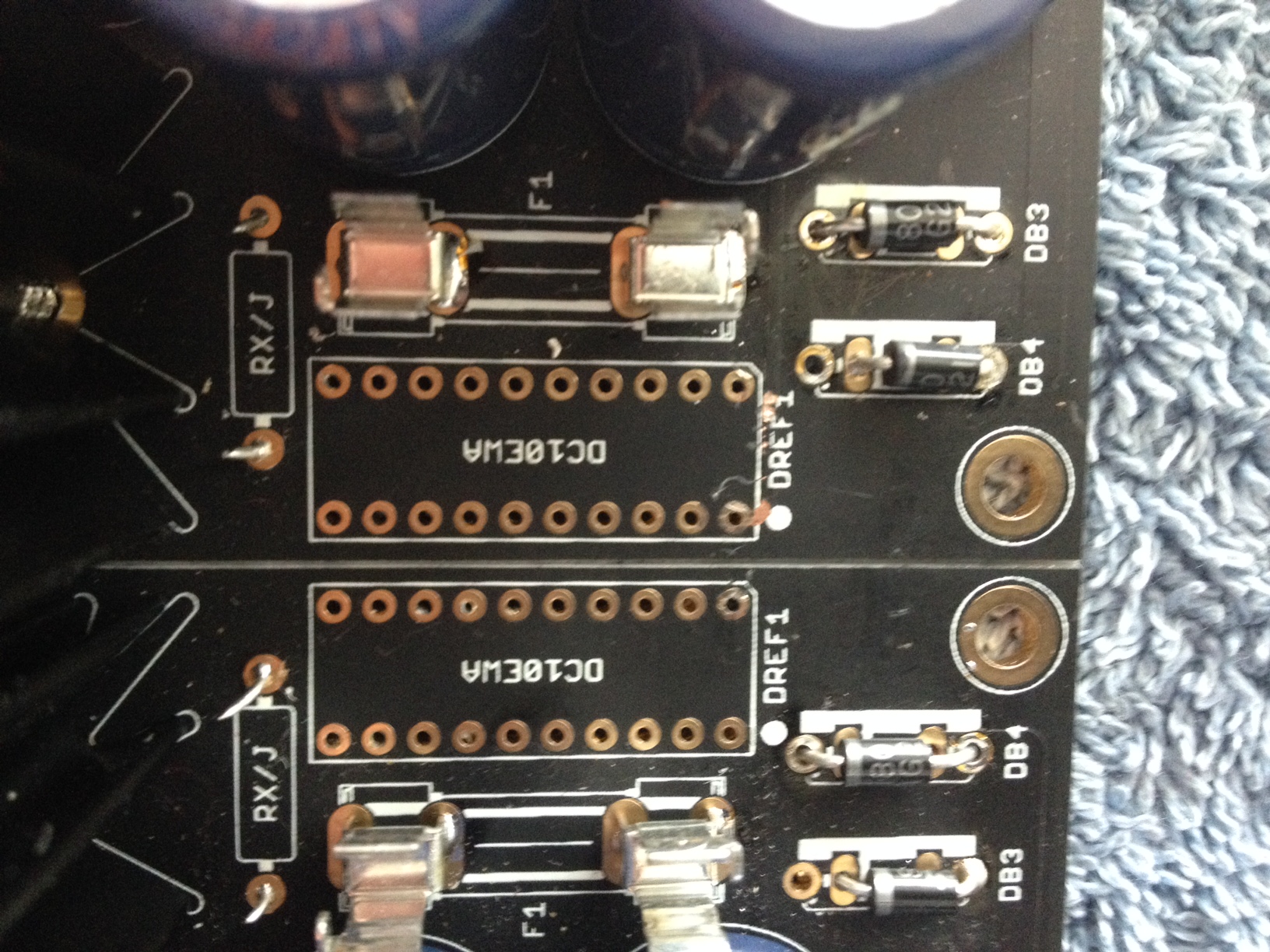

Broken diodes say that was a big prolonged short. Your Mosfets got assembled without Silpads if I remember well. Check various Vbe and other points like in Ammel's measurement list, because the few dark segmnets can be just signs of other problems yet unfixed than broken themselves. To verify the segments alone try light them up individually with a voltage source as he did. Don't forget to measure for shorts between the the +/0/- DCG3 inputs before attempting to use the supplies again after fixed. We don't know if your DCG3 passed fully undamaged yet.

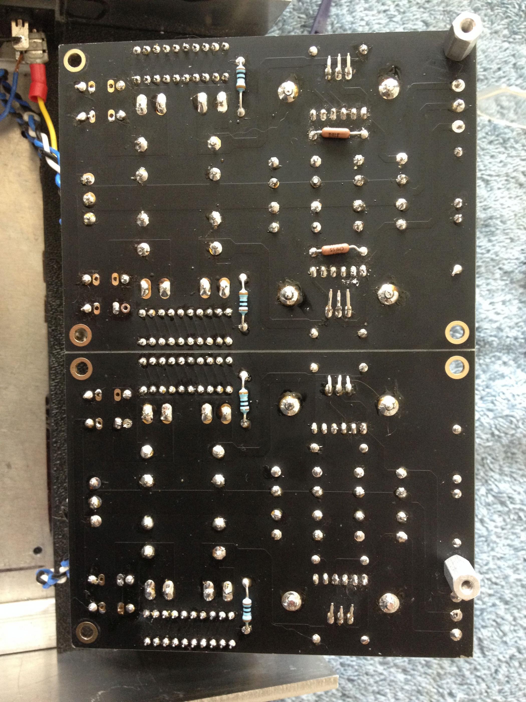

P.S. Why we see no R1, R2 on the top DCSTB in your picture?
R1,R2 are on the bottom side.

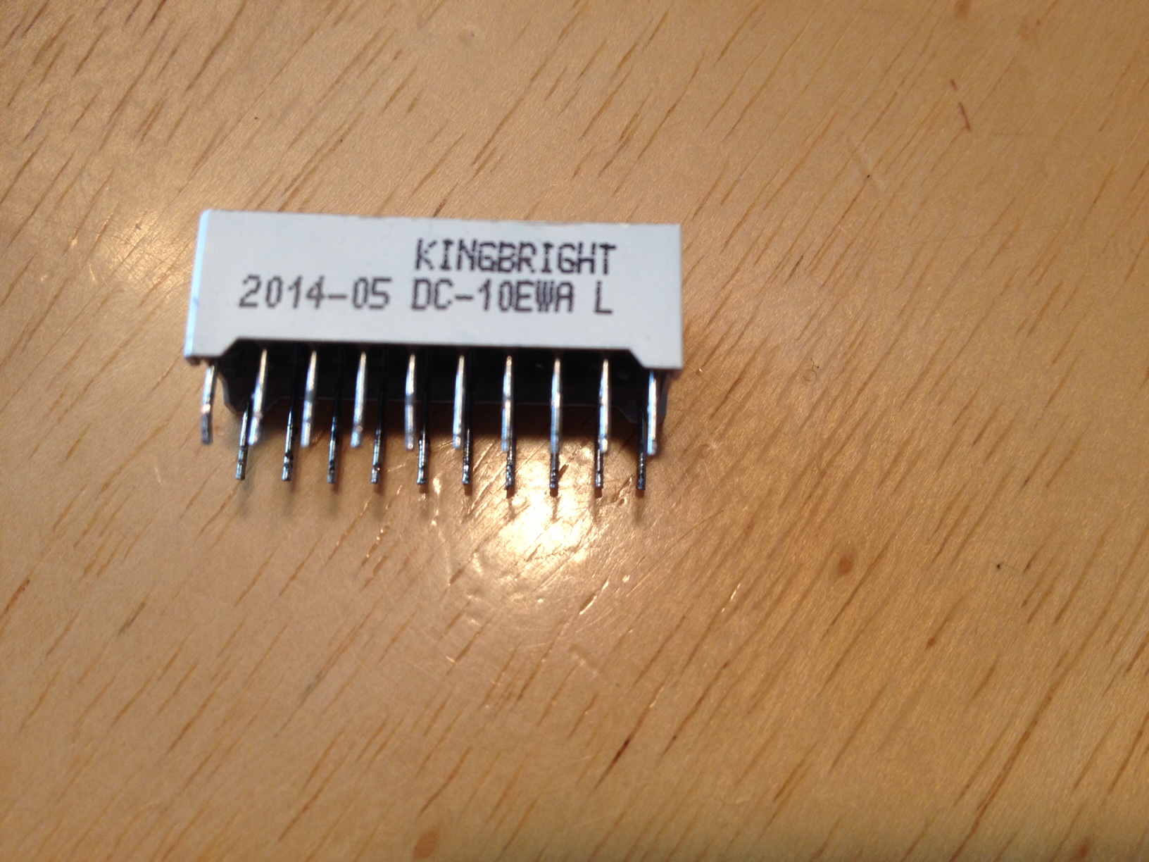

Thanks for the responses. I followed your advice Ammel and checked the LEDs. The two inboard blocks each have a bar unlit, they measured .20 and .22ma, much lower than the others.
I also checked Vbe on the transistors. These ranged between .64V and .65Vbe for Q2, Q4 and .13V to .17V for J1, J2.
Resistors R1/R2 were .17-.18V and R3/R4 were .47V-.49V.
Rx/J and Ry/J = 1ohm
Output is -17.3V and +16.6V, and -16.9V and +17.3V
I’m hoping by changing the unlit LED blocks I’ll have a happy board.

R1,R2 (33R) are indicating about 5mA which is normal. So J1,J2 are working OK as CCS for the LEDs. They are JFETs so they present no Vbe, they just have a Vgs.
Vbe for Q2, Q4 BJTs reads normally. Across R3 and R4 there should be the MJE TO-220 transistors Vbe drops. Which seem rather low at 0.47-0.49V. Ammel's Q1 was 0.56V for instance (with no load at the output). I suspect they could be just passing the Rb1, Rb2 bleeders ~5mA load current through Q2,Q4 directly and the MJEs could be damaged. I hope not.
Please check the drop across RxJ and RyJ too so we see what current passes through the LED bars finally. They have weird failure modes, they usually fail open, but can fail emitting and still have some resistance too, still passing current.

Sometimes things go right. Replacing the LED bars was not the nightmare I expected. I wicked along the pins, inside and outside, gave the pins a very light wiggle and the bars dropped out. The pads are untouched. Eutectic solder. I celebrated with a beer.
The sinks are low warm. I hope the numbers below tell the story. If not, please let me know. With input to the right hand and the board face up, measurements read top to bottom.

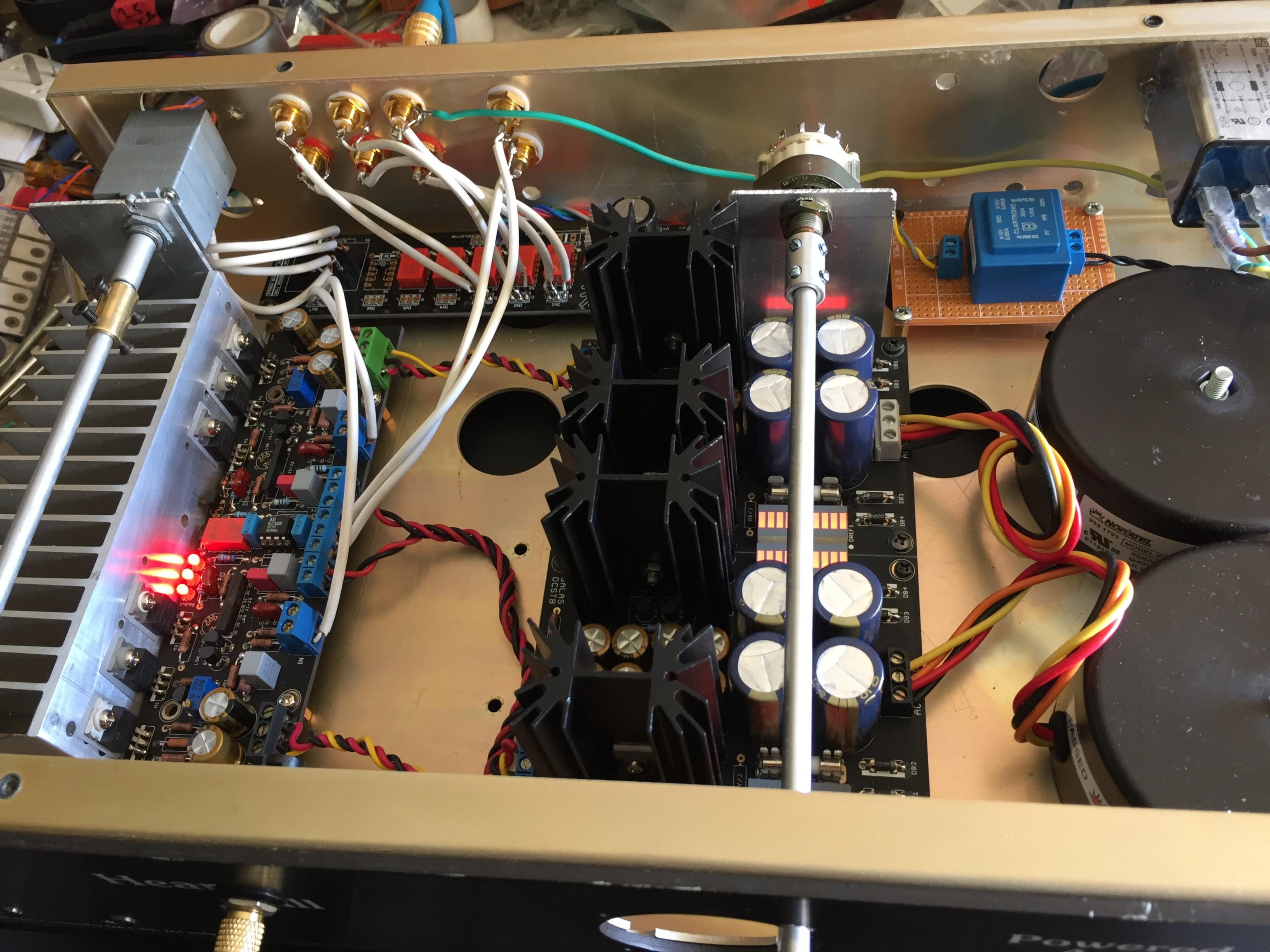

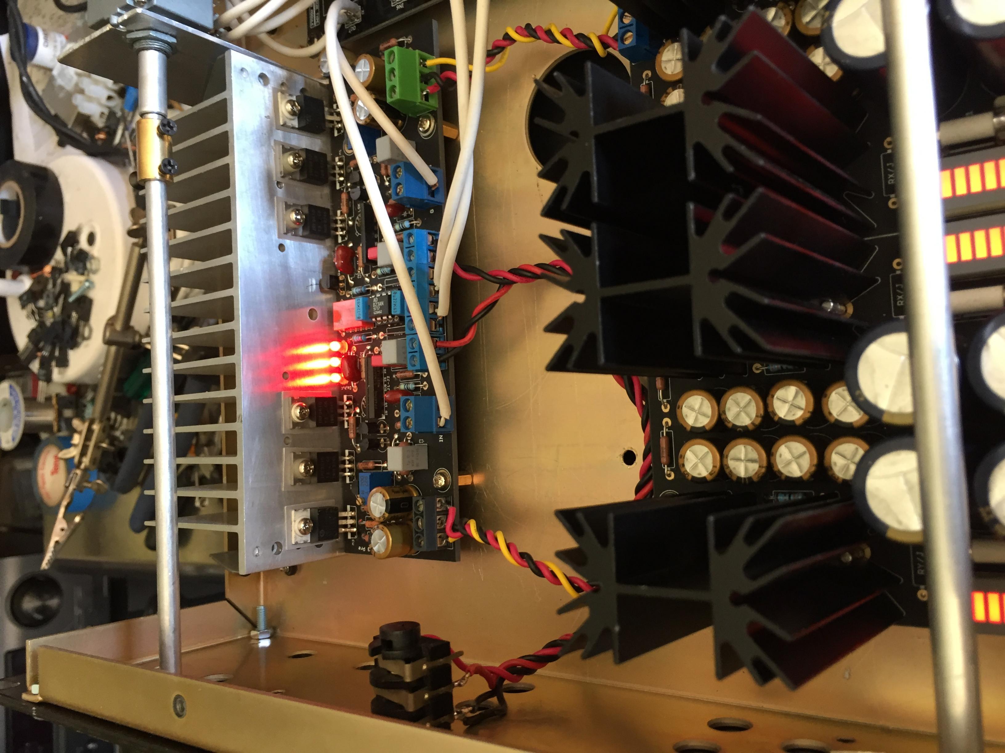

Hi guys, just finished the pre-amp, all light up and Dc offset is 0 but no sound. On max volume only faintest of music with lots of hum. I used neutrik input jack but not sure on wiring. The pot is 20k Noble ,and input selector is 6 poles type. I am yet to find power amp to check the pre-amp part as yet.
Play a strong steady tone provided by a generator app, or a lab gen if you got, preferably 300Hz to 1kHz, open the volume at 3/4 and measure with the scope or a DMM on AC mode across each channel's headphone output with & without the output jack connected to the board's terminals. If there's no output signal or its very weak, follow the signal path from RCA input to selector out to pot to DCG3 in to verify it really enters the main board first or where it maybe stops. Make sure that the relays also click.
Thanks Salas, will do and report back.
Quan
Hi Salas, all good so far the input selector relay did not switch on as the pole was incorrectly wired . Now there is sound from headphone but only from one chanel and lots of hum. I just need to sort out the input jack wiring and the grounding scheme. Is it suggested to ground the input RCA ?.
Quan
It does not look like a main board electronics build issue indeed. It seems like a signal path and grounding issue.
Don't wire the IEC mains ground or other ground to an RCA's ring. I see a yellow/green wire to one in your photo that I don't know what is it for. Remove it.
Wire the IEC mains ground to a nearby chassis location with a short thick cable to a screw with a safety nut.
Install another chassis screw in the space between boards. Wire there a link from anywhere at the selector board's signal ground. Also wire links to the same chassis screw from both DCSTB's output connector's middle zero screw. Not necessarily the perfect grounding scheme for you but something to start with.
I hope you have a stereo unswitched jack type. If the jack is proper, or more complex but rewired properly for TRS only and still no correct headphones sound, trace the signal on both channels from input to output and see where it possibly stops so to fix or rewire as we discussed in a previous post.

Hi Salas, the above grounding scheme works fine for me so now stereo sound noise free. I am using Audiotechnica ATW1000 and sound very nice. Thanks again.
