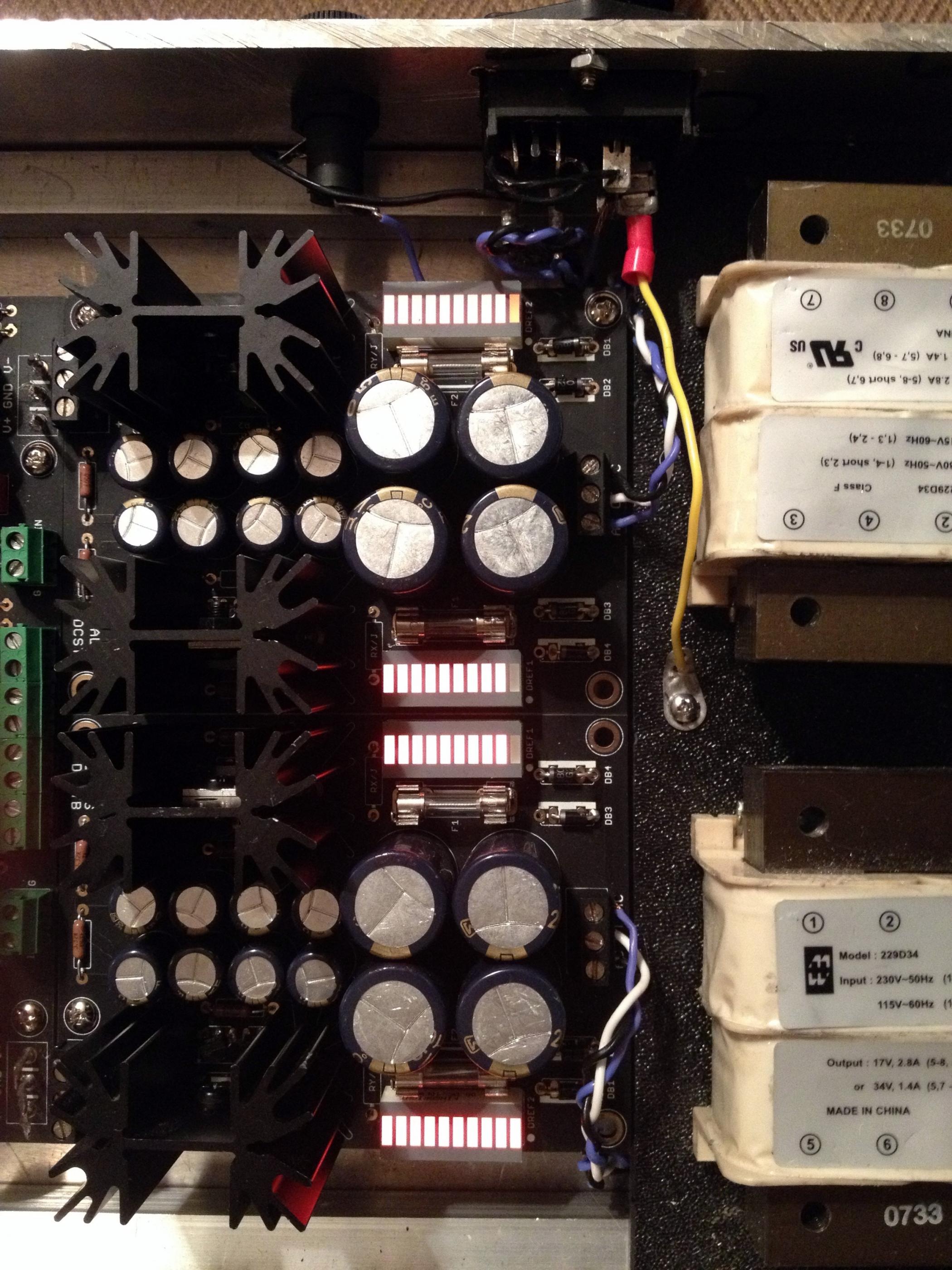

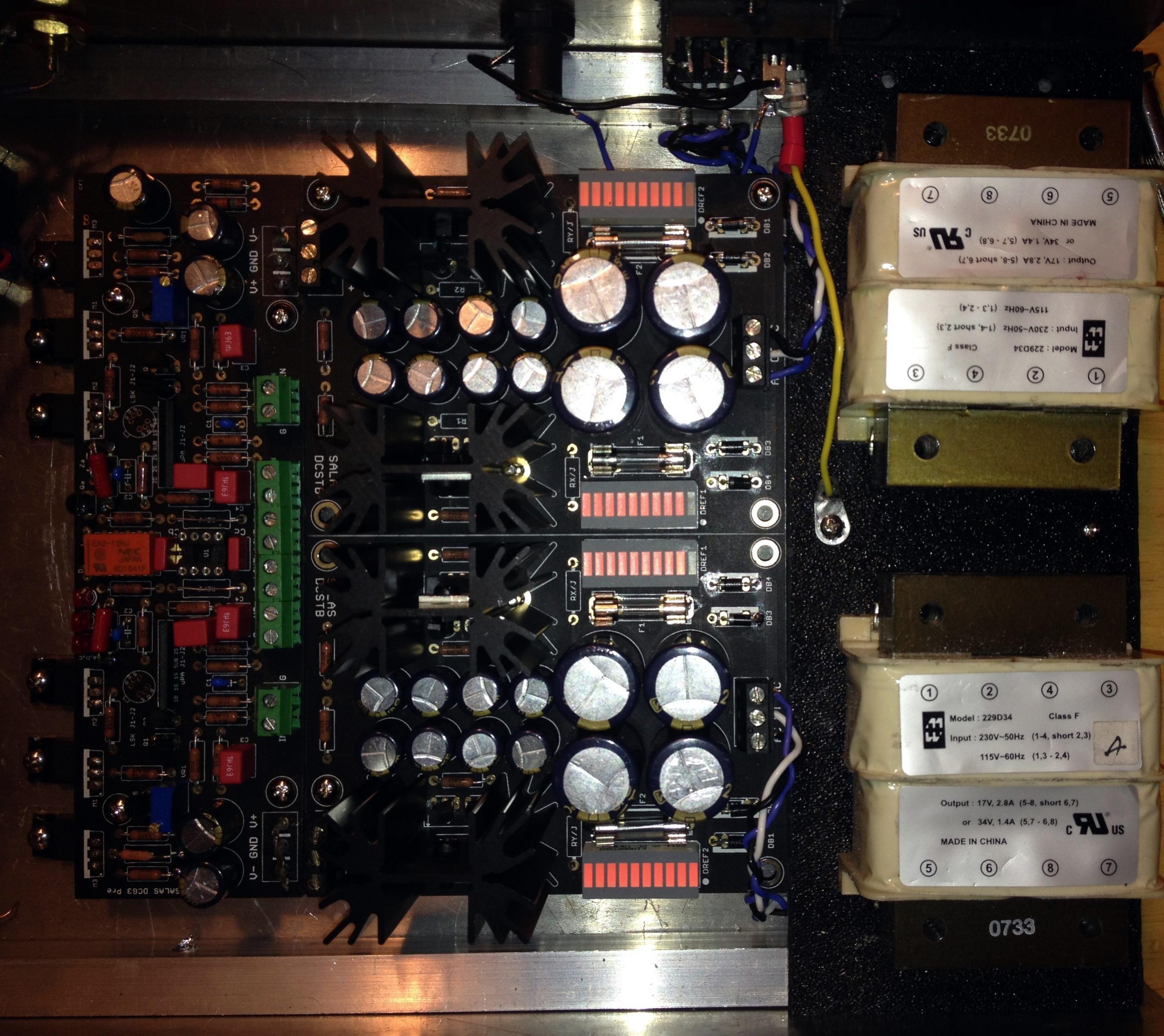

OK, changed out the BC550 and BC560 and 4 diodes.
Unloaded voltages look better, but a couple of LED bars are not lit I'll order some more. Voltages are now -17.2, +16.74, +16.99, -17.45 (top to bottom related to pics)
Keith
615498, you can easily check each LED segment with a 9V battery and a 1k ohm resistor in series with one of its terminals as Salas suggested to me in a earlier post.
I tried it and verified all my segments were working.
Changing those Kingbrights can be a real pain in the rear, especially if you don't need to.
Keith
Broken diodes say that was a big prolonged short. Your Mosfets got assembled without Silpads if I remember well. Check various Vbe and other points like in Ammel's measurement list, because the few dark segmnets can be just signs of other problems yet unfixed than broken themselves. To verify the segments alone try light them up individually with a voltage source as he did. Don't forget to measure for shorts between the the +/0/- DCG3 inputs before attempting to use the supplies again after fixed. We don't know if your DCG3 passed fully undamaged yet.
P.S. Why we see no R1, R2 on the top DCSTB in your picture?

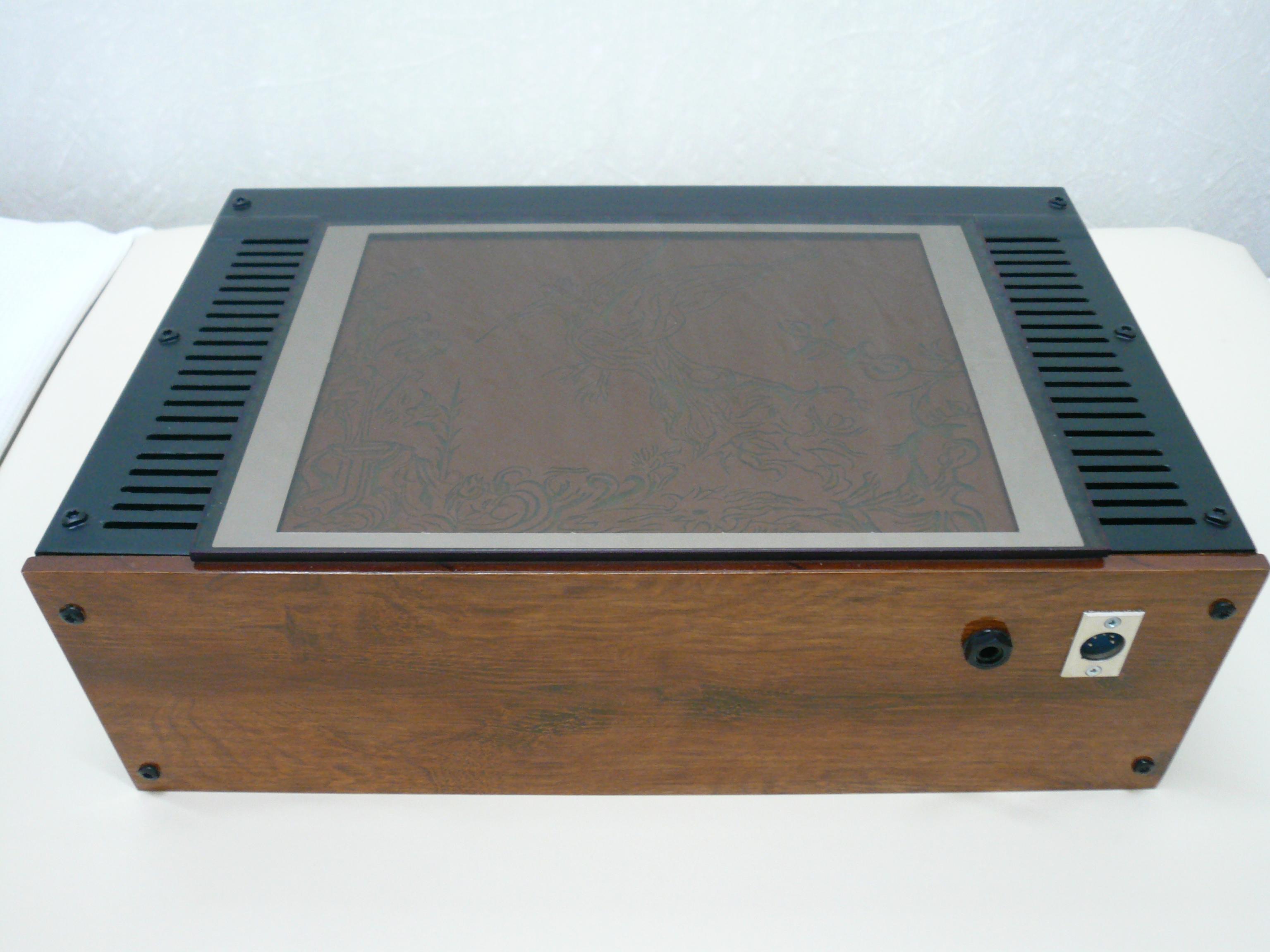

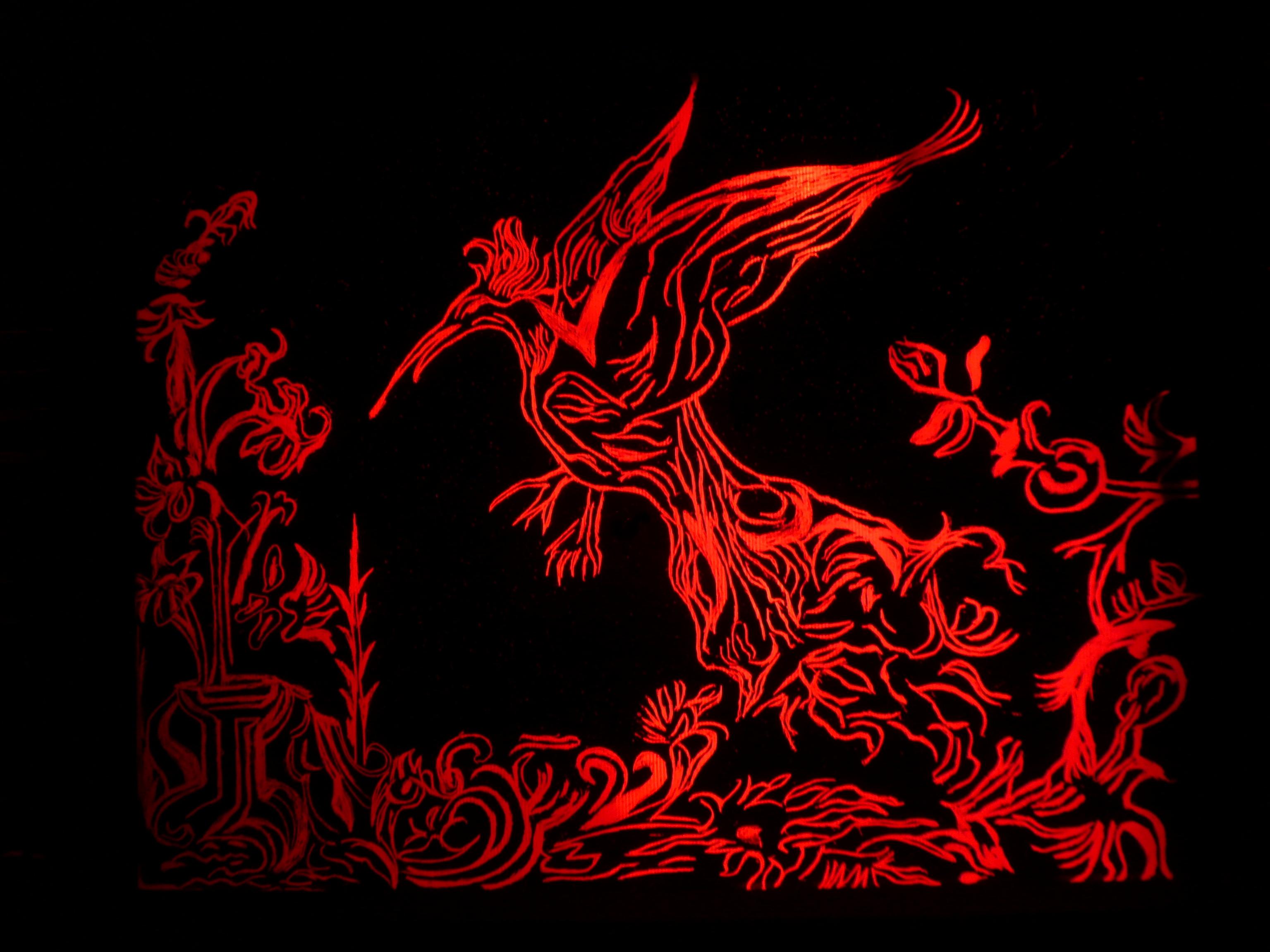

Finished!🙂 Normally, a generic box would do fine but, there was too much inner light to be ignored and I had enough leftovers to try this...
It doesn't glow that bright. Shot was taken in the dark with camera set to "night scenery"
A touch of nice art. I like it.
Very good work you did here 🙂
Magicbus,
That top is wonderful.
Jim
Thanks everybody!Very good work you did here 🙂
