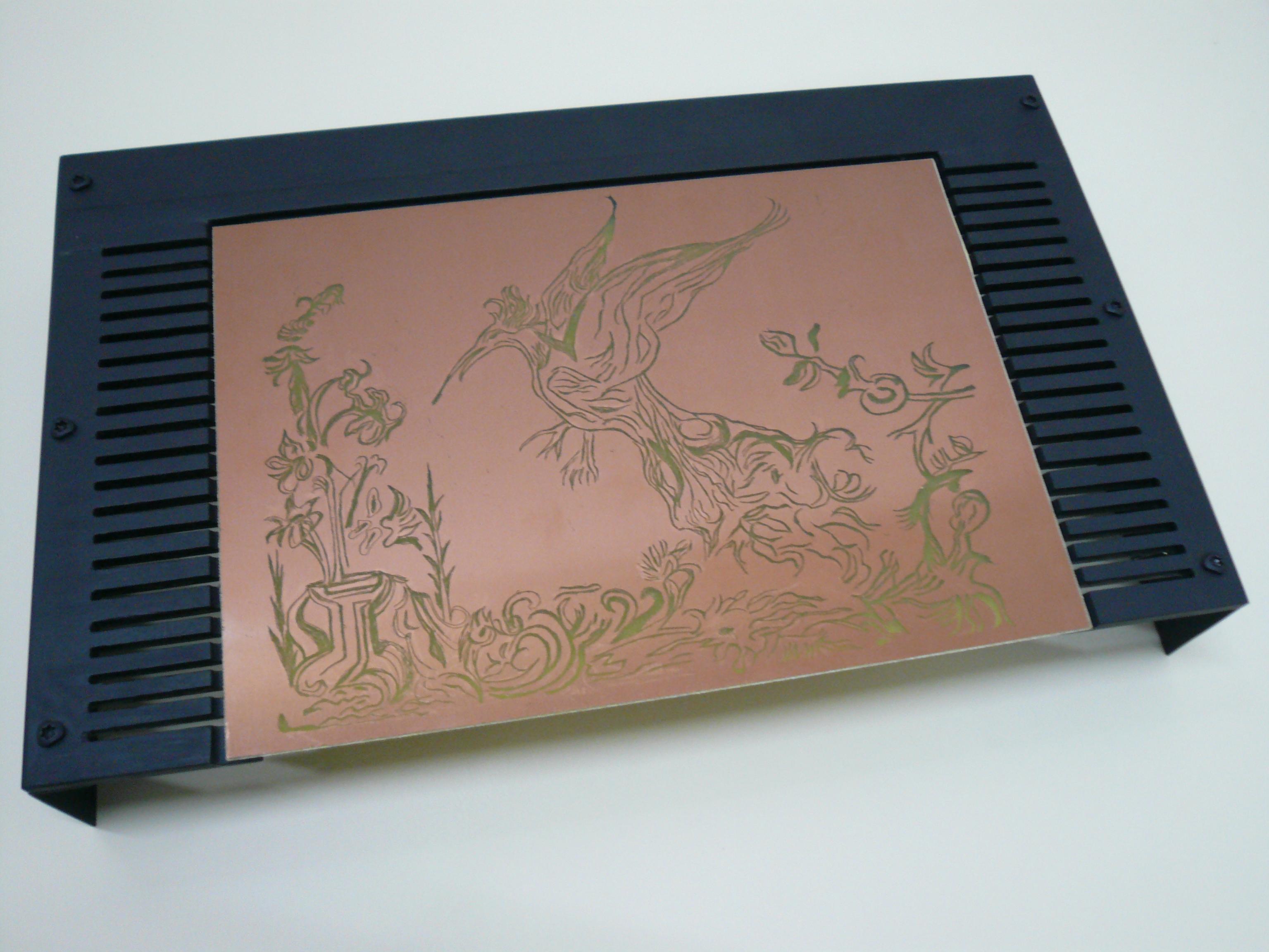

Spring time and my job needs me twelve hours per day... But I had some progress. Top cover is almost finished! Believe it or not, I' ll have to install two more leds inside the box. I'm going to power them directly from DCSTB output. Would this affect performance soundwise? Should I preffer the positive or the negative rail for some reason? Or put one led on each rail for symmetry? I guess this is another annual award question😀
