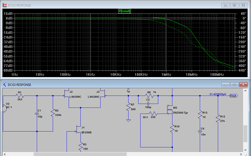

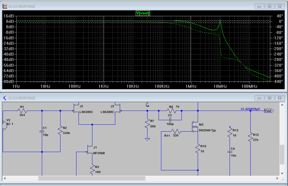

If the simulation is accurate then that terrible peak in response @ ~10MHz is an indication something is not set up correctly. Look at how the phase plummets at that frequency. It is trying to behave like an oscillator.
The peak also exists even with the original 33p cap in the feedback loop.
The zobel smooths things nicely (in simulation)
In post #20 you can see 20kHZ and 50kHz squarewaves when using the standard design values and a 20K pot set at half value

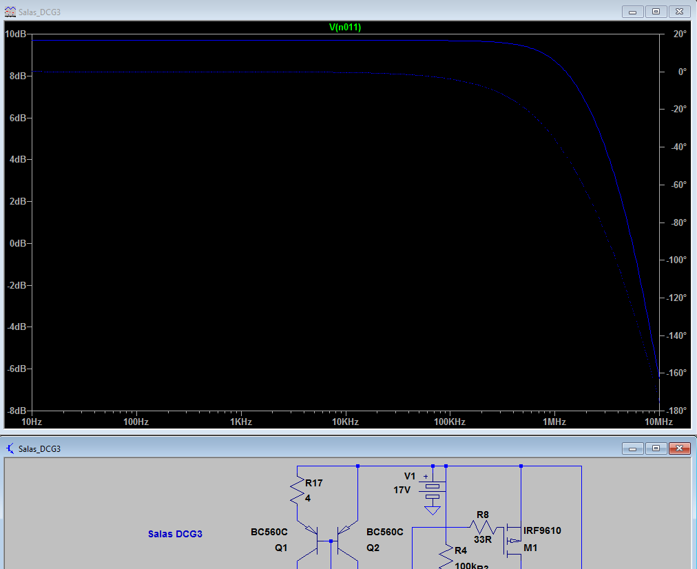

Nothing is peaking in my closed loop simulation of the standard circuit (33pF C2, gain 3X, and no Zobel)
Well, I am sure it is because I did not use the most correct models and I am not an expert in simulations.

It wasn't peaking on the scope too hence the post#20 very high freq smooth sqwaves
