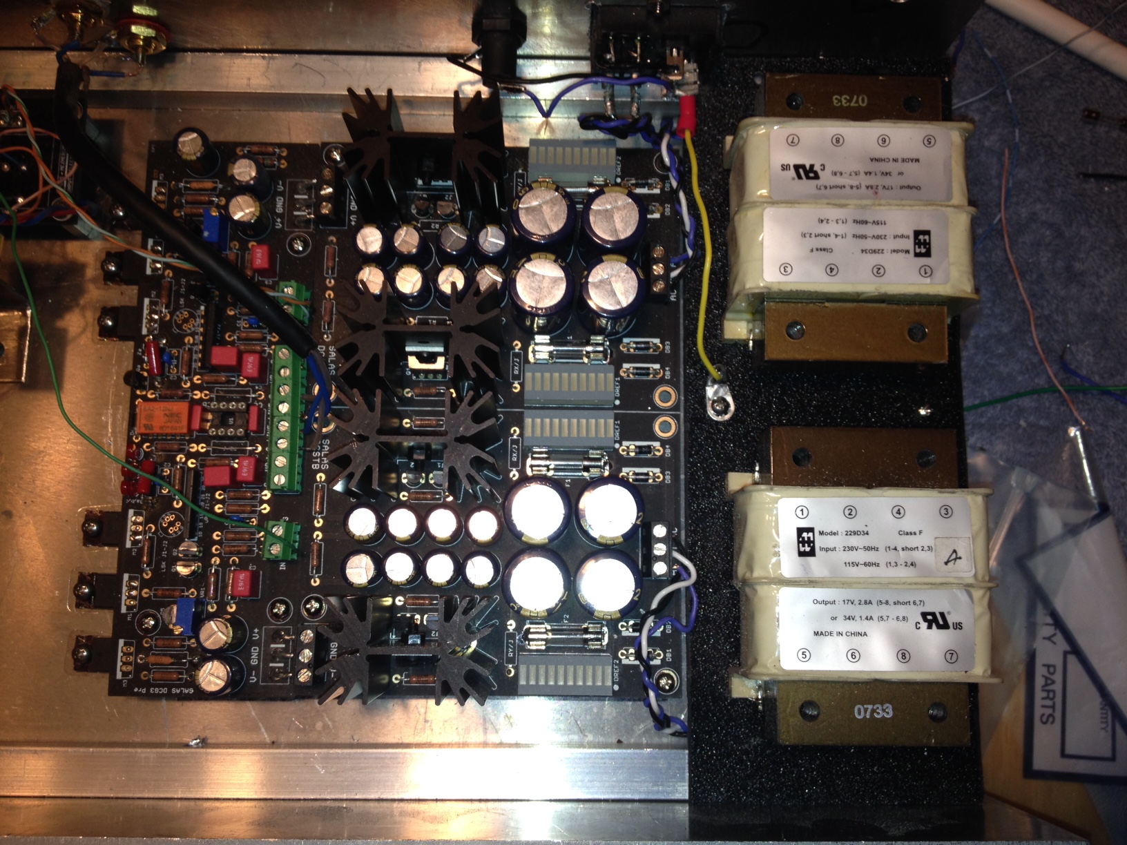

I forgot to insulate the Mosfets before power up and have likely caused some damage to the power supply (possibly more). The inboard LEDs blinked and their respective fuses blew.
I insulated the mosfets and replaced fuses and now read +24.3V and -6.6V ( on minus and plus rails respectively). The other side is about the same.
Where do I look?

Are those voltages without the amp board connected? I hope so.
24v means the led's and regulator diodes aren't doing their job. Actually, this is kind of a good thing...at least it's somewhere to start. You have a straight shot from the transformer. Replace leds and then semis is probably where I would start.
-6v means something is broken, maybe caps got reverse voltage but you are losing voltage somewhere. I'd measure voltage at the first cap after the rectifier to see that you are getting -24. Once you get to the leds if you have -24v you know the problem is after that.
If you replace the leds and the semis on the psu board you should be ok. Resistors look ok?
The amp board is another story...but if you can fix the psu you can start debugging it.

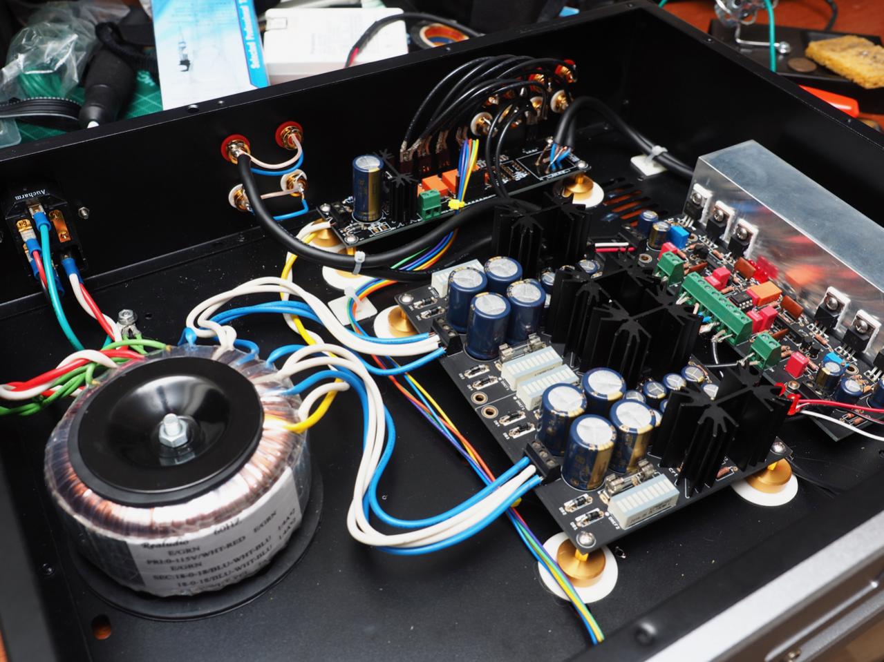

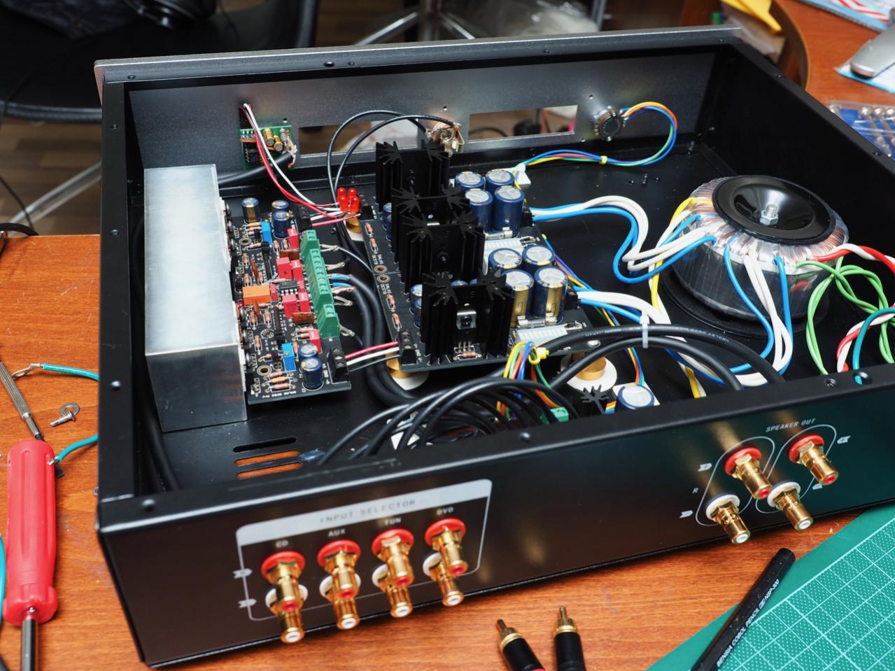

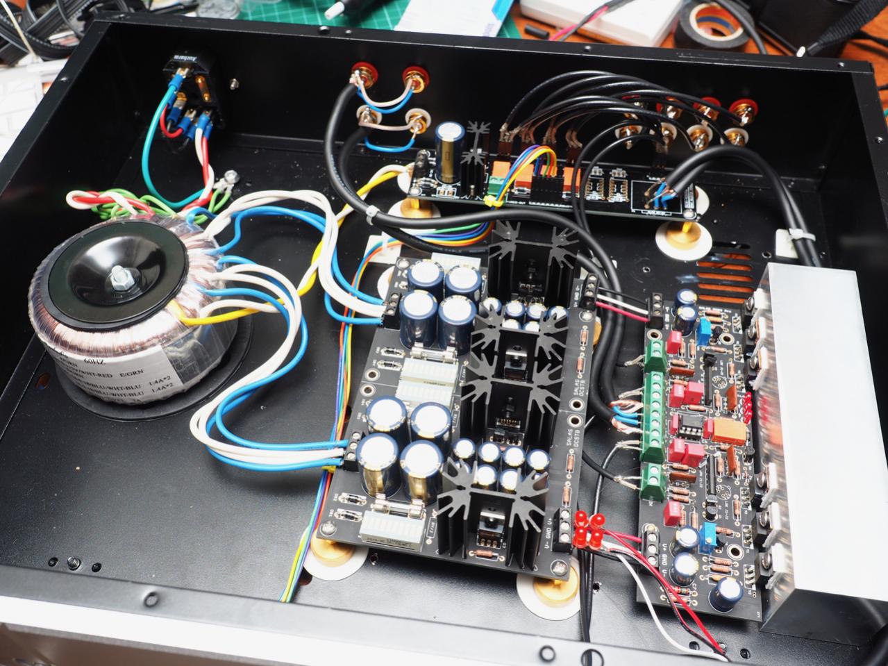

Just finish my DCG-3 build. I use MUSES72320 electronic pot kit from Japan which has 20k ohm impedence.
‚l‚t‚r‚d‚r‚V‚Q‚R‚Q‚O�@“dŽqƒ{ƒŠƒ…�[ƒ€ƒLƒbƒg: ‘g—§ƒLƒbƒg �HŒŽ“dŽq’Ê�¤ “dŽq•”•i ƒlƒbƒg’Ê”Ì
Everything working fine so far. Many thanks for Salas and Tea.

Congratulations. First one here with a Muses chip-pot I believe. Let us know more about your system and how it blended in after you run it enough to grasp the qualities.

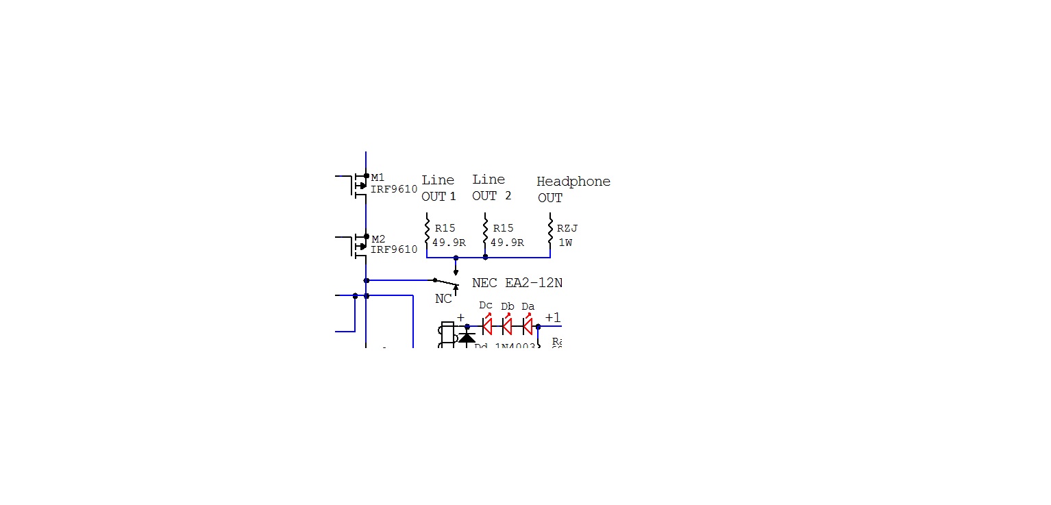

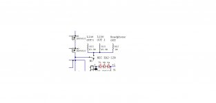

I see Seanwu uses two outputs connected in parallel. Is it the right way to have two independent outputs?
I assume that usege of output 1 or 2 is ok. But if to use both at the same time (like 1 for power amp and 2nd for power Subwoofer), then we need to add resistor.
We discussed that subject on Hypnotize/Mesmerize B1 buffer forum with Andrew.

Absolutely properly for two outputs it is done with a jumper on the PCB 50R output resistor's place and one 50R inline with each RCA output. Then again because its a strong driving circuit that does not care much about total cable capacitance it has to be compared to say its detectable or not vs just Y after the common 50R.
Using the Muses attenuator it already has input capacitors to that chip and an expensive Muses DC servo op-amp for its output on its own little PCB so there are even more things to consider vs a typical DCG3 configuration.
