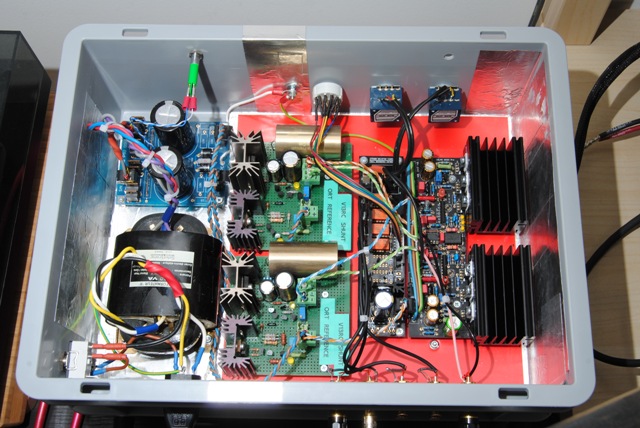

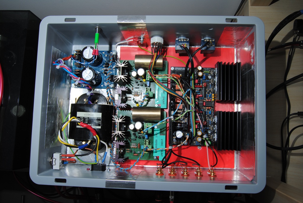

hello Salas
Now that I reasonably finished my power amps that have 30dB gain and produce a sound quite lisible, I am enjoying the DCG3 as I should.
But I have a small issue, with the DCG3 I hear a low level noise only aparent when there is now signal. It seems like digital crizz but might as well be other thing.
Can the preamp be uncompatible with the V12R I am using ?

I don't know what this sound could be in your special build mix. If the rails are clean on your scope then they are. Tham beta tester had 1.2s and did not report weird sounds. Can it be you have a light ground loop? Does that sound have some zzz element?

here we go

diyAudio Chief Moderator
Joined 2002
Hmm... now that's complex enough because it has stacked positive PSUs, sense runs, two pots.
1. Ground the metal necks of the pots.
If something does not change to the better... 2. Sever the top layer's front edge ground plane at mid-line between channels with a hobby knife and replace the now yellow to chassis wire with two of those connecting the pots signal return legs to the chassis screw like a Y. Because I possibly see a PSU 0 ground bar wire going from edge to edge connector and the loop continues around through the GND plane.
Joined 2006
Changing the GND layout did not help but I scoped the shunt outputs and found noise in the MHz range.
I am using shunts that I saved from an old folded build so they are optimized for 35Vout.
In this case I have one 30kohm resistor fro vref and the tail ccs jfet has a trimmer in the source leg so to get the desired 17Vout I just turned the trimmer pot. current in the shunt ccs might be too small and also current in the vref ccs.
