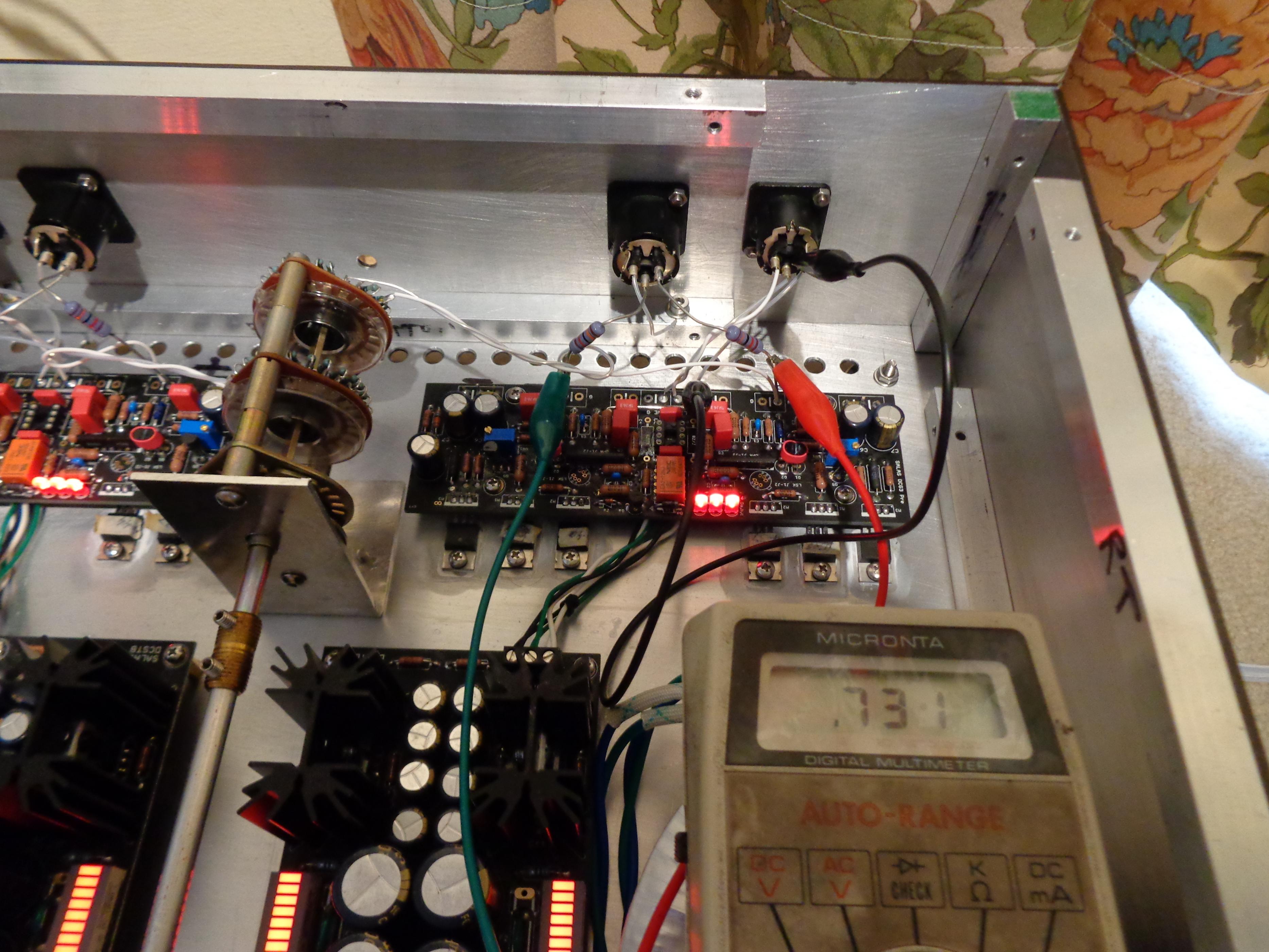

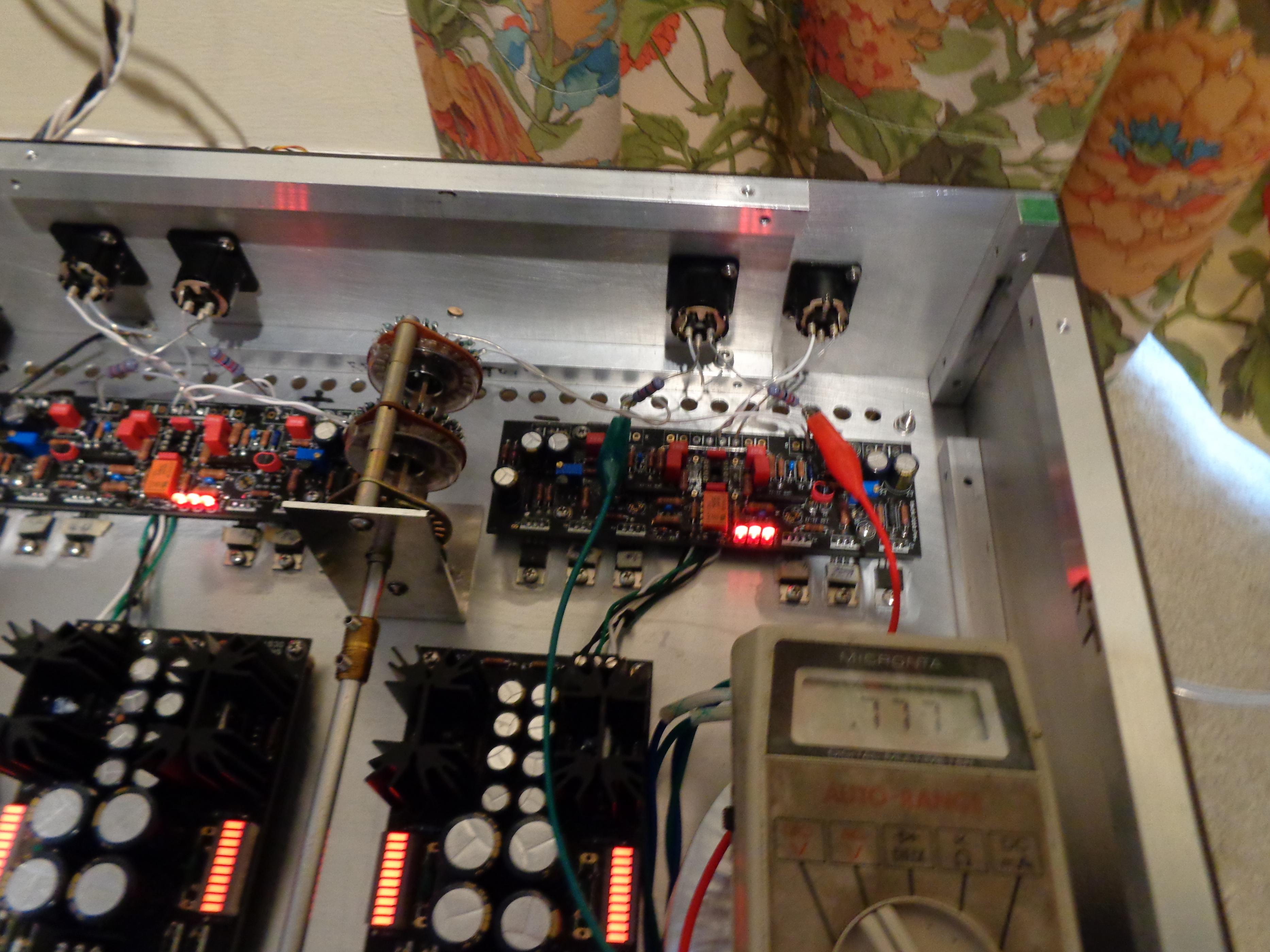

OK so I did a bit of testing.
As mentioned before the shunt portion of my attenuator is between the two IN's on the board. I turned the vol to its max in which position there is an open so essentially there is no shunt between the two IN's.
I took the SE output of a CD player and outputted a 1khz test tone and adjusted the output to around 0.25VAC. Using test clips I connected the red signal wire in the pic to the + in on the board and the green signal reference to the -In. The meter is reading the differential output between the two Line outs and you see it is around the expected 0.75VAC.
Next I connected a black test clip between the R7's link and G on the DCG3. The pic shows me connecting one end to the output XLR pin 1 which is presently connected to G on the DCG3. Once again the differential output shows around 0.75VAC.
This tells me that that I can get a differential output even if R7's are not linked. Why? I think it is because the G's of the two individual gain modules(if you call them such) are linked thru a common Ground plane on the DCG3 board.
So in short to get diff output with an SE input either have an RCA input on the DCG3 that connects the signal to XLR pin2 and SE signal reference to pin3 or just make an interconnect with an XLR plug similarly wired. Pin1's to chassis on both input and output.

Nash,...I connected the red signal wire in the pic to the + in on the board and the green signal reference to the -In....
nash
I believe you should connect the red wire to the +in and the green wire to GND. The -in should also be connected to GND. And of course, R7 lifted. I think this is the proper way to convert SE input to balanced output and preserve functionality of the volume control. Please try it this way and let us know the results.

Sure will let you know tomorrow. Indeed my BA3B is wired the way you say but that is to avoid a 6db gain going from balanced to SE.
