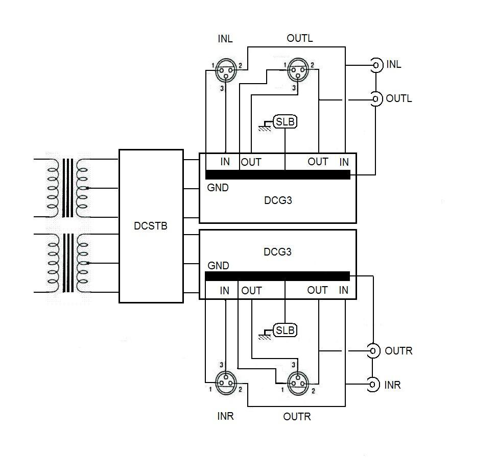

your sch says otherwise.Perhaps the scheme is not as clear as I would like. Circuit GND is not connected to chassis nowhere except at one point through the SLB. The rest wiring from pcb to inputs/outputs is as your suggestions
Pin1 is shown connected to a symbol. The other pin 1 is also connected to the same symbol.
The signal returns on the two RCA/Phono are shown connected to the same symbol.
That tells me you have taken the signal returns to the same chassis as the two pin 1 are connected to.
it must, it cannot work any other way.It cannot amplify the difference at it's inputs!
The signal arrives over two wires, the amplifier reads that voltage difference and processes it.
That is why it is important to keep the two wire connection close coupled all the way from the source to the receiver.

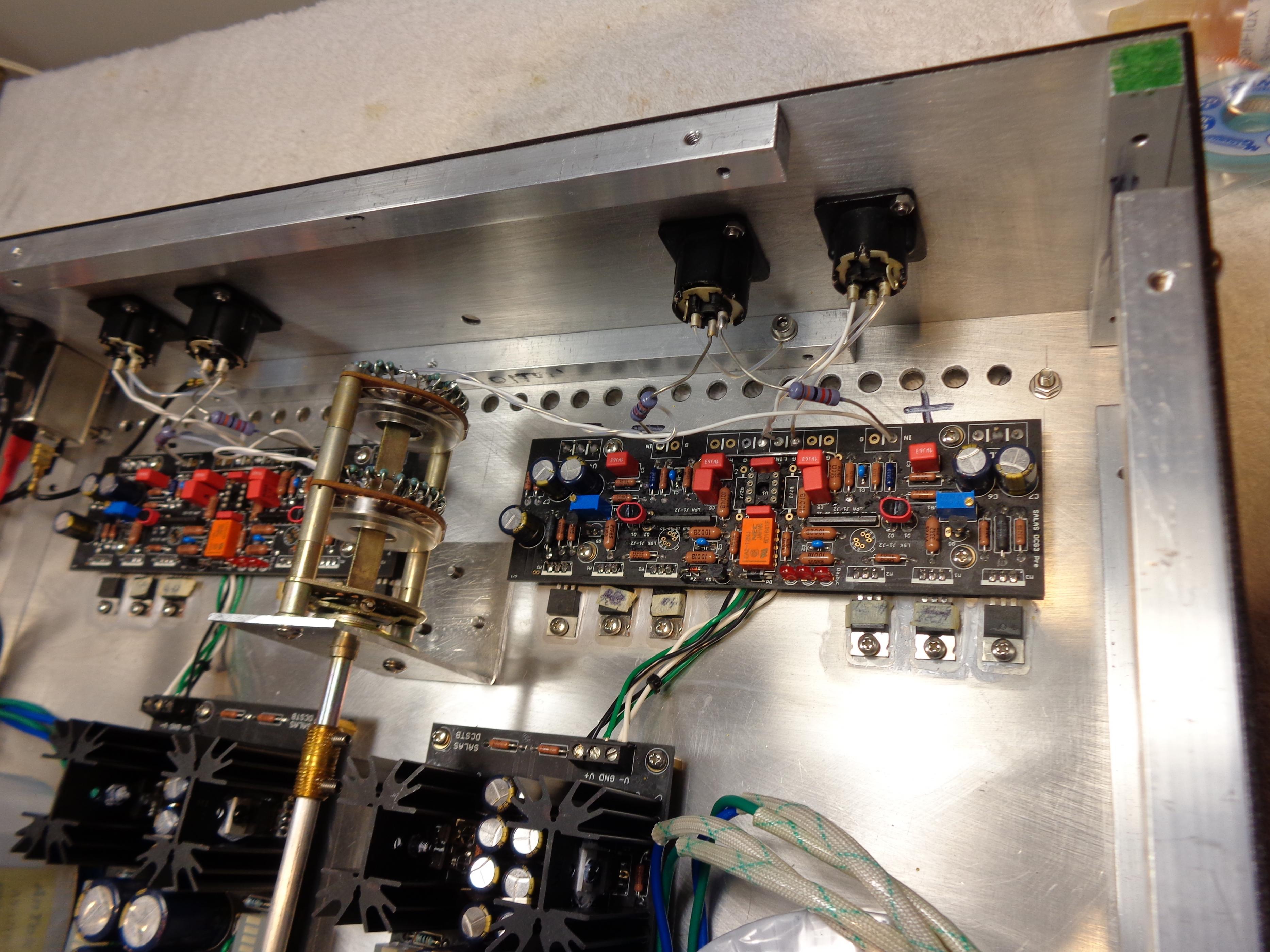

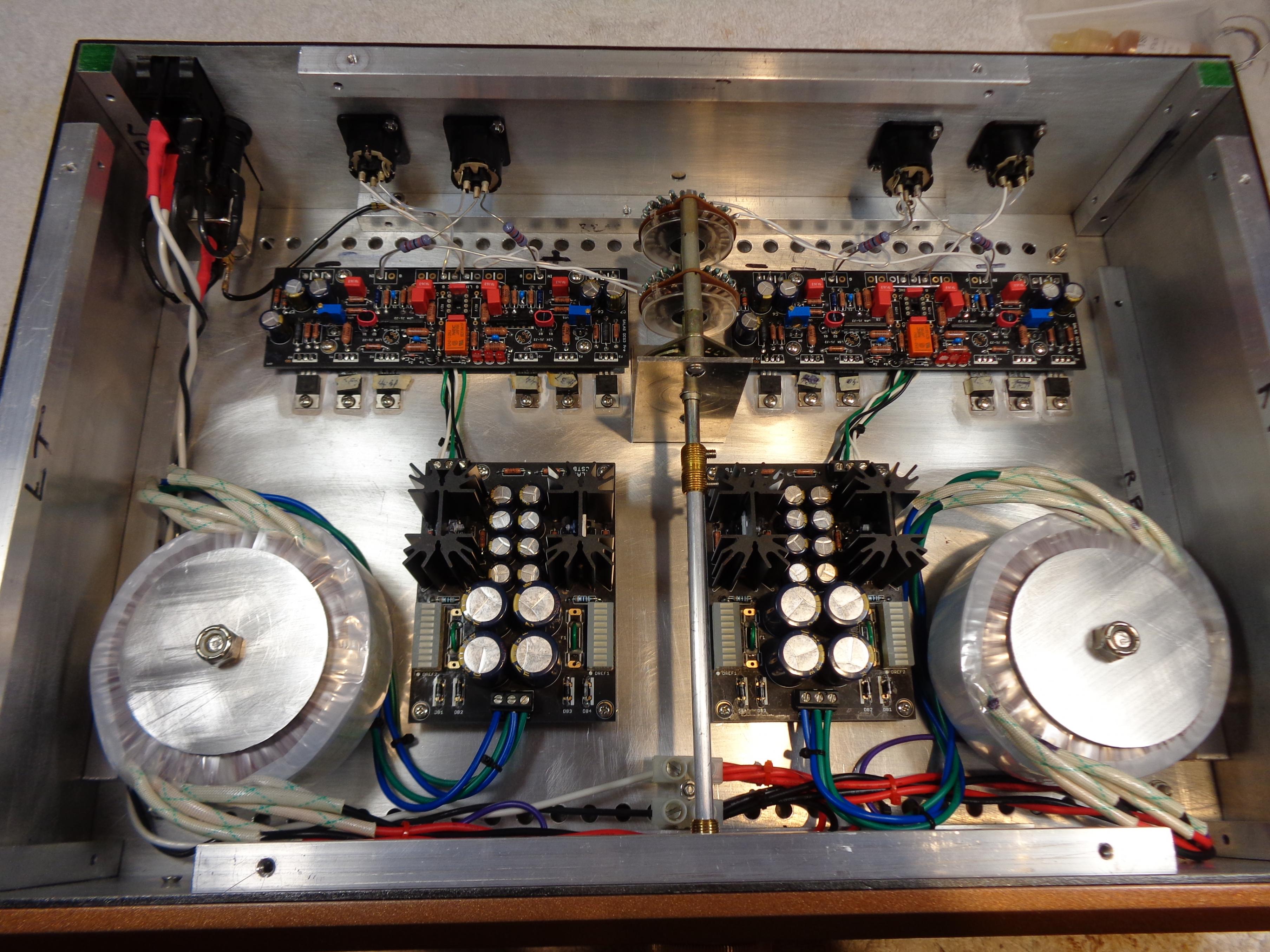

Please see pics of my completed balanced build.
R7's are lifted and linked together.
I have been experimenting with XLR pin 1's and in this build for balanced use only the lowest noise is with pin1's to chassis which is where I have them now.
My attempts at installing a SLB have not been successful. I have tried at the DCSTB G and at the DCG3 G points but they both introduce a buzz. With no SLB and XLRpin 1's to chassis the amp is very quiet.
I will be replacing the 11/2 in heatsinks with 21/2 ones very soon. At 130ma they are getting around 52C with lid open and 64C with the lid on at ambient 22C.
Just a note that with R7's linked adjusting the DC offset of one phase effects the other.
My initial impression of the sound is that the stage is a bit wider and the sound more revealing than my BA3B/SalasBIb. Depth about the same although I feel the sound has moved a bit forward but the separation is outstanding. All the positions of the performers seem correct. A bit of harshness in the violins but I bet after 100 hrs that will be gone.
