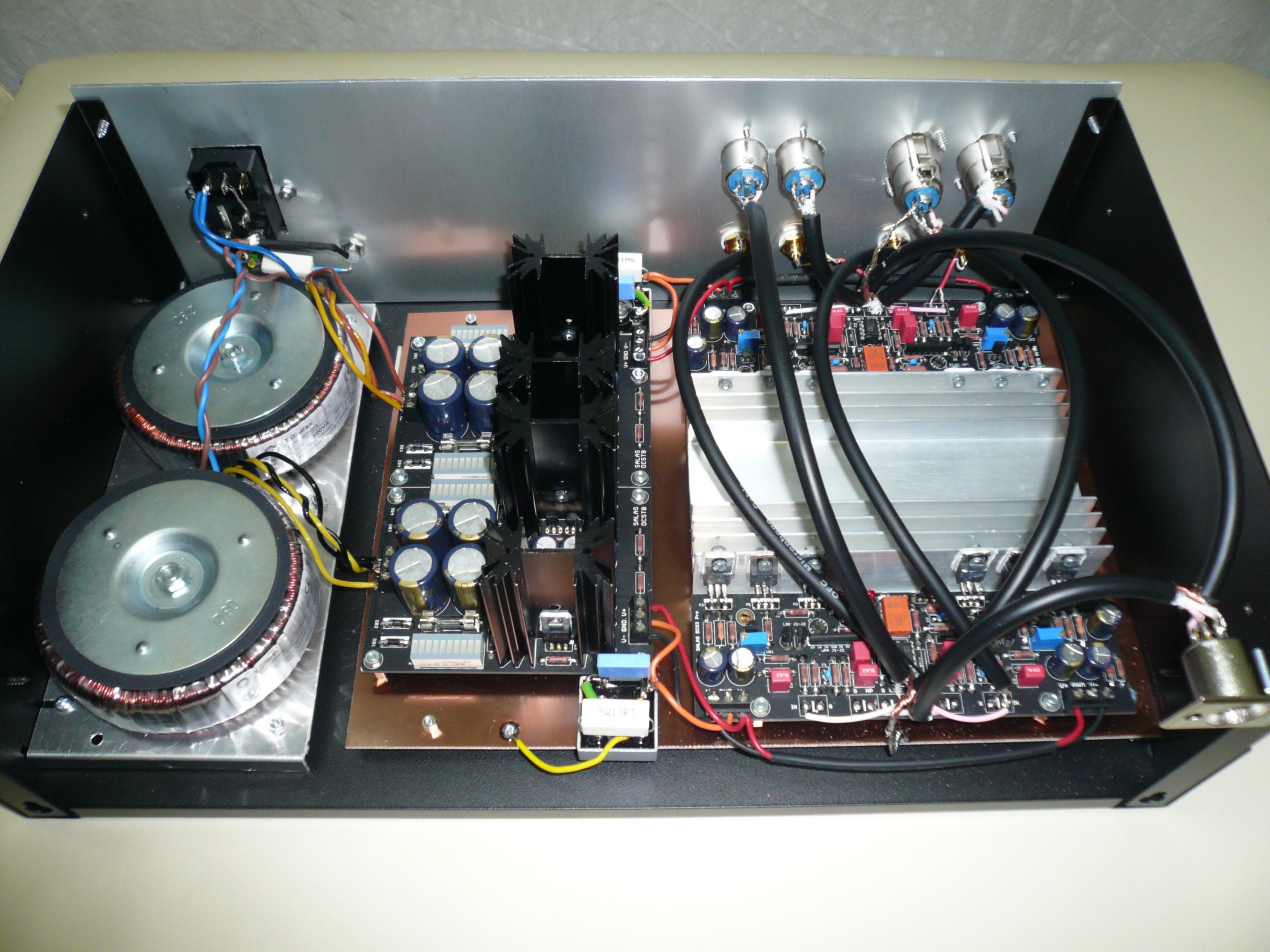

Finally getting around to completing my balanced build. Two DCG3 boards each powered by 1/2 DCSTB each with a transformer.
A few questions:
1)From the DCSTB outputs + G _ , should I run separate wires to each of the DCG3 + G _ points ie 6 wires out or should I take 3 wires and then daisy chain to the next? I think I read that 6 wires is the way to go but cant remember.
2)I will install two CL60's to chassis, one for each channel. Should I connect the one end of the CL60 to DCSTB G or to the PCB G? If PCB G then which one?
3)I could also connect a link to the two outer G power points on the DCG3 and connect the G wire from the DCSTB to the center of this link and also connect the CL60 at this point, if this is technically superior. XLR pin1's are planned to be connected to the chassis.
Thanks. nash

Here is what I did - see pic.
1) Daisy chain the two channels. The GND of each DCG3 is common for both onboard channels so no need to connect them again with an external wire. Just two wires for + and - from ane channel to the other and then to DCSTB provided it is lockated close to the DCG3.
2) You will only need one CL60 per DCG3 board. It could be connected like my ground lifters - the rectifier bridge with the power resistor and the cap.
3) XLR pin 1 is connected to chassis in my construction and it works. But on second thought it may be not optimal solution because this is not a true differential amp and I expect signal to pass through the GND lifter/CL60. I'm going to return pin 1 to DCG3 GND. This would not affect channel GND separation in my system because source GND is allready common for both channels and power amps are monos with XLR pin 1 to chassis.
I hope that helps!
the signal should not pass through the safety connection to chassis.I expect signal to pass through the GND lifter/CL60
The signal should pass along and back through a Signal PAIR. Signal should never go anywhere else.
Agreed. That's why I think XLR pin 1 sould be connected to circuit GND in this case. I'll test it against pin 1 connected to chassis as soon as I find some time.
XLR pin 1 must be connected to the chassis by the shortest route. Please do a search for "pin 1 problem". I think Rane had a decent analysis of the issues when I last looked.

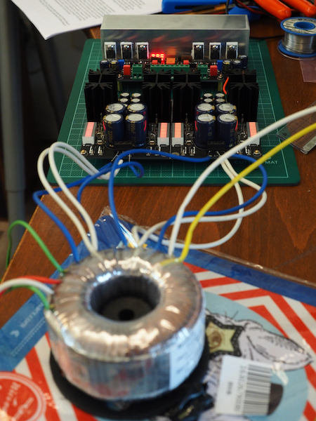

Hello Salas, hello Tea, another DCG3 running 🙂
Thank you both and all the other guys too for their questions which prevented me from asking ;-)
Here my build still in workshop running on 130 mA and 6mV DC at output without the service.
