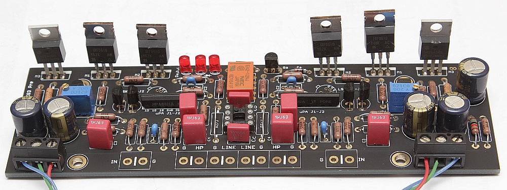

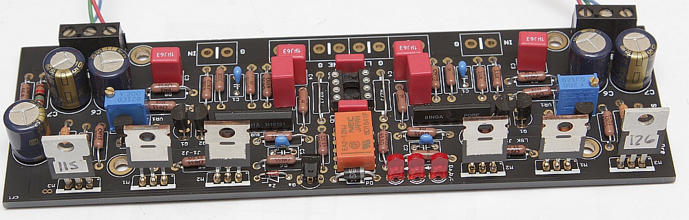

Help. I have completed my DCSBT and DCG3. DCSBT works like a champ 17.3vdc and 17.4vdc from the two outputs.

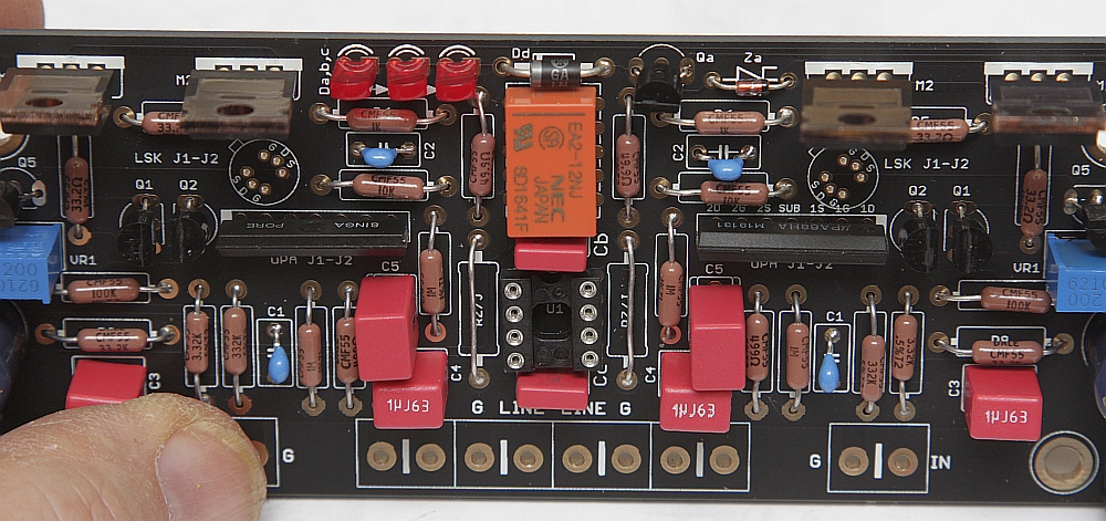

DCG3 not so good. What is the problem appears to be on the left channel. If I power the right channel by itself after a few seconds the LEDs come on and I am able to set the offset.
I am using a light bulb on the AC side and when I connect the left channel with or without the right channel connected the bulb does not fully dim, so a problem somewhere.
I have checked location and values of all passive components and removed the transistors and checked them. Everything seems to be ok.
I am stumped. Obviously I am missing something.
I was concerned maybe I didn't mount the J1-J2 properly. But looking at photos of other builds I believe I have it installed correctly. This is the one device I have not removed to test. Perhaps it is not working?
Any thoughts or guidance appreciated.
David

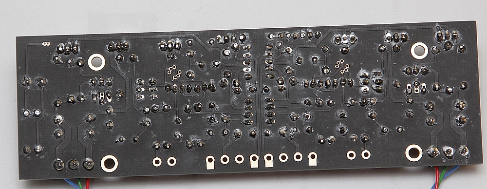

I did do a reflow on the entire board. Same problem, powering both channels results in the bulb test staying bright. Powered separately no problem. Both R10s are still in the 1.24v range. VR1 has no effect on the offset for the left channel.

Did you remember to follow the guide ?(short the input's to GND, when trying setting offset and so)
Not to sound ugly or like, but i really must tell you should have been a little more carefull soldering, and placing youre part's straight on line if you know what i mean.

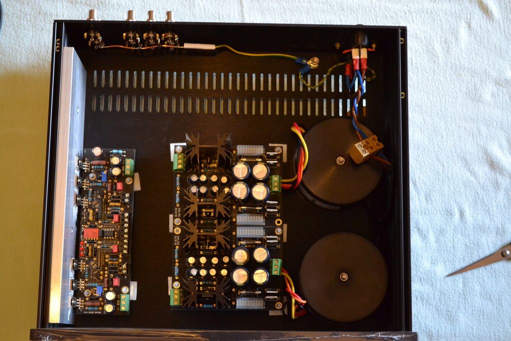

My DCG3 is now well on it's way to being cased in a chassis from Modushop and is sounding excellent; so much so that I think my VTA SP14 valve pre is in a sweat thinking that it has met it's match or even superceded😉
Salas I must owe you a whole raft of drinks by now what with the DCB1;various power supplies and now the DCG3 all enhancing my listening pleasure over the past few years; so a huge thank you from me :cheers:
So, you have two transformers and two DCSTB. Right? When you power up any one channel with one DCSTB no problem. When you power up both channels with both DCSTB there is a problem. Right?
If I got the breakdown well, then some short must be existing between the two power sides. If you look up close the relay and IC socket pins solder joints which are the busiest places, is there any solder bridge? Or anywhere else for that matter, like at the trimmers, at the small transistors, etc?
When much current seems to be drawn, measure the Vgs of both sides Mosfets and compare the readings. Also the voltage drops across Q1, Q2, R3. Are they comparable? Maybe a small transistor is shorted?
