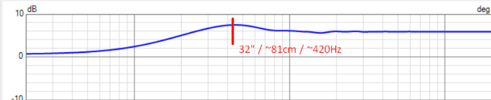

Its all relation between wavelength and the object. All frequencies diffract at an edge they interact, it is just that on a loudspeaker like this highs don't reach the edge as the transducer beams. Low enough lows (bigger than the baffle) just wrap around / diffract enough in phase with direct sound so that not much interference "ripple" is seen in axial response. Only the hump around where wavelength roughly equals baffle width which seems to make constructive interference with direct sound. Above the hump all kinds of ripple show up until the driver beams. This means roughly wavelengths between baffle width and driver diameter would be the ones that produce "ripple" seen in axial frequency response. I have to say there is not much seen here on your example dimensions and with the simple baffle sim, it works out nicely being asymmetric enough spreading the diffraction in time
I'm starting to see your point but I think I just confused myself....Is bafflestep an unavoidable trait?
I'm guessing that it is outside of infinite baffle and no baffle, So whether it is up high or down low, is neither here nor there? I mean that a really narrow or really wide baffle seem to be the answer with intentions of keeping it out of the middle of the passband. In particular I would say above 7000 and below 700. Edge treatment gets rid of just the issues of diffraction issues (ripples and time delay issues) ? The wider baffle provides more direct energy, which is why I personally wanted a wider baffle.
"Low enough lows (bigger than the baffle) just wrap around / diffract enough in phase with direct sound so that not much interference "ripple" is seen in axial response. Only the hump around where wavelength roughly equals baffle width which seems to make constructive interference with direct sound. Above the hump all kinds of ripple show up until the driver beams"
This wide baffle has no ripples... that I have ever seen in a sim, at least.
With big enough baffle this could be count in milliseconds. If there is no baffle the situation is as good as it gets, delay would be about the same as with naked transducer which you cannot better / do nothing about because there has to be one, with some physical size. The other way is to make infinite baffle, or infinite enough, where there is no edge to interact with within certain amount of milliseconds. We gotta remember in a room there are many objects the sound diffracts and we need to fit the speakers into the room. In-wall is closest thing to infinite baffle.
Milliseconds needs to be in perspective to frequency, and at a lower frequency a larger time smear of a few milliseconds doesn't mean much in a room. So I guess the question is...how many milliseconds? Or are we acknowledging that a wide enough baffle is optimal?
Infinite baffle has no edge to interact with, but then you say here "path length along the baffle just "smears" the direct sound" So infinite baffle has max direct energy smear.....This is bad? or just different.
I'm not trying to say there is an "issue" but there is a difference in the directivity
The change in directivity is the transition of the FR above and below baffle step....
Baffle edge creates the earliest one so there is good reason to mind about it, either make it very short delay by narrowing the baffle and crossing over before diffraction, or very long, or try and mitigate with big enough round overs.
OK I think I am seeing the picture now....and its pointing back to keeping bafflestep away from some arbitrary point.
looking at post 70, my thoughts are" Oh, edge treatment can mitigate baffle step....but at a very wide baffle, this would be impractical due to the size of the edge treatment needed to be effective there?" Maybe I said that wrong....Edge treatment can remove the resonant note that occurs right before the baffle looses directivity is what I mean.

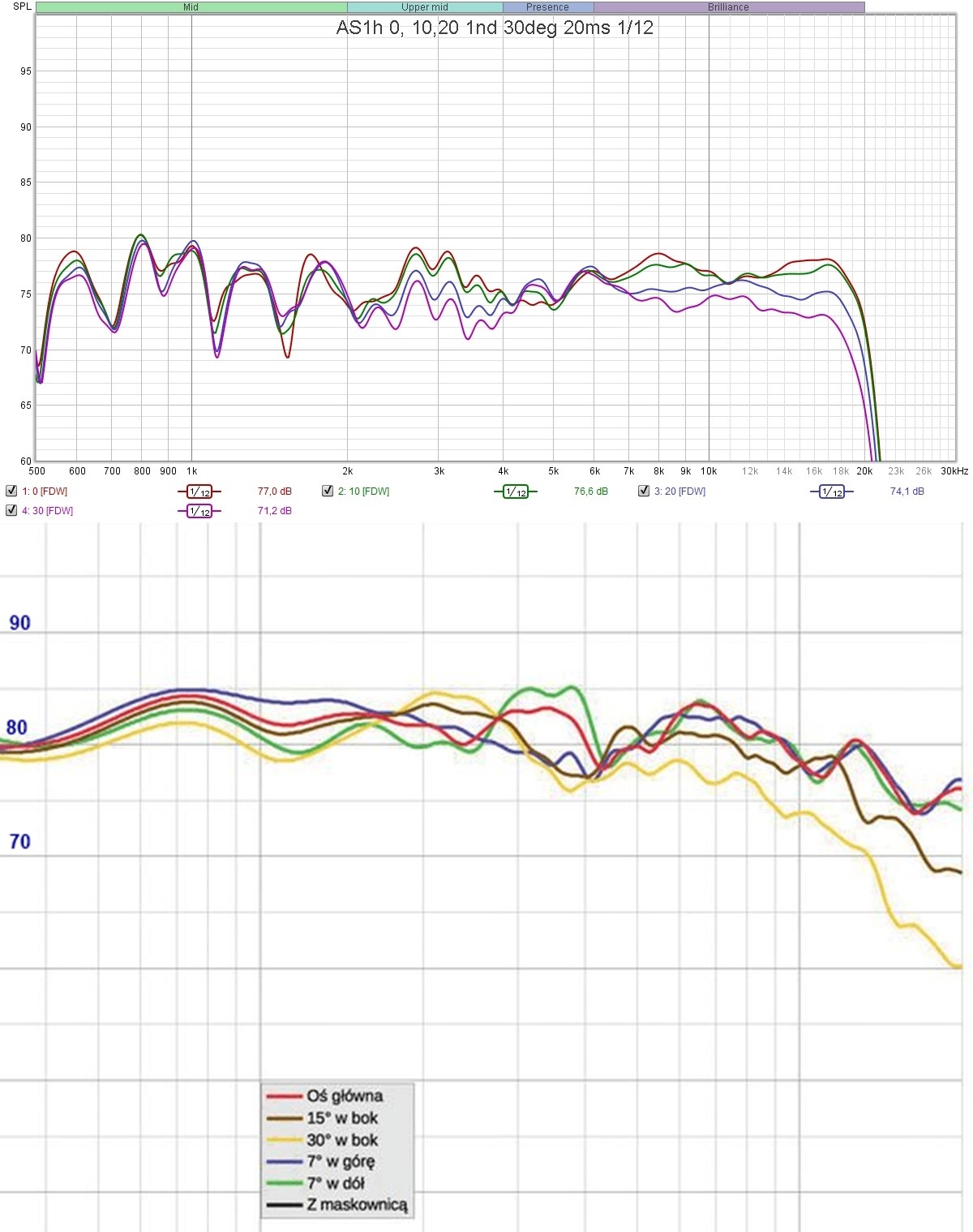

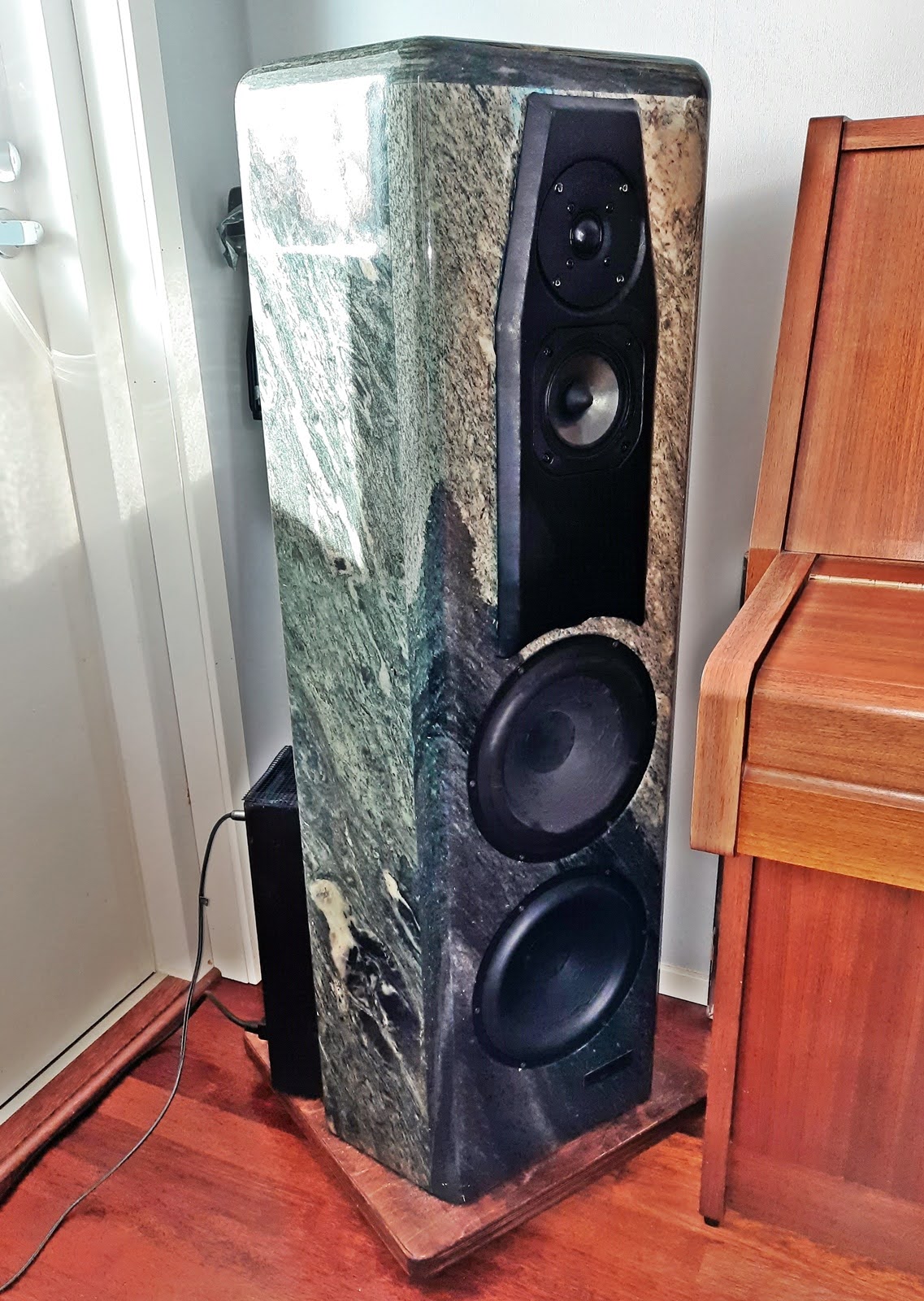

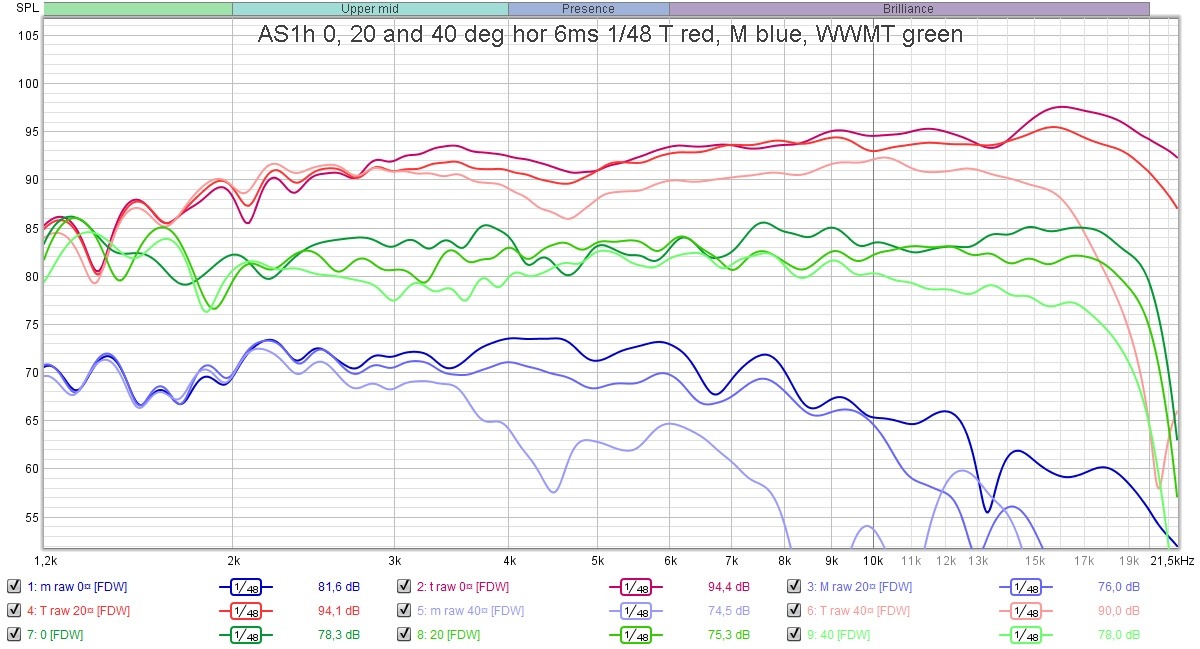

A practical example of edge diffraction mitigation...
Here is my latest project speaker's 0, 20 and 40deg horizontal measurements of tweeter and mid without eq and xo, and completed speaker with LR2@3500Hz. We can clearly see that in a finished speaker most diffraction irregularites will get mixed with midrange's directivity and xo/interference issues.
Box has pentagonal crossection, rounded edges and a trapezoidal ½" thick add-on baffle with 45¤ chamfered edges. So pretty much everything possible done to mitigate diffractions...
