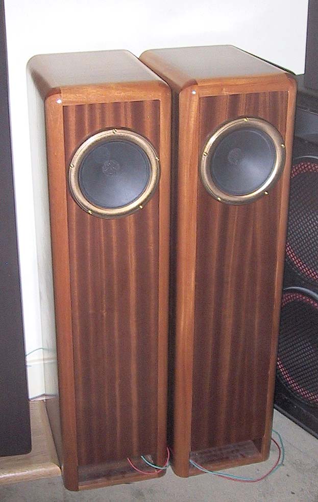

You seem to have a well equipped shop and while your tests will be interesting, I'm stuck on your statement about being easier to veneer. Why veneer a roundover, or your bevels, as opposed to using solid wood? With a reasonable width, and proper orientation, isn't going to have enough movement to stress joints. Just curious ...Hello,

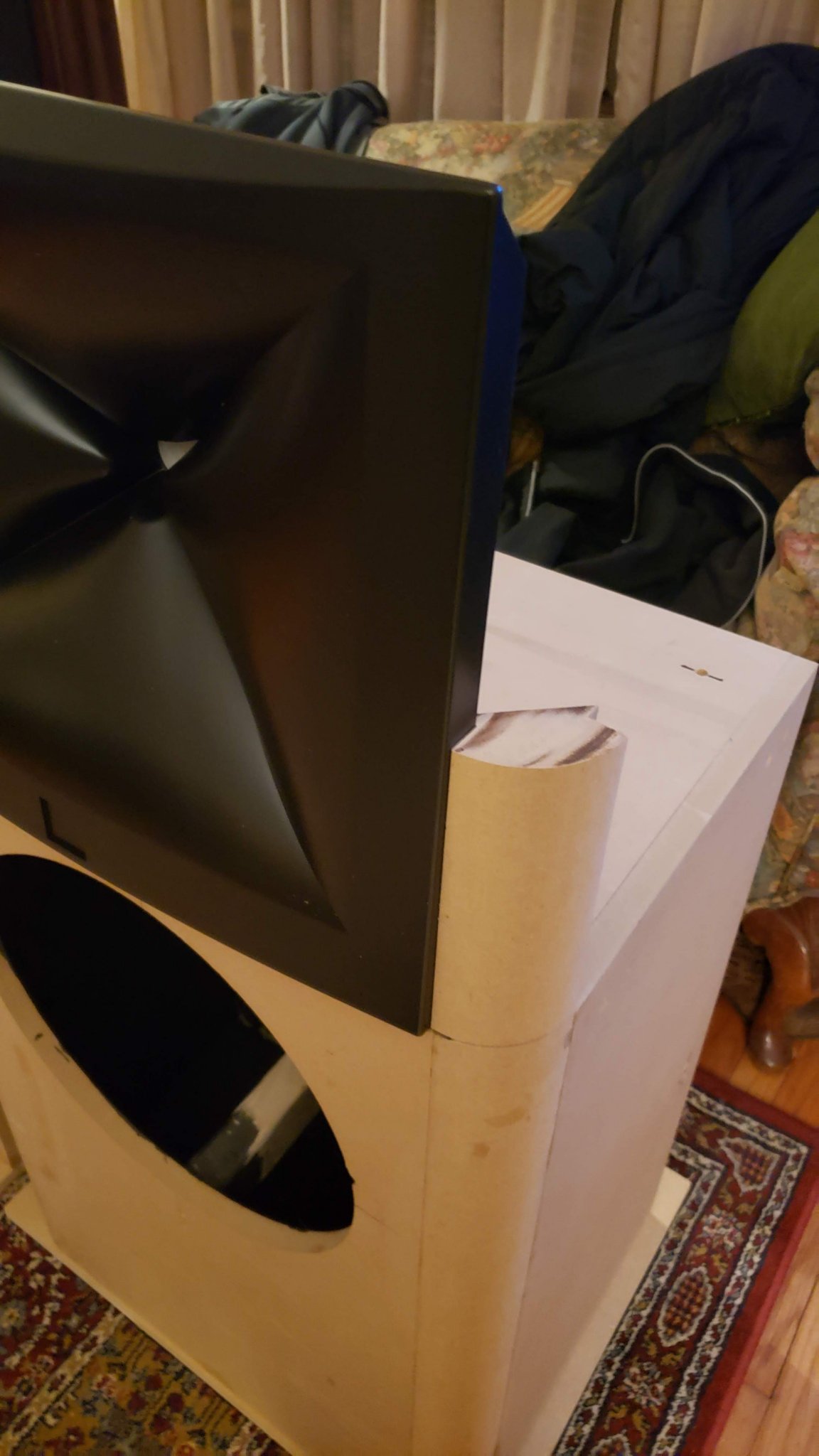

I have always wondered how much difference there was between a roundover and a 45° chamfer. Jeff Bagby once told me to treat a chamfer as a roundover with modeling programs that didn't specifically list chamfer as an edge option.
An edge treatment I have not seen is a double 22.5° bevel, it would seem to be similar to a roundover, but not require a big expensive roundover bit or be hard to veneer.
While various modeling programs allow different sized roundovers and show specific angles, I have been curious to see the incremental difference in edge treatment size as a full range of off axis measurements.
Here are three test baffles that I will be testing incrementally larger edge treatments of roundover, 45° chamfer and double 22.5° bevel with a full range of off axis measurements.
Test tweeter will be a Seas NoFerro 900.
Here are the blanks I will be testing on.

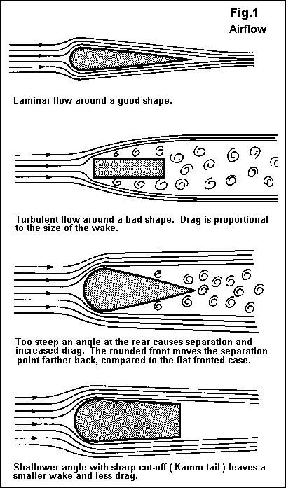

I have always wondered how much "diffraction of sound waves" is analogous to "aerodynamic eddies". The way I think of it is that, in the moment that a transducer travels outward, there is air pressure in front of it. Thag air under pressure bumps into the next air and so forth. IOW, a compressional wave has air movement. As that air molecule drags across an edge, eddies cause the air to move in other directions, producing a new compressional wave from that point in all directions, like a tiny little tweeter. Thinking about this way, it seems that for a monopole, a teardrop would be superior to a sphere, because the flow of air around the rear would be smoother. For a dipole, you'd want a large roundover on the sides so that air could pass from front to back without snags. (This was verified by the BG 75 experiments they did in a gym a few decades ago,, wish I had a link handy). I'm assuming that my way of understanding it is not correct. Or am I right?
Do you mean solid wood for the entire speaker or just the corners?
It is pretty but a PIA.Do you mean solid wood for the entire speaker or just the corners?
dave
Just the corners.Do you mean solid wood for the entire speaker or just the corners?
Although it is possible that aerodynamic (low drag) shapes might also be acoustically low diffraction shapes, the physics involved are so different that this similarity is really just coincidence. The analogy is very limited. I am speaking as an aerospace engineer.
An example of an aero shape being different from an acoustical shape is a convergent/divergent rocket nozzle... it may superficially look like a horn or waveguide, the actual shape is very different. This demonstrates the limit of the analogy
GM, no.. much different to that. A soundwave is not the same as an object moving through a fluid, it is not static flow. In any case, the goals are different.
Correct.
Sound is a wave phenomenon. The air particles are not moving across the shape, except for the minute microscopic motion caused by the tiny pressure variations that we call sound.
These are very handy and if available locally I would use it.These are 2" round corners I have used set to work with 3/4" material. They are easy to use and make for a very still baffle.
Rob
If painting it’s good, but If veneering, large round-overs it still leaves one with the same issues of finishing the cabinet.
Still harder than a cabinet with square or faceted edges; at the backyard/hobbyist level.
For serialised production of MDF based cabinets most small volume cabinet makers prefer to deal with pre-veneered MDF, and thus mitred joints.
Any true low diffraction cabinet seems to be very labour intensive. Eg. B&W or Vivid cabinet and/or need CNC…
I understand that the air movement is minute and microscopic, yet movement nonetheless. But if the physics is different, then I guess that settles it. Thank you very much for sharing your expertise. CraigAlthough it is possible that aerodynamic (low drag) shapes might also be acoustically low diffraction shapes, the physics involved are so different that this similarity is really just coincidence. The analogy is very limited. I am speaking as an aerospace engineer.
Correct.
