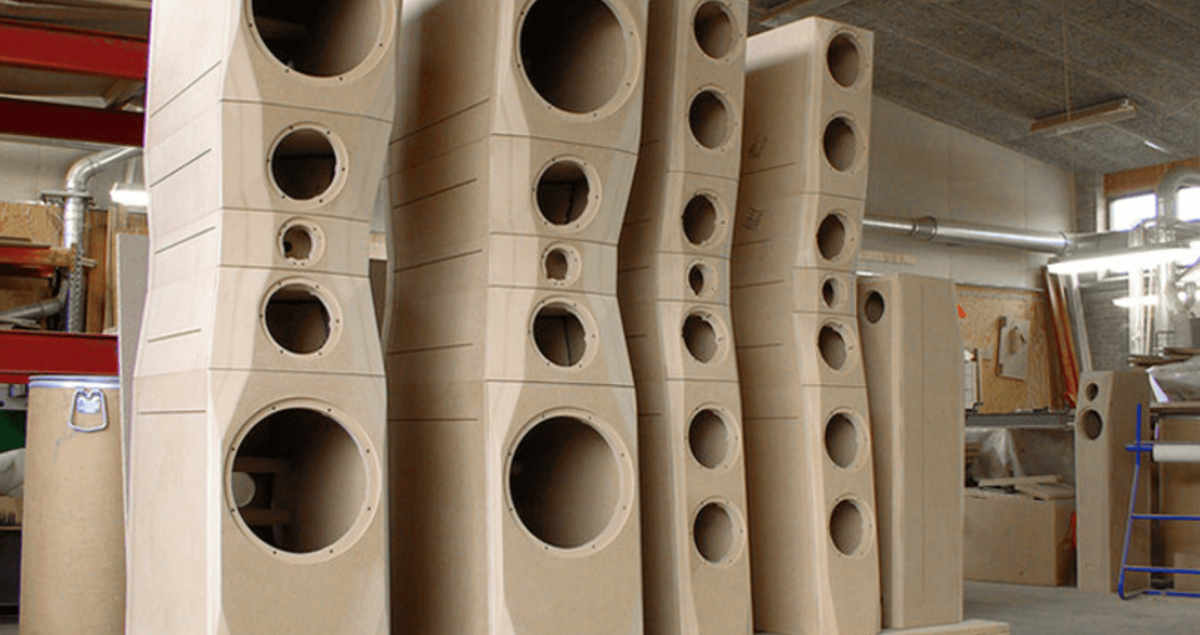

beautiful cabinets from Peak Consult back in the 90s
Still in business, these the sort of shape?

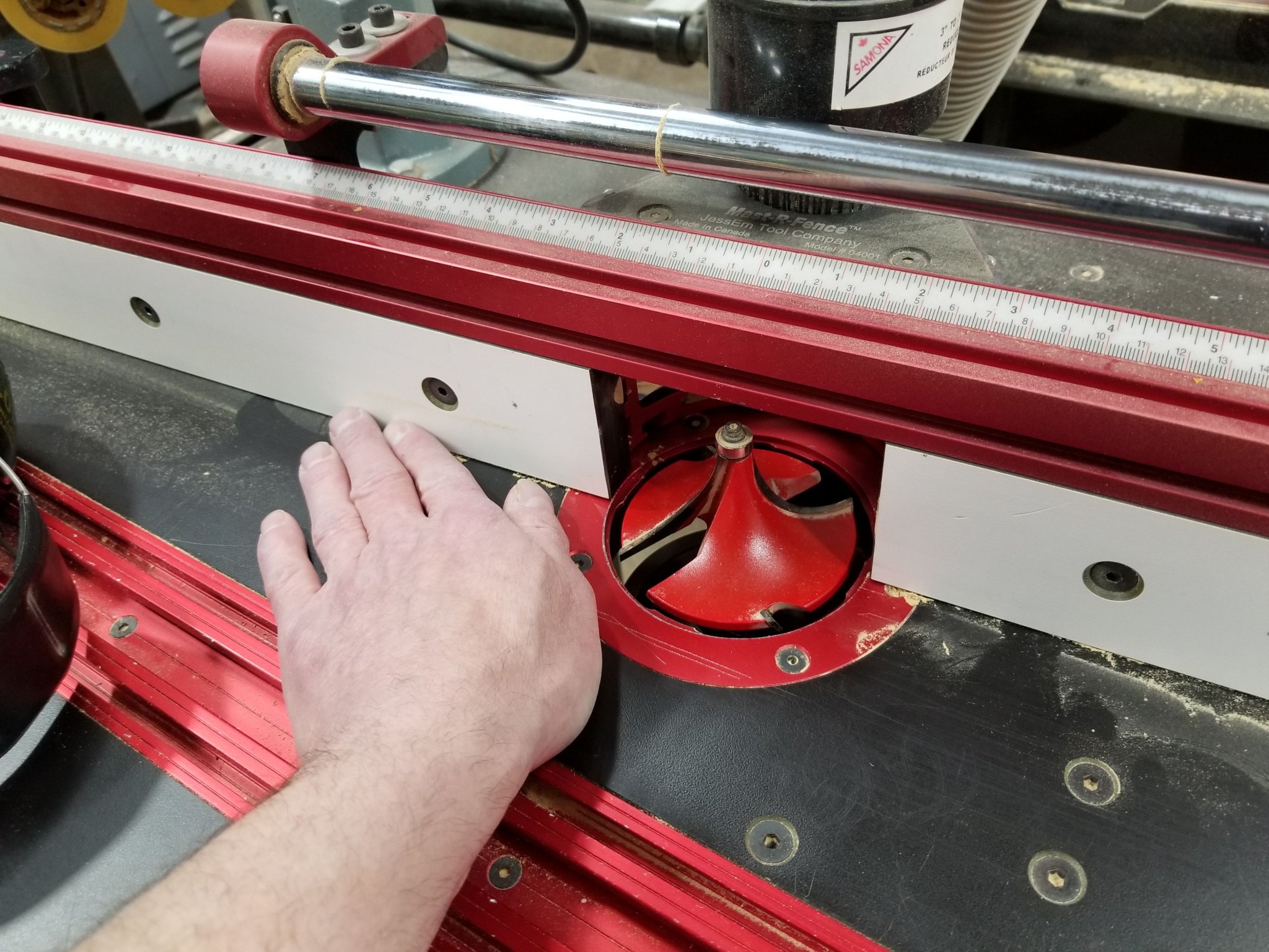

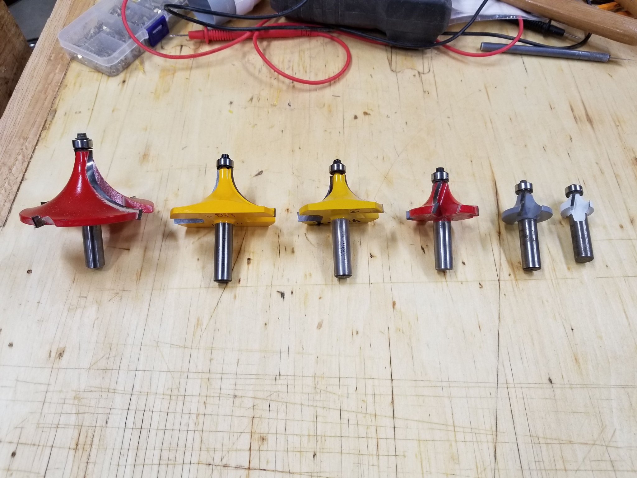

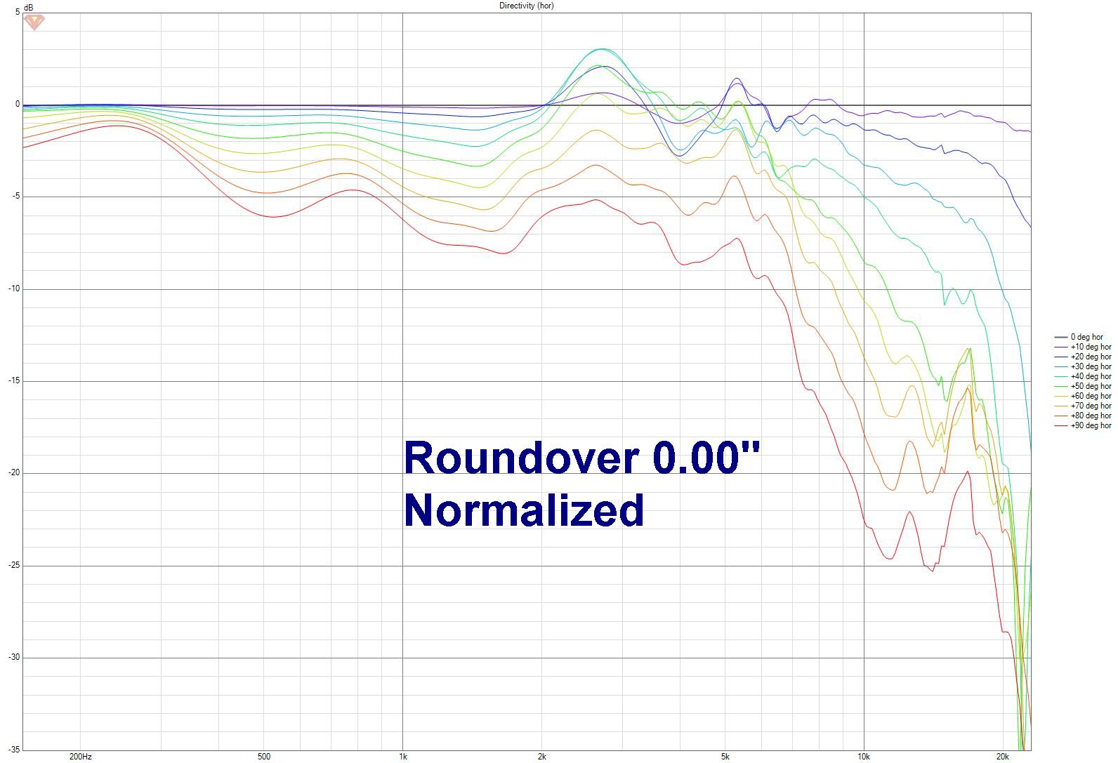

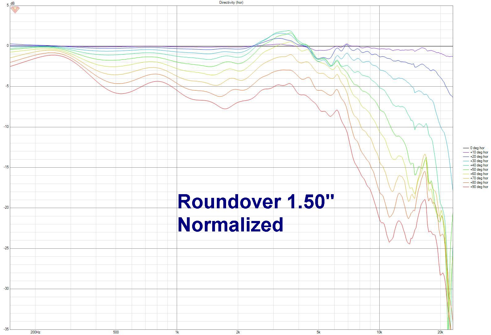

A selection of roundover bits.
1.5" Roundover bits are scary.

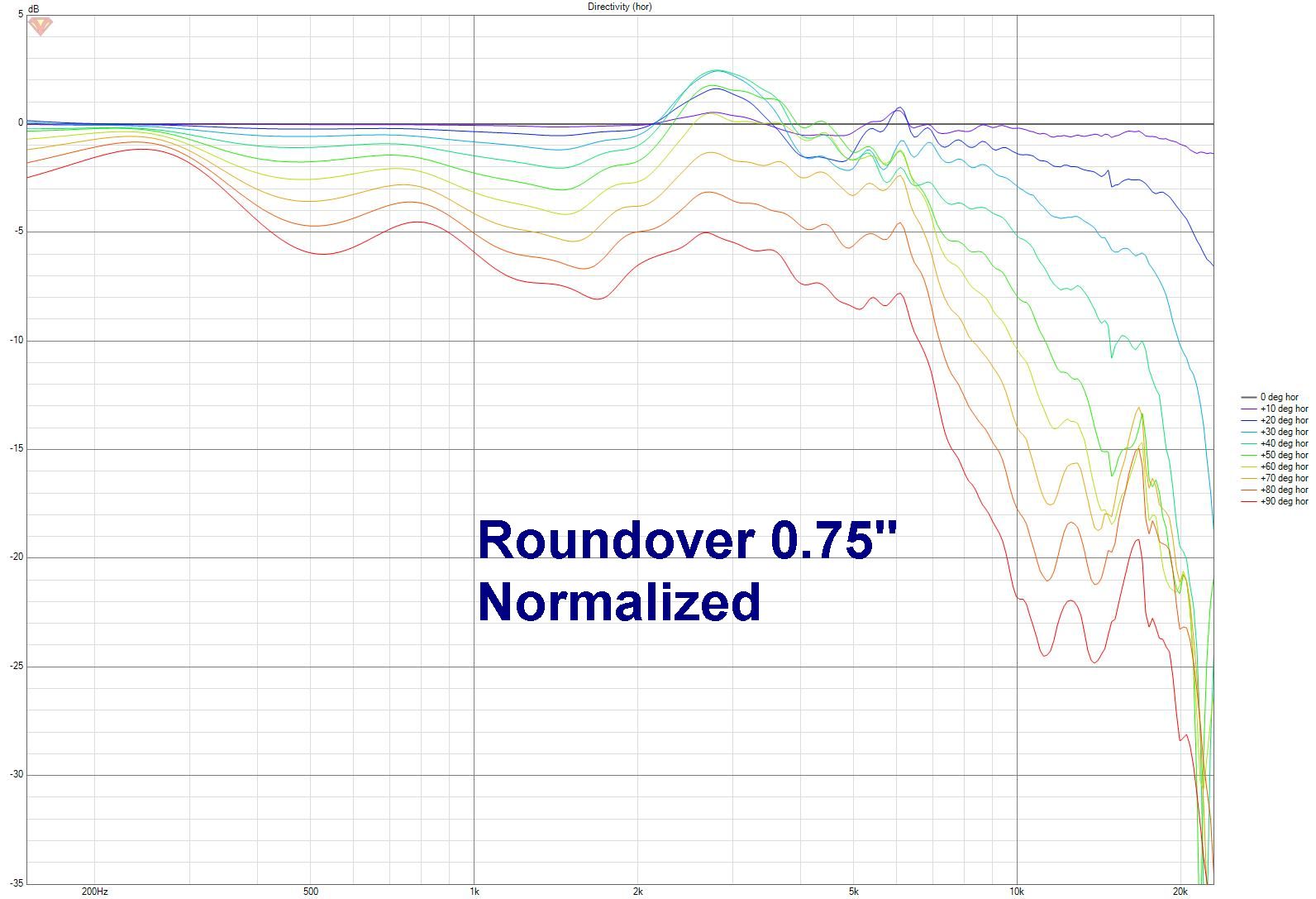

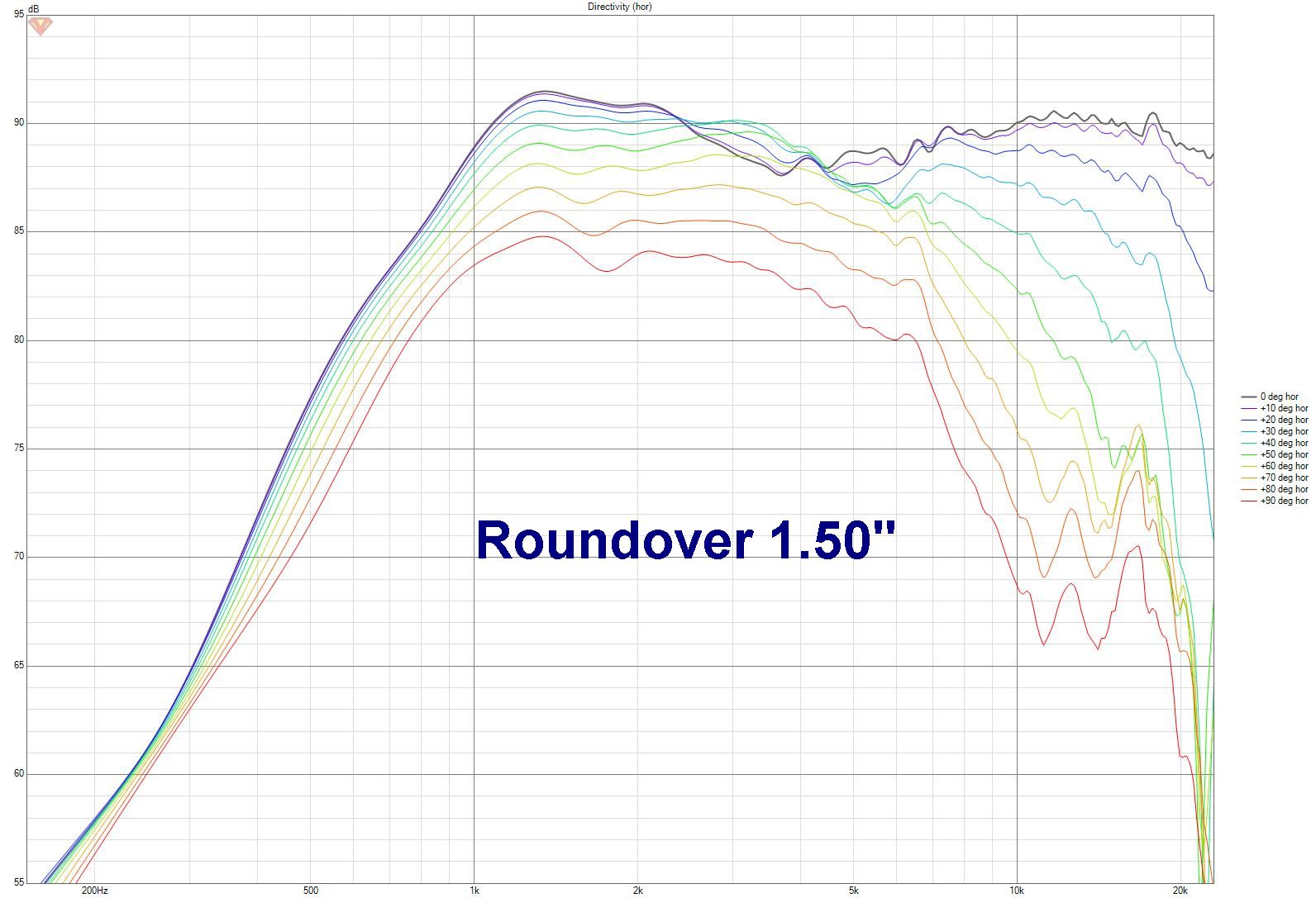

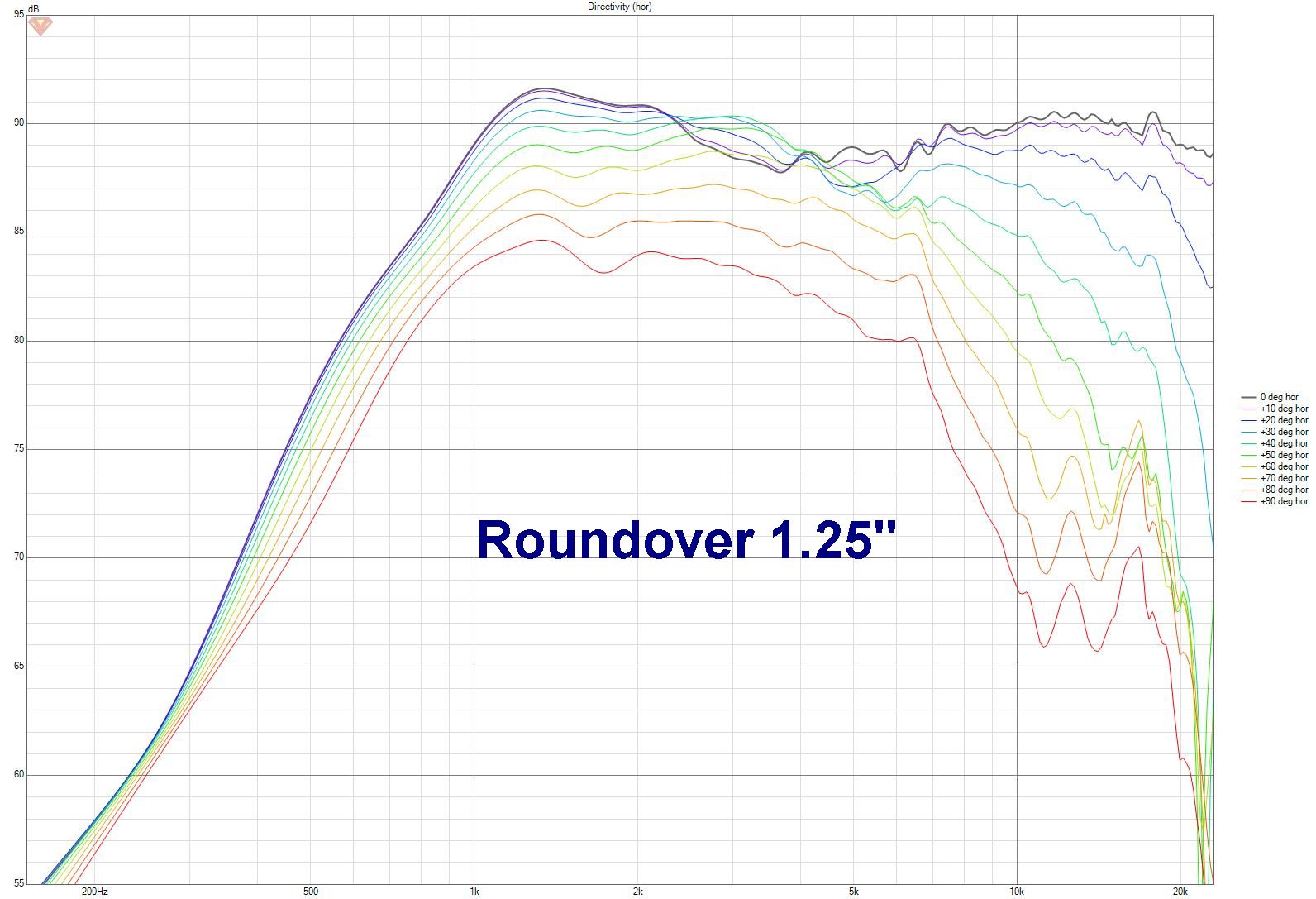

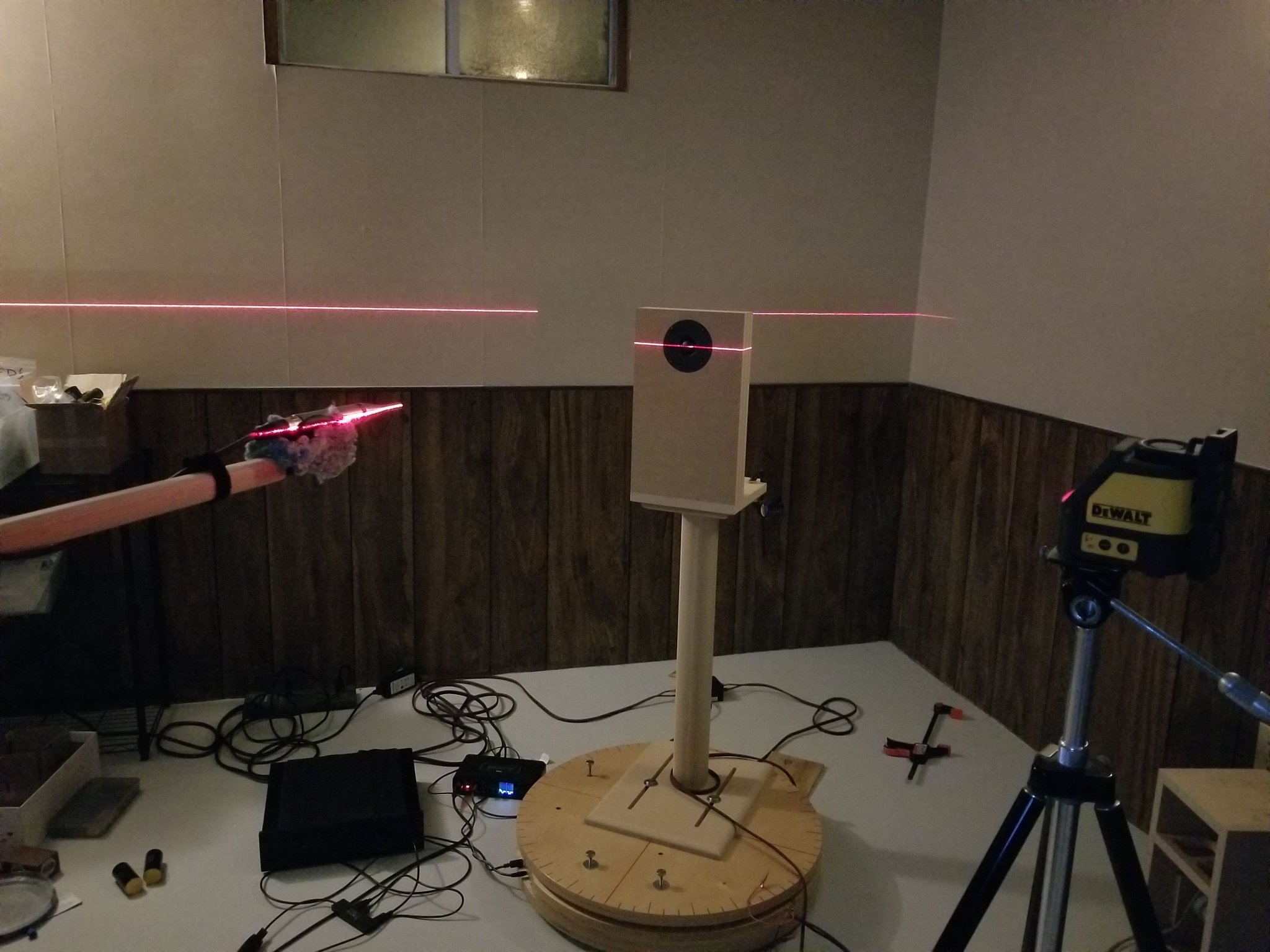

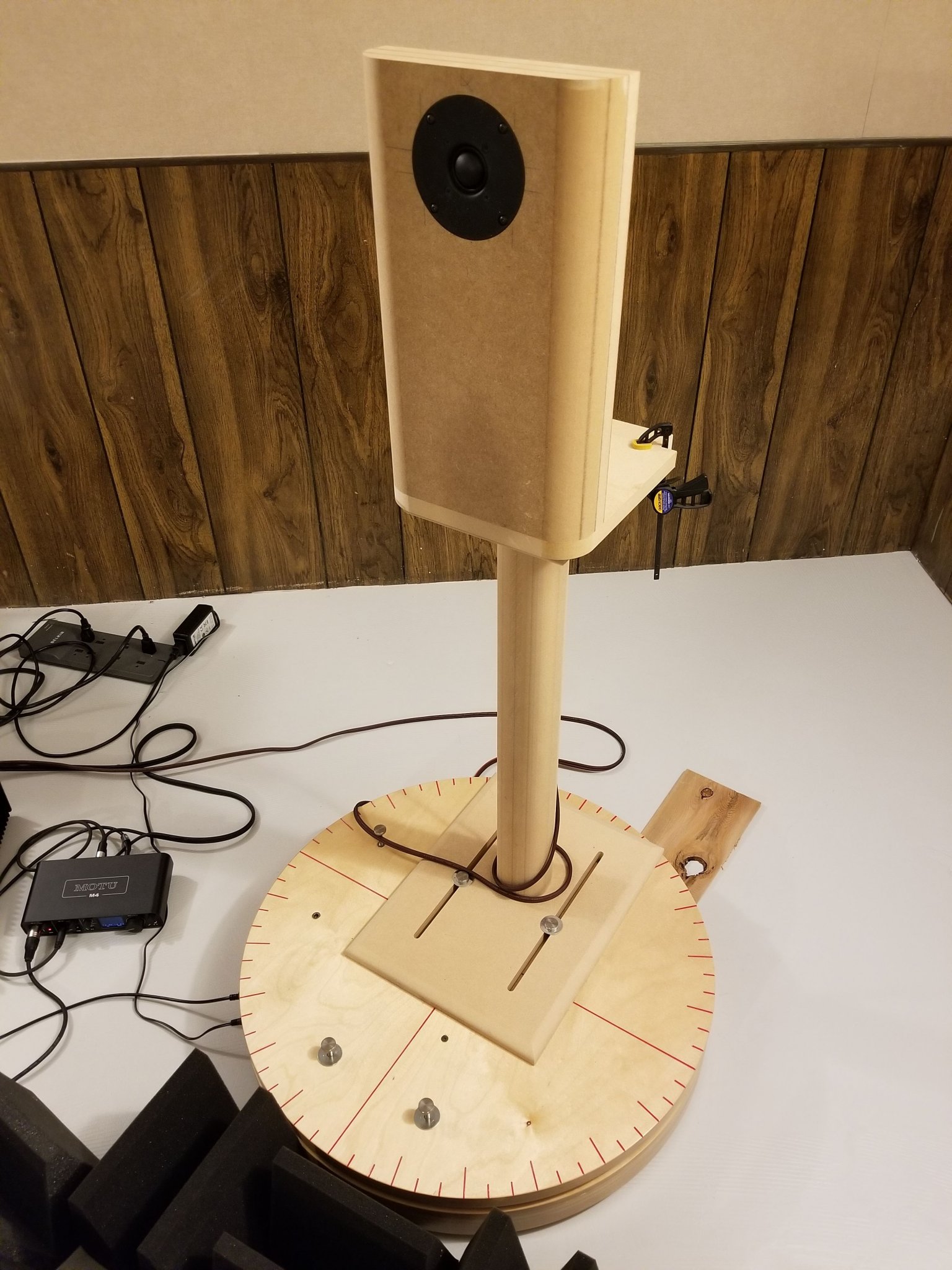

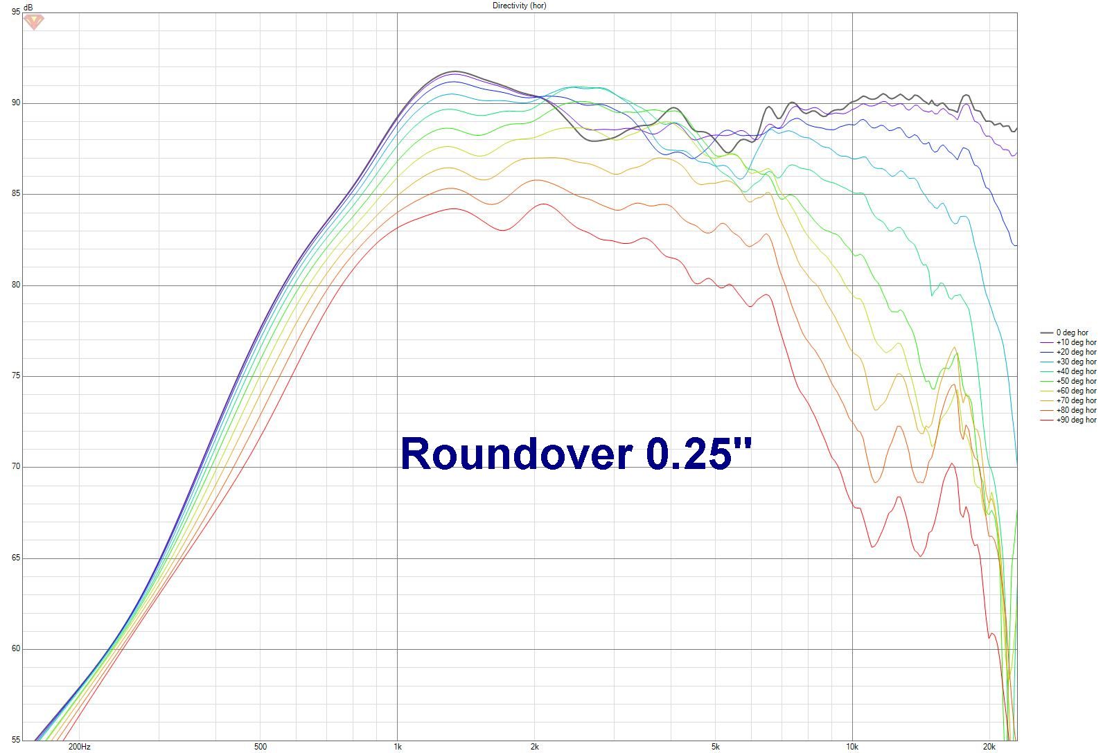

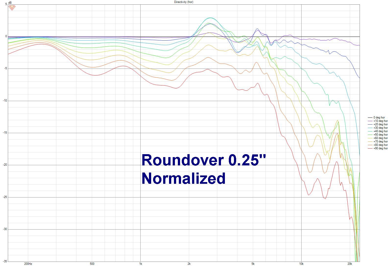

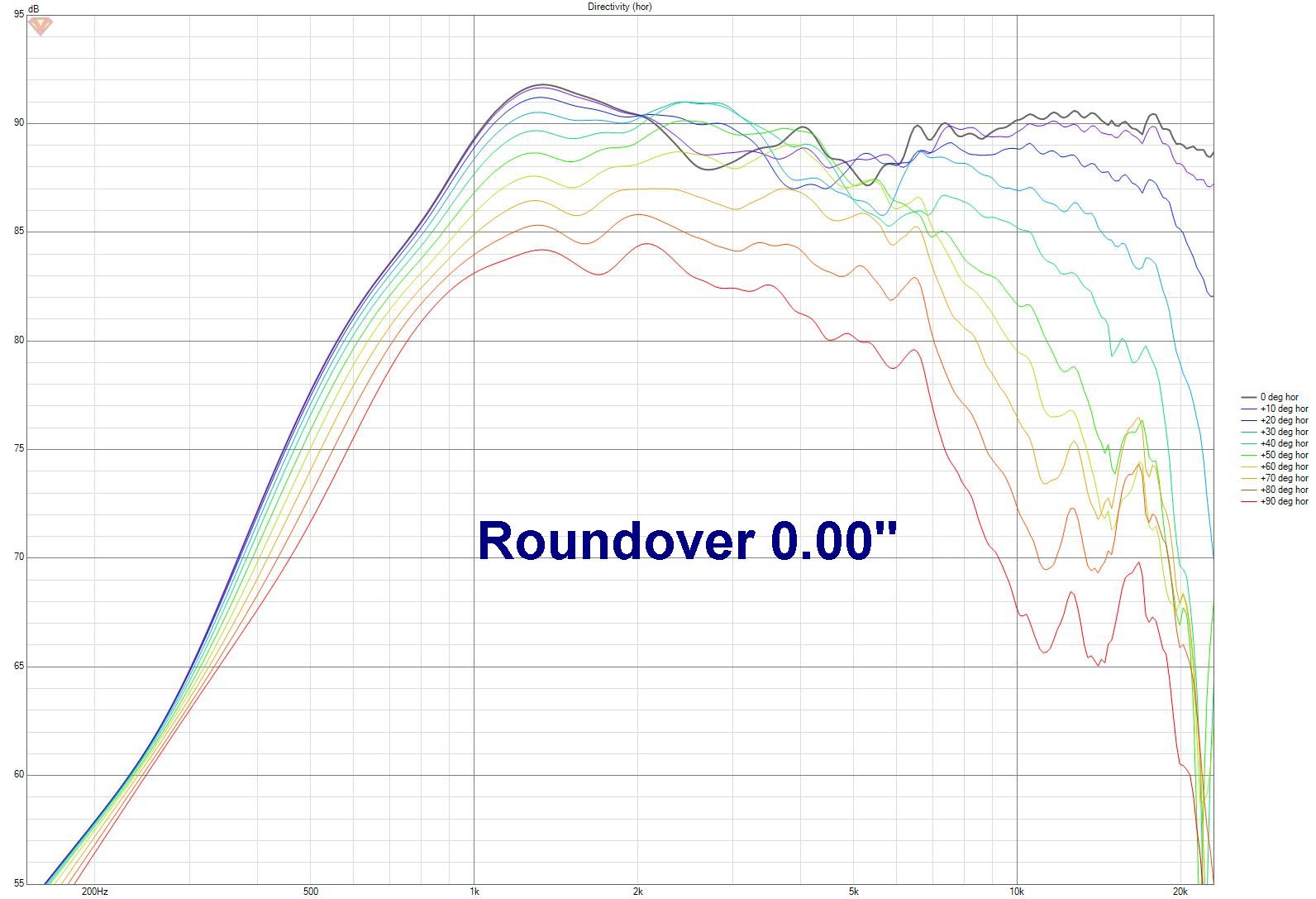

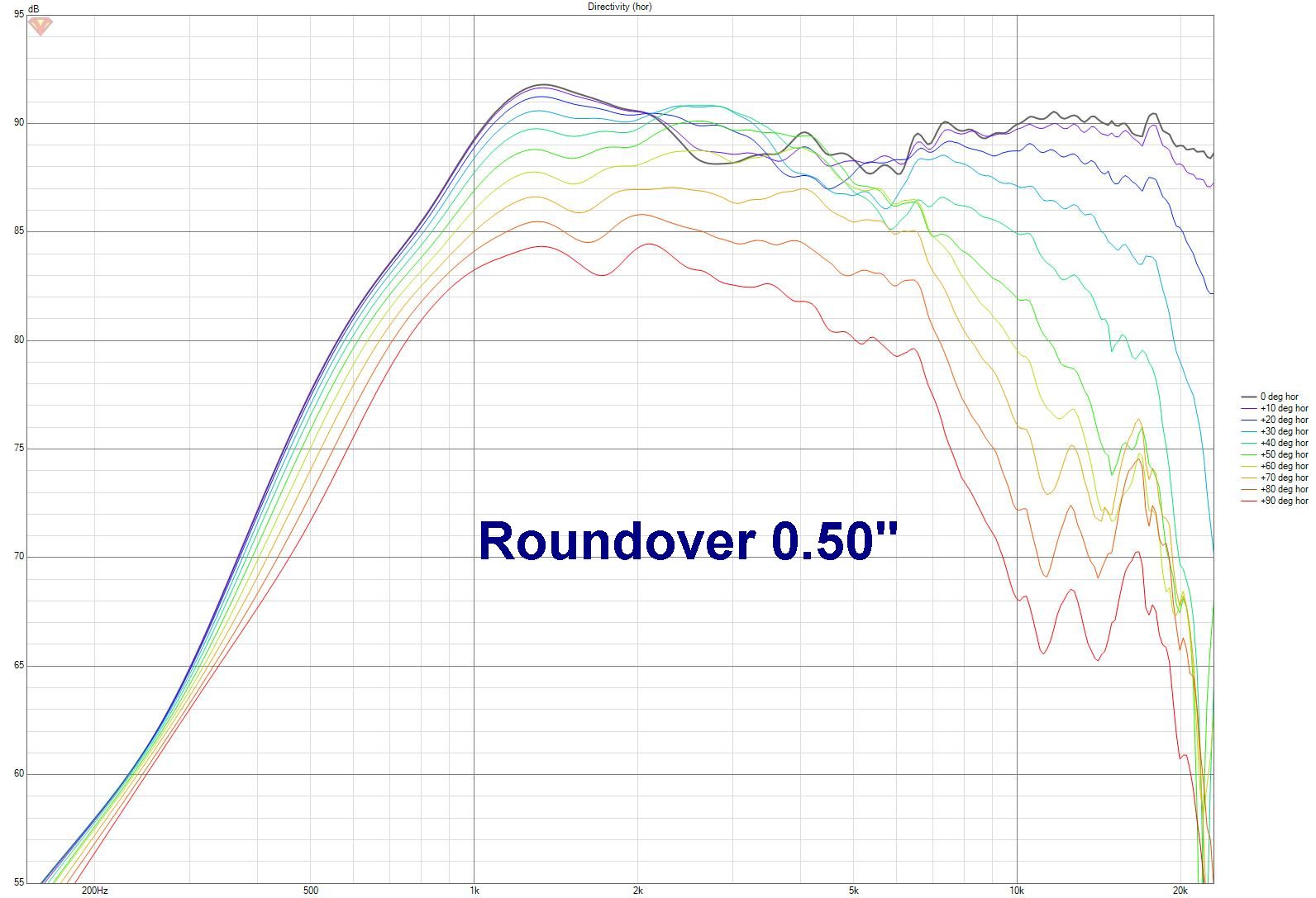

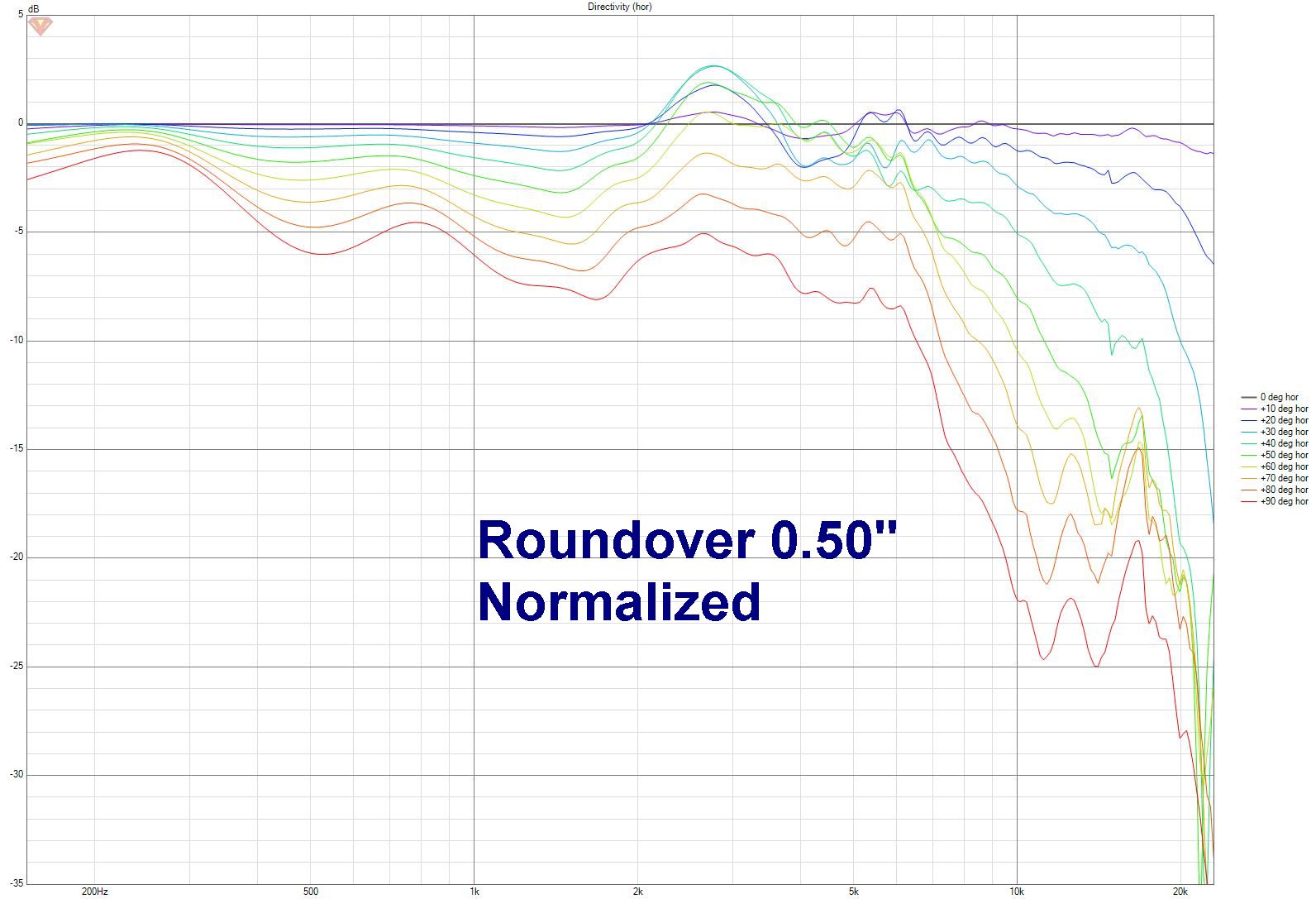

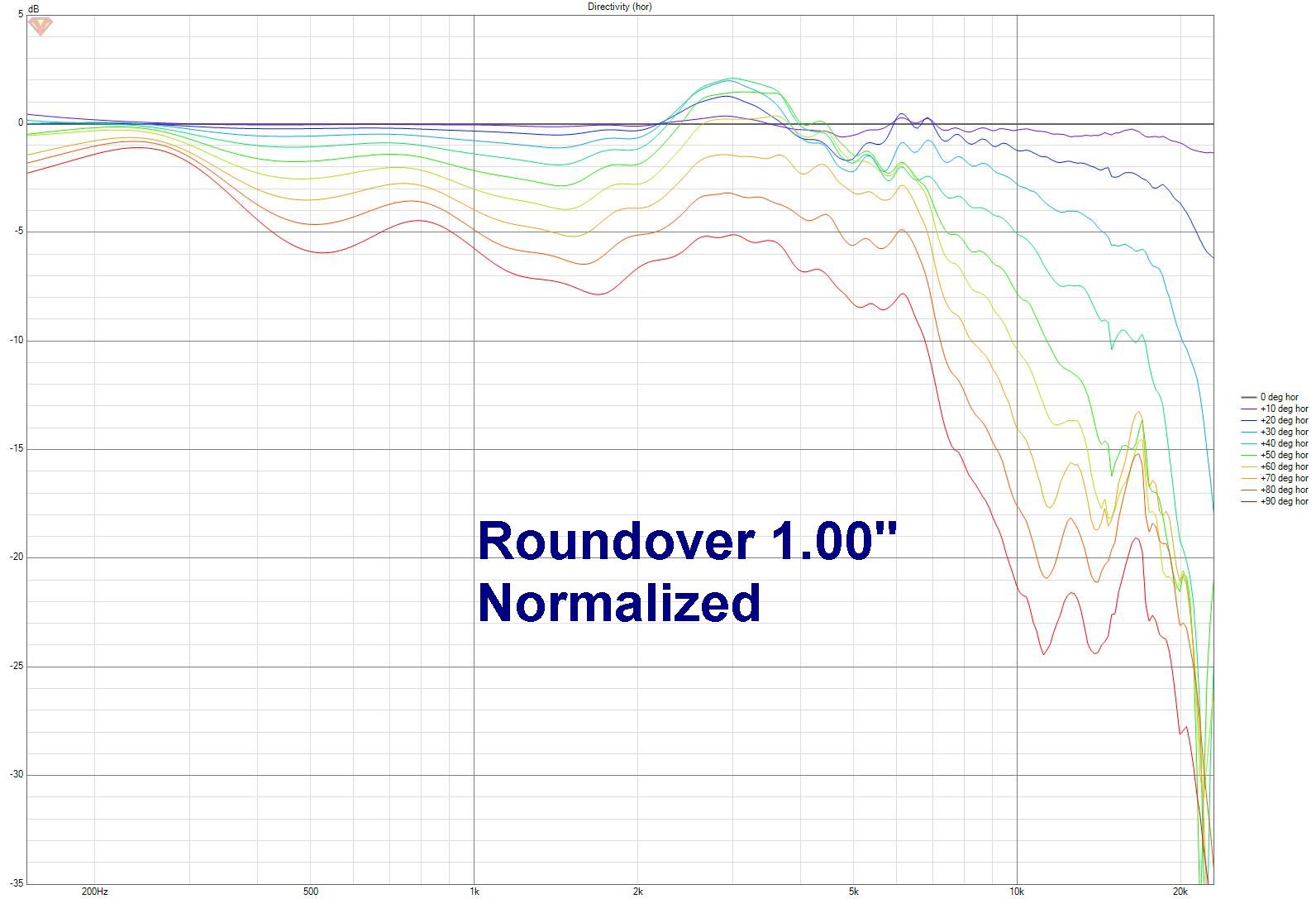

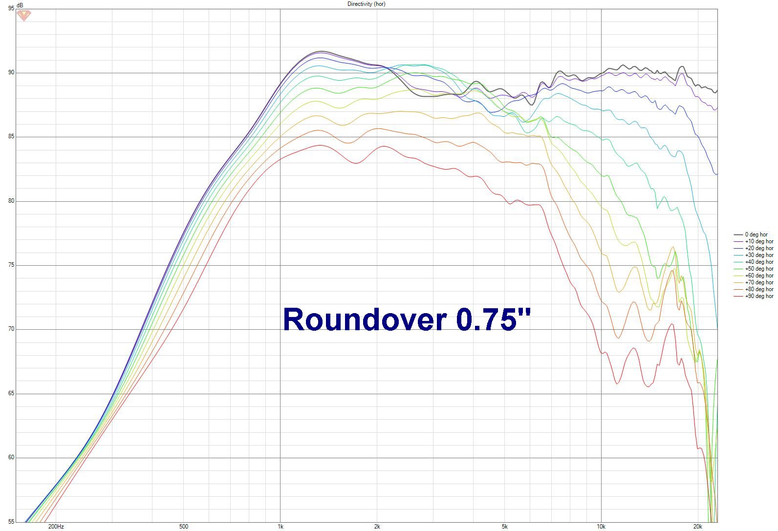

Roundover data,
Roundover data,

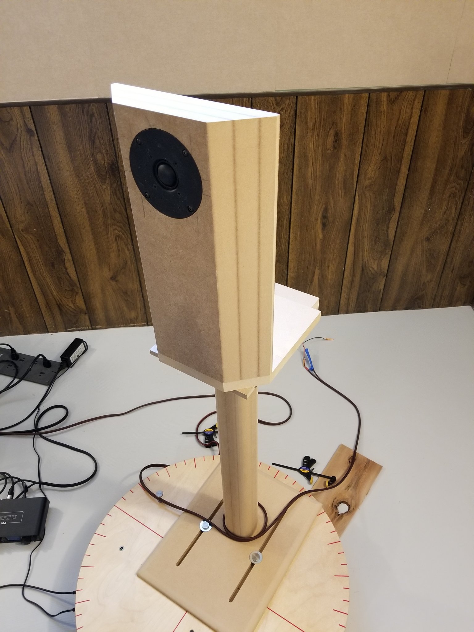

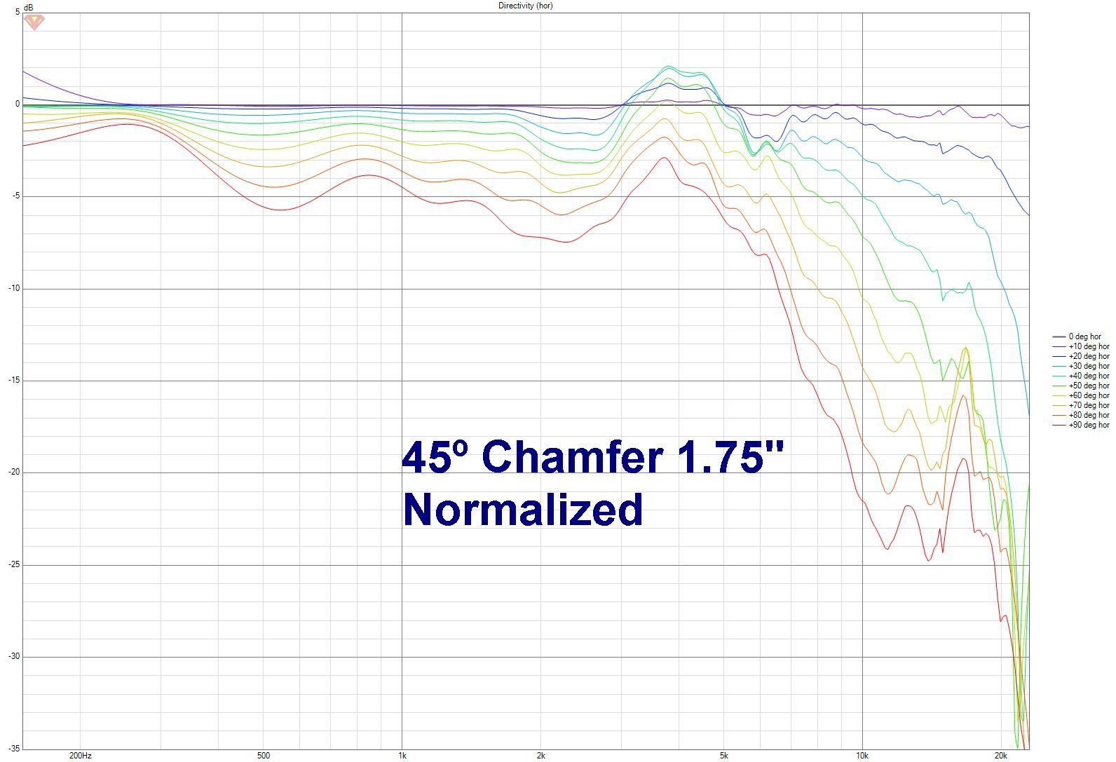

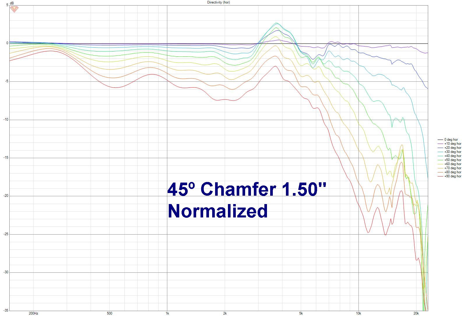

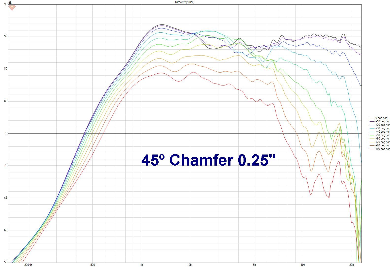

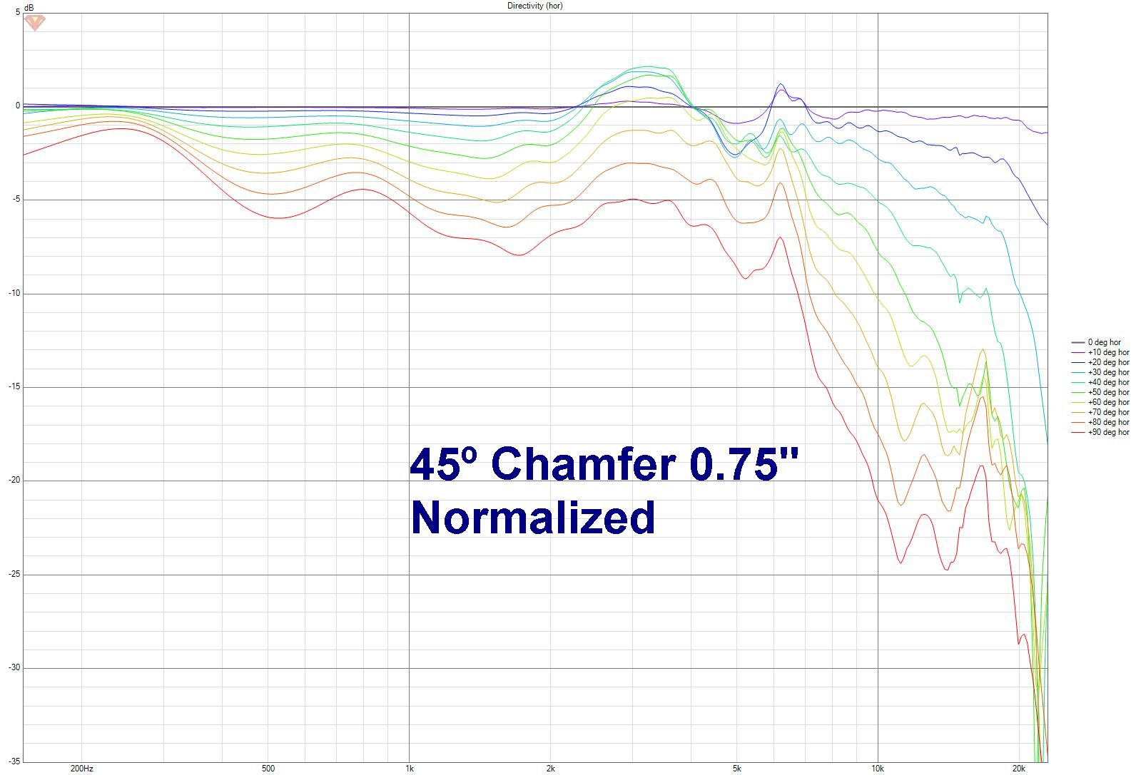

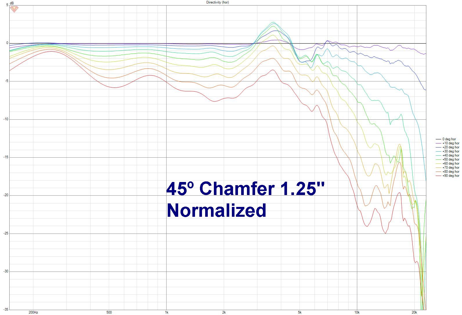

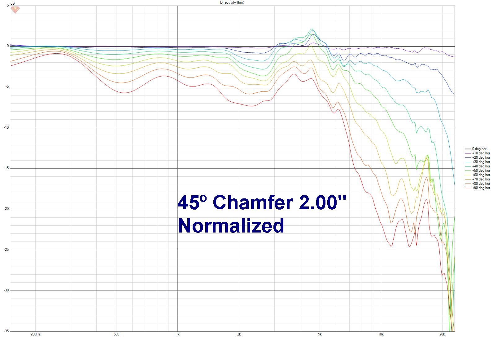

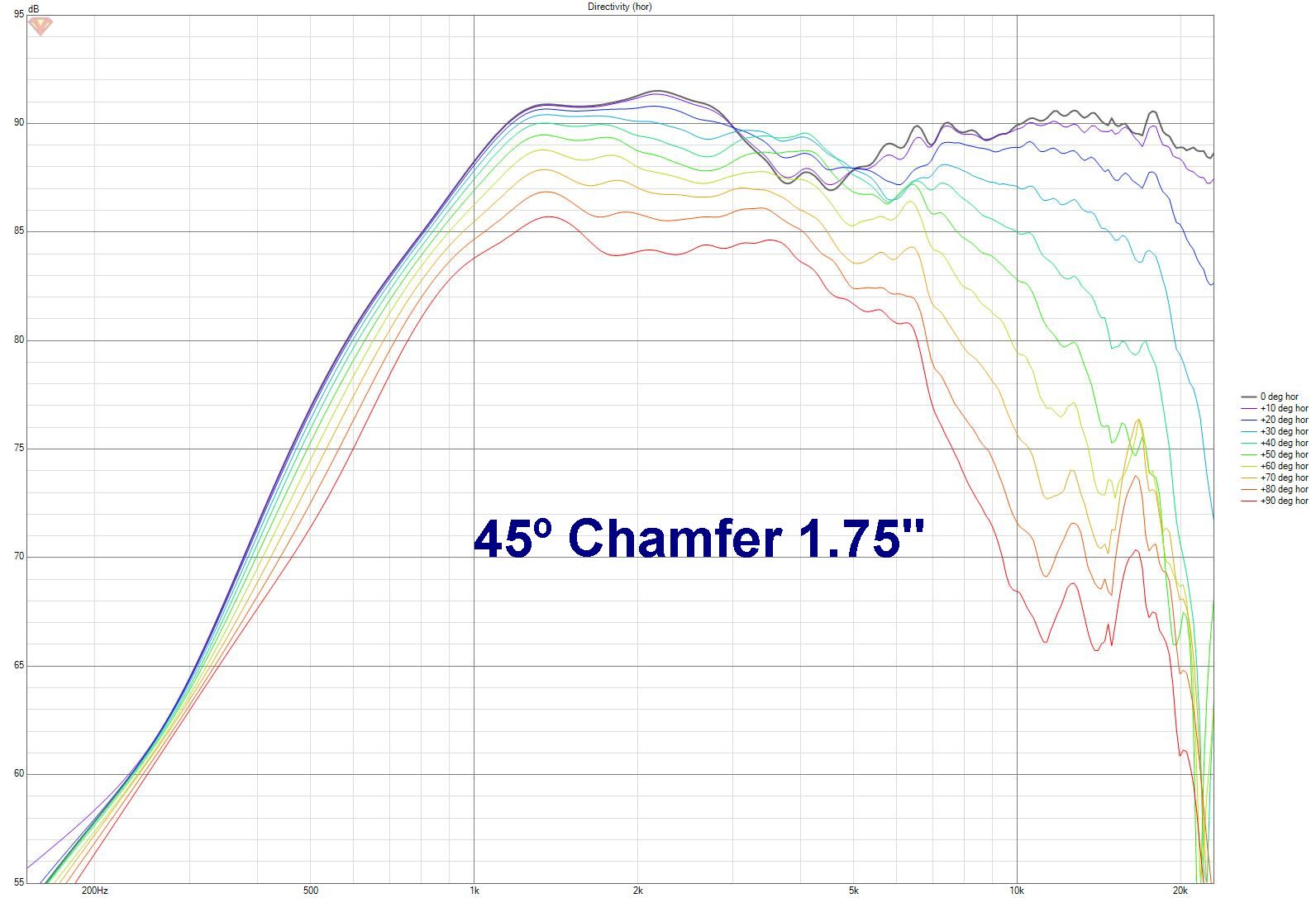

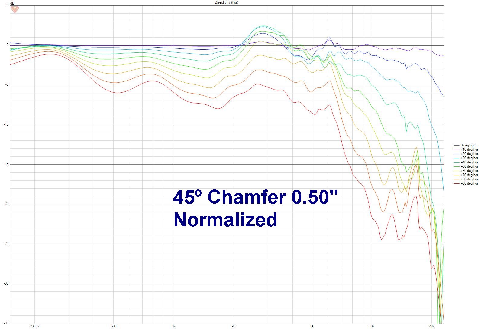

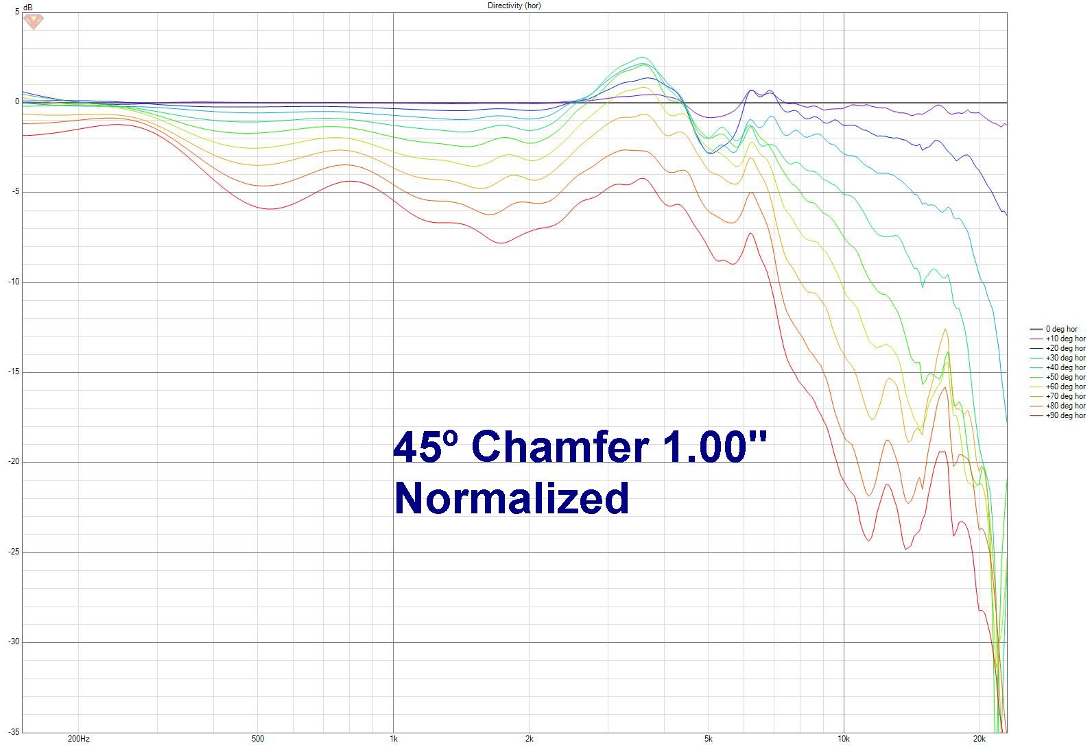

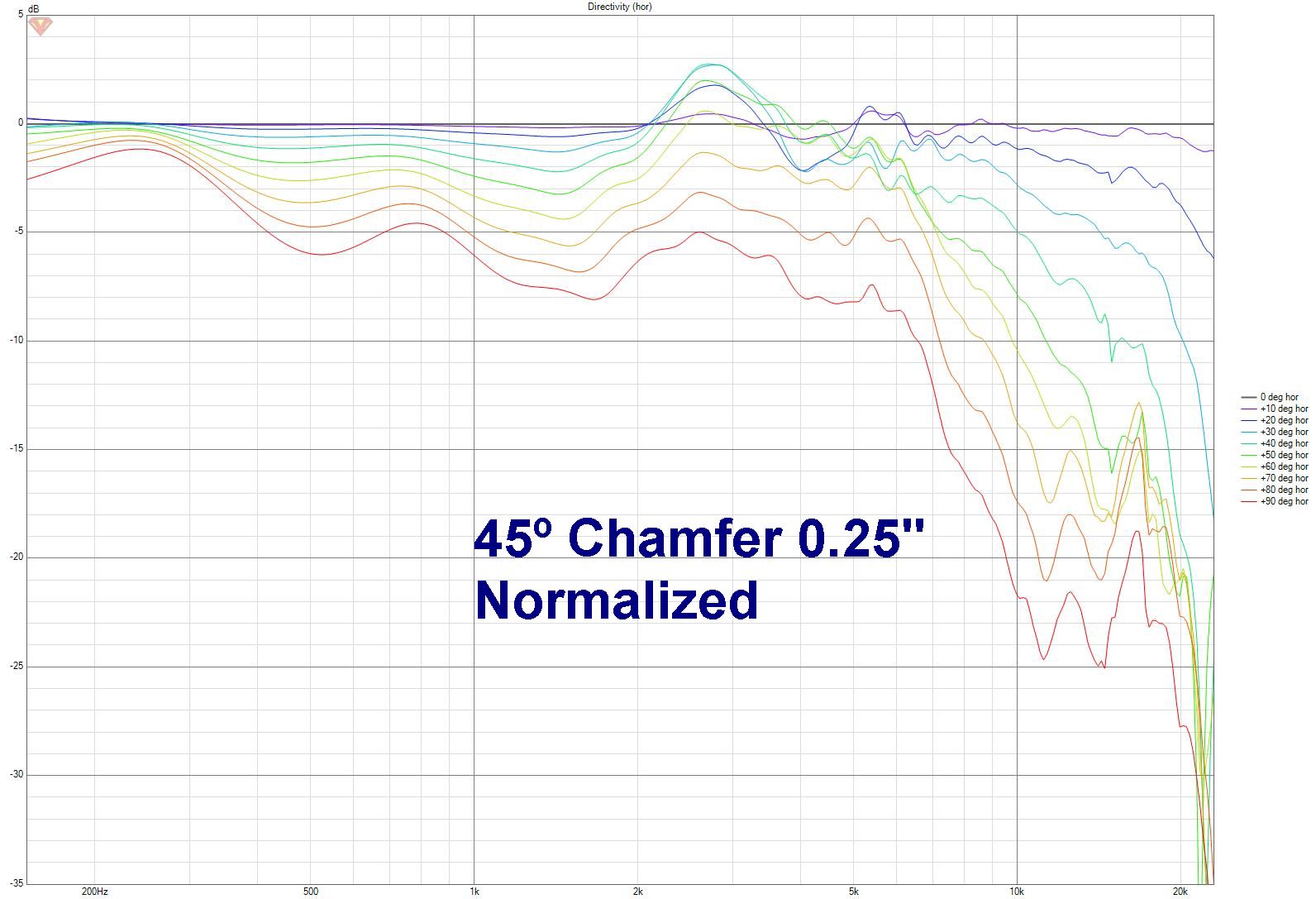

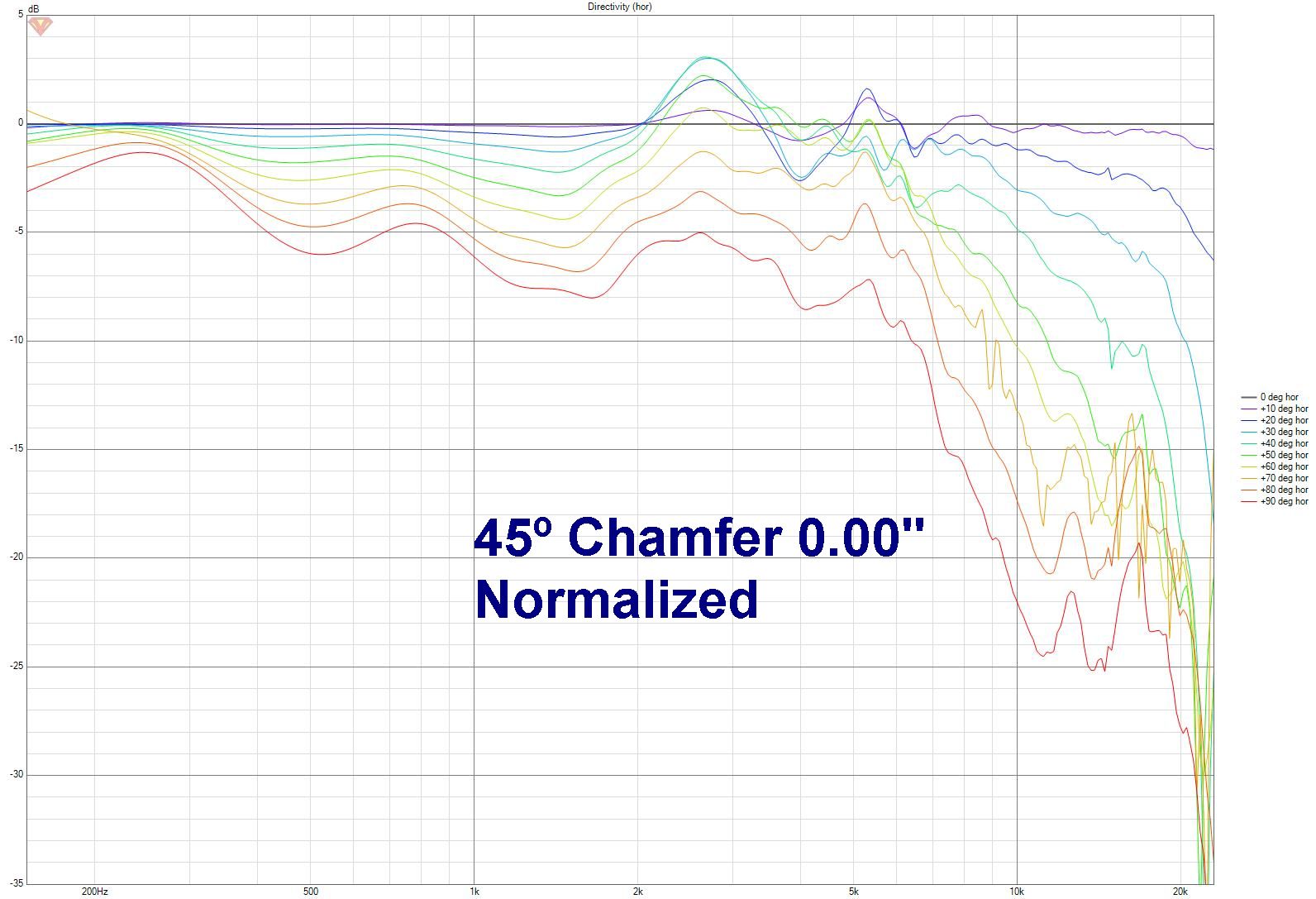

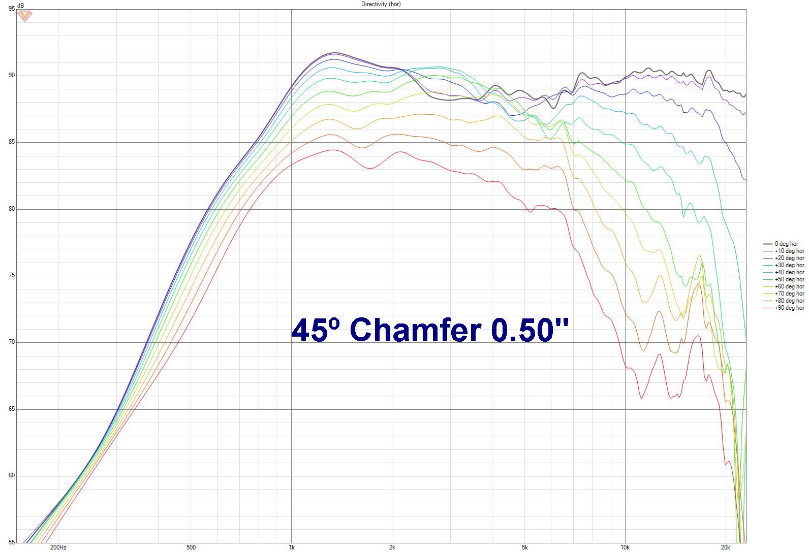

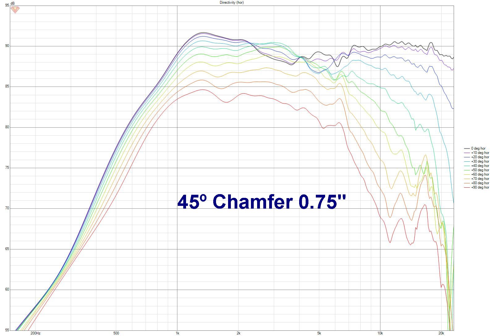

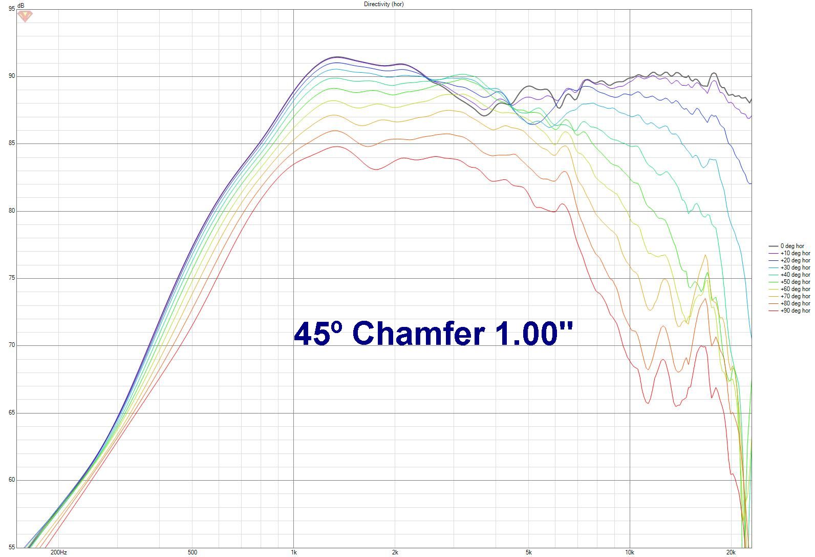

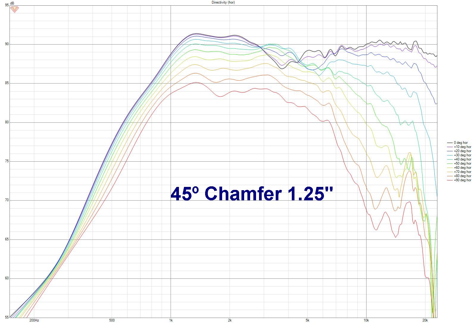

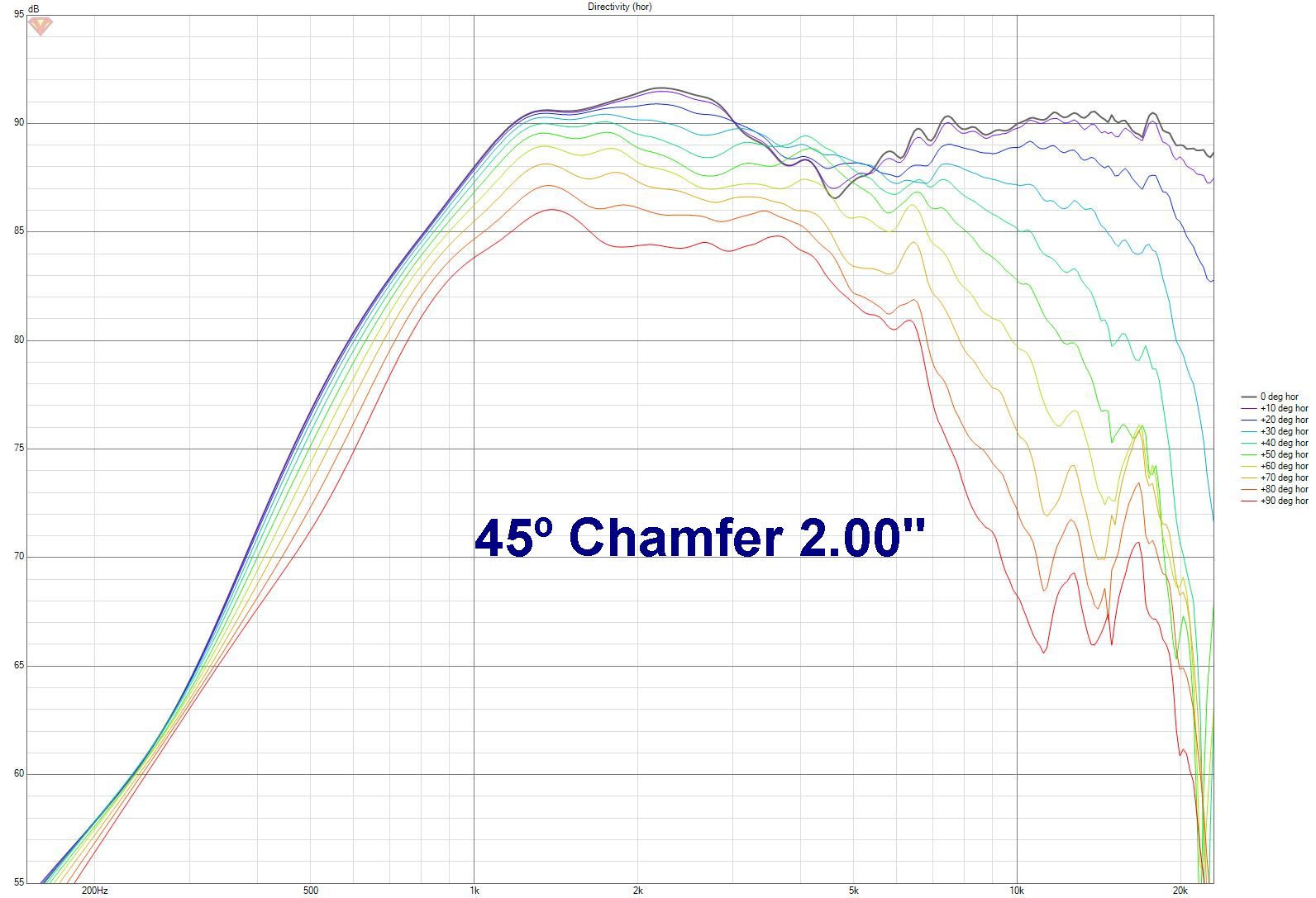

45º Chamfer data,

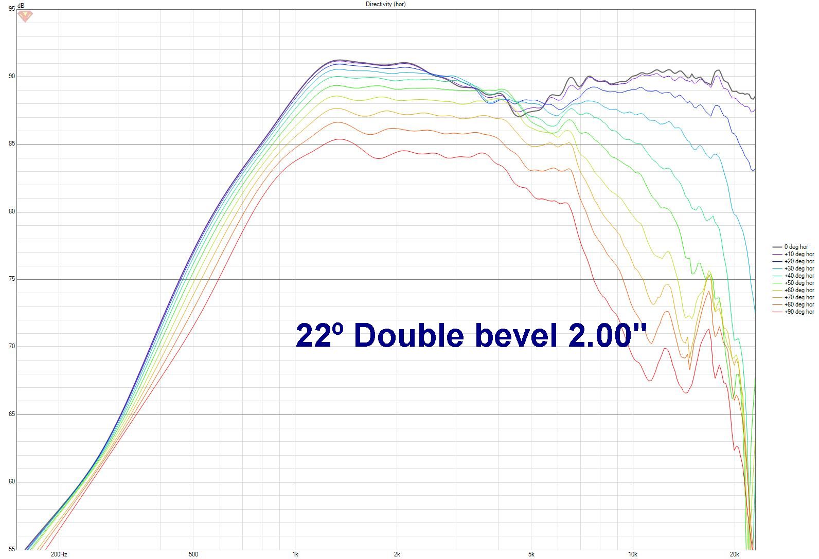

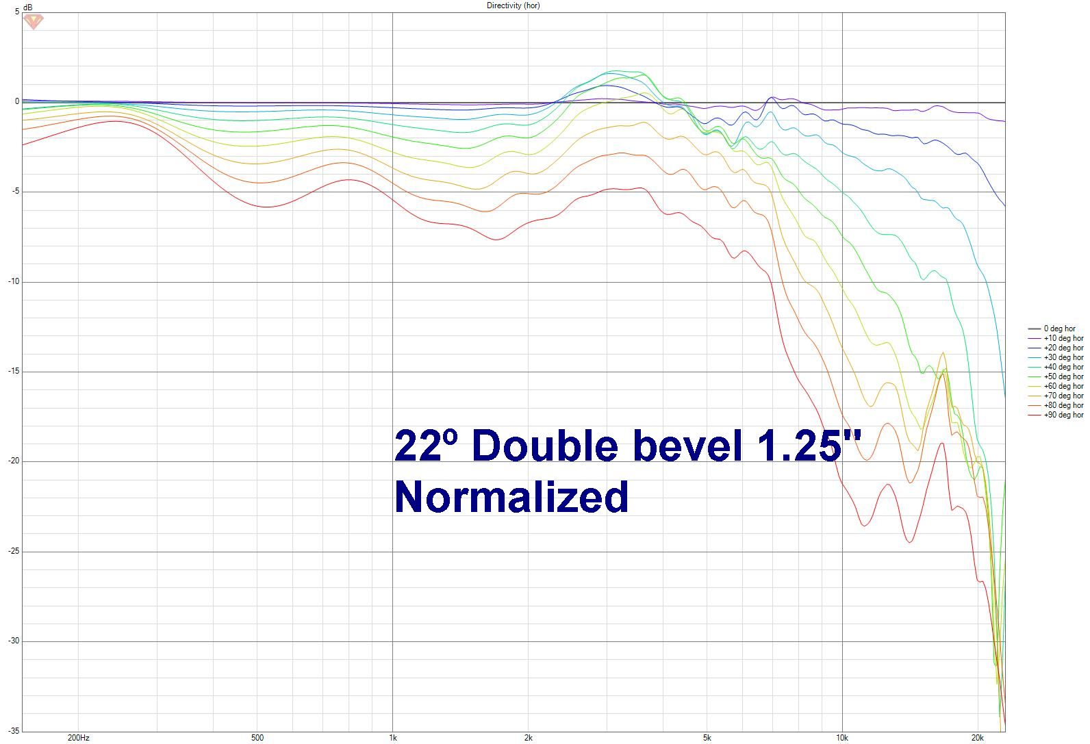

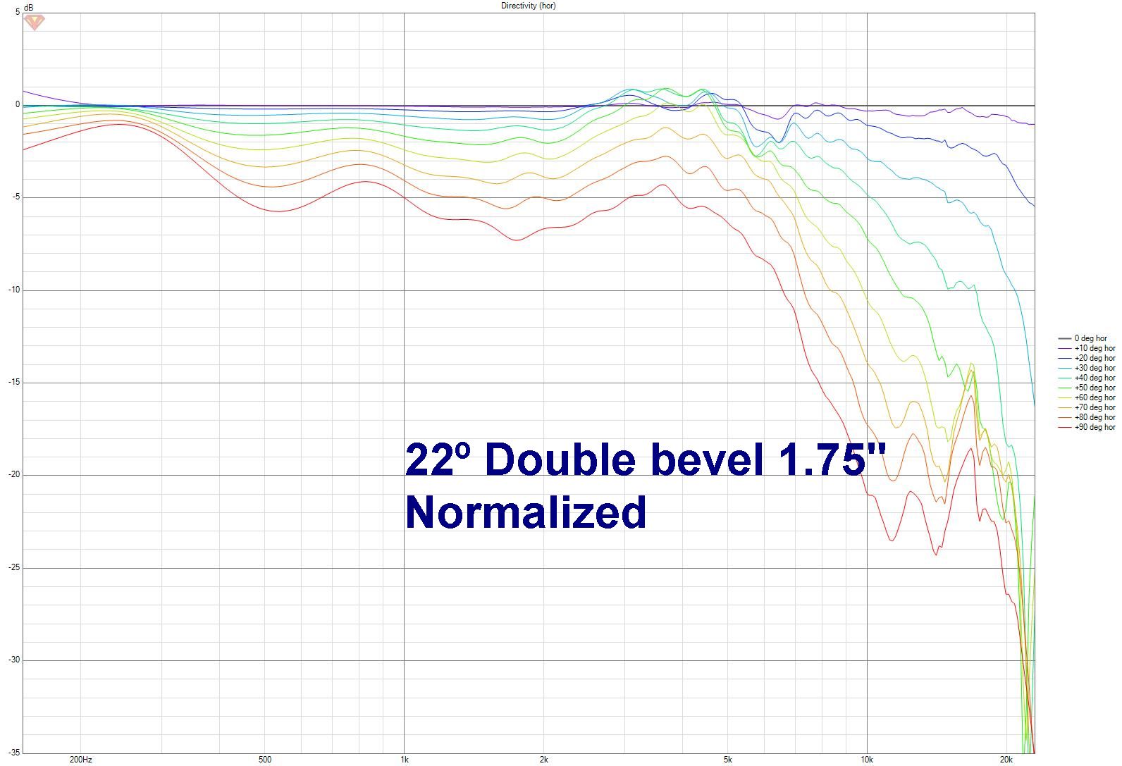

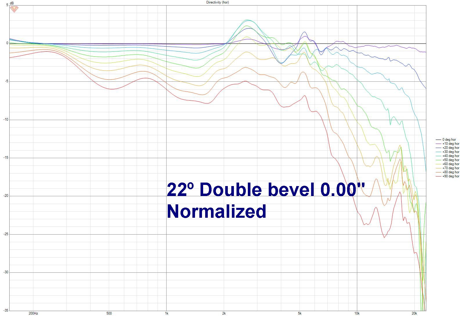

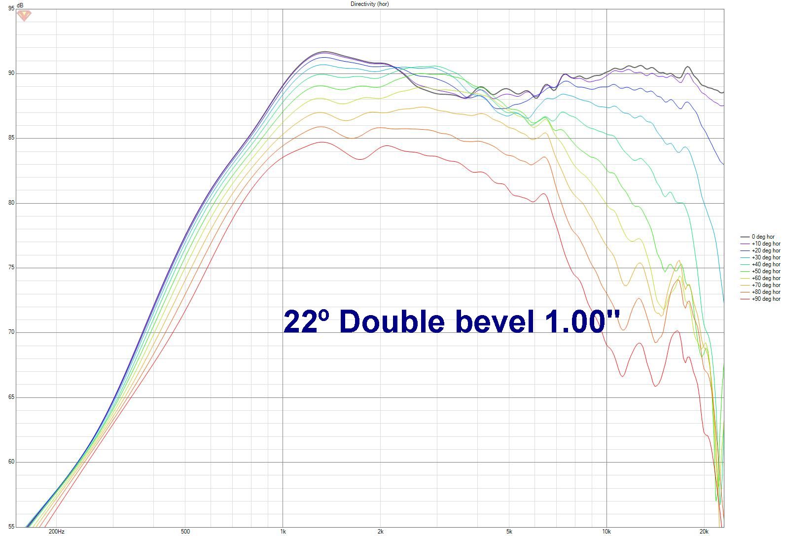

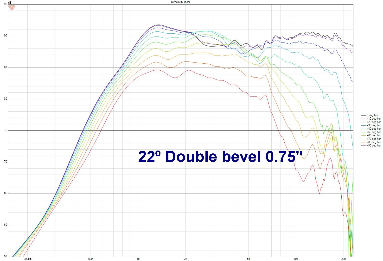

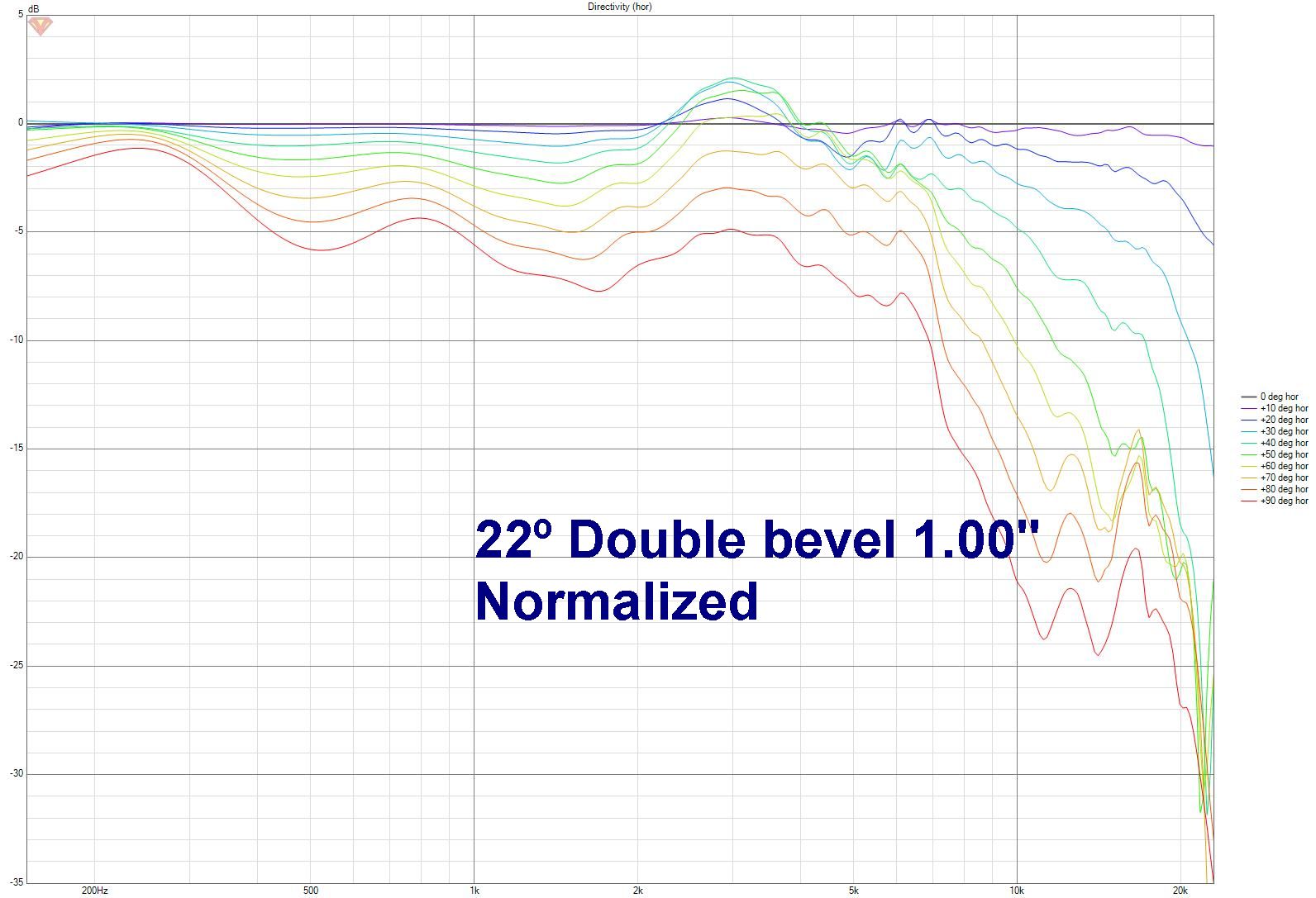

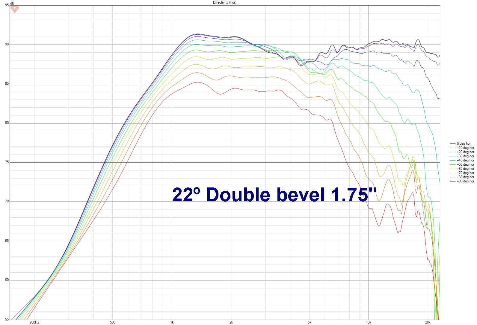

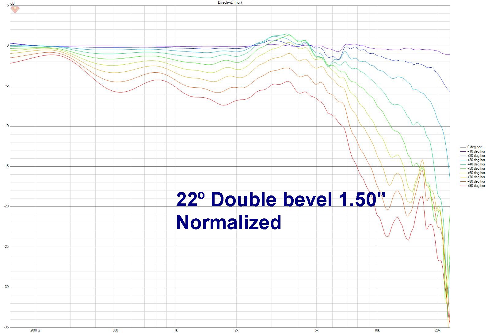

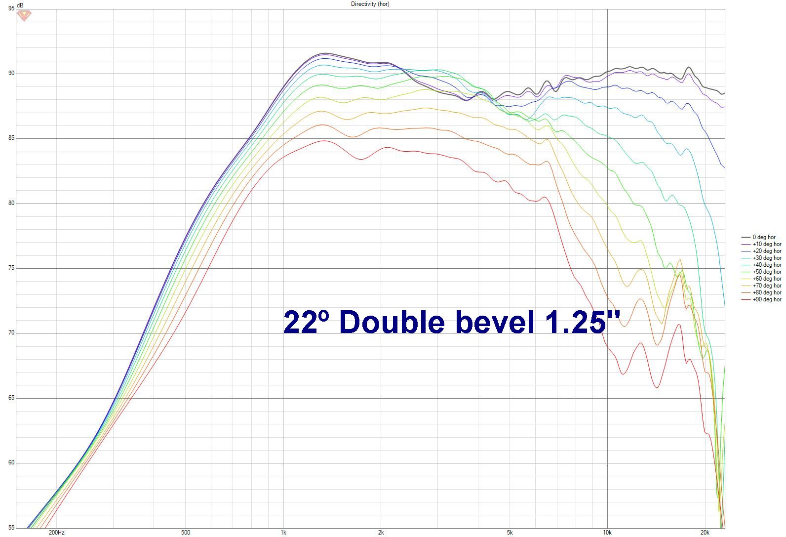

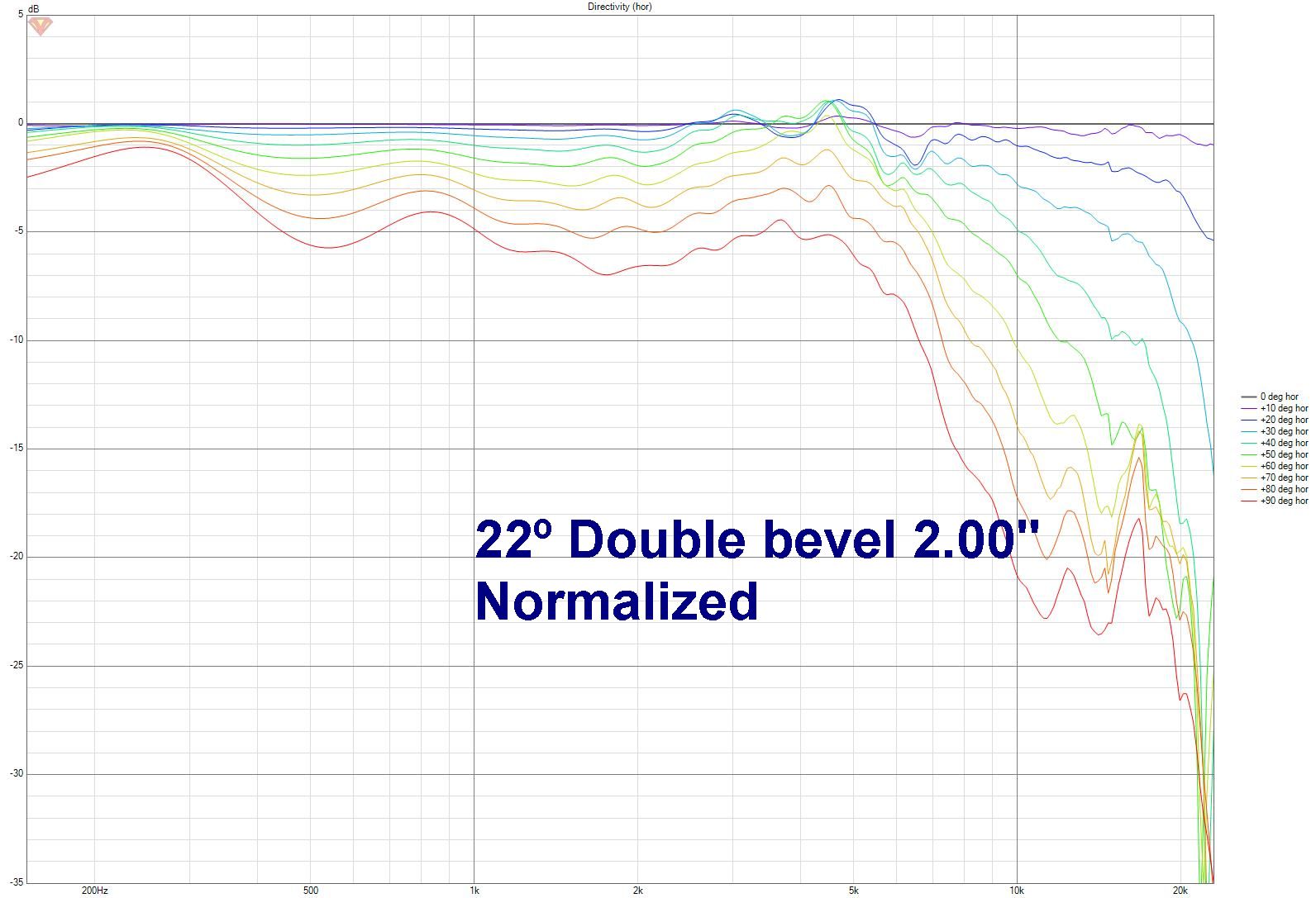

Double 22.5º Bevel data,

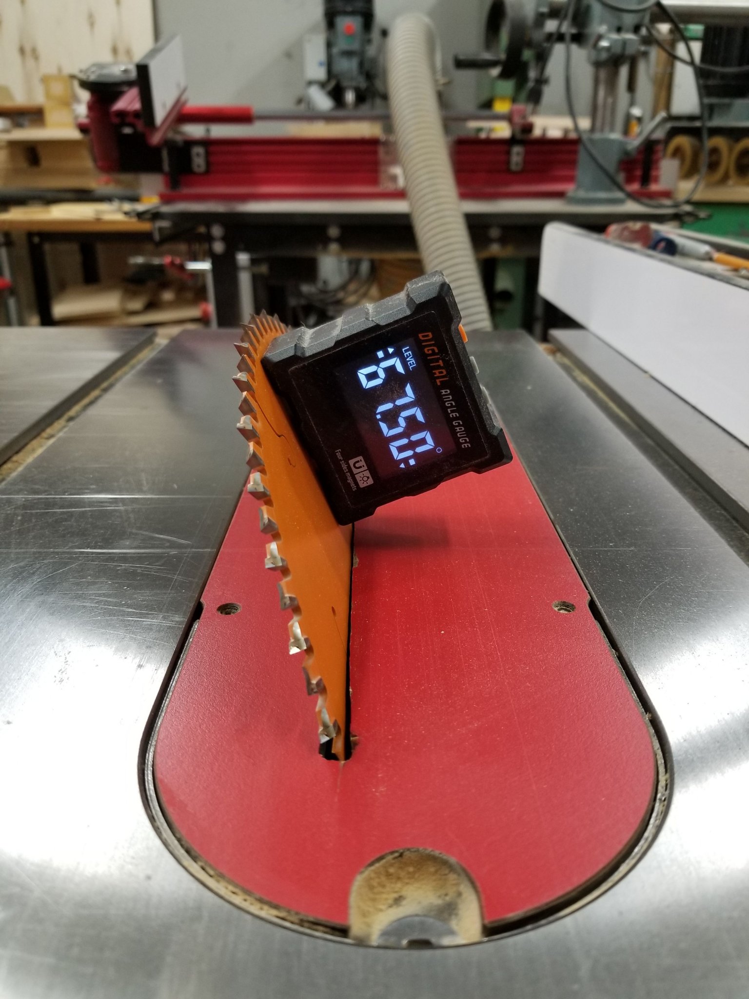

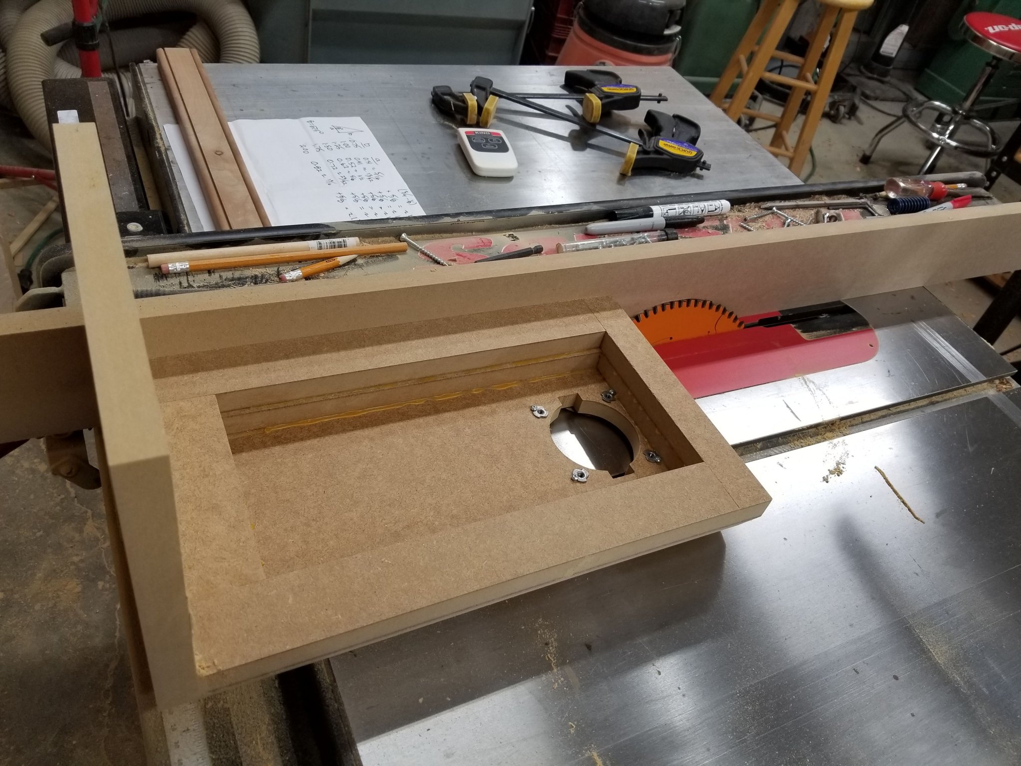

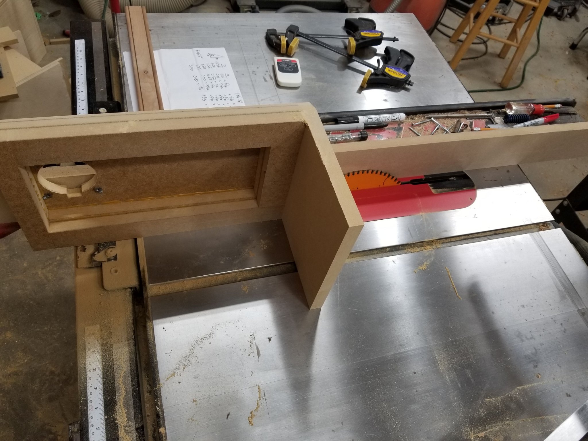

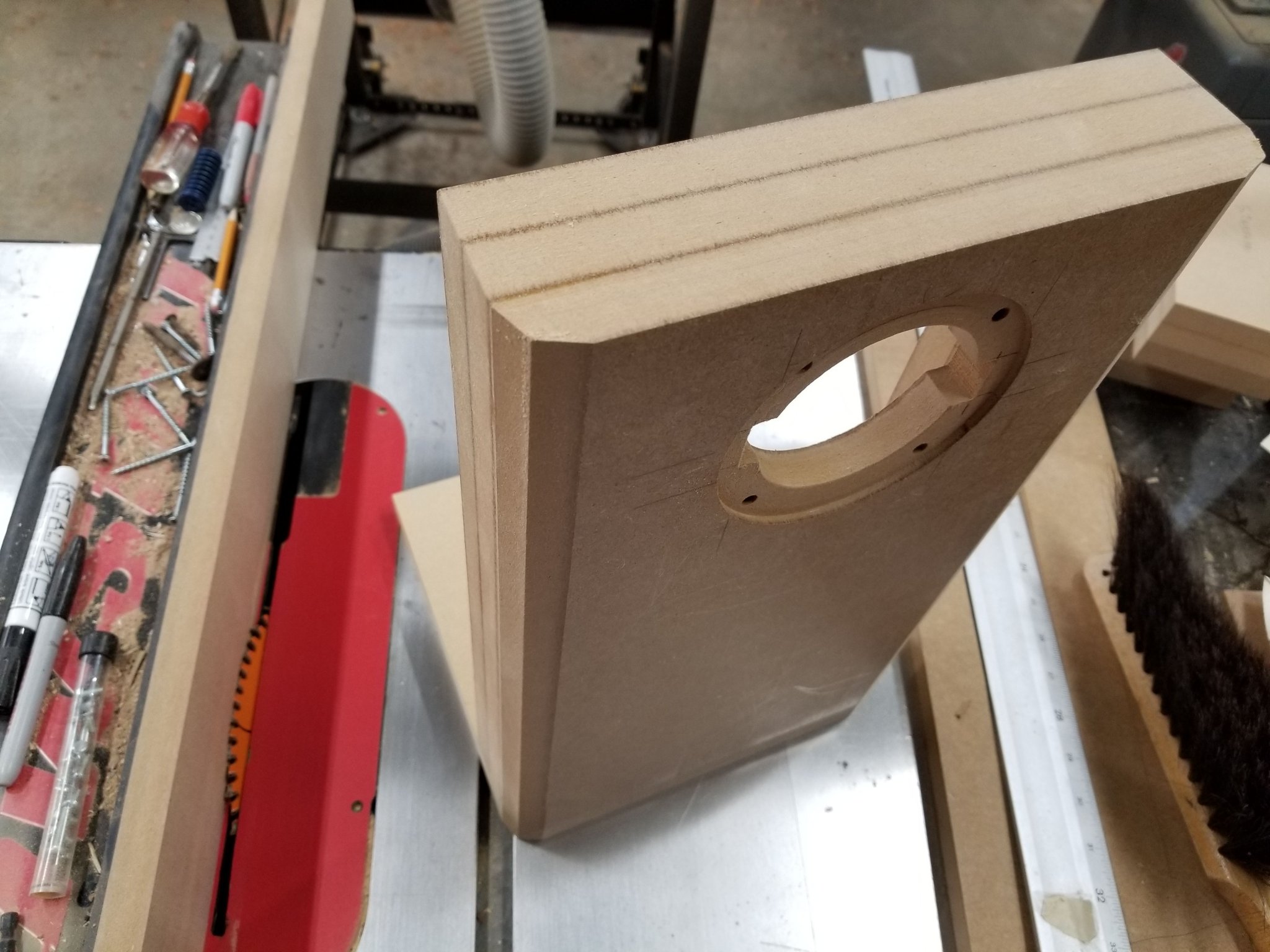

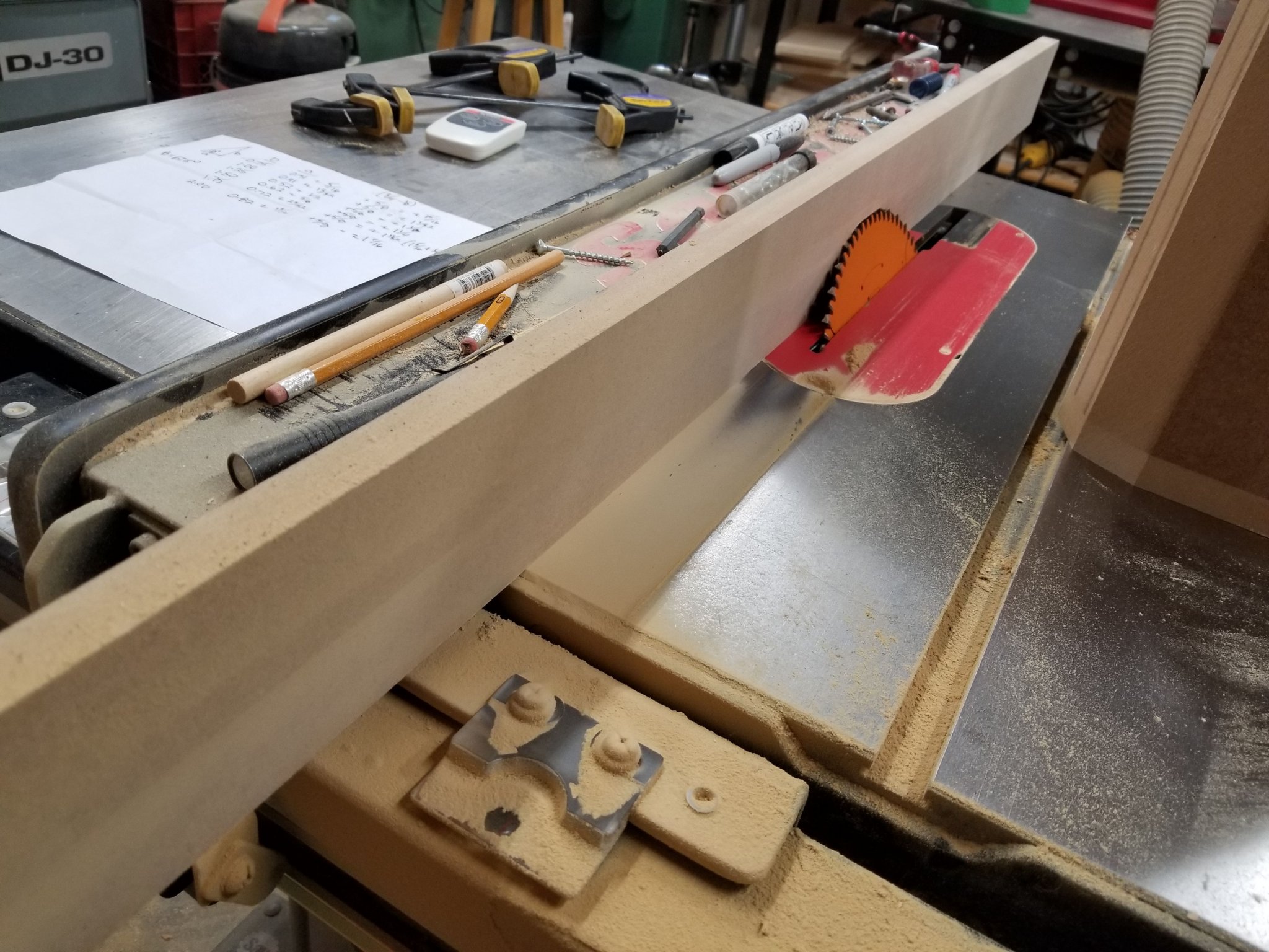

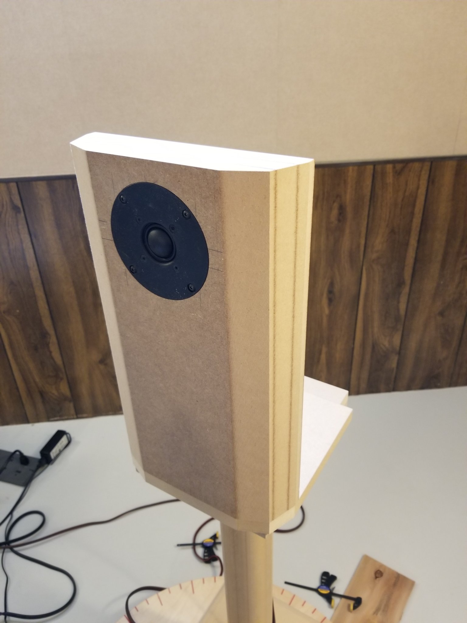

Here is how I did the double 22.5º bevel, Making a double 22.5º bevel edge on corner of speaker boxes.
Because you will need to bury your blade into your table saw fence, attach a sacrificial 3/4" MDF fence with double sided carpet tape. Conceivably you could do it with blade tilting away from the fence, not into it, but it would require two fence settings and this way ensures the cut is symmetrical on both faces.
Had to do some right angle math in order to calculate the fence setting for various "radius's" (b on the sheet) and account for the sacrificial fence and the blade width. This hinges on you having a scale on the left side of the blade with a accurate reading cursor on that side.
Set the blade to 22.5º (or the complimentary 67.5º), set the fence to the desired chamfer size, raise the blade until both sides of the blade are cutting into the sacrificial fence, make four cuts and you have a perfect symmetrical 22.5º bevel on the face and the side of the box!

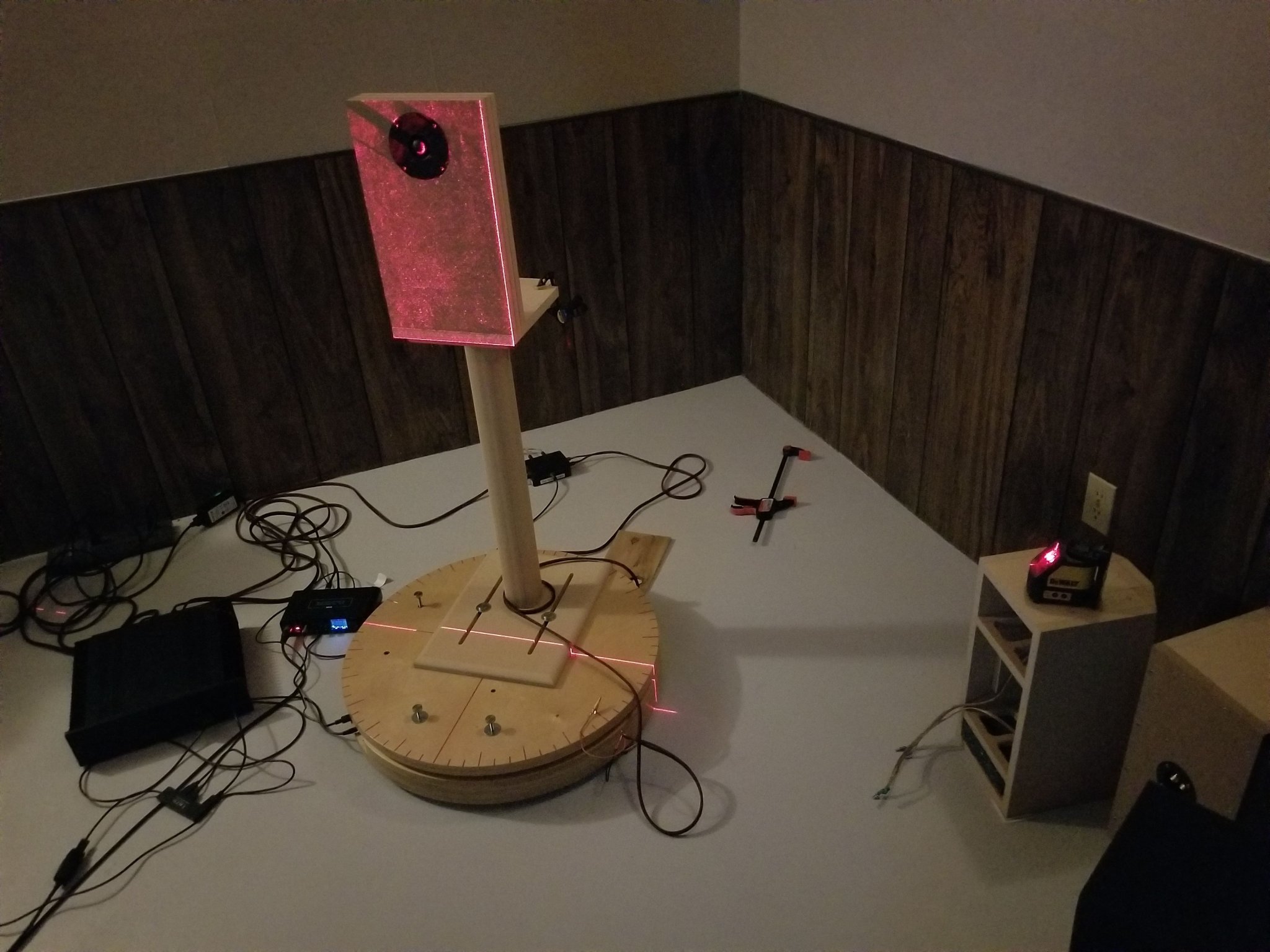

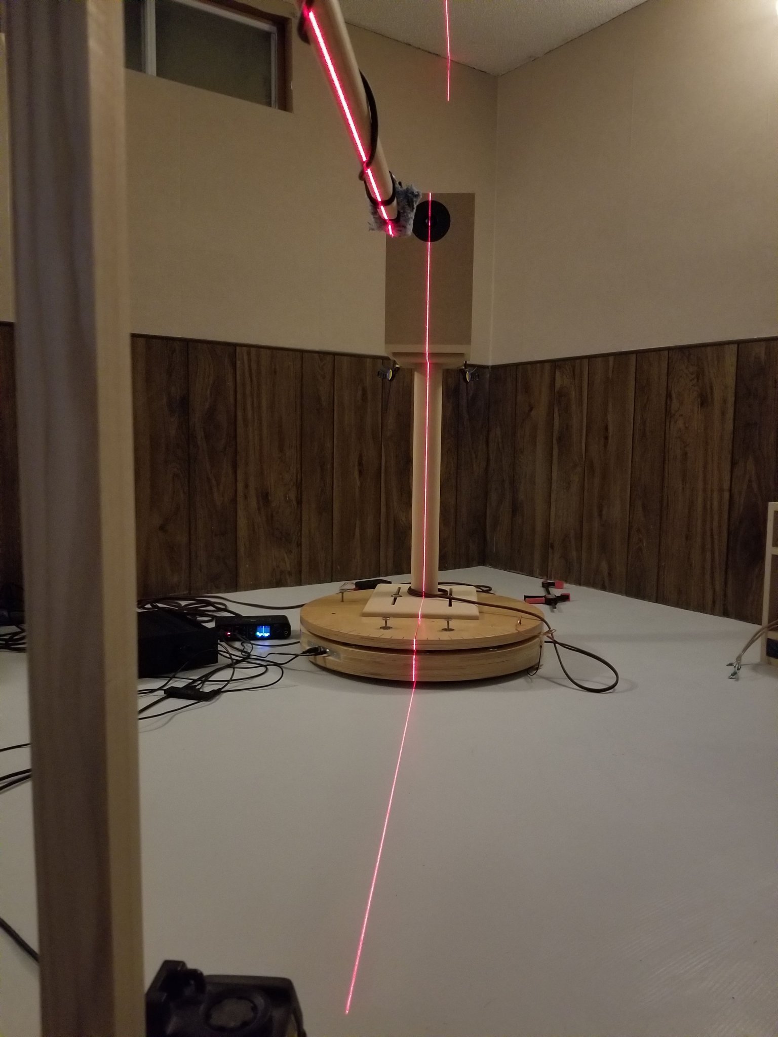

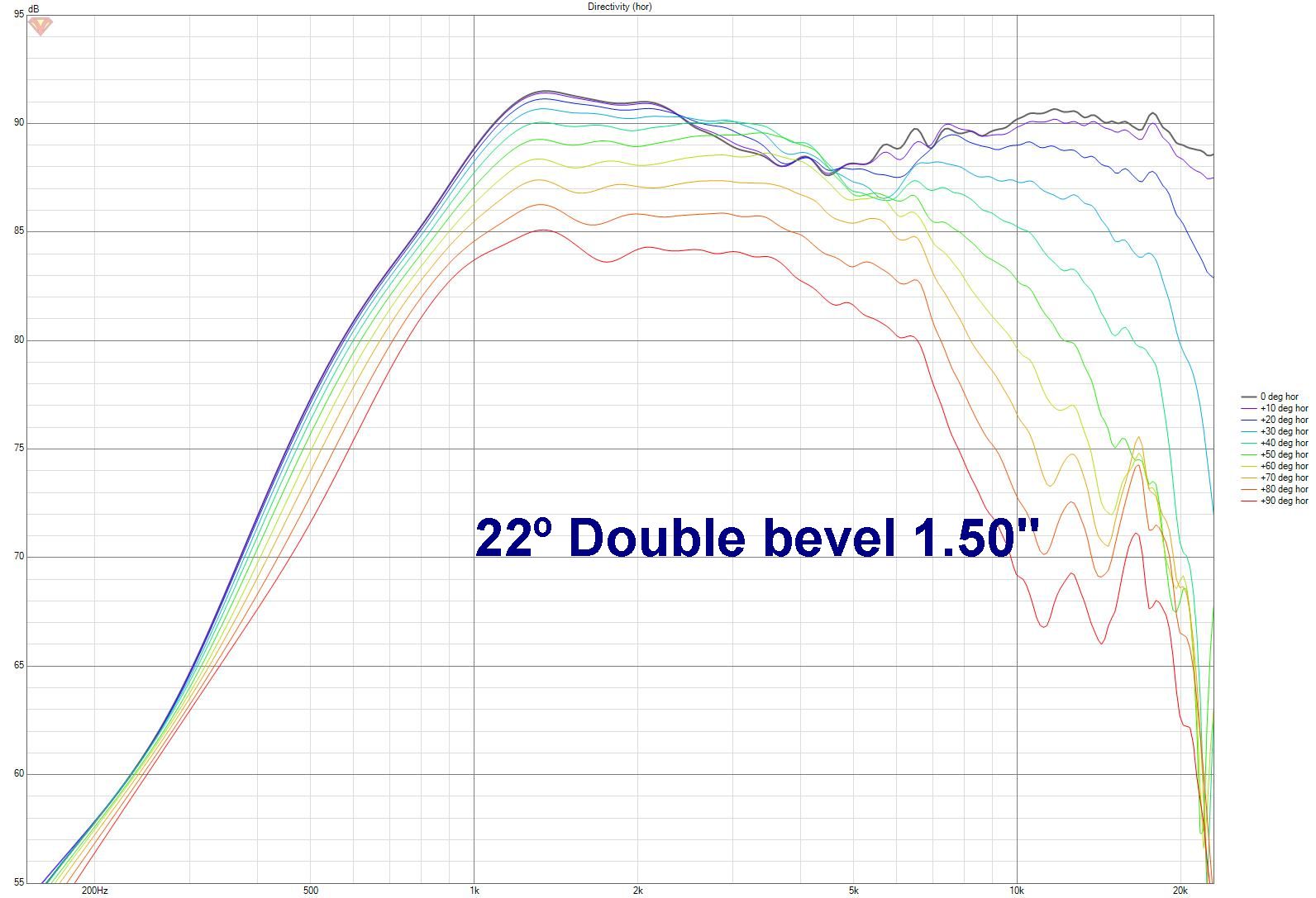

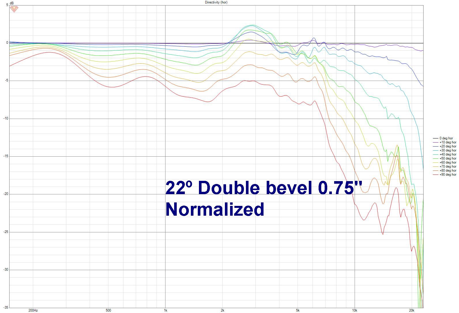

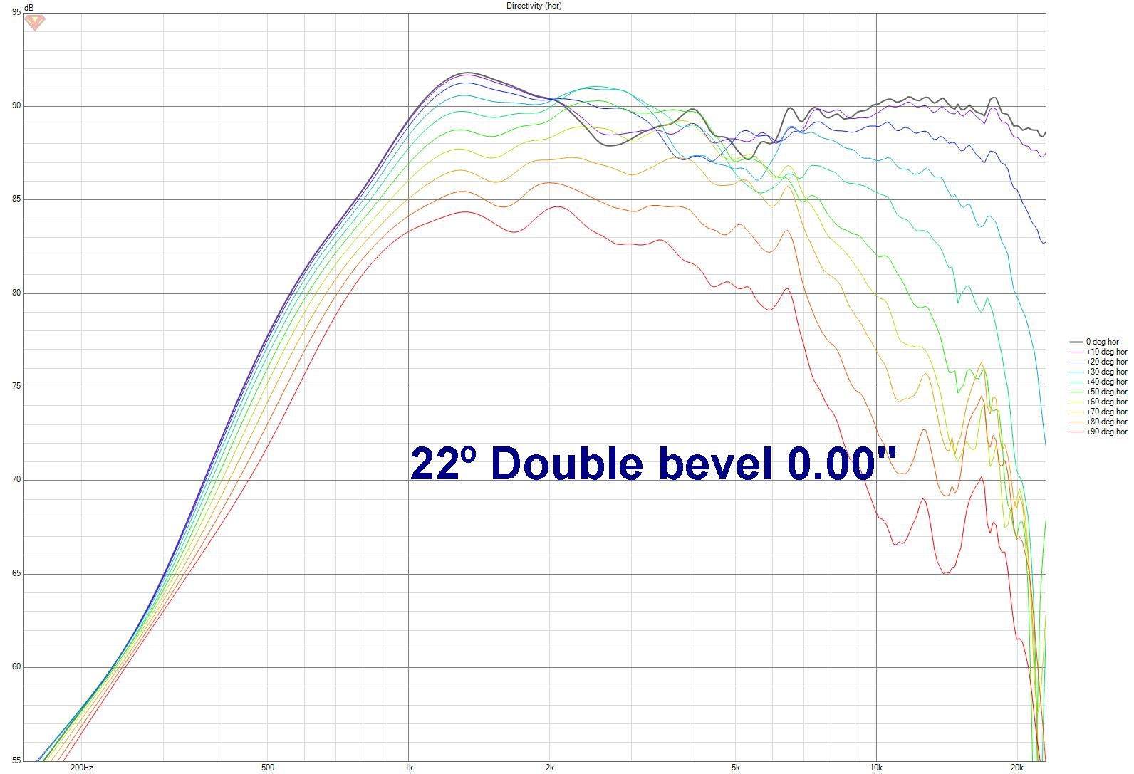

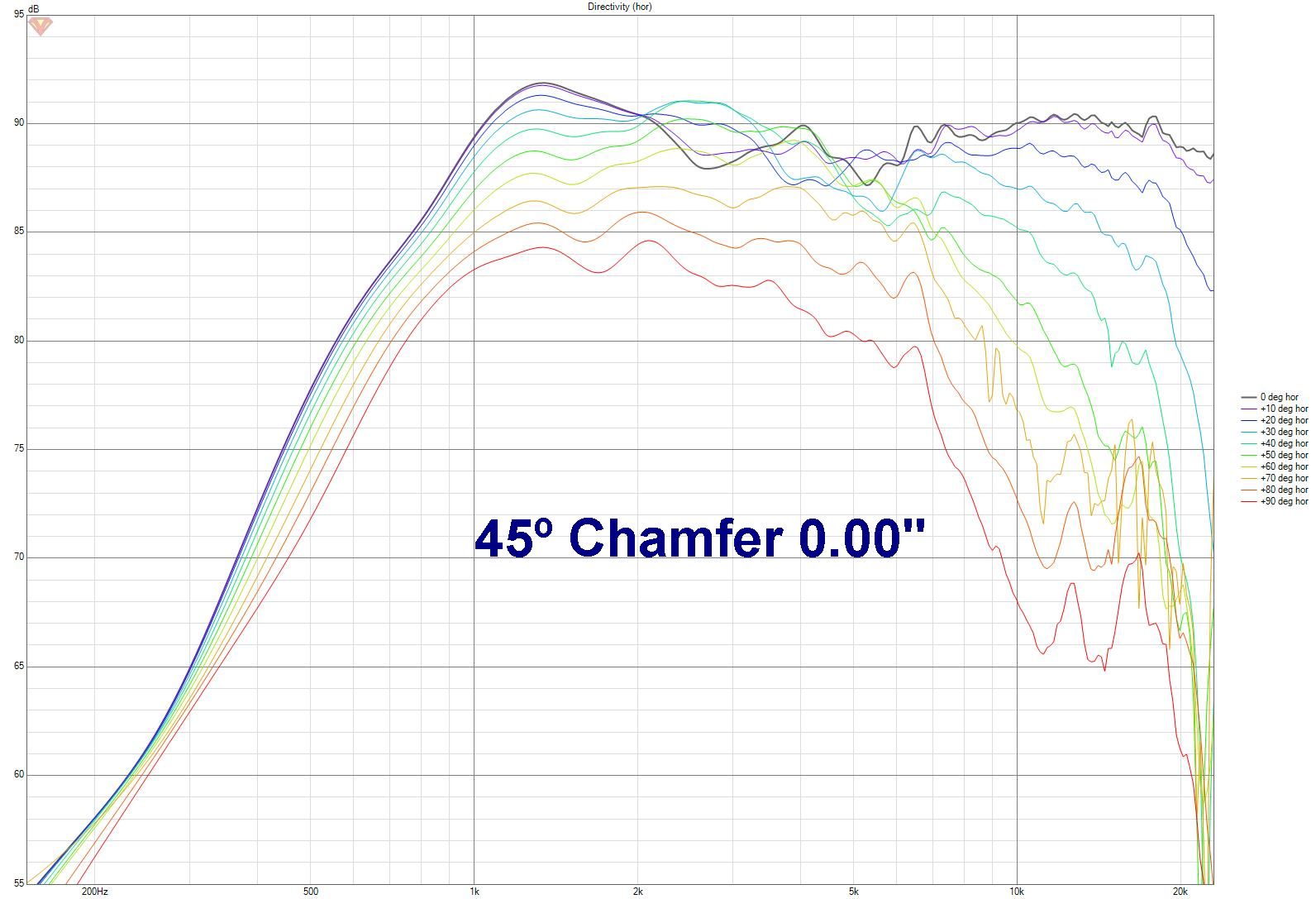

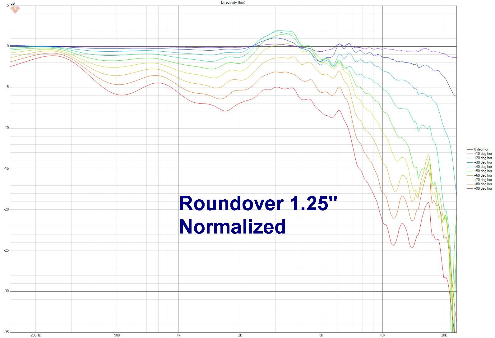

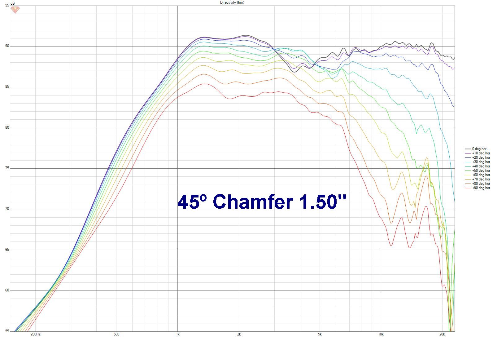

And here is what I was most interested in,
How do these four compare on a 9" baffle,
It looks like 45º edge bevels are not as good as roundovers and double 22.5º bevels are the functional equivalent of a roundover.
Nice work! You may have just saved me a lot of time! Post your baffle dimensions, I want to see if I can replicate this in ABEC if you don't mind.
I think roundover looks the best, but as I've noticed in past measurements, they behave as a slightly wider baffle than a chamfer. My issue is with a waveguide, the roundover looks smoother, but is lower in frequency where my waveguide doesn't have much pattern control. So I'll have to do my own tests with a box I just built anyway it appears.
It is really hard to make a totally even comparison between them particularly the roundover and the chamfer as it changes the baffle geometry. In practical terms the double bevel actually spreads the lower diffraction peak more, it makes the effective baffle smaller which is a good thing and smooths the transition more nicely like a roundover. Applying that at an angle would be effective much like kimmo's preferred rounded facets.And here is what I was most interested in,

Also confirms what I've read previously- small round-overs are not worth doing. Anything 3/4" or less is really not worth it. Merely an aesthetic effect.
If you're going to do a round-over, do a 1.5" roundover.
My smallest round-over bit is 1". Maybe it's time to find the biggest round-over bit that will fit my router...
