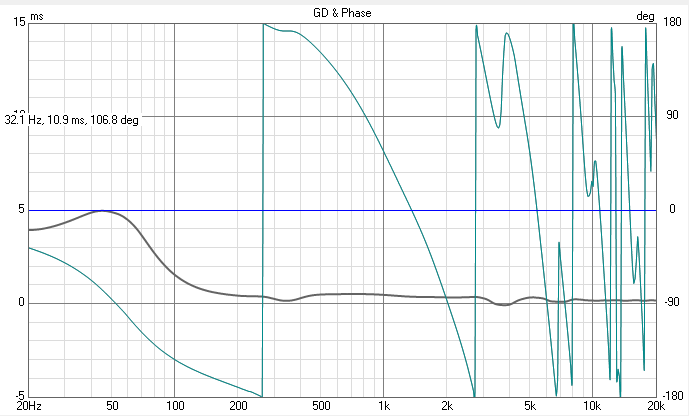

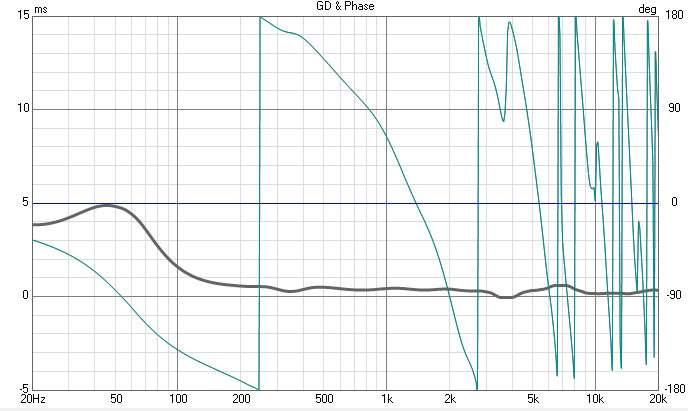

Does Vituix not calculate the GD parts of diffraction?

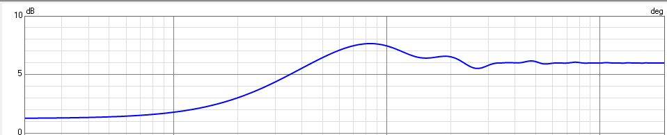

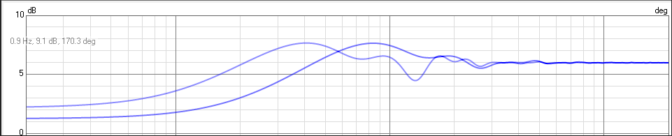

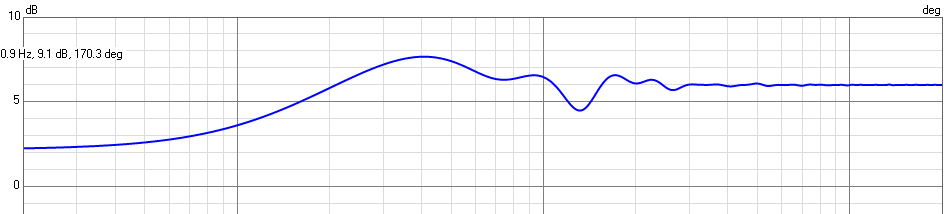

32x17
17x17
This is for the 15" driver which likely is not the best example.....Thanks for the convo guys. bed time

To me looks like it does. GD is in milliseconds and phase is in degrees. At high frequency 180 deg phase shift is only fractions of millisecond in time.

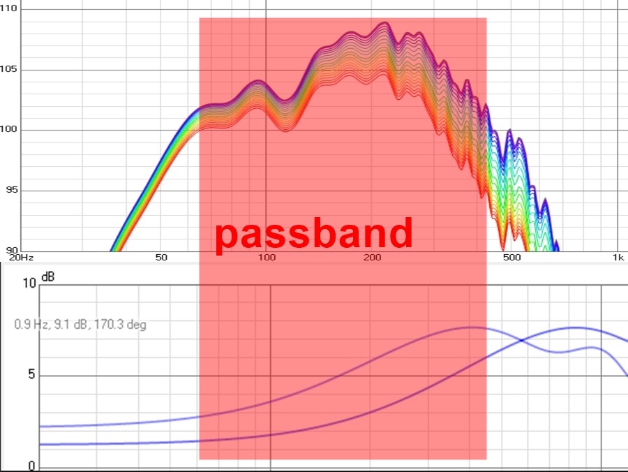

Regarding you low-mid woofer, it's passband looks like this. So, something like 2dB difference in on-axis spl and a small difference is dispersion.
When equalized, I don't think you could hear a difference in sound, until the driver starts distorting.
In your real world speaker, the 15" driver in 32x18" box is just fine. Narrower box gives no benefit, on the contrary!
