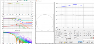

I am familiar with this material, its just for my particular situation I am speaking on. 15" woofer with a 32" wide baffle...the woofer is slightly off centered
Its not like we aren't going to use room correction that low...Its just another bump in the road that may or may not need to be ironed with eq, as the room sees it.... As well, there are no diffraction peaks and dips above baffle step...with a 32" wide baffle...Its just not coming into how my vertical polar is in play...as well, that we are looking at a 2db hump lol
I think this has been my point the whole time as I am only referring to where my situation fits into the greater scheme of things.
As Fluid said, the change in directivity is what he's looking at...I see it as not a win or a loss for me....I can either keep the highest amount of directivity well into the room mode territory with con of a directivity change within the at ~141hz passband or I can make baffle as narrow as I can say 17" and the baffle looses directivity at ~265hz....The edge diffraction effects get more intense as you shorten the baffle length....and less intense as we widen the baffle...
I forget that I have the tools to simulate my situation on some level, forgive me for being so helpless. Heres a my 15" on the 32" baffle, perfectly centered....Normalized sim by Vituix
If I am correct, this isn't as detailed as possible because the side walls are not simulated? I don't know.
My vertical represents the shortest baffle you might find on a 15"
I guess this is more a result of the directivity of the 15" not letting the edge interaction happen.
THis is just looking at the mid enclosure alone....since diffraction will happen at every other object the source waves encounter in the area...like the sub box for example.
I want to say that an extra wide baffle is another Form of optimal.....I am trying to figure out how this isn't true.... Looking what I can sim....I'd say that I am right....but maybe there or more details with an akabak sim.
Just because I want to say that, doesn't mean its correct...I was chasing as much direct energy as I could and somehow I landed here. Optimal for me isn't optimal for the next guy....still I want to see the bad...I don't see it in these sims.
Above grammar correction; "Its just now coming into view, how my vertical polar is in play...as well, that we are looking at a 2db hump lol"
The two comparison images show the point I am trying to explain. The vertical shows a smoother response overall, there the off axis response continues to drop as the angle increases. That is not the case with the wider baffle. The wider spread of the curves in the vertical indicates that there is more energy directed to the front with the narrower baffle dimension.
It is not totally accurate particularly at low frequencies as without the depth the full shape of the step is not accounted for and the impact this has on the directivity is missing.
Reactions: camplo
More direct energy in comparison to the off axis...but not more direct energy in total
Perhaps you have your own definition of direct energy, because a speaker that is more forward directional puts out more direct energy by common definition. I would not choose the super wide baffle for all the reasons I have stated (and graphs shown) but you have already made your choice and it's not a bad one.
I think I am saying it right??? When we look on axis....as we see in the graphs above....increasing baffle width increases output, the extra output is more direct energy.....The off axis performance looks that way it does because the with wider baffle its like the source is wider....with the smaller baffle the source is smaller......
Here is the catch, if you were looking the on-axis frequency response curve writing this it is true, the line rises with frequency on the baffle step, which in turn gets lower in frequency as the baffle gets bigger, true more sound forward as baffle gets bigger. But wider baffle doesn't make your source wider, source is still the same driver on the baffle and the baffle edge turns the sound that originated from the transducer and travelled across the baffle to the edge making secondary sound source at the edge due to diffraction. But the secondary sound source polarity is flipped (towards listening position, and back where the wave came from). And this is of course delayed from the direct sound depending where you observe at and how long it travelled along the baffle before diffraction. As you make the baffle bigger, the baffle step gets lower in frequency as lower frequencies get projected forward instead of wrapping around but also all of this edge diffraction has more delay to it showing interference lower in frequency. This all means that all you do while enlargening baffle is drag all the bafflestep + diffraction and issues lower in frequency, later in time.
Your analogy is kind of right, "the source" is now bigger with bigger baffle, but it doesn't represent equally big transducer, it is the same transducer + various amounts of sound at various delays dragging behind and at opposite polarity if inspected on-axis. This of course adds more energy to front (or to any direction) at certain wavelengths, where there is constructive interference, but it also creates less energy where there is destructive interference. When the wavelength is longer than size of the baffle, below bafflestep, where the system radiates all around and has lost its directivity completely, all the sound from the transducer comes as one toward the listener, without all the hash reflected from the edges dragging behind.
All this is kind of semantics, if you just look at the frequency response plots and see on dramatic wiggle happening, in other words get smooth graphs for the whole loudspeaker system, all should be fine. Here is diffraction tool sim with approximation of the subwoofer enclosure included, I don't know the exact dimensions so it is probably off some. If you look at it there is some wavy lines on the pass band <600Hz, but the more severe looking thinks happen >600Hz. If you made the baffle bigger but keep the transducer same, all these trends in the graphs move lower in frequency, and if you scale the baffle down keeping the transducer the same then all of it moves up, farther outside of the pass band.
Instead of making the baffle wider one should make the transducer bigger and baffle smaller in order to get maximal output and bandwidth out of the transducer, below frequencies where diffraction is an issue. Think about it a while 🙂 Unfortunately 15" is about the biggest driver one would want to use for mid range duty so multiple drivers would be required, which might just more issues. You can utilize the baffle size as you like, but if you think it through minimal baffle + as big transducer as needed to get the "baffle step" down where one wants it is the key for problem free great "direct energy", opposite of what you propose.
Here is new analogy to think about it: think about 6" driver on 32" inch baffle and compare it to 32" driver on 32" inch baffle. Both would have same bafflestep, but the 32" driver would not have any diffraction ripple because it starts to beam right above the baffle step (only the huge main diffraction hump would be there). The 6" driver would have diffraction ripple above the baffle step up to 6" wavelength. Now think which of these would have more displacement and SPL capability at low frequencies, the 6" driver or the 32" one?😀 Which one has less diffraction problems?
