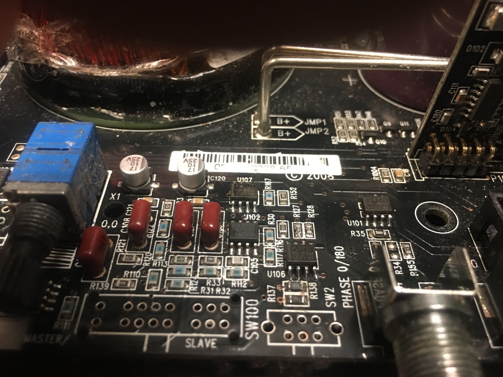

Ok I replaced R137 . I have 0.00 volts on pin 1 now .
what would cause R137 to keep burning up I’ve replaced it twice now

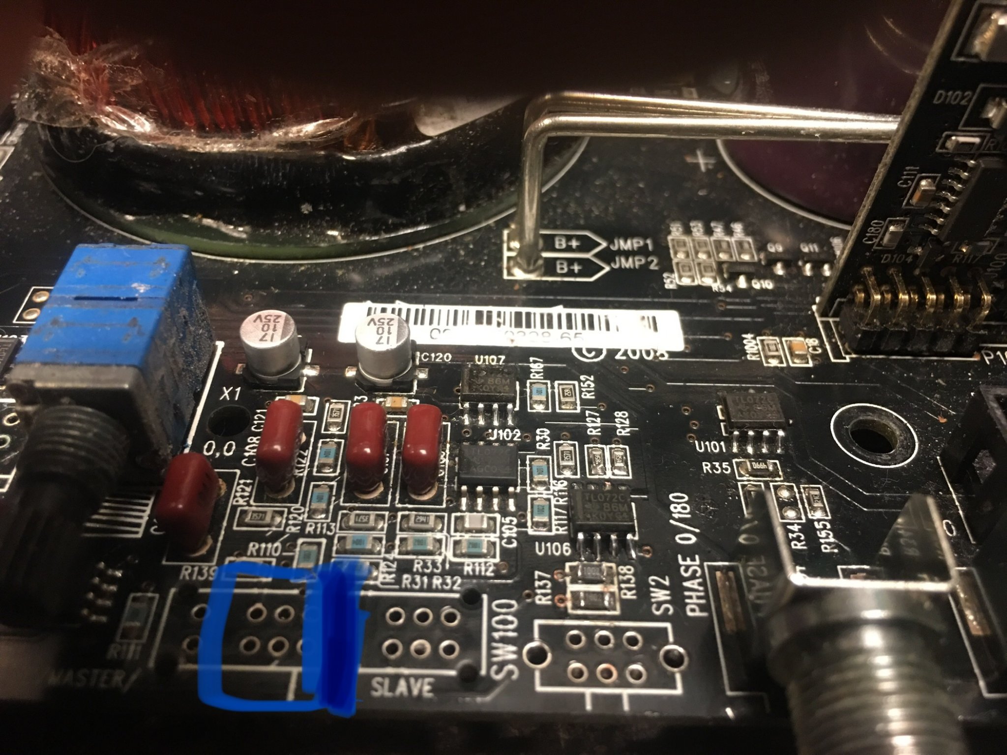

IT would be difficult to burn a 10k resistor.

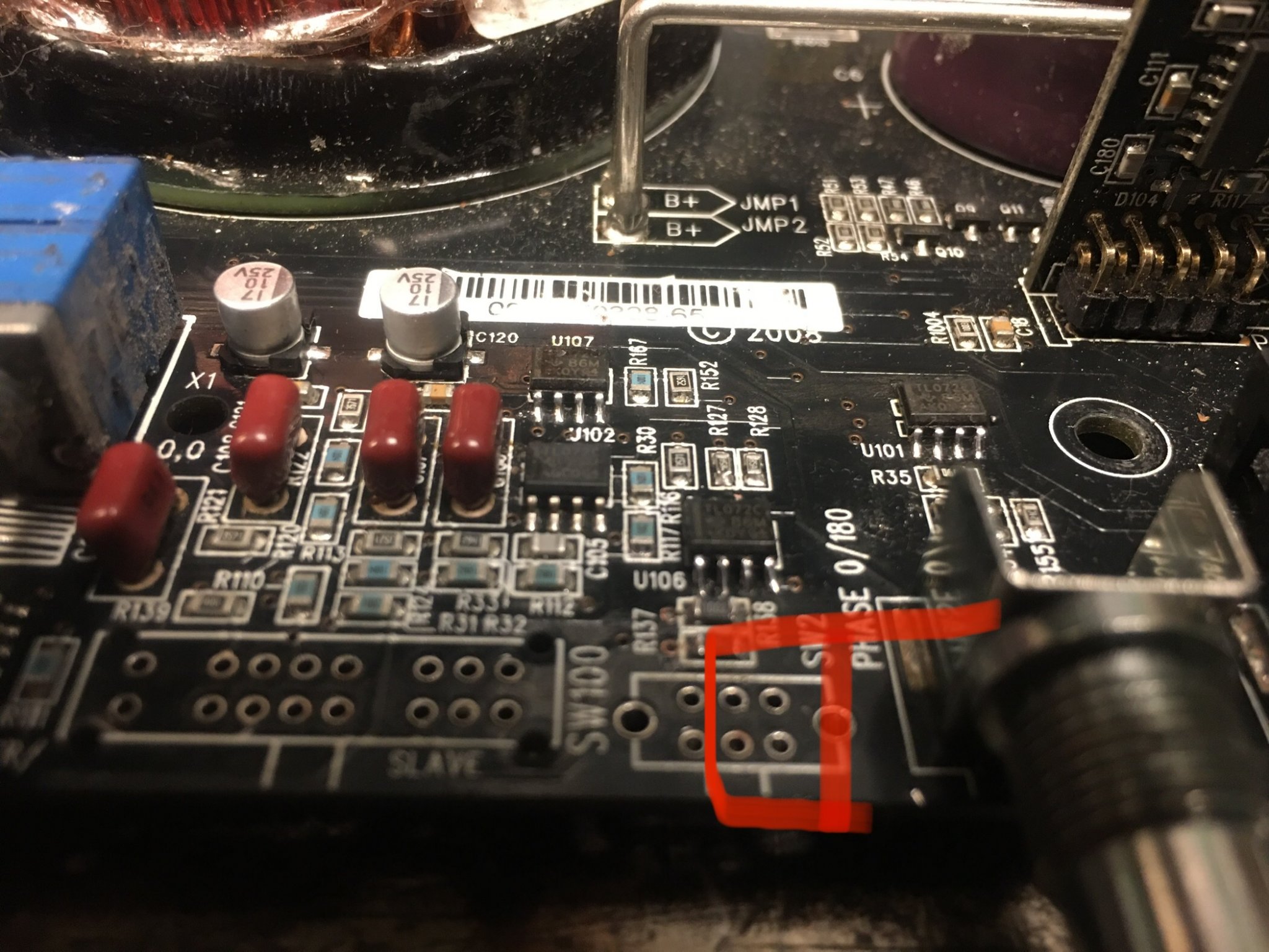

What about the switches? In, out, jumpers, shorted terminal photo?
install jumpers in place of the shorted terminals (so the jumpers act like the switch does).
Now do the master/slave switch.
