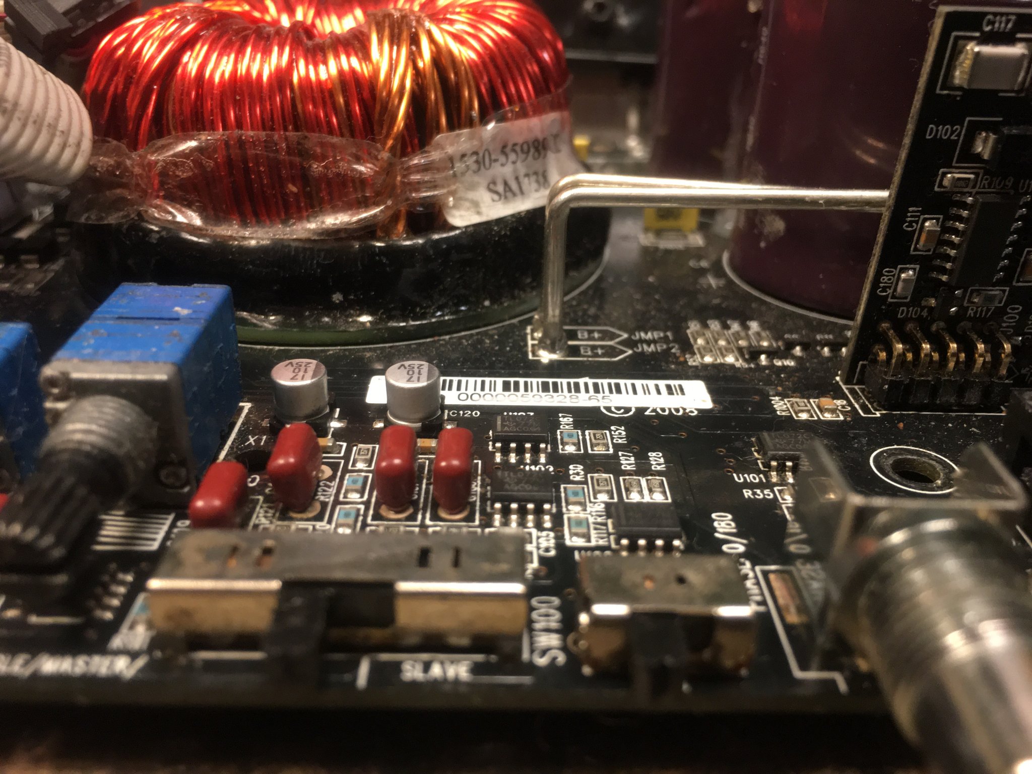

So I have to unsolder them from the board and take them apart correct ? These are sealed switches and I cannot spray contact cleaner in them
I get 0.3 ohms between the pins of the switches . I do not see any audio on any pin of The phase switch

I rebuilt the output driverboard and the 7k signal went away . I have audio on some of the pins of the master slave switch . 1 row I see audio on the pins the other row I don’t see good audio on the same pins .
not sure if this is normal for this amp or not but on U106,107 that sit behind the switches I get 13 volts on pin 1 of both opamps

Pin 1: 13.33
Pin 2:13.31
Pin 3: 0.00
Pin 4: -15.15
Pin 5: 0.00
Pin 6: 0.00
Pin 7: -0.07
Pin 8:13.32
I also noticed U106 gets very hot to the touch

Why did you say that those switches were sealed? The ones in the photos I have are not.
Post a photo of the master/slave switch in your amp.
Slide R137 off of its pads. Do you still have DC volltage on pin 1 of U106?
The op-amp appears to be defective. With R138 in place and within tolerance, the voltage on pins 1 and 2 should be the same as on pin 3.
Those switches are in no way sealed. If you drop DeOxIt into the holes in the top of the switch, it will flow through the switch.

I will replace U106
I noticed I also get 13 volts on pin 1 of U107,U101 is this normal or could they also be defective ?
