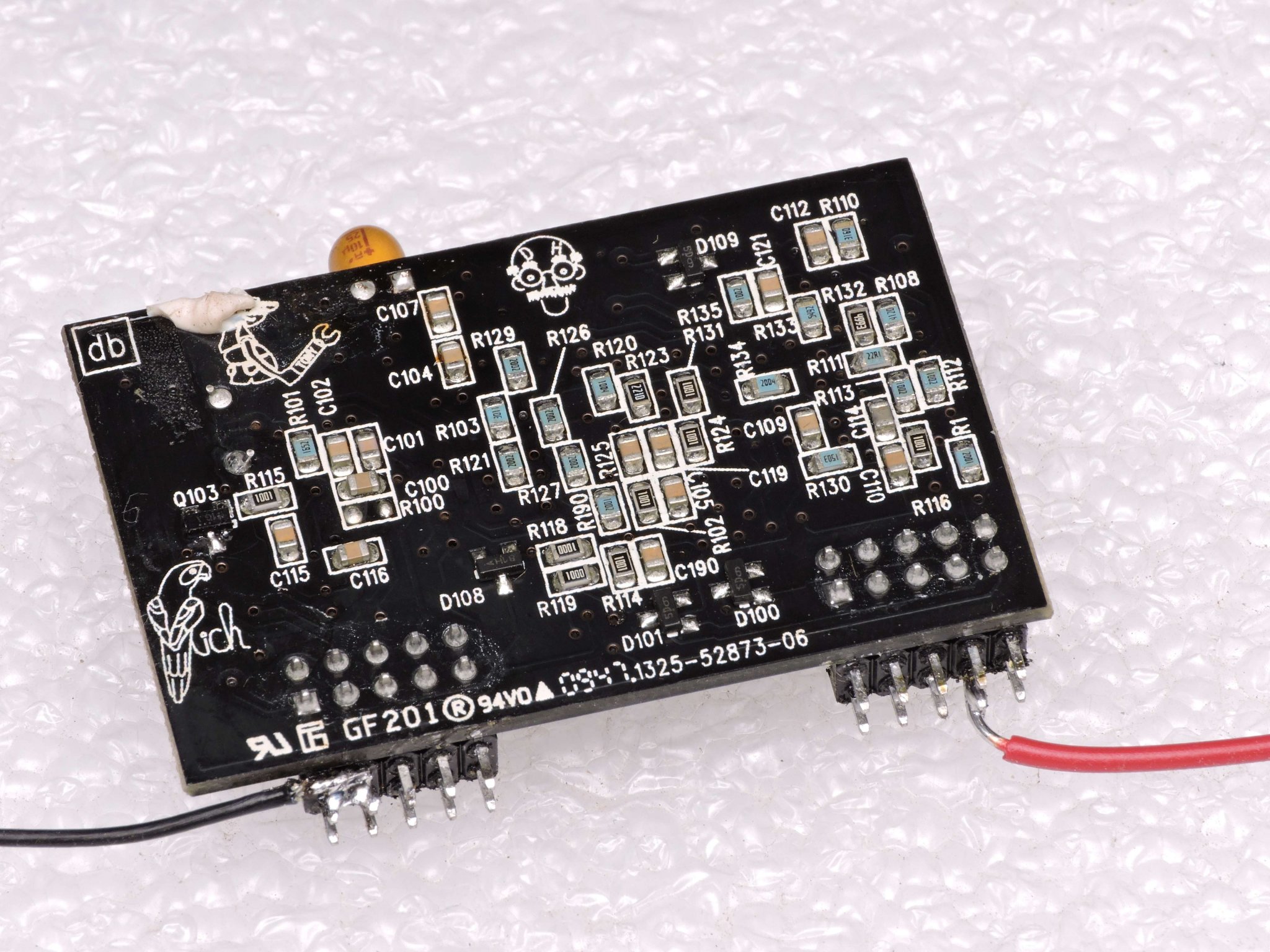

Do you have a pic of the power supply driver board ? Both sides

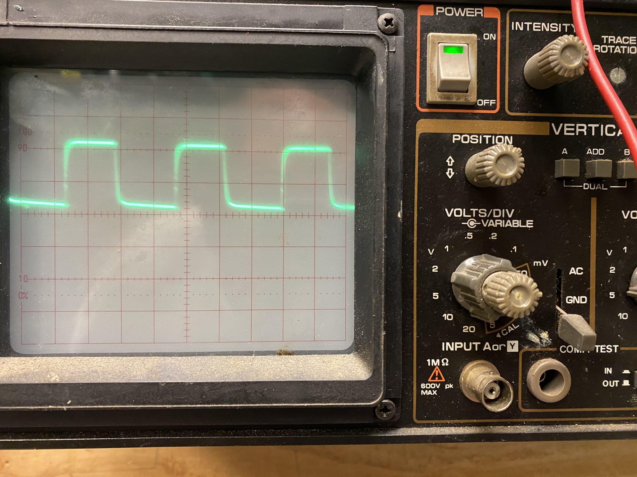

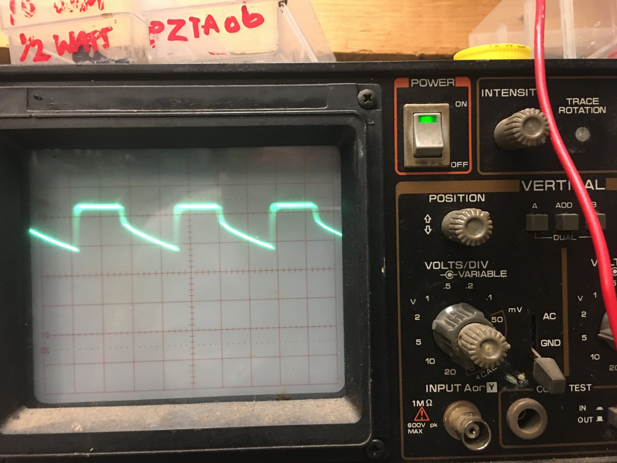

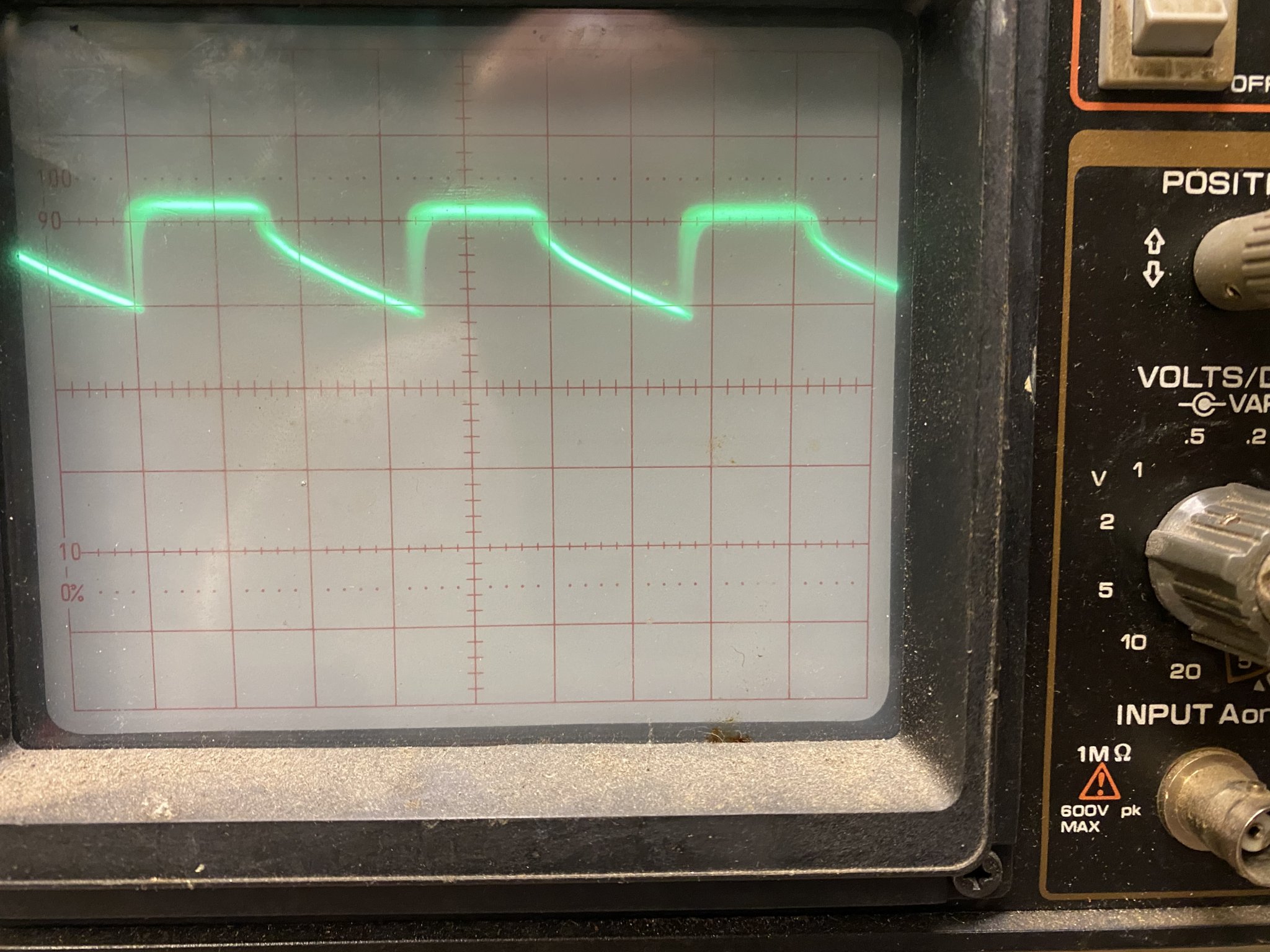

I powered the amp up and it blew the power supply fets in 1 bank it took the drivers out also . I replaced the drivers but not sure if I put 1 in the wrong spot now the amp draws excessive current
I might have problems with both banks .
First pic is of Q1,2,3
2nd pic is of Q4,5,6
3rd pic Q1000,1002,1005
4th pic Q1001,1003,1004
scope set to 5us 5 volts Div

I believe the issue is on the output board . Maybe 1 of the smd transistors are bad . If I remove the output board the issue goes away and the 7k signal is gone

I’m rebuilding the output driverboard in this amp since I’m almost certain that is the issue . I found 2 transistors that are leaky .
MMBT5088 and 2N700
does anyone know of a good replacement I can use for these transistors ? Mousse and digikey have no stock

2N7002?
Did you short the gate-source before checking for d-s leakage?
Newark shows stock on the other transistor.
