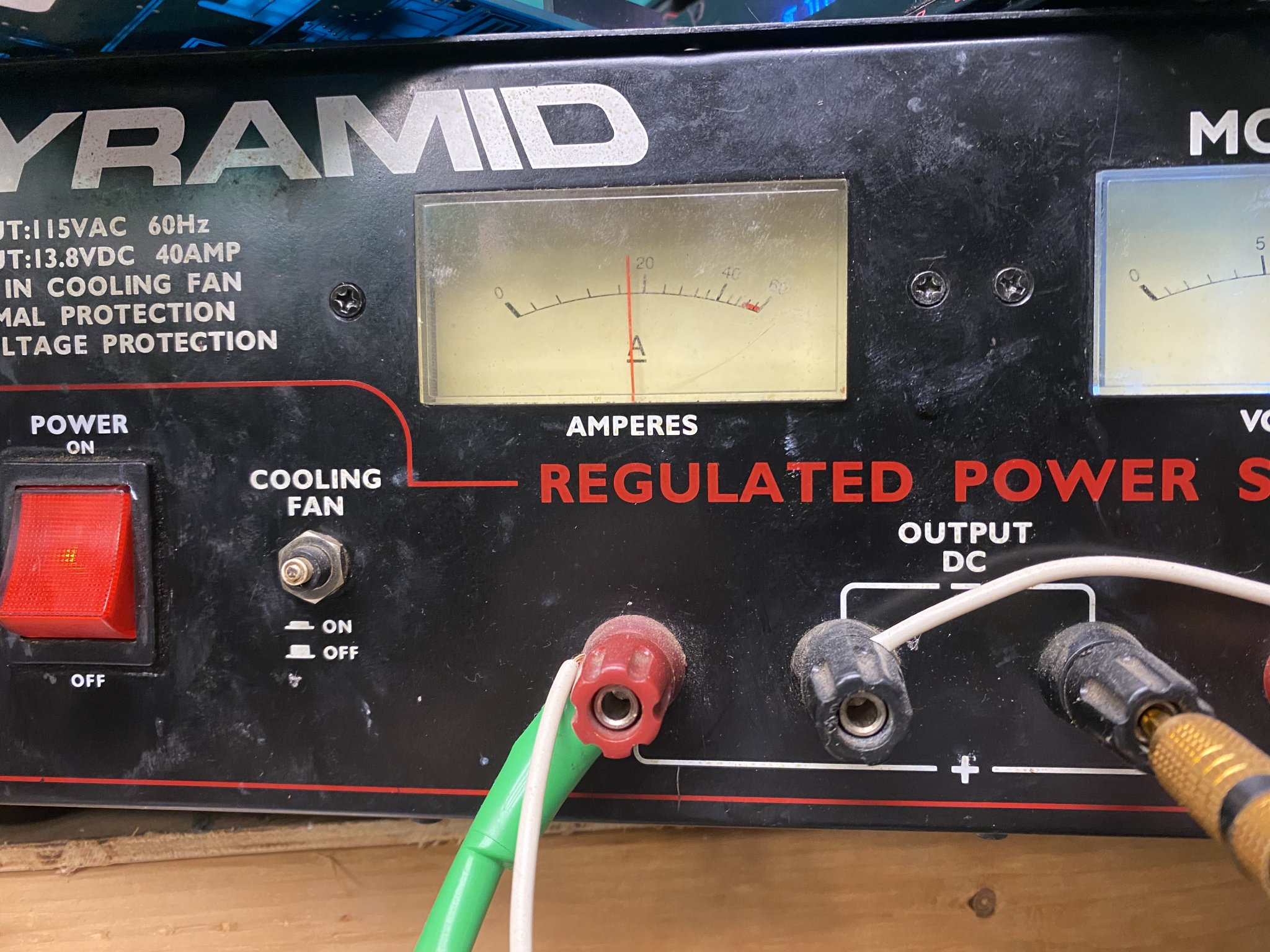

Jumpers are in place for the master slave switch . A jumper is installed between U106 pin 7 and R139 amp has audio output but very low and distorted and I get 14 volts on pin 1

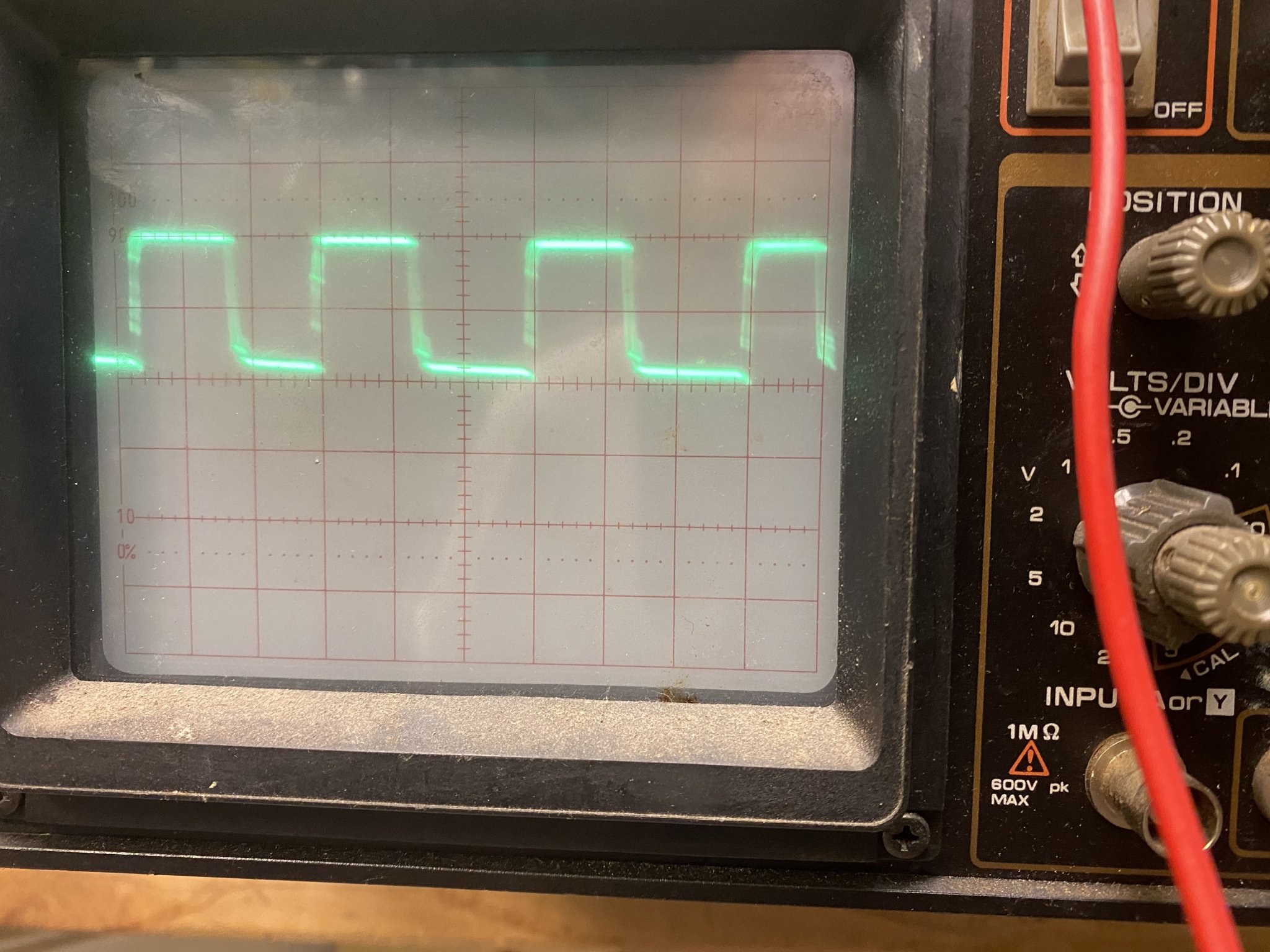

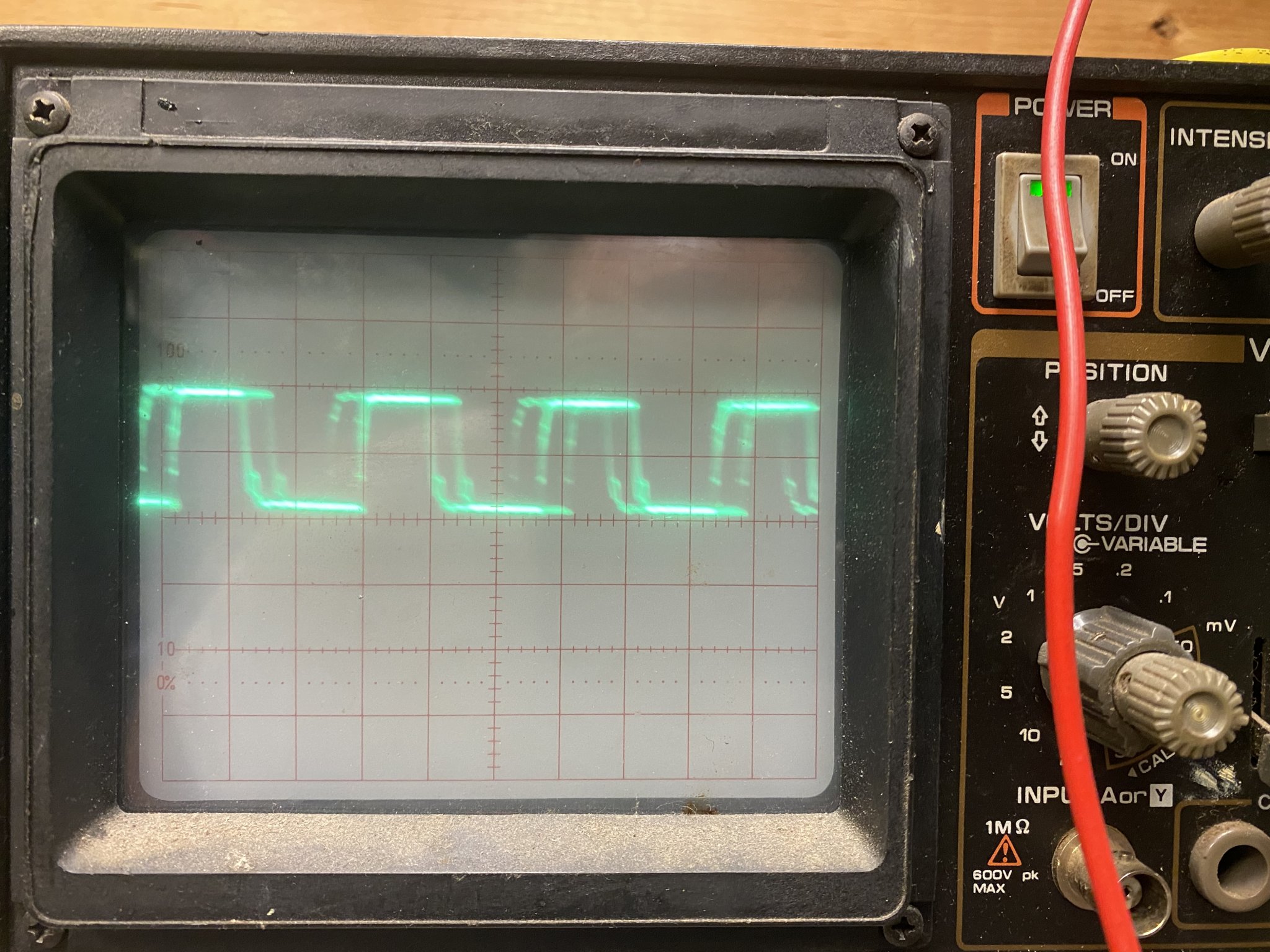

Ok I pulled the EQ card out of the amp and then voltage issue went away .
There is an ic on the board wondering what the likeliness of it being bad is ? The master slave switch connects on one of the pins on the ic wondering if that’s causing the issue

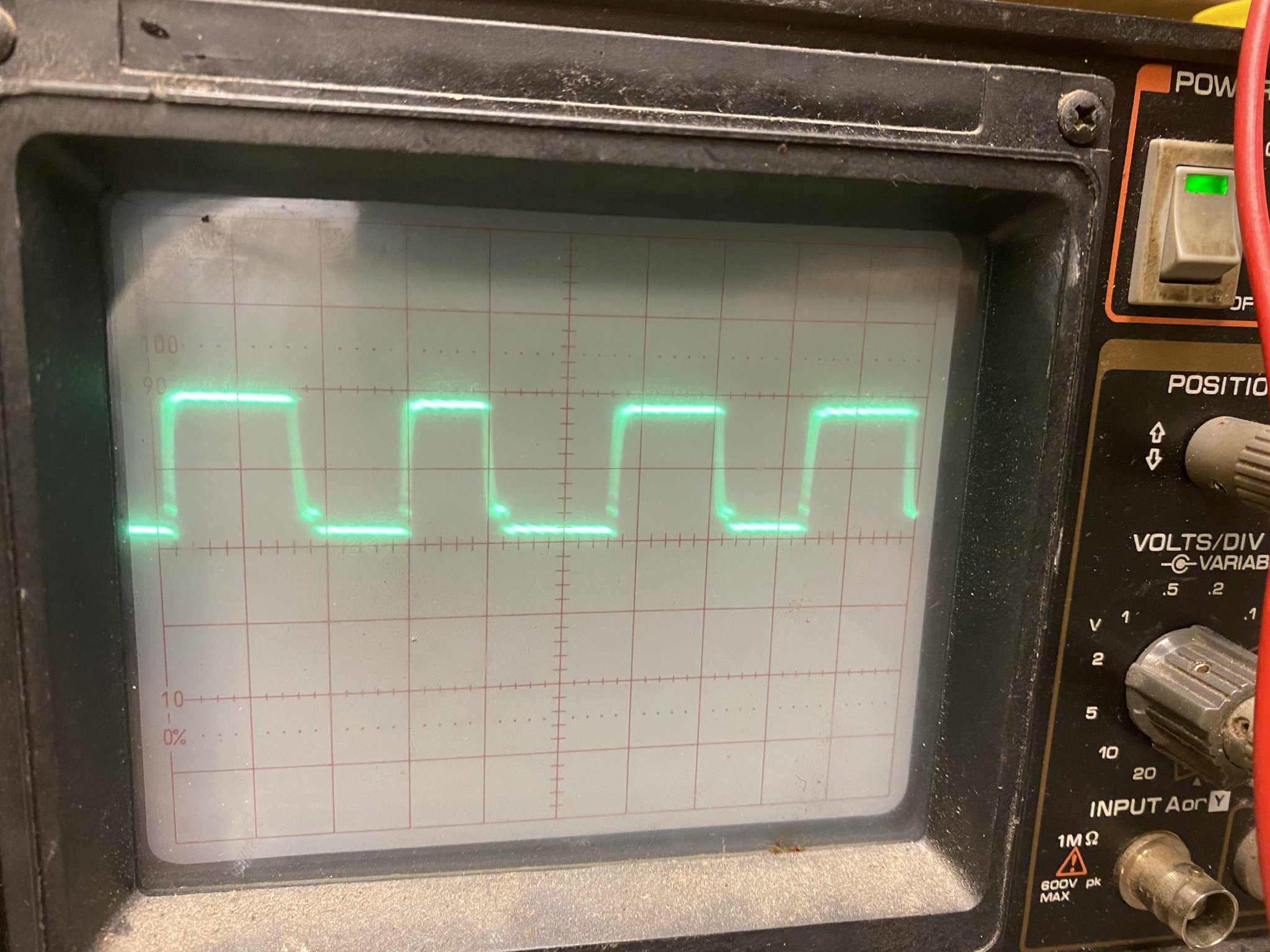

Amp is finally fixed !! I appreciate all of your help Perry .
Whatever ic was defective on the eq card was causing the issue with U106 Pin 1 . I had a spare eq card swapped them out and the issue went away and all switches / pots work correctly
