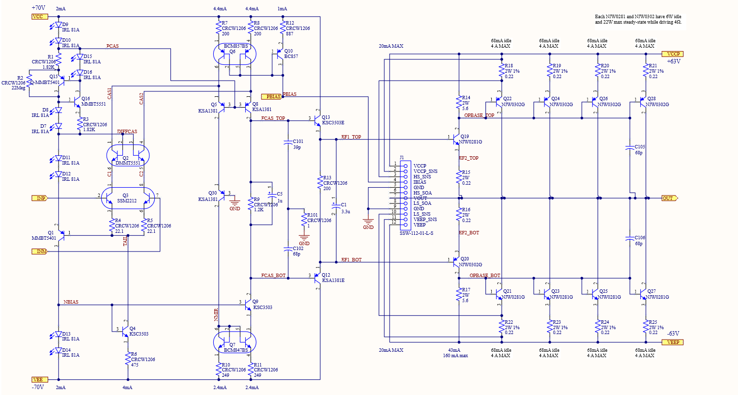

I dont use D1, but my "diamond" is a bit different.
I go up a diode from the supply through D5. Without D1, the base of the drivers would go a diode above the supply during clipping. I think saturation would be possible and quasi-saturation would be inevitable, probably leading to ringing as the drivers exit quasi-saturation. I mean, that's the whole point of having the diodes, right?
I haven't simulated your amplifier, but I think that you are "killing" a lot of gain by your compensation.
That's big talk for someone who hasn't simulated my amplifier. How would you recommend to compensate a folded cascode amplifier?
In an FC amplifier, Miller has to be input inclusive, and the gain of the stage is just too high for that to work right on this amplifier. Trust me, I've tried. That rules out two-pole compensation, and output inclusive compensation becomes part of the global feedback. Right now, the 0 dB loop gain crossing is just under 5 MHz.
The only other FC amplifier I've seen on diyaudio is roender's RMI-FC100. He started by using 30 pF of output compensation on the FC, and then switched over to 4 pF of Miller input compensation. The FC100 loop gain is about 15 dB lower than mine, so he got that to work OK. I could not.
In simulations, I'm not seeing any nonlinearity due to charging/discharging of the 36 pF of compensation cap. My nonlinearity is dominated by the output stage, at this point. That is why I think ojg is on the right track, suggesting a CFP for the OPS.
That will likely kill a bit of my overall loop gain, but make up for it with local feedback in the CFP. With lower loop gain, that phase lead compensation may be workable. Roender also used a CFP OPS.

Ha, just as I was about to close the lid on this design and start the PCB, I'm starting to get a lot of great feedback and ideas.

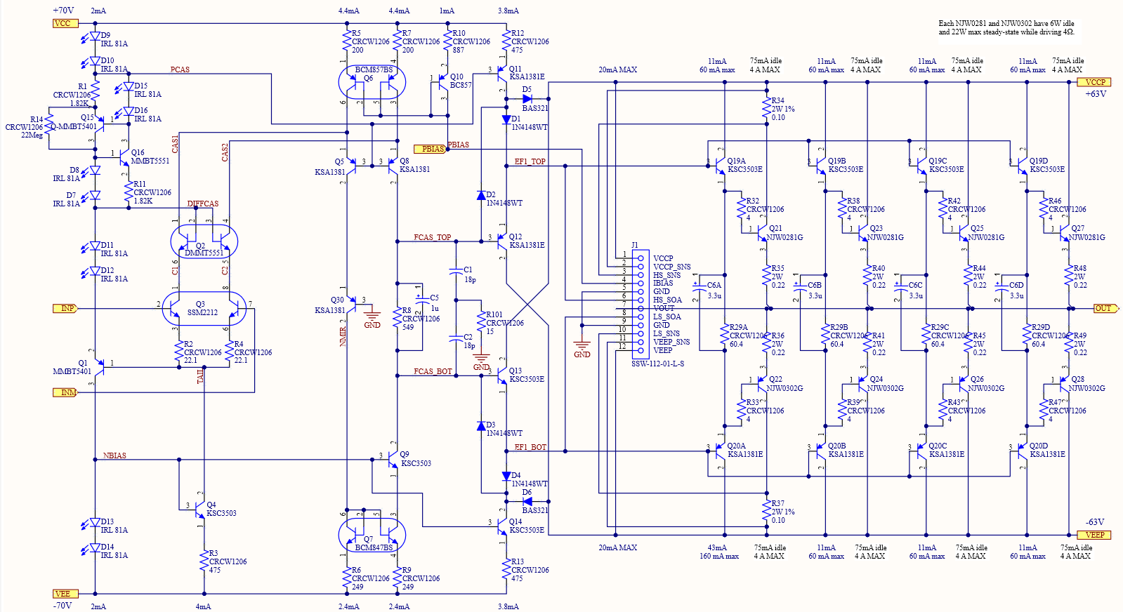

I'm going to take these as I get them. I got a little out of order because stinius' change to my anti-sat diodes was easy. Next, I need to show what I found with ojg's proposed change to a CFP triple from the present diamond EF triple.

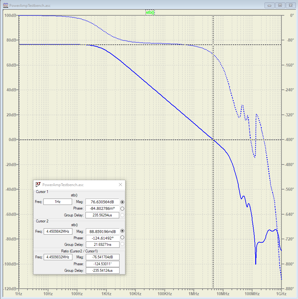

Here's the schematic I drew, and the compensation I ended up with. The CFP triple has lower BW than the EF triple, so I had to increase the compensation. At the same time, low frequency loop gain dropped by 12 dB compared to the 3EF. The 1st Bode plot shows the CFP gain/phase, and the second shows the 3EF gain/phase.
THD at 20 KHz is 49% higher (0.0049% increased 0.0073%) and THD at low frequencies is 9.4% higher (0.00034% increased to 0.00037%). The FC + diamond 3EF is still the preferred design.
That is true, the bandwidth of the EF triple is higher, although in my sim it shows that 30 degree phaseshift appears at 15MHz for both when outputting full negative 56V into 4ohm. So I didn't think the difference in compensation would be that much.
The input impedance of the CFP triple is about 8dB lower than the EF triple, so that probably explains the difference in loopgain at lower frequencies.
Some questions:
Why is your C101 and C102 unequal in the schematic above?
Did you optimize the bias for the CFP triple carefully? If the currents indicated on the schematic is correct it seems quite underbiased. I found that 120mA in the driver and 94mA in the output transistors gave the least THD at 20kHz/20V/4ohm output. The THD goes up quickly with underbiasing, but is quite tolerant to overbiasing.
About the name "CFP triple", I'm not so sure that's what it should be called since it can be confused with the more common CFP configuration where the drivers are also class-B. Maybe "decompensated CFP" or "class-A driver CFP" is better? Neither of them very catchy names, I admit...
