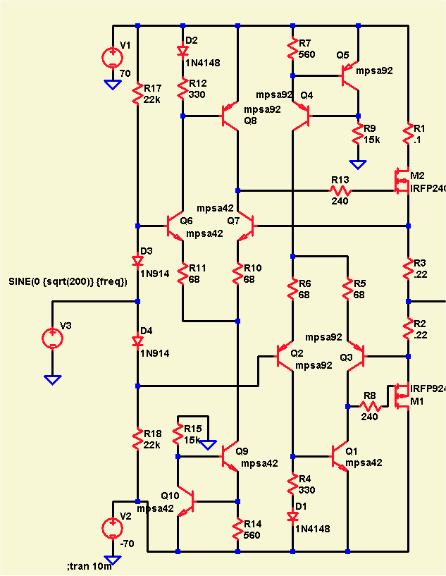

I have done further experiments with IIC and TPIIC, and I was able to get good stability with a 6 dB increase in loop gain between 2 kHz and 20 kHz. However, it had no effect on distortion. All significant distortion in this amp seems to be in the output stage. IIMC specifically excludes the output stage. That also confirms that the folded cascode input/VAS stage contributes almost nothing to the amp's THD.
A few posts back, I looked at the effect of input RE degeneration, and found that lower RE gave lower amplifier THD. However, lower RE boosts the Gm of the input pair, requiring a proportional increase in the compensation caps, thus lowering slew rate. What I need is a way to increase the gain that does not require an increase in the compensation caps. By accident, that is what happened next.
I looked at increasing the bias current of the pre-driver stage. Increasing it makes distortion go up, not down. So, I tried decreasing it, instead.
The sweet spot for pre-driver bias seems to be around 1/2 the current I was running before, so about 3.8mA in the pre-driver.
Ibias ---- THD <1kHz ---- THD 20kHz
7.5mA --- 0.00045% ----- 0.00163
2.8mA --- 0.00028% ----- 0.00150
In the schematic this changes R12 and R13 from 249 to 475. The folded cascode input/VAS is looking close to final form.
My intuition was that increasing current would increase the linearity of loading on the VAS. I was wrong. The loading is already quite linear. Pre-driver current is fairly constant vs signal swing. The pre-driver adds linearity to the VAS, but more importantly, it adds gain to the VAS. The increased loop gain corrects output stage distortion.
Next, I will look at optimizing the driver stage to reduce THD. When I changed out the KSC2690/KSA1220 for multiple KSC3503/KSA1381, distortion went up significantly at low frequency, but down at high freq. I will check THD vs driver-stage current. I do not have any intuition about whether the driver bias current is too high or too low. Perhaps some other circuit change would help.
The output transistors are pretty well optimized wrt Oliver effect, but I'll re-examine that, too.

The key thing I have learned today is that a folded cascode input/VAS stage has almost zero non-linearity, relative to the output stage. This is not mentioned in any literature I have seen. (I'm sure Scott Wurcer knows it, however.)

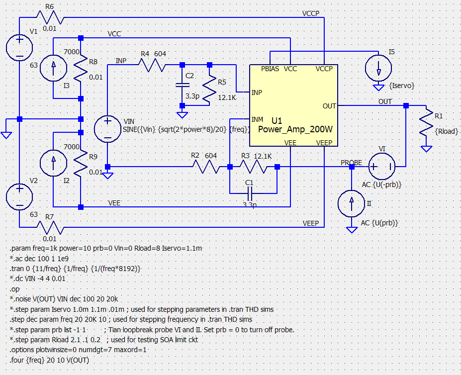

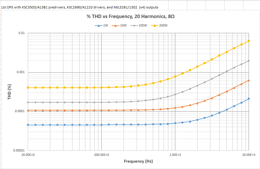

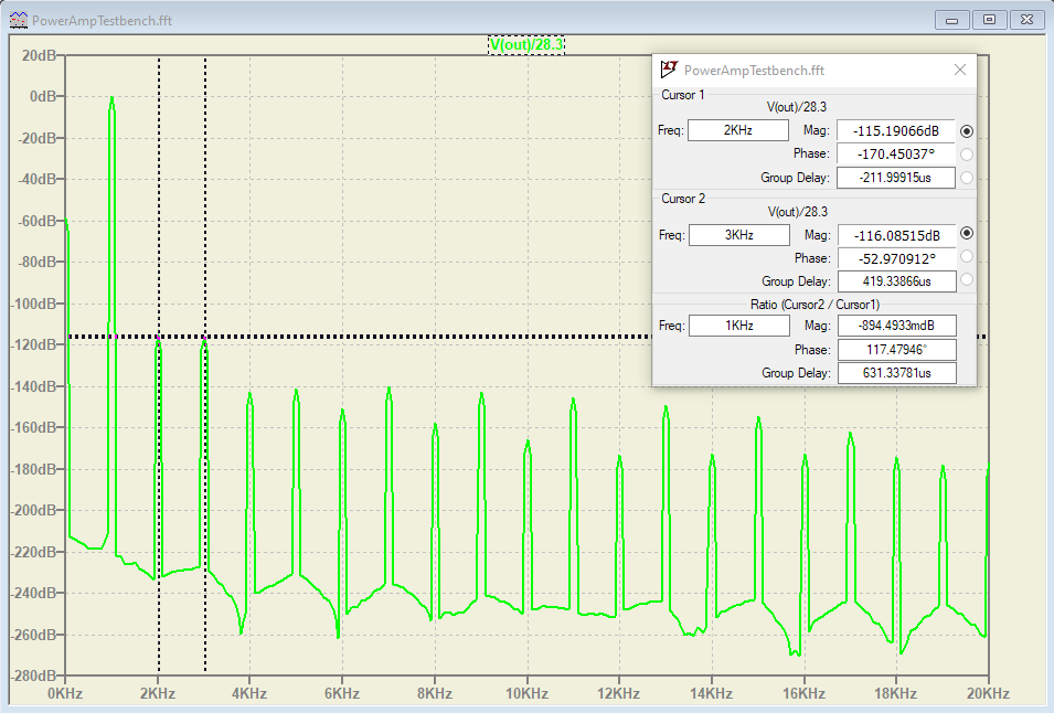

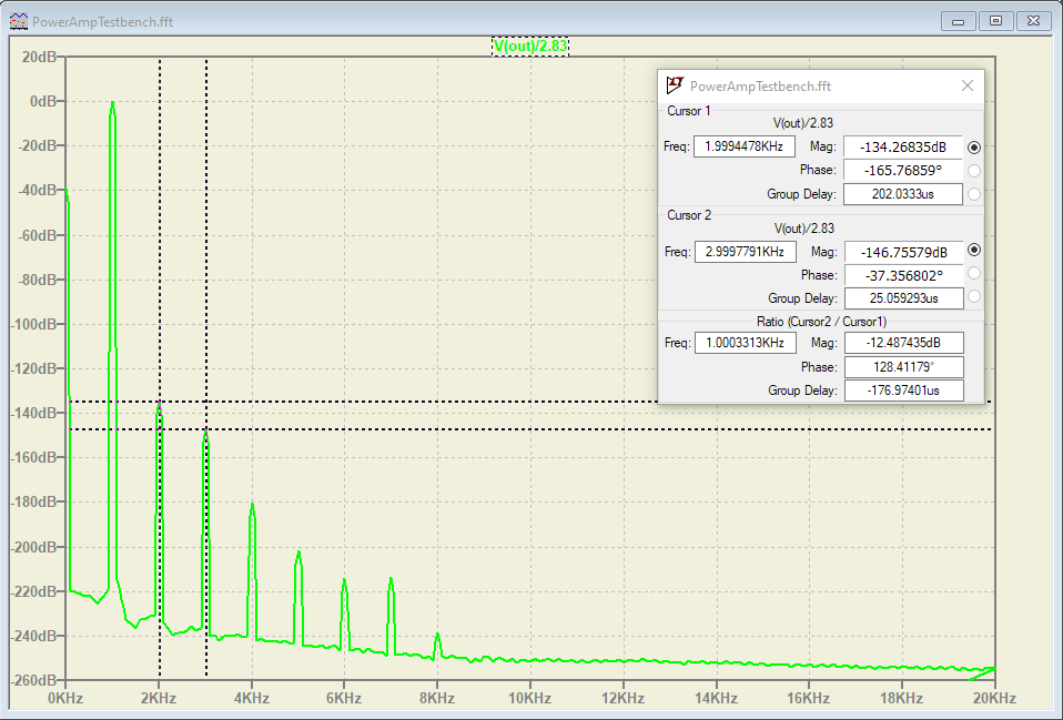

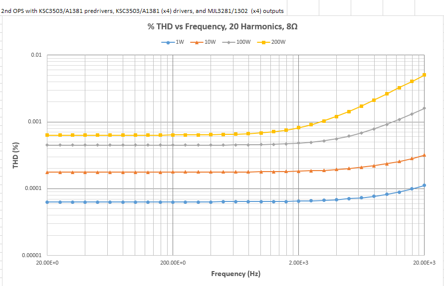

Update: Output stage optimized
Ten days ago, I said I was going to optimize the output stage. Then I got busy at work, and had to put this aside for a bit.
The optimization has gone better than I expected. To review the evolution of the performance so far, I'm attaching the THD vs freq & power plots of
I'm also attaching the schematic in its present state, the testbench schematic, and FFTs of the latest amp at 1 kHz and 1W, 10W, and 100W. Finally, I have attached the amp netlist and .asc file.
I think the low frequency circuit design is finished. I had hoped to get high frequency THD lower, but the low frequency distortion is a lot lower than I expected. Two-pole compensation may help me, now that the output stage distortion is a lot lower. For the record, I do not expect to realize 20u% THD or even 100u% THD. Like Camelot, it's only a model.
Then I'll decide if I want a DC servo to kill offset. Then I need to decide how I'll do speaker protection, and how I'll generate the 70V rails. I already have the transformer, rectifiers, and rail caps chosen.
- The original circuit with KSC2690/A1220 drivers.
- The revised circuit with 4 each of KSC3503/A1381 as drivers.
- The revised circuit with pre-driiver and driver currents optimized. Output is also boosted a bit, from 70mA per let to 100mA.

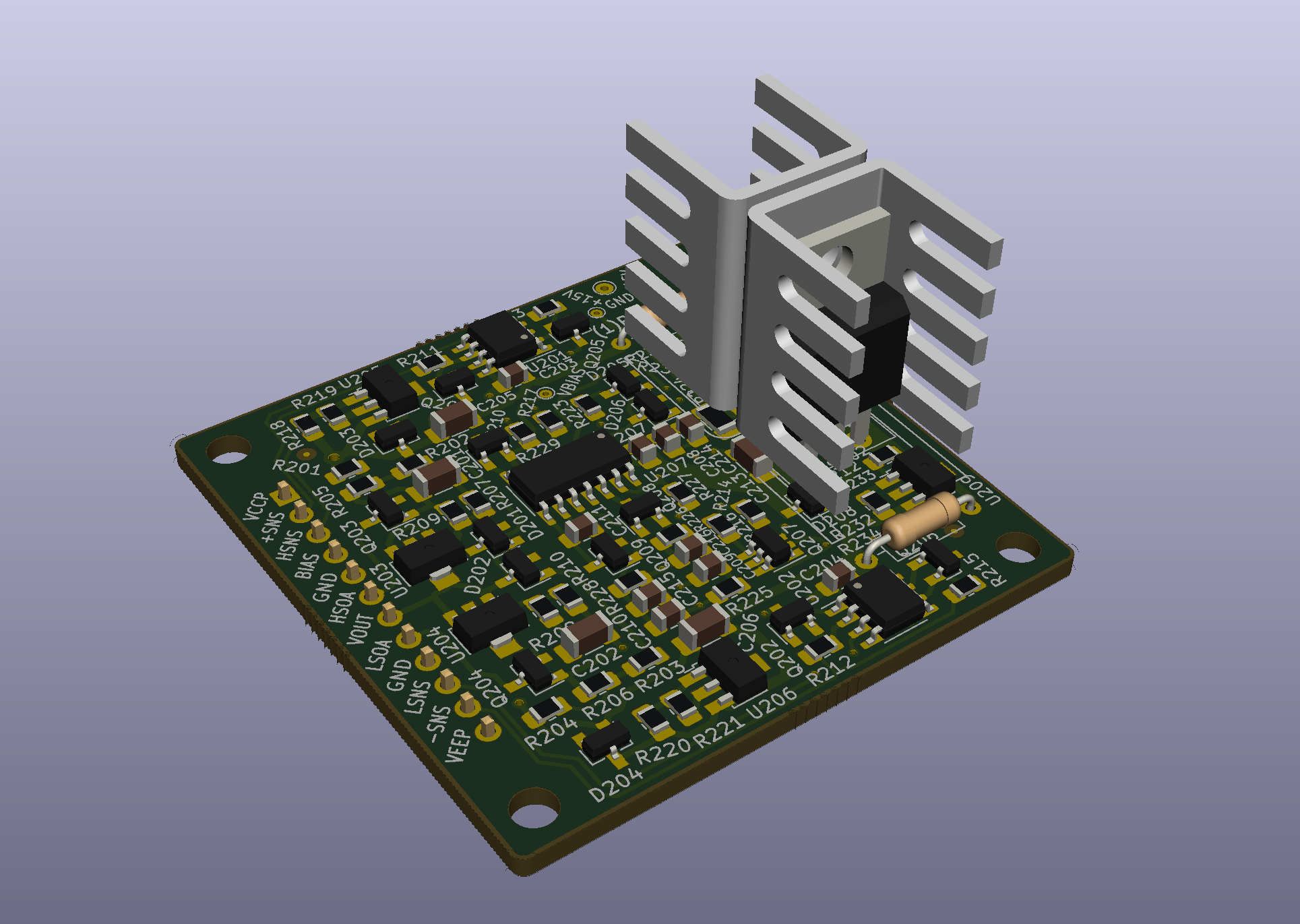

SLABS layout update
The SLABS layout update is done. With the two TO-220 passing transistors and their heatsink we are still on the 2"x2" PCB formfactor.
The heatsink is the inexpensive ATS-PCB1072, available at Mouser and nearly all venders. The transistors and heatsinks are bolted back to back with a couple of flat washers or a spacer in between the heatsinks to keep an air gap. I think that will be a very sturdy installation.
Below is the 3-D rendering. The through bolt, insulator, thermal interface material, and the spacer are not shown. The KiCAD schematic/layout files will follow soon.
Russell, I'm not sure this concern I have is valid or not, that the simulation suggests the TL084 would draw 5mA each opamp, totaling 20mA for the package. That makes a dissipation of 600mW at +/-15V, 88% of its 680mW limiting (up to 60C amb). I didn't realize it until you pointed out those passing transistors in the rail regulators have to be TO-220 and be heat-sunk.
The simulation seems to work fine with +/-12V, though I did tweak the resistor divider to maintain the same Vref. Would you think lowering the supply by a few volts is a good idea?
In addition to the output stage changes, R5 now has the same value as R7 🙂.
I had been wondering what your thinking is regarding current mirror design and balancing of base currents.

Hi, Jonathon,
I had tweaked R7 to zero out the DC offset of the amplifier, for open loop studies of DC transfer function. I never intended for the final amp to have different values for R5 and R7. OTOH, I may yet set them to different values, and inject a current into the emitter of Q30 to zero the amp's DC offset.
It doesn't hurt anything besides offset for those two currents to be slightly mismatched. In this case, I was correcting input offset, making the input pair run exactly the same current.

That looks really good. I'll be happy to see the files.The SLABS layout update is done. With the two TO-220 passing transistors and their heatsink we are still on the 2"x2" PCB formfactor.
I'm not using the standard TL084 here, but the TL084H. Each op amp draws about 1 mA. Datasheet from TI says a regular TL084 draws 1.4mA/op amp, 2.8mA max. So, power dissipation should be around 1/3 of what your simulation shows. SPICE models for op amps often get supply current wrong. Many of them don't draw current from the supplies at all. The vast majority of TL084 are powered from +/-15V, so I do not expect problems.
Regarding the lower supply. The lower supply slightly limits how fast the op amp can pull the minimum hold cap down, but it should be negligible. +/-12V is fine, but should not be necessary.
