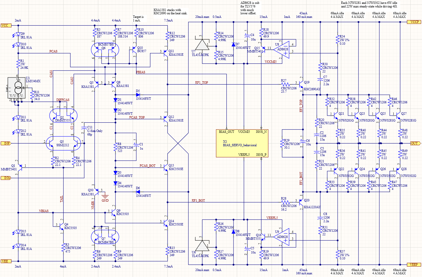

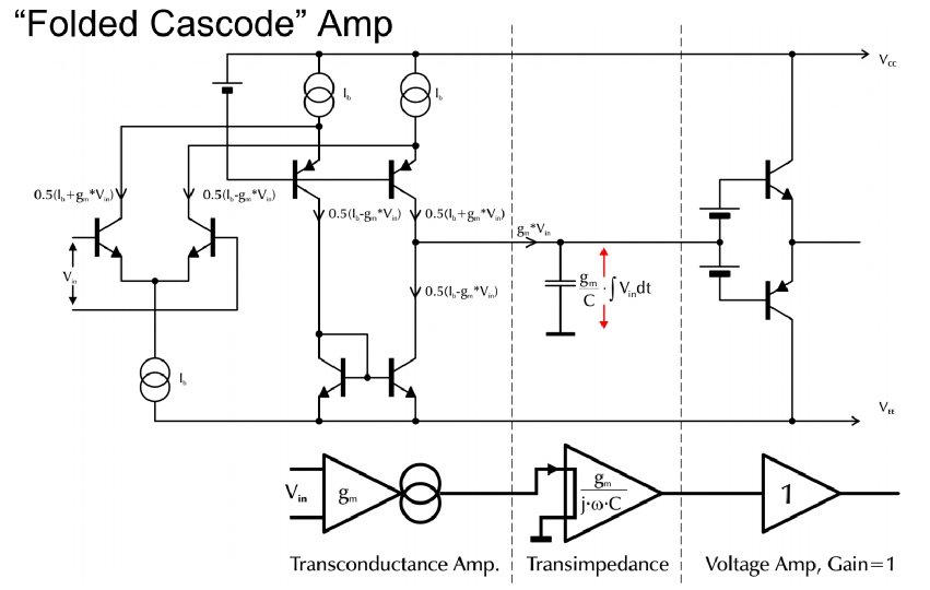

I put a 56u capacitor because that's why I have it. However f = 1000000 / (2 * 31.14 * 680 * 56) = 4.18 Hz is small enough. Through the bootstrap the 4 ohm load resistance will be in parallel with 680 ohm / 2 and its effect is insignificant. I have attached the simulation in MicroCap.
Looking more closely at the diagram I saw that it is not necessary for the bottom of the controlled current generator but only a repeater configuration is sufficient. This is because we are only interested in the sum of the two currents and we are not interested in the value of each current. It simplifies the scheme. After that I removed the comparator transistors, his place being taken by the second tl072 from the capsule. It is possible because the input to tl072 is with jfet and has high input impedance and does not affect the voltage on C54. And so the scheme is simplified even more.

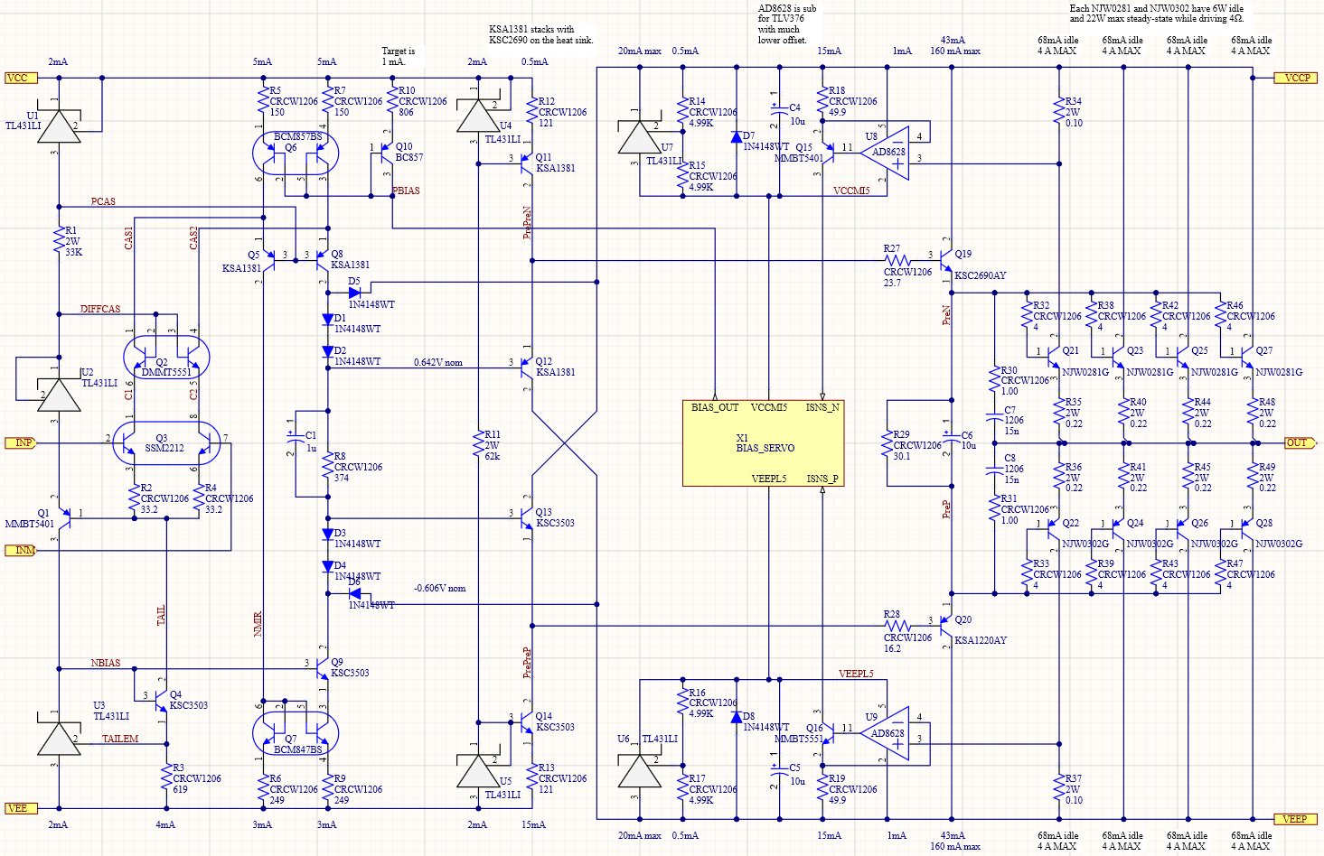

I finalized the scheme and made a test plate. In my opinion it works very well. I attached it to an amplifier built by me recently that had the connection terminals for an autobias. We matched the currents through the final transistors to about 180 mA so that at the input we have about plus-minus 39 mV. Having six irfp240 / irfp9240 transistors the idle current is about 1 A. I would like to hear opinions, criticisms, observations about this autobias.

I would have to see if the floating nature of the circuit affects its performance, as well as the performance of the amp. My initial impression is that it should be OK.
--Russell
Thanks for the continued interest in my amp design, and particularly the autobias circuit. Aksoboro's implementation is nice, but for my design, I'll stick with what I have.
Work is crazy for me right now. I'm trying to do an extremely high speed RF A/D converter. Poring through IEEE papers for architecture ideas and trying to innovate a couple of my own. The whole amp project got started in the Covid shutdown, while I was waiting for my previous IC to come back from the fab.
My feelings won't be hurt if someone picks this up where I left off. My original curiousity was how good an amp I could make with a single gain stage (folded cascode = 1 gain stage). The answer is a damn good amp. The other answer is that the classic "blameless" amp with two gain stages has an edge over this, along with more flexibility for 2-pole and output inclusive compensation to deliver the very highest overall linearity.
Still, I think I will eventually build this one, even if I have to wait until I retire.

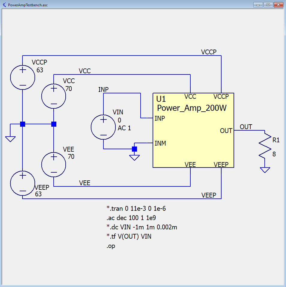

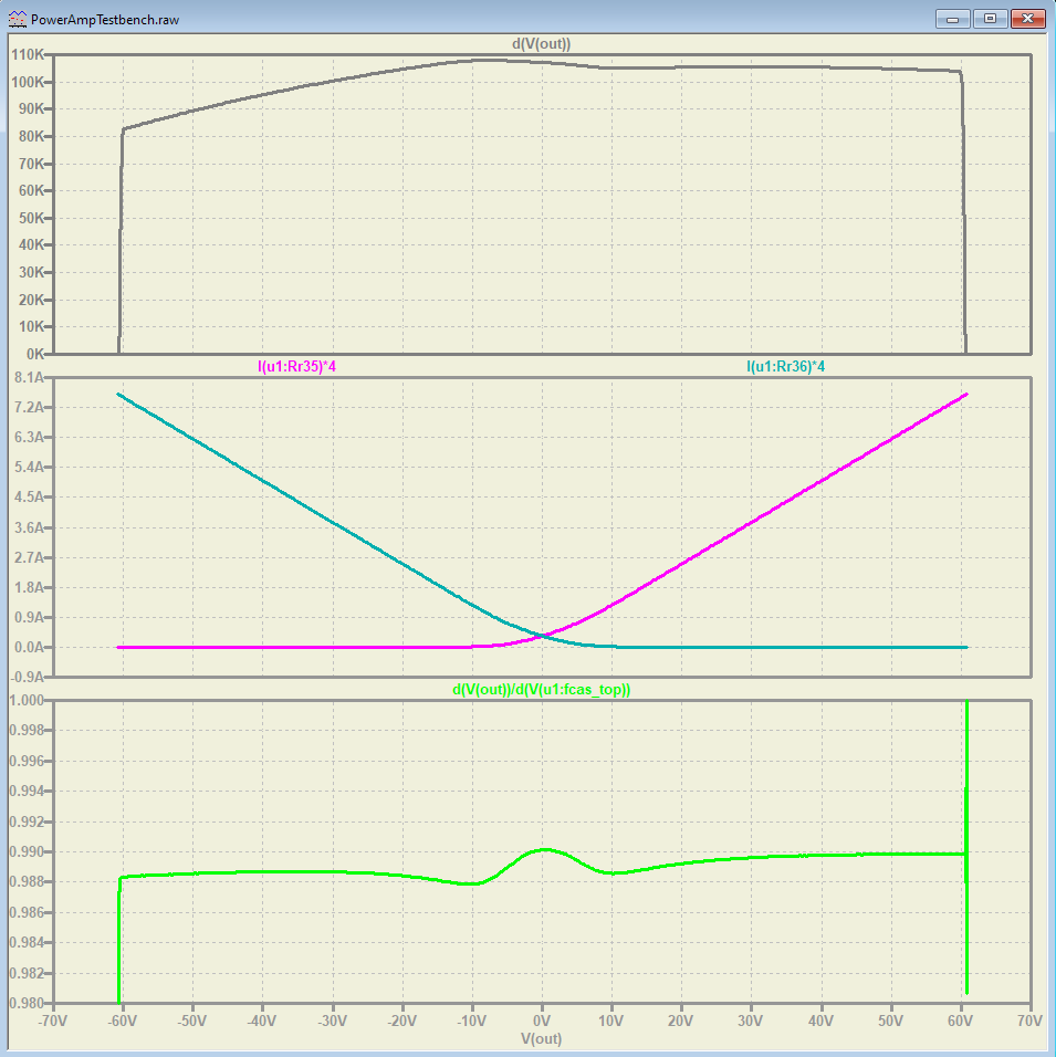

#156,Power_Amp_200W.asy
You need to change line 15 "Kinder\Documents\Audio_Designs\Circuits_PCBs\Power_Amp_200W\Simulation\Power_Amp_200W.net" to "SYMATTR ModelFile Power_Amp_200W.net" to simulate.
