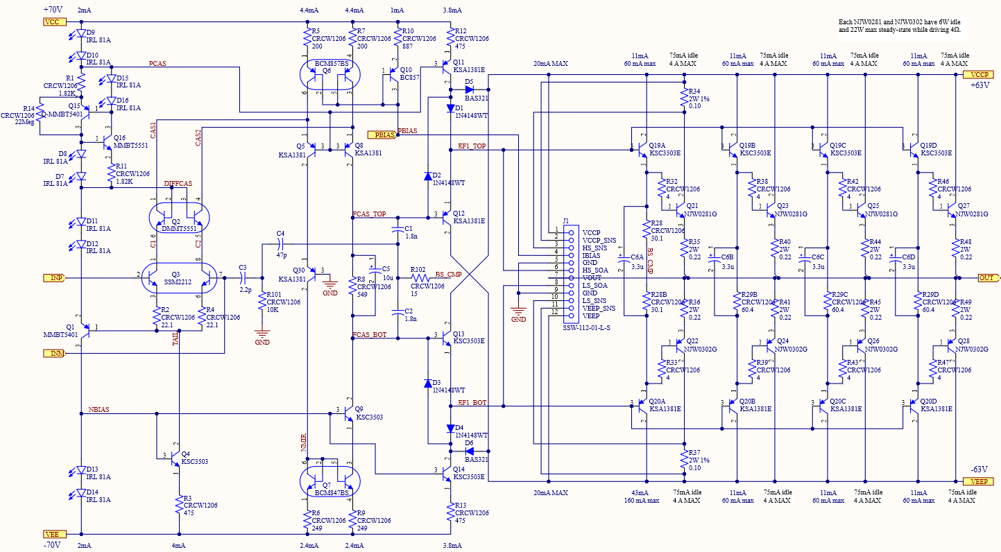

C101 and C102 were actually equal in my sims at 39pF, but I happened to take that snapshot while changing them to 68 pF, for a subsequent sim. Sorry for the circuit typo.
I set the bias in the output transistors at 75mA each, same as in the comparative sim I ran with the EF triple. The EF triple is very tolerant of a fairly wide range of bias currents.
I do not recall the exact current in the driver transistors. I used the same values for Rc and Re that you did there, but my ballast resistors for the finals were larger, so probably the driver bias current is a tad higher. I think it was in the 100 mA range.
You're right about the CFP triple. There are lots of circuits that could describe. Class-A CFP is kind of catchy, but could mislead folks that the whole OPS is class A. I'll leave that one to the marketing department. lol. To really use the CFP, I would need to insert a Tian probe into the current feedback path, and wring it out.
The folded cascode gain is very sensitive to input impedance of the OPS. That is somewhat how I ended up with the OPS configuration that I have. I wish I could get the predriver and driver poles out past 100 MHz, with the final pole at 20 to 30 Mhz. That would let me get the BW that I originally wanted. I may yet play with bias currents at each stage to get more BW for the overall circuit.
Before I posted any circuits, I did a lot of experiments with several stand-alone OPS circuits, including one very like the one you showed. At that time, I was looking for highest BW and highest input impedance. The diamond 3-EF is the only one I actually tried in the full amplifier.

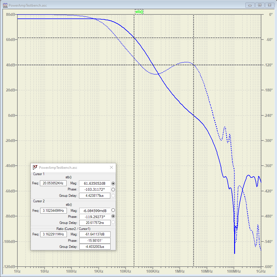

OMG. I'm trying this circuit, and it's still very preliminary. I'm getting these results. This seems like it will be awesome.
ULGF = 3.2 MHz
PM = 60.7 deg
GM = 10.3 dB
LG @ 20 kHz = 61.6 dB​
Now, the let-down. THD is worse at 20 kHz, and only slightly better for a very small range between 1 kHz and 3 kHz. Bypassing a stage or two of the 3EF lowers the impedance at the FC output. This kills the gain and the linearity correction at high audio frequencies.
I have not given up on this technique, but now that I see how the trade-off mechanisms work, I am less optimistic.

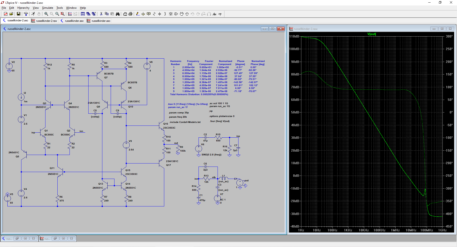

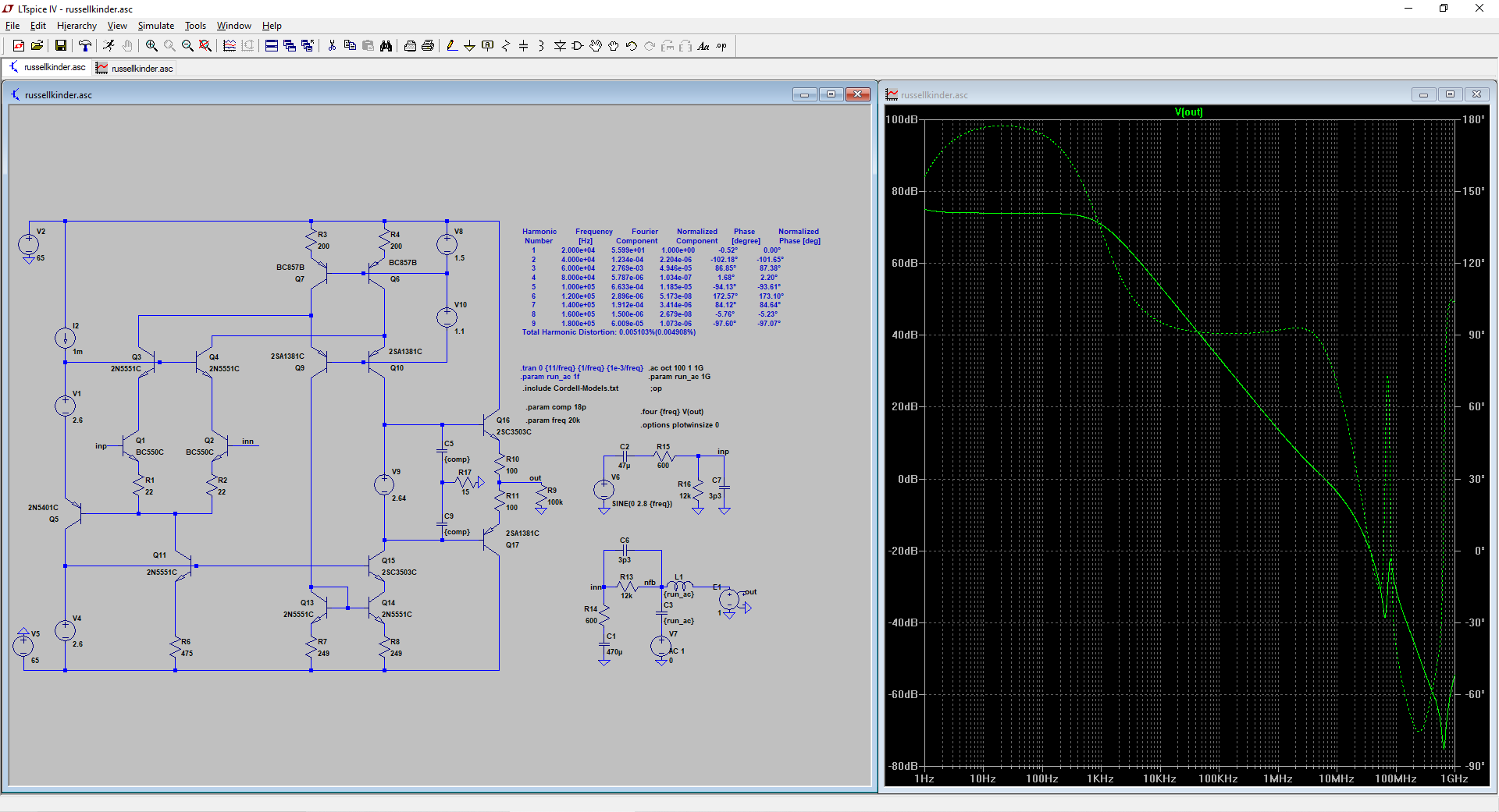

Sorry for even more armchair engineering here, but this thread is so interesting that I can't help myself.
I made a simplified version of your input stage in LTspice, with just a predriver for output stage. I got 0.005% THD at 20k at 56V which matches well your own simulation back in post 114. Which again shows that it is not the output stage that is limiting the THD performance of this amp anymore. I agree with Paul that the FC stage just hasn't got any more to give with these large voltage swings.
Now it struck me when looking at the schematic that by just rearranging two of the transistors, I got a push-pull VAS stage. Compensating this VAS is straightforward and the ULGF, PM and LG@20kHz becomes the same as the FC. The interesting thing is that even though the Bode plot is the same (above 10kHz) now the THD at 20k at 56V is 0.0002%, that's more than an order of magnitude better! Which shows that THD can be reduced in more ways than just by adding more loopgain. Imagine what the number could be when adding two-pole compensation as well! (I'll save you the trouble, it's <1ppm)
I'm not saying you should throw away the FC and go for a push-pull VAS, but that maybe it's time to accept that you got the most from the FC topology and just start building it. I highly recommend splitting input stage and output stage in two PCBs to make it easy to experiment with different architectures later.
