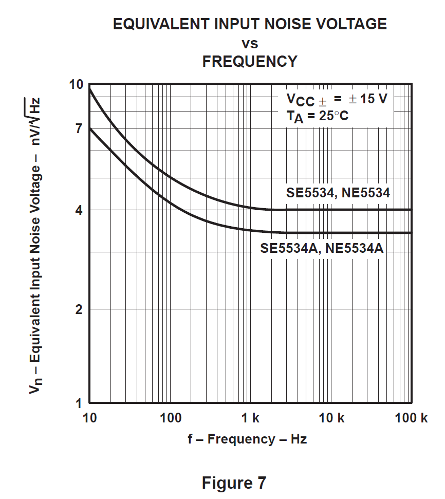

Have you made even a first attempt to determine that the J113 FET's have a suitable noise performance?
It's right there in the datasheet. The noise performance is broadly comparable using an audio op amp for the same purpose. A little better at high frequency, the same or perhaps a little worse at low frequencies. I've shown a bipolar op amp by way of example, a FET input type like the OPA134 is a little worse again.
I meant actually measure a few typical samples. They are not speced for audio and other Fairchild switches need to be screened for audio frequency noise i.e. the spec is typical not guaranteed. For some parts the opposite is true the data sheet looks bad but the yield to low noise is excellent, BF862 for instance.

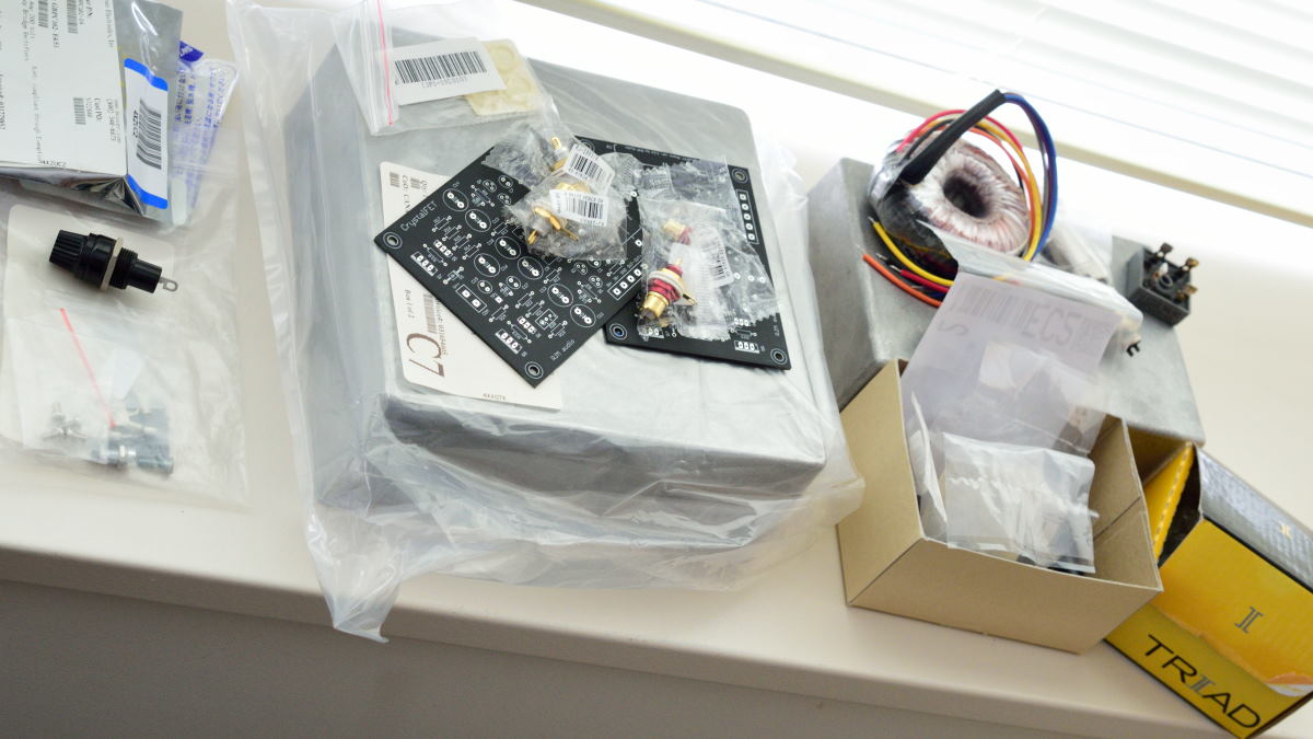

I have all the parts to build this already, except for the actual components on the boards will will arrive tomorrow. Transformer, case, misc hardware right down to the cable strain relief were all in my "parts drawer".

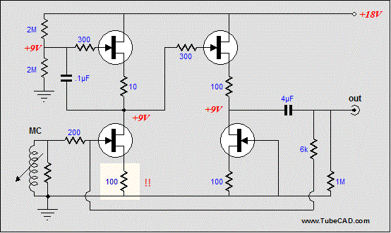

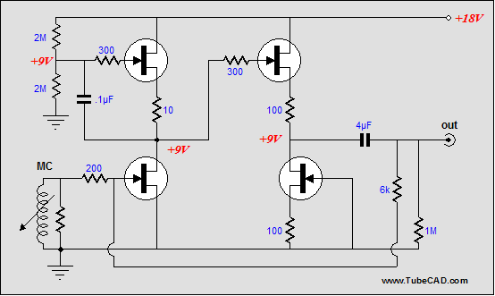

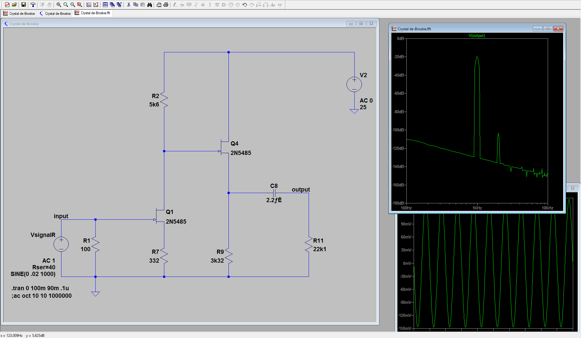

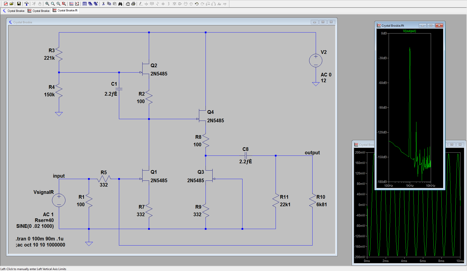

Ok, real quick: a sketch-up of the circuit in the previous post.
note the original circuit is missing the source resistor on the input jfet, I, uh, took the liberty of fixing that. 🙂
(You can also deconstruct the circuit back to the CrystalFET by removing the two CSS stages. You can see the distortion is very similar. Basically what you get for your pains is about 12 dB of PSRR and the ability to run at much lower supply voltages.)

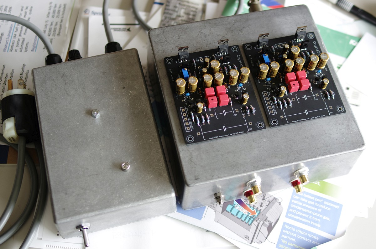

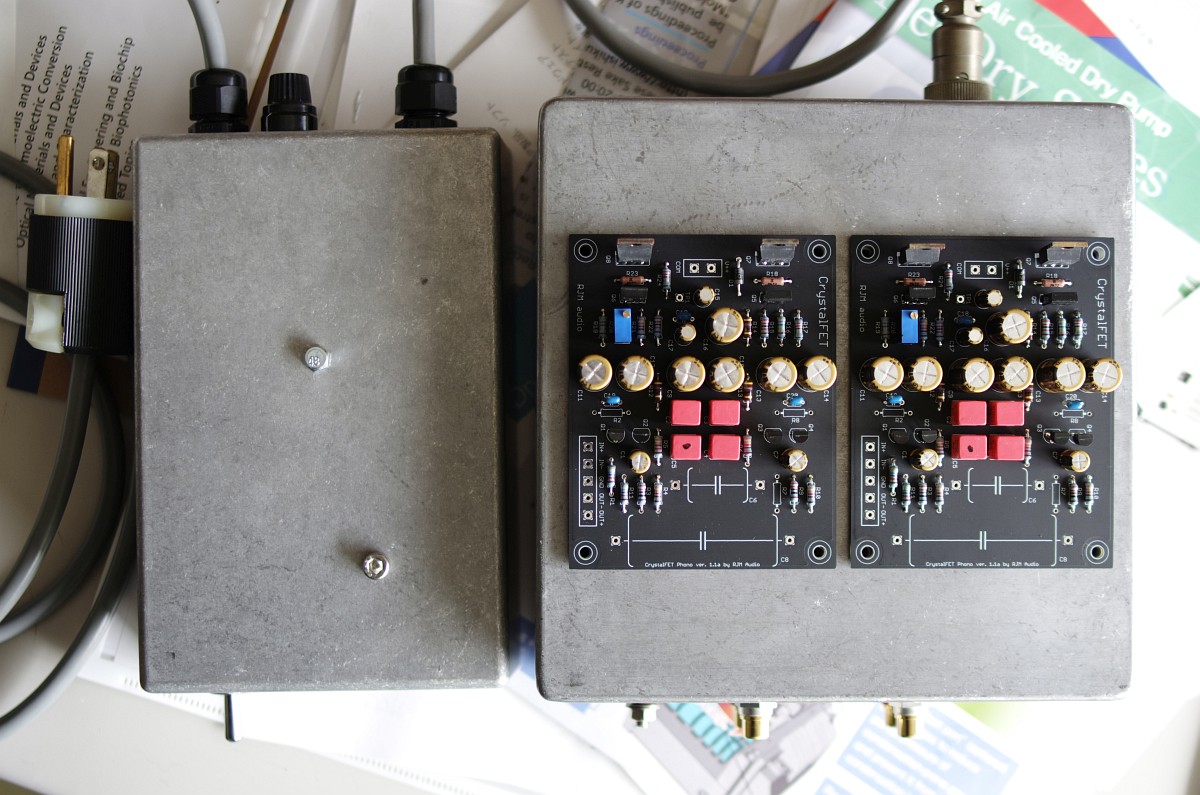

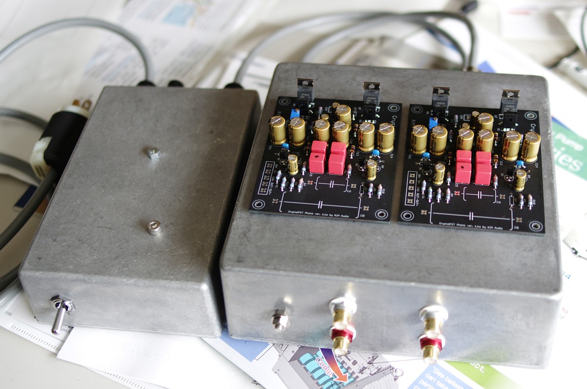

Prepared the CrystalFET chassis and power supply.
I hate this part of the process - drilling holes - but at least it's over with. The power supply is up and running, I just have to finish the boards and do the internal hookup.

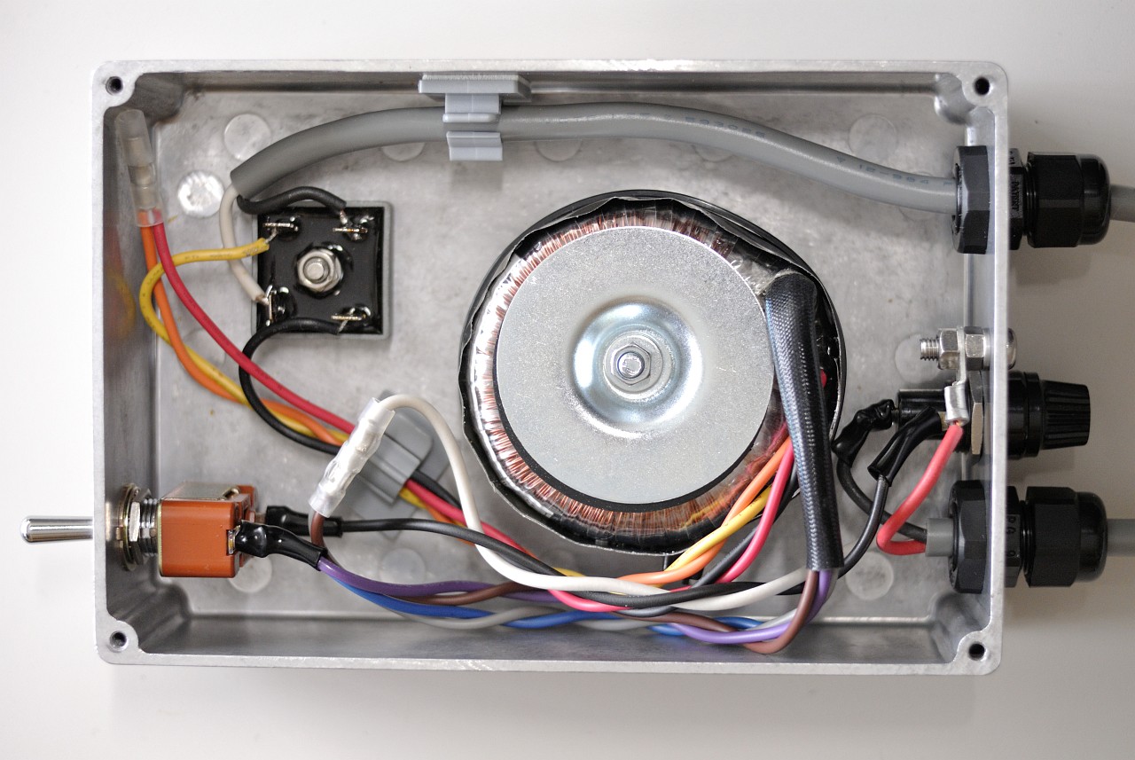

Here we have the insides of the power supply. The transformer is wrapped in Permalloy foil. I should have put the foil inside a metal band as exposed it can cut your finger very easily.

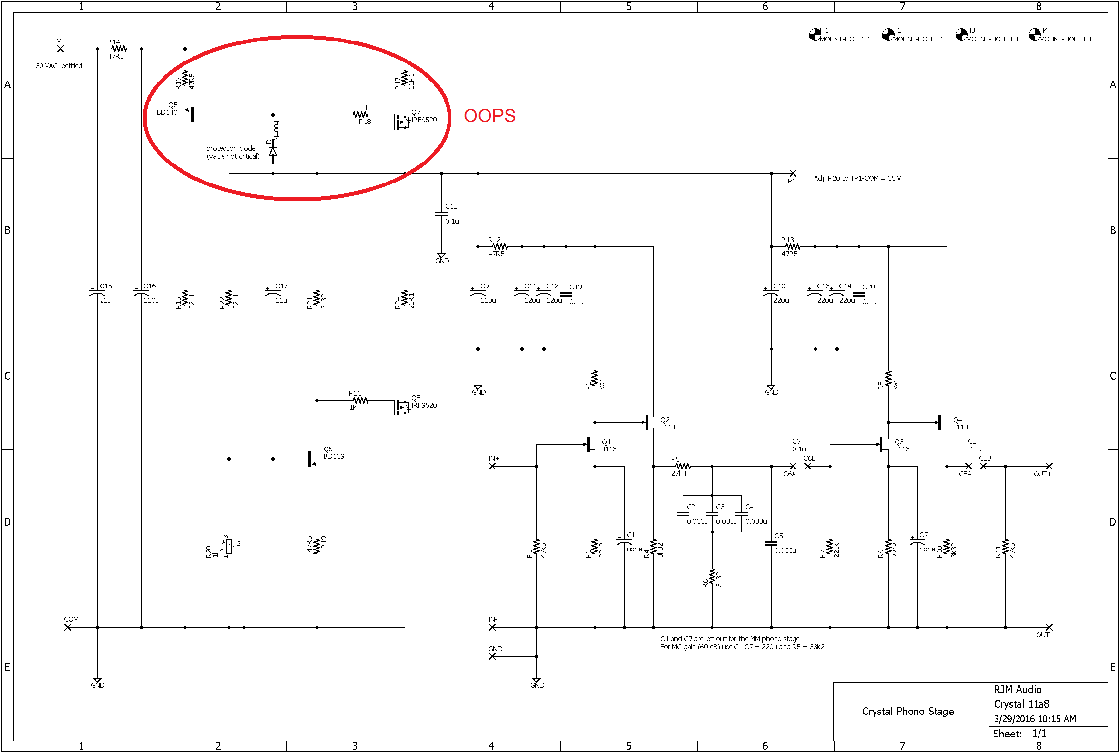

Oops!

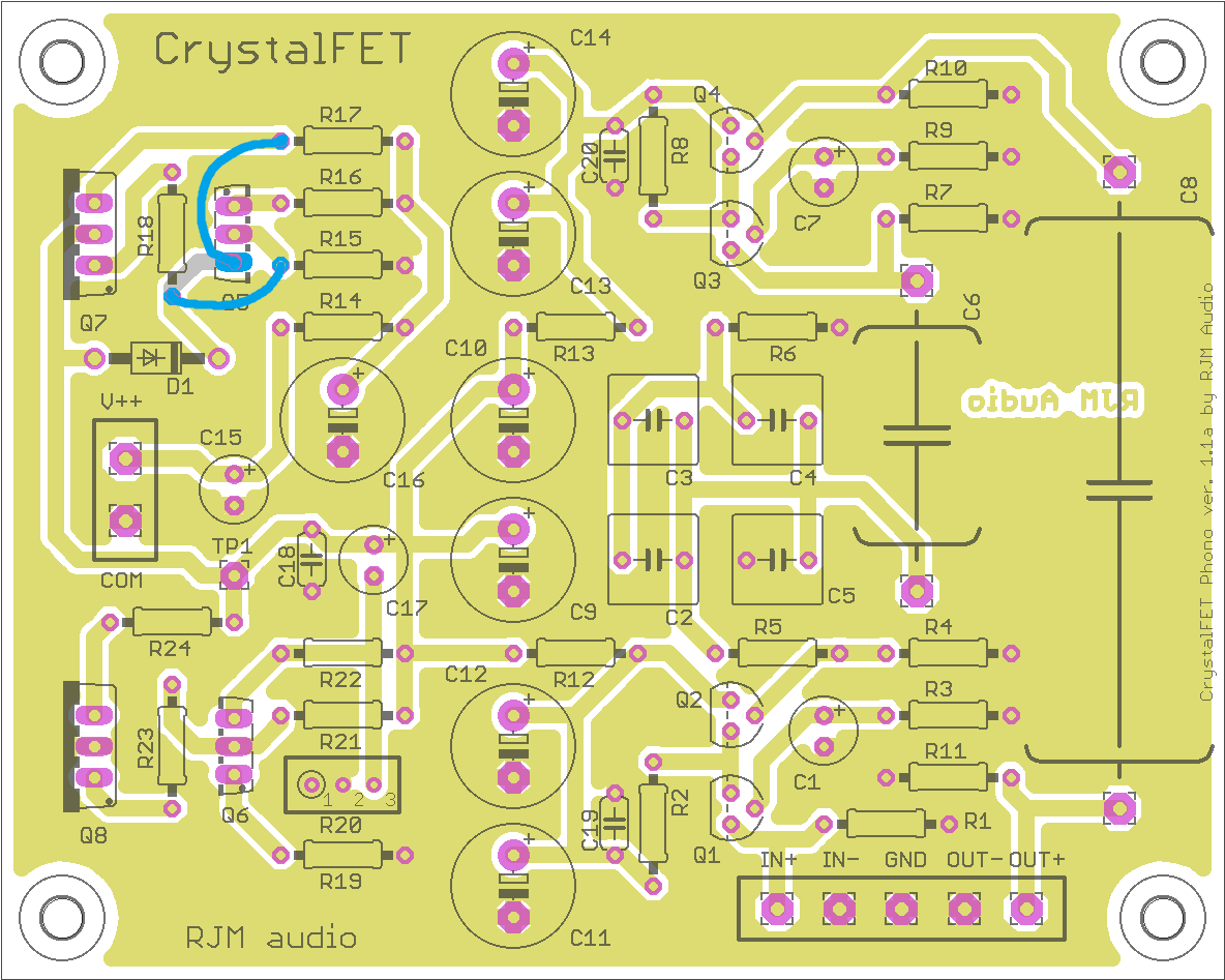

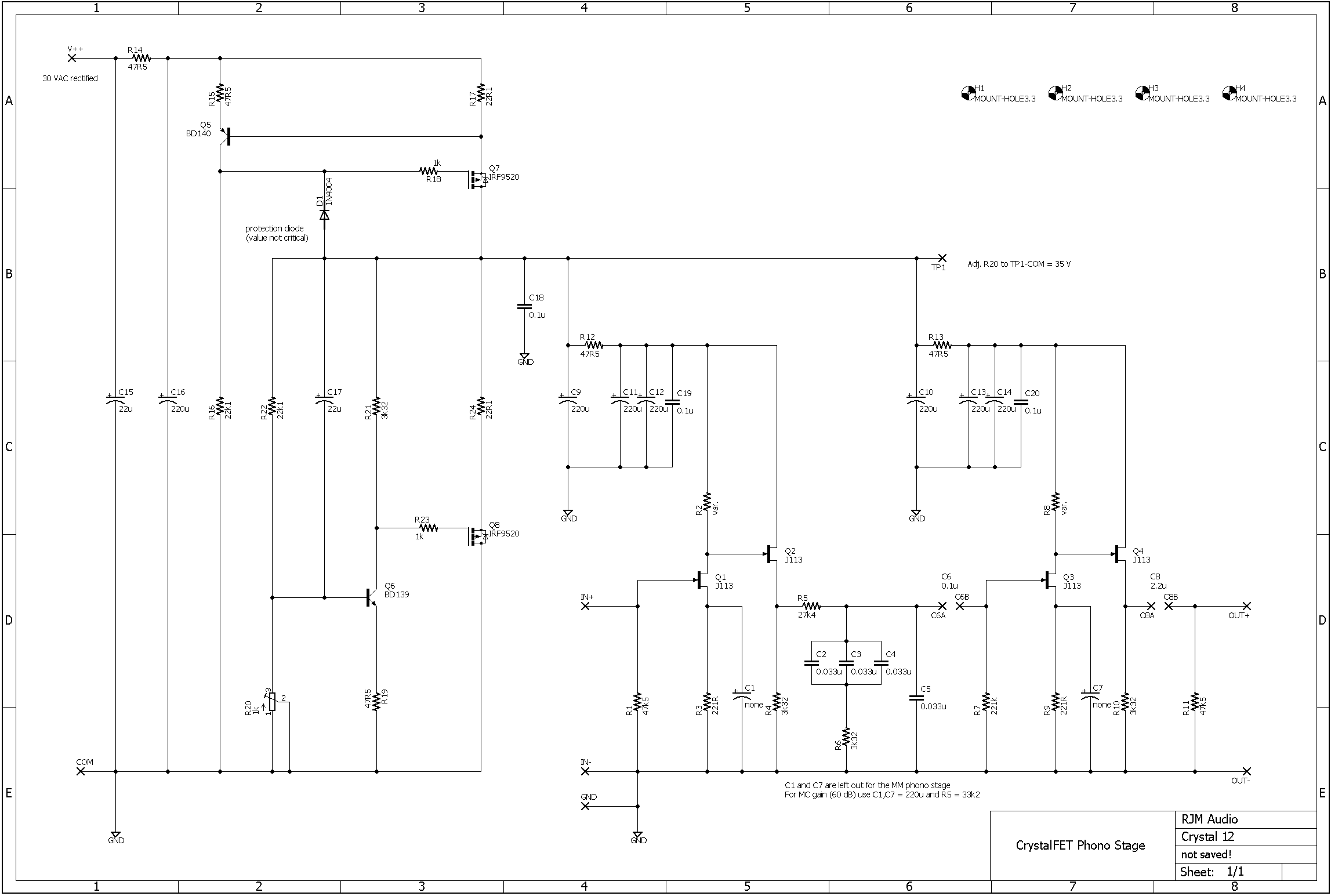

I made an error when transferring the LTspice circuit to Eagle.
Boards need a re-spin. The fix is easy enough, but doing another run will take some time.
Existing boards can be fixed with a trace cut and a couple of flying leads.

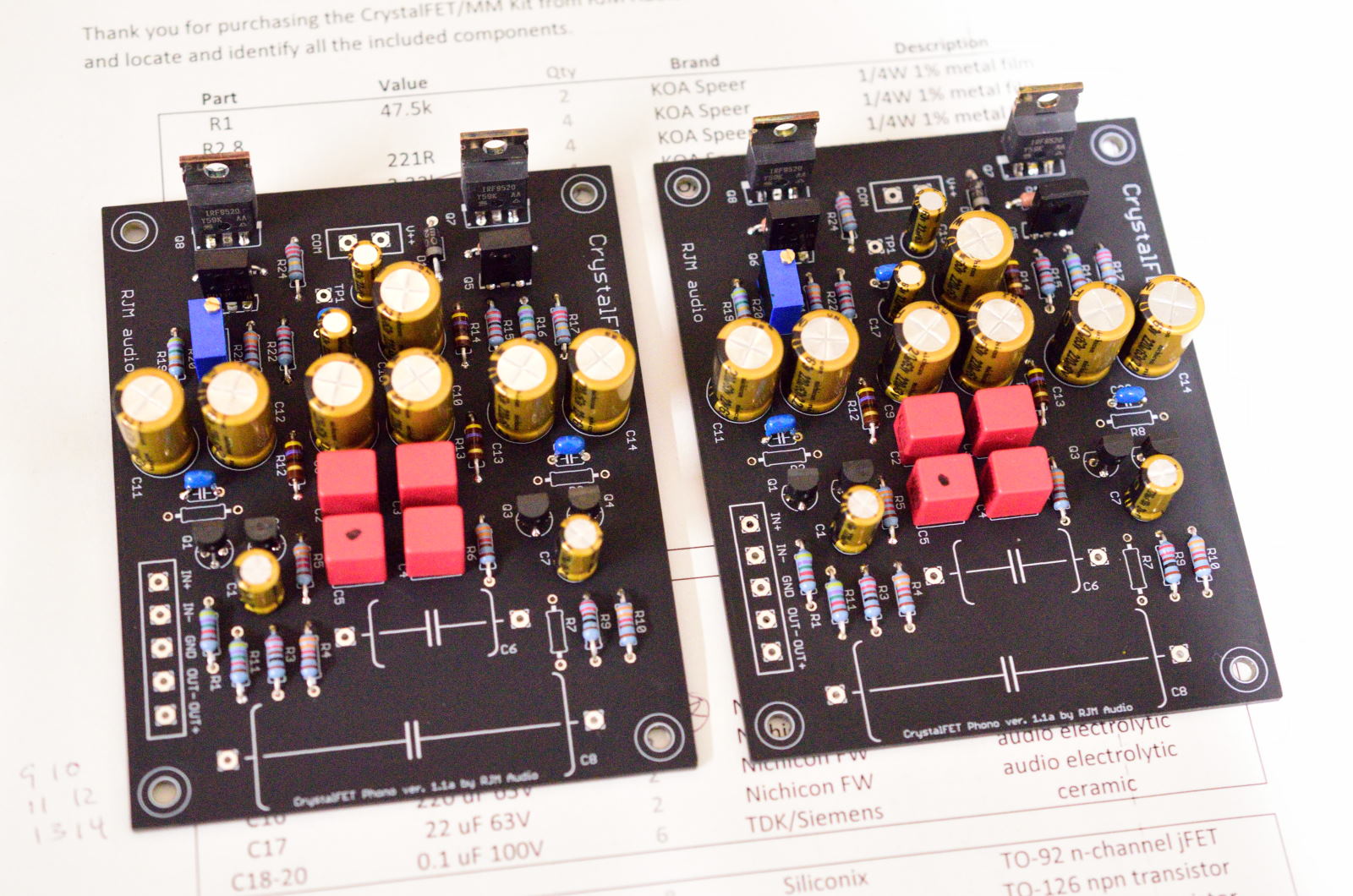

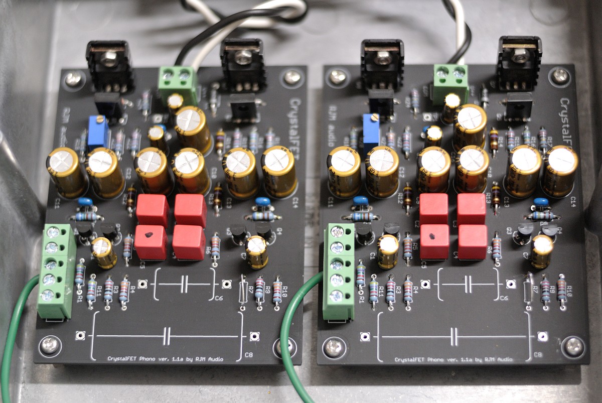

And here it is powered up, DC bias operational state but no signal wiring.
Mosfet regulator section works as expected. R20 full CCW V+ is about 15-20 V, adjusts to 35 V after a few turns CW. Output voltage falls about 1~1.5 V after being powered up for a few minutes. Current source output 30 mA, about 20% less than simulation, probably because the transistors used are different types.
I found the jfets bias a little hotter current than calculated, pulling the drain voltages to between 7~8 V when 9~10 V was calculated. I'm not sure why, but it's pretty close and can be easily redressed by decreasing R2 and R8 a little.

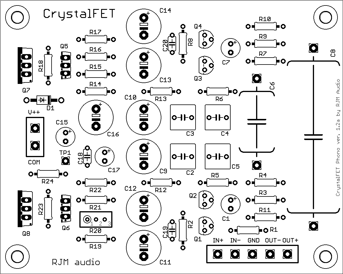

This is rev. 1.2a, with the corrected schematic.
Q5 is rotated 180 degrees, and R15 and R16 have had their parts values exchanged. There are no other changes.
