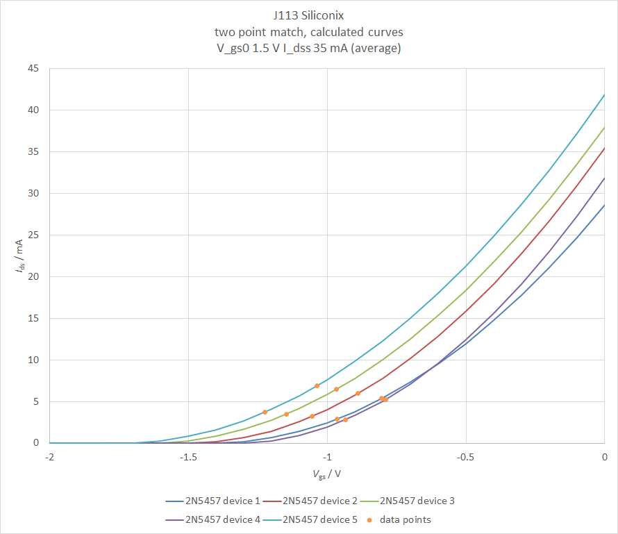

I'm doing better with the Siliconix J113 which arrived from the UK.
These are properly in spec, V_gs0 1.5 V and I_dss 35 mA, close to the center of the datasheet values. The beta is about 15 mA/V^2.
That's a quick estimate. Although higher current than ideal (the five parts I checked are grade C to F2 on my little chart) the circuit is workable at 35 V and finding well matched parts should not be a problem.

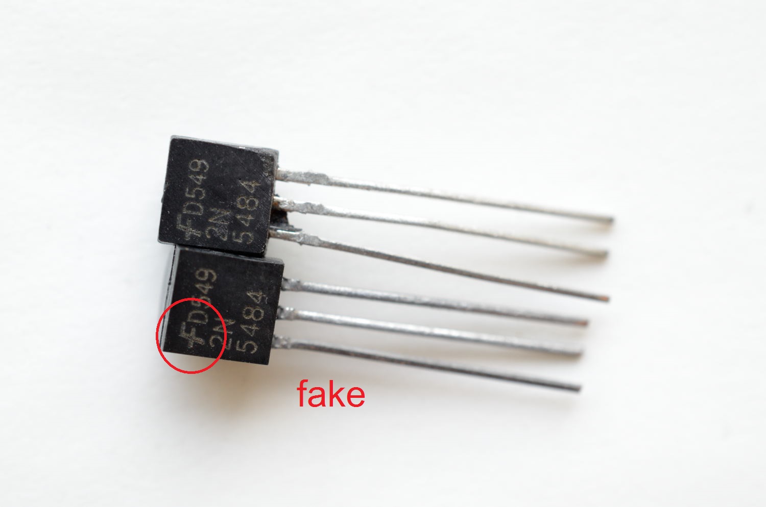

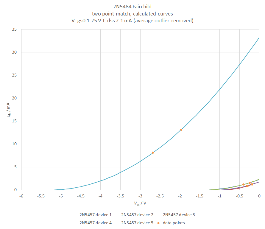

More fun and games with Chinese-sourced jfets via eBay, this time with parts marked Fairchild 2N5484.
The good news is most of them seem to be genuine or at least to-datasheet-spec, with V_gs0 1.3 and I_dss 2.1 mA and a usefully high beta of 1.3 mA/V^2.
But then there's an oddball weirdo in the mix, which measured like a J111. Just to keep you on your toes I guess.
Moral of the story: do not buy semiconductors off ebay from from China-based sellers unless you are prepared to a full screening to properly identify what actually shows up.

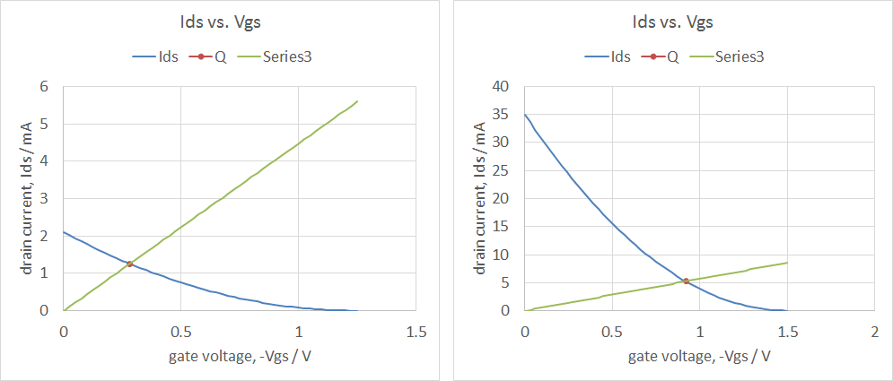

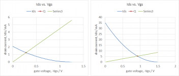

So, after consideration, I have come down to two options:
1. J113 running at 5 mA I_ds from a 35 V supply. 32 dB gain, no bypass caps. [Adding bypass caps, the circuit makes 55 dB for MC use.]
(advantages: high transconductance, low distortion, MC/MM dual use)
2. 2N5484 running at 1 mA I_ds from a 25 V supply. 32 dB gain, no bypass caps or 40 dB with bypass caps).
(advantages: low current, optimized operating point, 40 dB MM output option with bypass caps)
2b. Use 2N5484 as the amplifier, and a J113 or similar for the follower)
I am favoring option 1, though 2b seems to have merit also. It comes down to this: for a given operating current, say 3 mA, is a jfet with higher or lower saturation current more desirable?
Normally it's a non-issue, as higher saturation current means more transconductance (lower output impedance) and lower saturation current means higher gains but in this instance the fact that the J113 can be used at 35 V while the 2N5484 is limited to 25 V, together with the high beta value of the J113 and the degenerative feedback of the source resistors, means that the gain has a certain degree of overlap.
My gut feeling is that if it the gain specifications can be met, then the higher transconductance part is desirable. The concern of course is the existance is some hidden "gotcha" that I haven't considered.

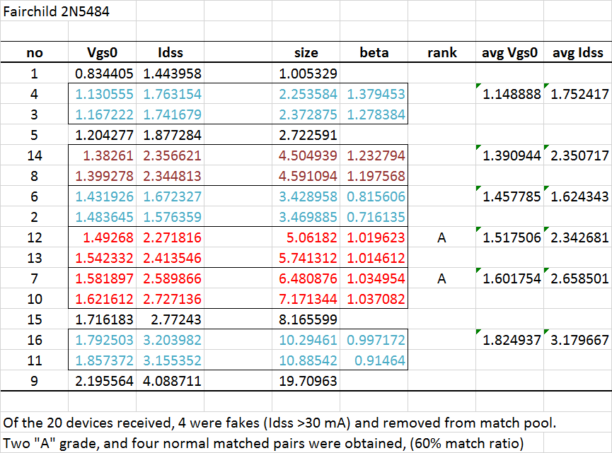

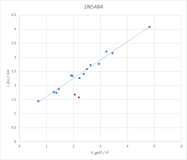

Matching results from 20 2N5484,
4 fakes.
2 "A" grade matched pairs (beta match <3%, beta above 1mA/V^2)
4 normal matched pairs
4 unmatched
* match efficiency 60% (75% if you don't count the fakes) I can build a nice CrystalFET from 20 jfets, obtained off ebay for <$5.
** the fakes are different physically from the actual Fairchild parts. The leads are slightly shorter, the font and logo print less sharp, and there is an "x" mark in the mold stamp on the rear of the package.
*** with a couple of exceptions the plot of I_dss vs. (V_gs0)^2 is a straight line. That means for a given model of jfet if you know the pinch off voltage you can imply the saturation current, and vice versa, with reasonable confidence. In other words It means you can bin (match) by pinch off voltage though for best results the two-point method is still recommended.
**** "size" is my own figure of merit, I_dss x (V_gs0)^2. Basically how far up the line in the plot below. jfets with the same size will tend to bias to the same operating point with a common set of resistor values, obviously important when matching between channels, together with the gain, which is defined by the beta. "Size" allows for a little more compensation that matching strictly to both V_gs0 and I_dss individually, and is more reliable than just V_gs0 alone.
***** The 2N5457 I received from anoter ebay seller appear to be 100% fakes. All short leads, same general appearance as the fake 2N5484, but with a "II" mark instead of the "X" mark in the mold release hole.

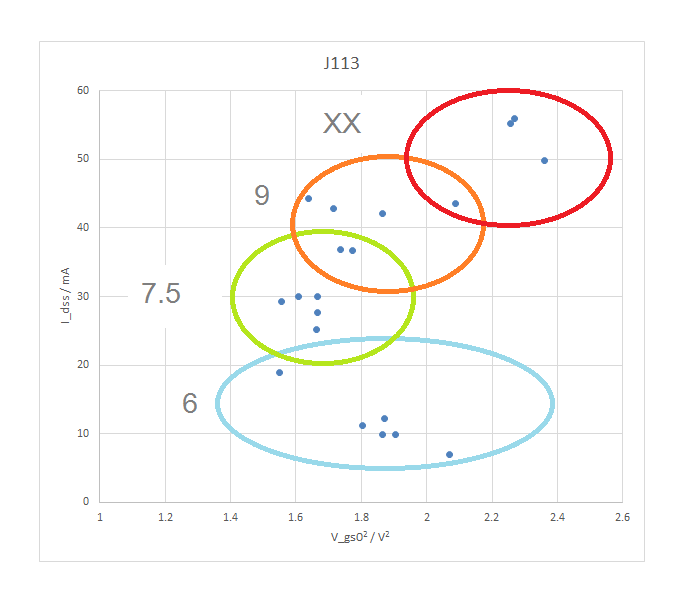

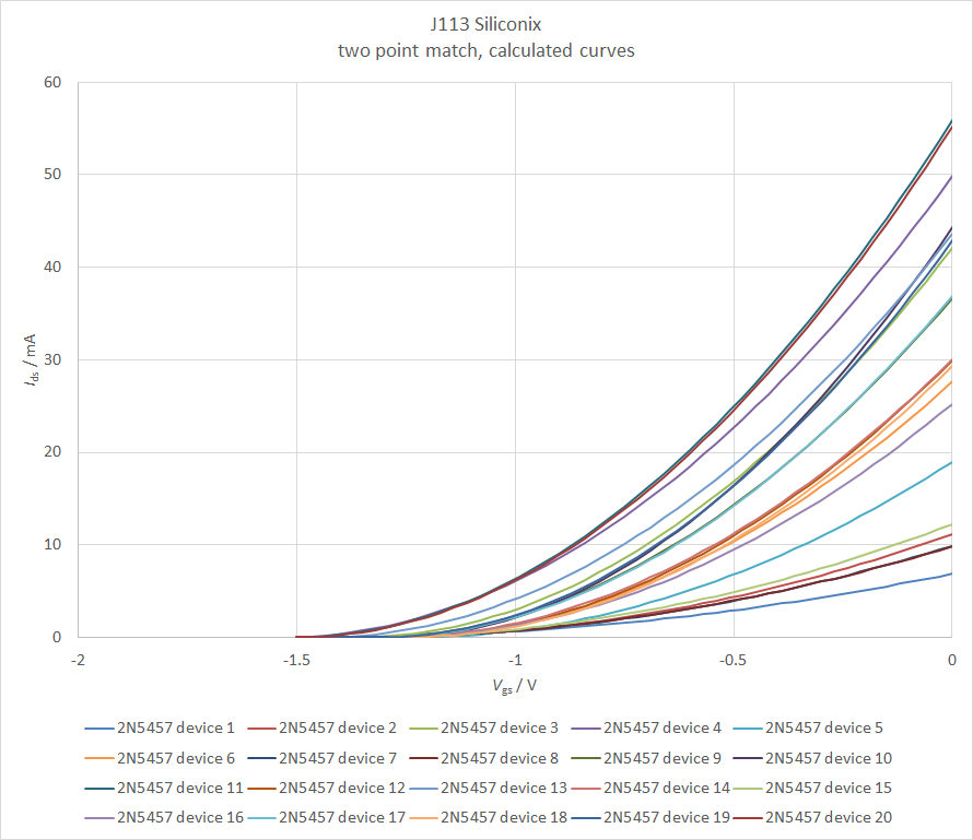

Matching report for 20 Siliconix J113s.
The scatter of these jfets is different than the Fairchild ones I've looked at. The V_gs0 traces an arc as the saturation current increases, so minimum pinch off voltages are obtained for the mid-range saturation currents.
That actually makes them easy to deal with from the point of view of the CrystalFET circuit since the range of pinch off voltages is very narrow, just 1.25 V to 1.55 V. All of the 20 components measured would be suitable, though only 12 were matched, with three of those pairs found to be "A" (amplifier) grade.
The circuit gain is about 32 dB, while adding bypass capacitors would allow the circuit to be used as a 58 dB MC stage.
I have graded the J113 into four bins "6", "7.5", "9", and "XX". The drain resistor R2,8 will be slightly different for each bin, but no other components will need to be changed.

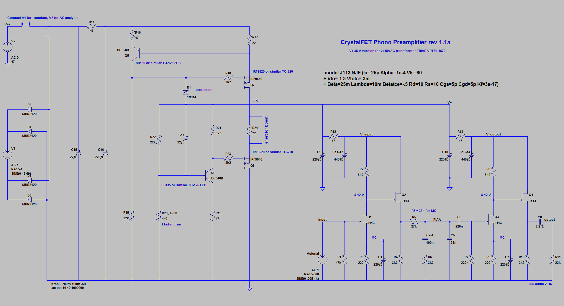

I would suggest you use a dual footprint for the jfets, use a SOT-23/TO-92 footprint. It leaves you with way more options rather than resorting to Ebay for your sources, unless you only plan on making a few of them.
Gain trim pots to balance the channels.
I never could get the level 3 model to work in LTSPICE
I am sure LTC would appreciate your input for improving the functionality 🙂
LTSpice is just a big calculator. For that purpose it is very useful.

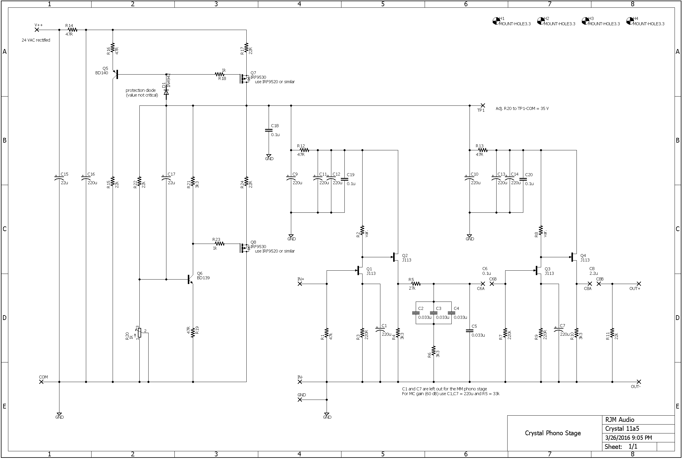

Latest circuit revision attached.
(I considered using trim pots on the source to adjust the bias, but with well-matched jfets in self-biasing arrangement I figured it wouldn't be needed. I'm using "tube logic" in a number of areas with respect to the jfets here, we'll see how it goes.)

BOM updated to 1.1a4.
Several small changes to the components.
Calculation worksheets completely revised.

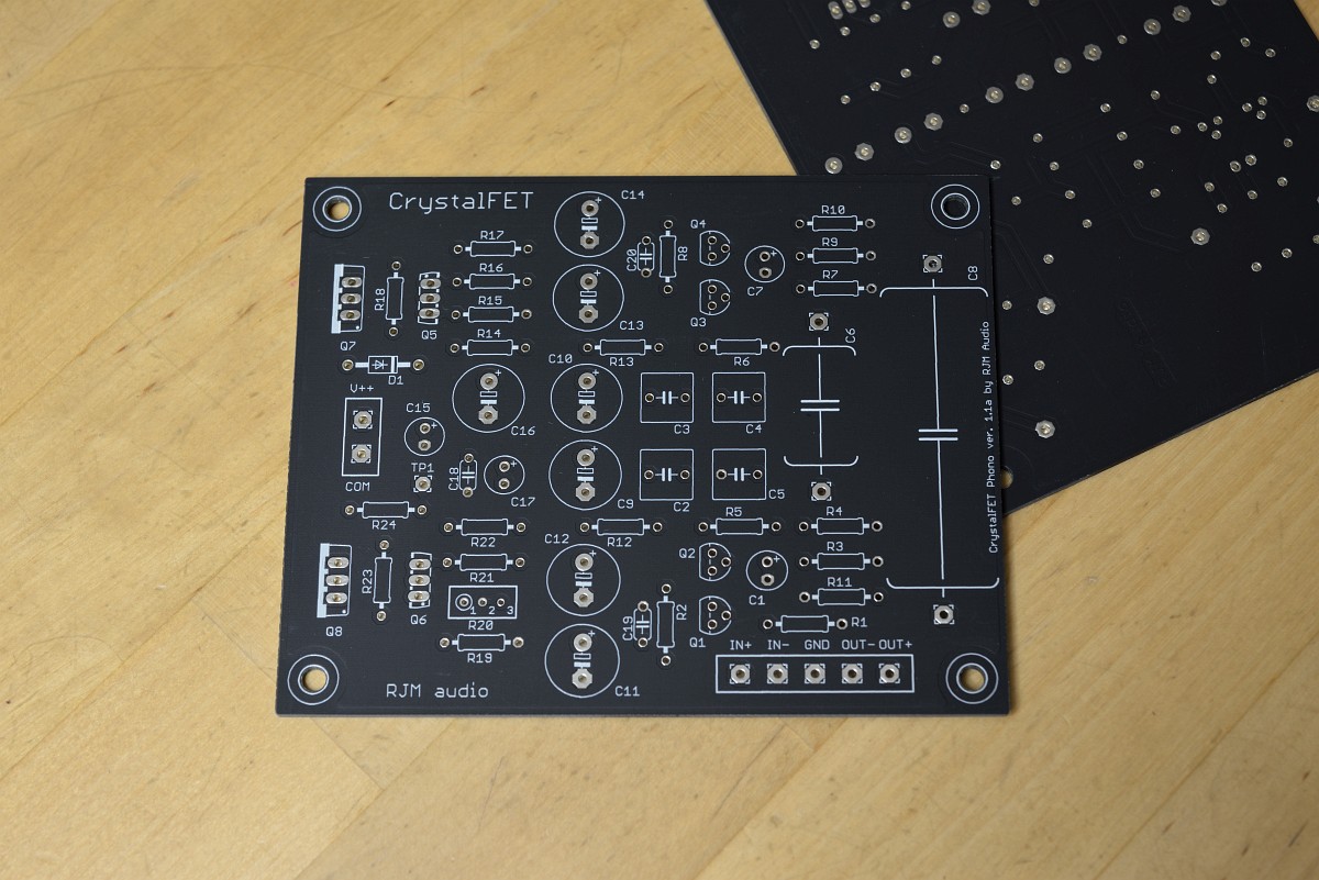

For the base MM configuration if you can obtain matched pairs of J113 with "size" = V_gs0 x sqrt(I_dss) between 6 and 9, you can use the BOM values as-is, R2,R8 = 6.19 kohms. Provision is made, however, for adjusting R2,8 precisely to any given J113 size.
The MC configuration is more of a side project. Yes, by adding bypass caps C1,7 to the source resistors gain shoots up to 58 dB, but the loss of all that degenerative feedback means the phono stage gain is ten times more sensitive to the JFET matching. R5 should be increased to 33k and the appropriate cartridge loading taken care of at the input.

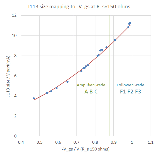

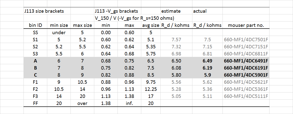

While at first glance the I_dss and V_gs0 values for the J113 appear to be scattered at random, there is in fact a very close correlation.
That is, there is only a very narrow range of possible V_gs0 values for a given value of I_dss. It is easy enough to link the two parameters empirically, I use a measure called "size" defined as [V_gs0 x sqrt(I_dss)]. It turns out that pretty much every other parameter can be expressed as continuous function of size, including the gate-source test voltage for source resistance 150 ohms. (see attached plot)
So this quick voltage measurement (with gate grounded and R_source 150 ohms) can be used to bin the J113 jfets according to the table. A B C grades are used for the amplifier, while F grades are used for the follower. S grades are not useful in the CrystalFET circuit and are kept for other applications.
The circuit gain for jfets of any given grade ("B", for example) should be well within 0.5 dB (MM version), but of course this can be improved by selecting matched pairs within a grade.
Matching within a size bin 0.2 wide is more than sufficient. In terms of the voltage measurement at R_s 150 ohms, this means matching within 15 mV. With just 20 components I could obtain 3 matched pairs of (A,B,C) grade jfets, and enough F grade parts to complete the circuit.
This means: if you are planning to build this and use your own parts, you'll need to buy at least 15 J113s, but no more than 25 should be necessary.

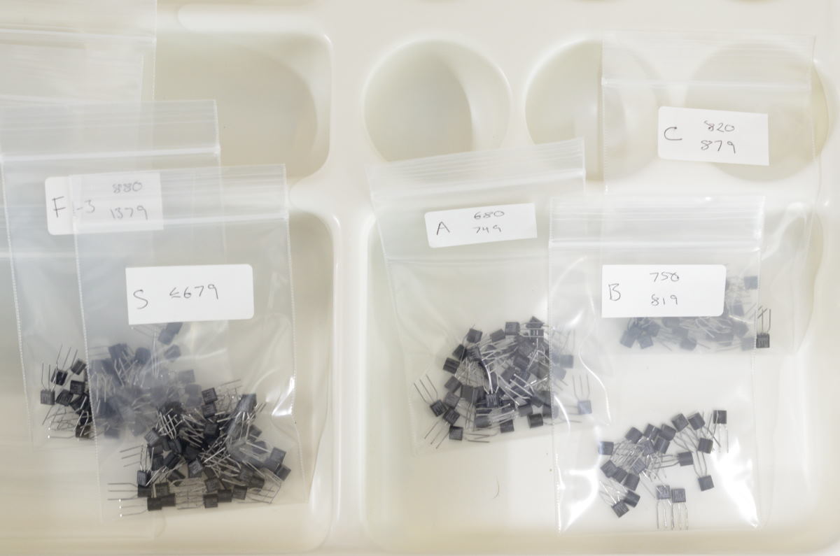

Churned through 200 J113 jfets to sort into bins.
approx. part count:
S 50 (unused, size <6)
A 43 (amp grade, size 6-7)
B 19 (amp grade, size 7-8)
C 28 (amp grade, size 8-9)
F 60 (follower grade F1,2 size 9-14)
There is a "double hump" in the distribution, so more A and C than B, but 45% of the total were "amplifier grade" and another 30% were "follower grade". That's a pretty good harvest. The balance of followers can be made up from poorly matched jfets from the amplifier grades.
