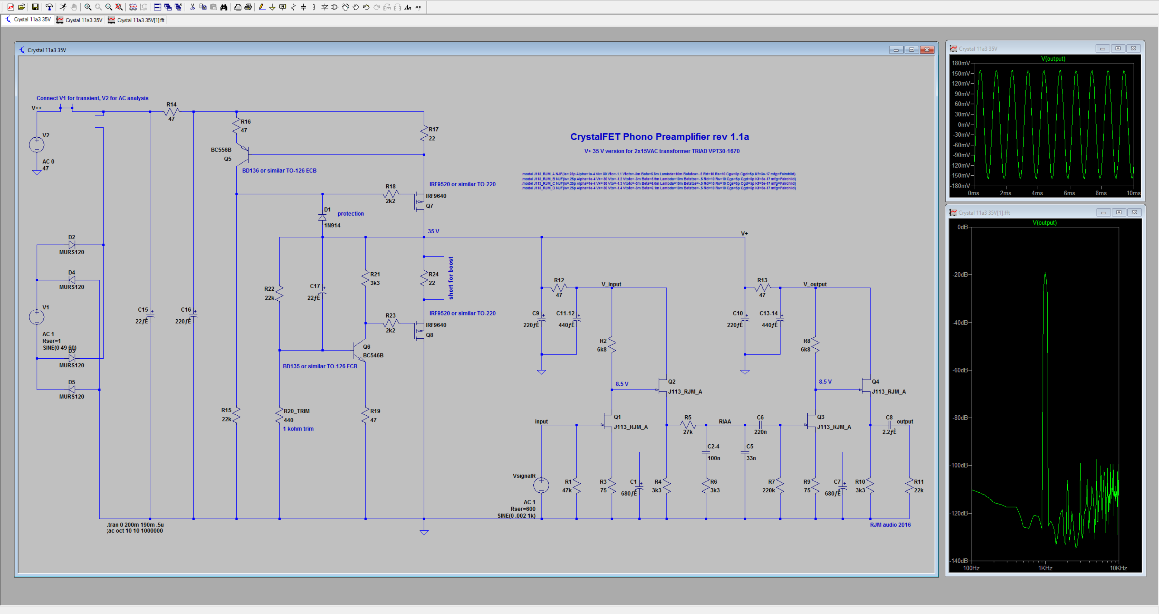

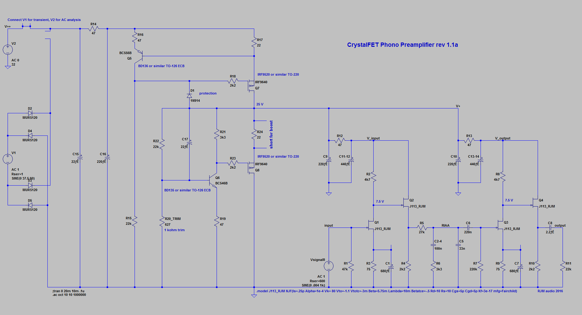

I've gone back and re-jigged the LTSpice circuit to use the J113. The gain is 38 dB with C1,7, about 30 dB without. The phono stage current draw is about 16 mA, while the shunt bleeds 14 mA.
You'll have to copy the J113_RJM model text into your standard.jft library for the simulation to work.

Latest LTSpice files, and an updated BOM.
I remembered that now I've settled on the J113 the working voltages can be higher since this is a 35 V part.
The circuit can work at 20-25 V when a 2x12 VAC secondary is used. It can work at 25-35 V when a 2x15 VAC secondary is used. The power supply capacitors are rated to 63 V so they don't need to be changed.
According to LTSpice the distortion isn't radically lower, but at higher voltages there is more headroom, and perhaps more important, a wider useable voltage range for the operating voltage. This makes setting the value of the drain resistor a little less critical.
The V+ value is adjusted with the trim pot. As a last resort this can be used to fine tune the jfet drain voltages if they stubbornly end up a bit too low or a bit too high (ideally they should be about 7-9 V). Do not exceed 35 V.

The V_ds of the follower stages is up to 25 V, but LTSpice says the gate leakage is 280 nA.
Seems pretty low.
Seems pretty low.
> dealing with the circuit's nonexistant PSRR.......
I would fold the drain resistors to Gnd with a current source.
Patrick
Patrick
The LTSpice estimate of gate leakage current in the order of 10^-7 A seems reasonable as it is in line with what I have been able to find in published datasheets. I don't have specific info about the J113 however.
Since we aren't building an electrometer here the DC leakage currents don't seem high enough to be troublesome.
re. current sources. Helps the PSRR problem, but makes setting the jfet operating points even more finicky?
I am sure you know how to make a good adjustable current source.
PS
If you change I1 in the Spice file to exactly 3.6mA, Vo1 would be identical to Vo2.
Except that you have (in this simulation at least) infinite PSRR with Vo2.
Patrick
PS
Patrick
And you can adjust the DC level now at will with the current source.
This is a working full schematics (in Spice).
The only thing missing is a source follower at the output.
Here I would perhaps use a BF862 cascoded by a J111 (also for better PSRR).
I have checked that it has good PSRR as is (by using a 30mV 3kHz sine superimposed on the 36V Vs).
The 6.9V voltage sources are meant to be LM329's and the like.
Distortion at 2V pk-pk is so-so at about -65dB, but that is no surprise.
The nice thing is that it is almost all 2nd harmonics.
Third harmonics and beyond is very low.
Though this is only Spice and not reality.
But I shouldn't disturb your development process any further.......
Patrick

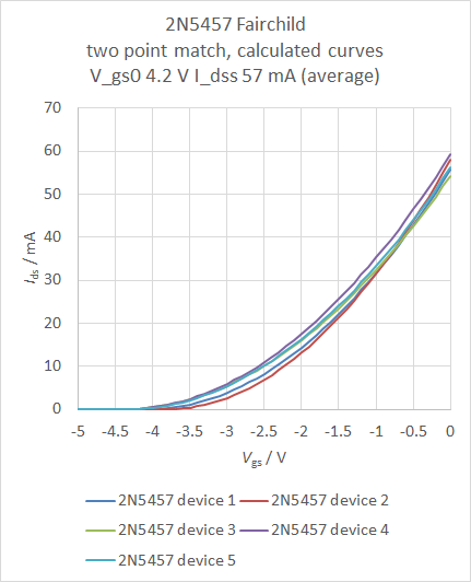

Oh ebay, you bring tears to my eyes!
I've just measured the "Fairchild 2N5457" jfets I ordered from China.
Datasheet: V_gs0 -0.5~-6 V I_dss 1~5 mA
Actual: V_gs0 -4 V I_dss 57 mA
Well, at least the cutoff voltage is in the right ballpark. 🙄

That one looks more like J112 to me...
