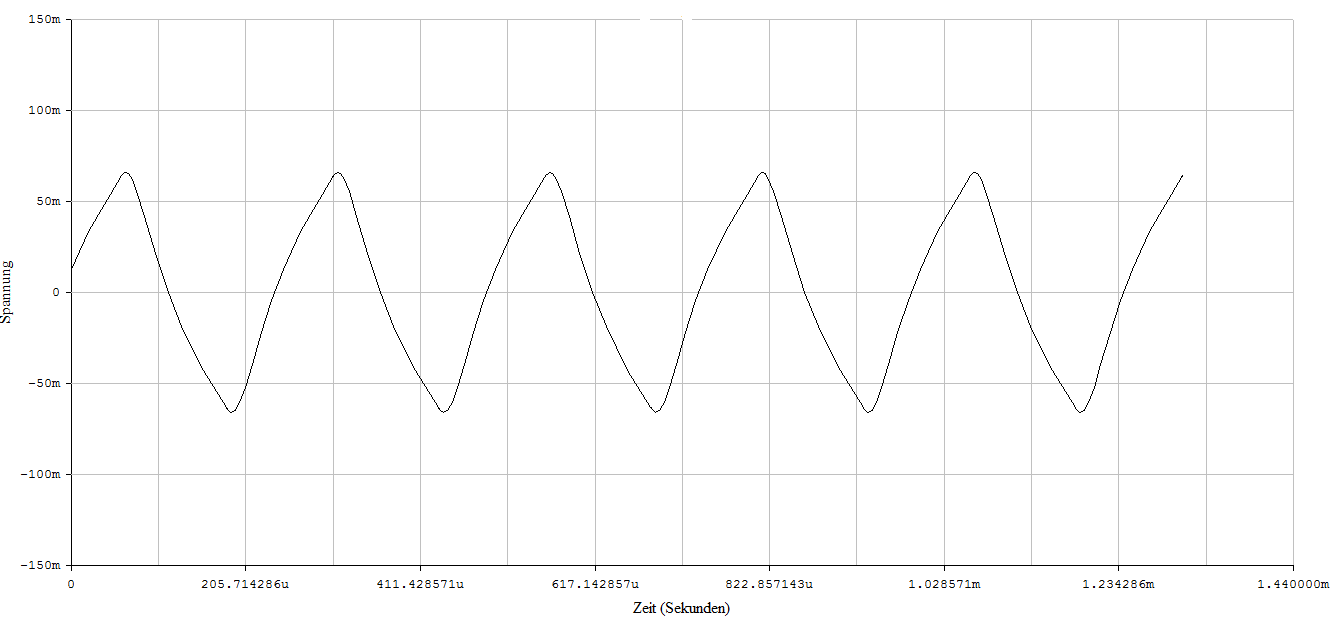

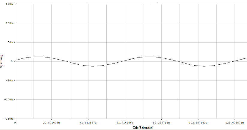

I think it's obvious to everyone that the waveforms in post #2 are supposed to look different.
It's nice to see what such waveforms look like in real life, though. If you were to use a Dirac impulse as a theoretical model for a click, you would conclude that the + 1 term makes a non-inverting active RIAA stage infinitely more prone to overload, while with the waveforms of post #2, the + 1 term actually doesn't make much of a difference.
Yes phono cartridge is NOT a source of Dirac impulses.
Can you tell us what the good and bad circuits are? Someone else might be able to dig up the circuits.No, sorry, I don't have the circuits.
I have borrowed a network from Bonsai 😉

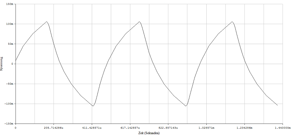

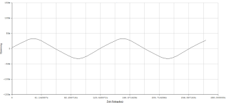

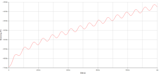

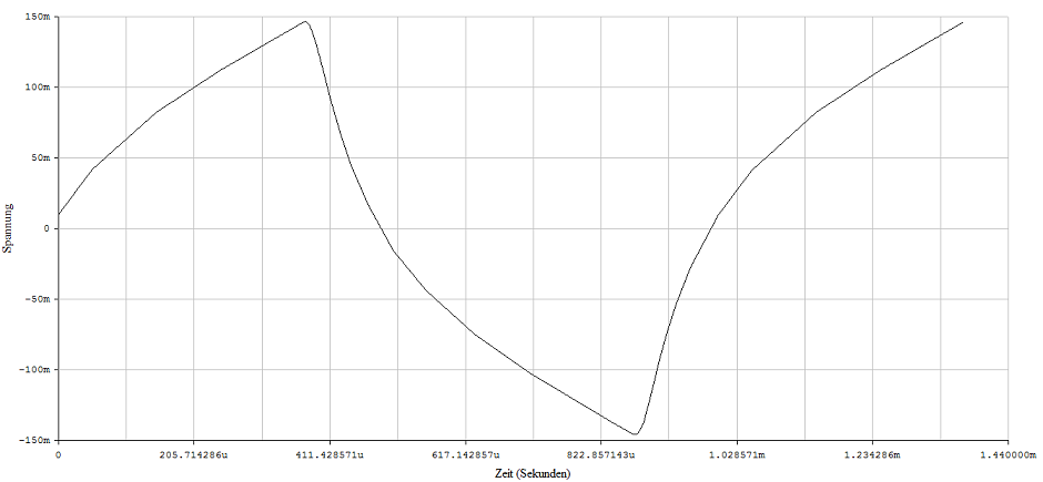

To be able to compare with and without the "+1 error". The MM system is again taken into account as a separate low-pass filter. A direct comparison with the postings #120,21,22 is immediately possible.

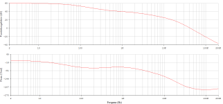

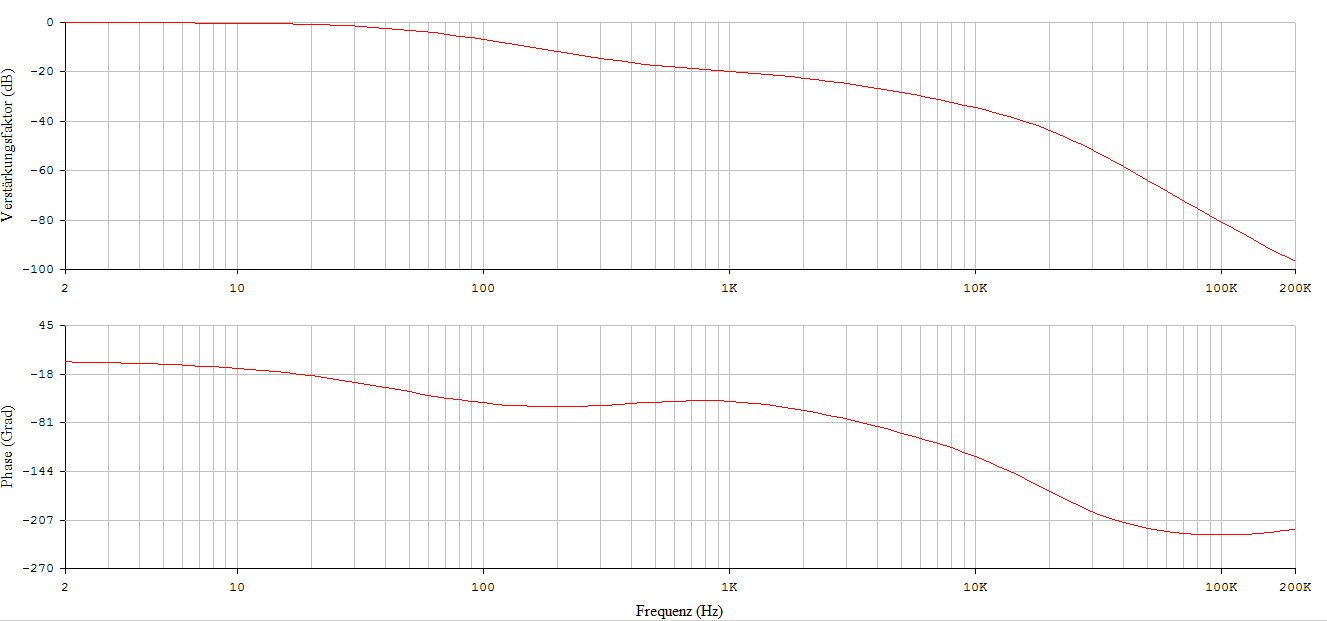

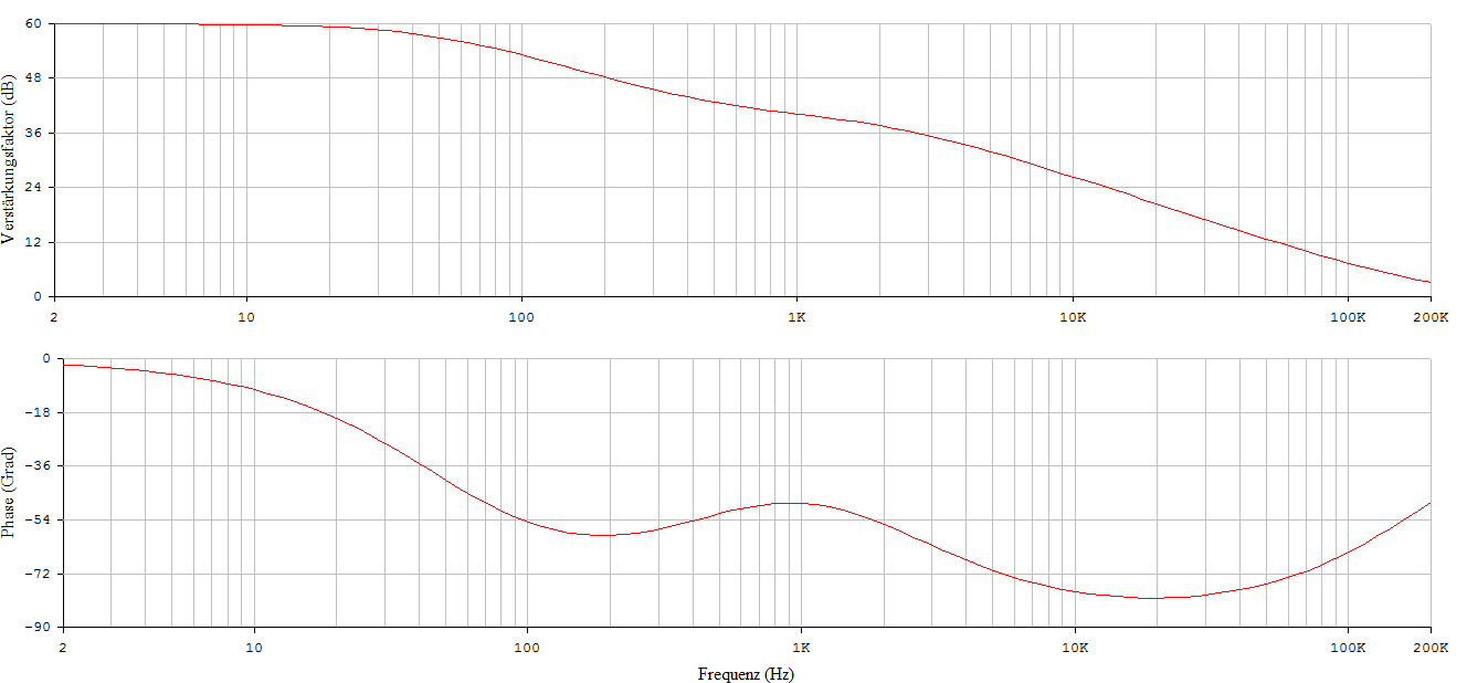

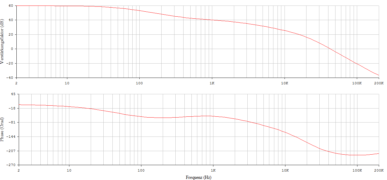

I'll quickly add the transfer function as a picture.
All non-inverting with the classic NE5534 and the original Signetics model. Can we now identify significant differences with regard to the + 1 error ???

hbtaudio, can you explain a little more about what you are showing here and in #121 & 122 ?To be able to compare with and without the "+1 error". The MM system is again taken into account as a separate low-pass filter. A direct comparison with the postings #120,21,22 is immediately possible.
Are you feeding a 1Vpp squarewave into the RIAA preamps ? Or is it 2Vpp (+-1Vp) ?
What are the 'Transition' waveforms?

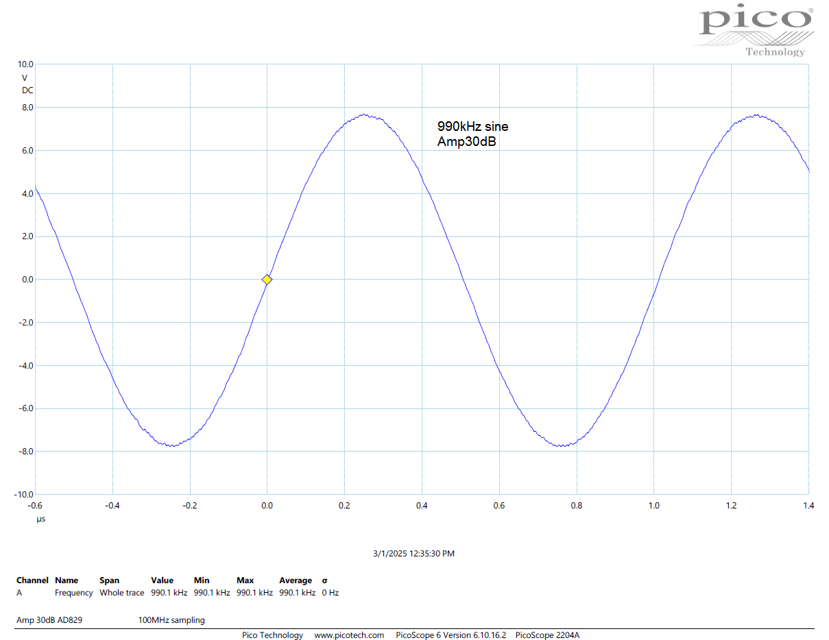

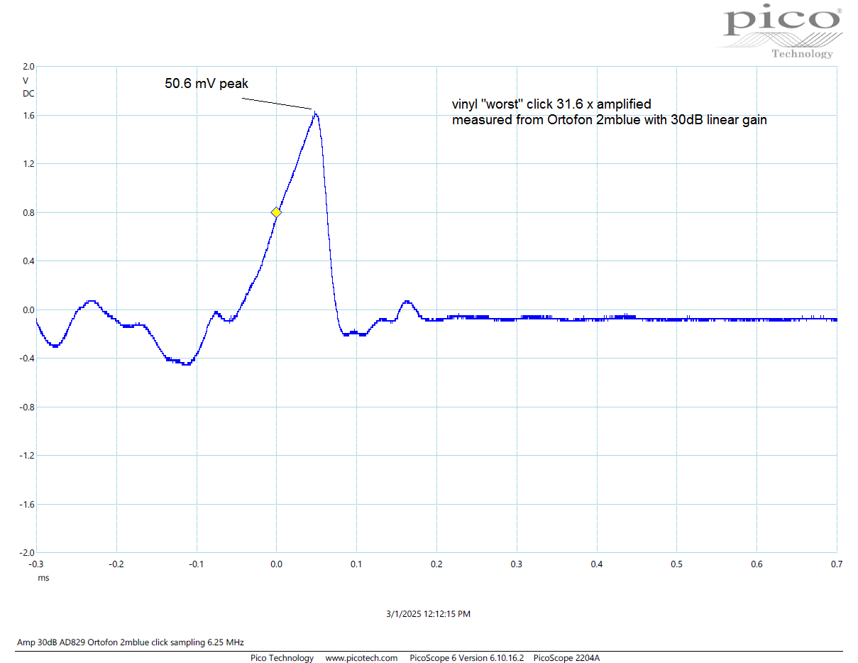

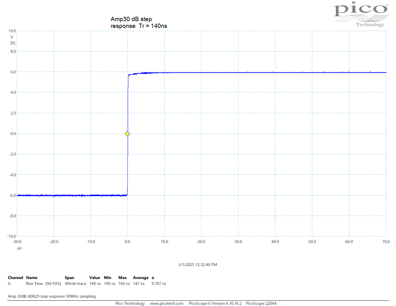

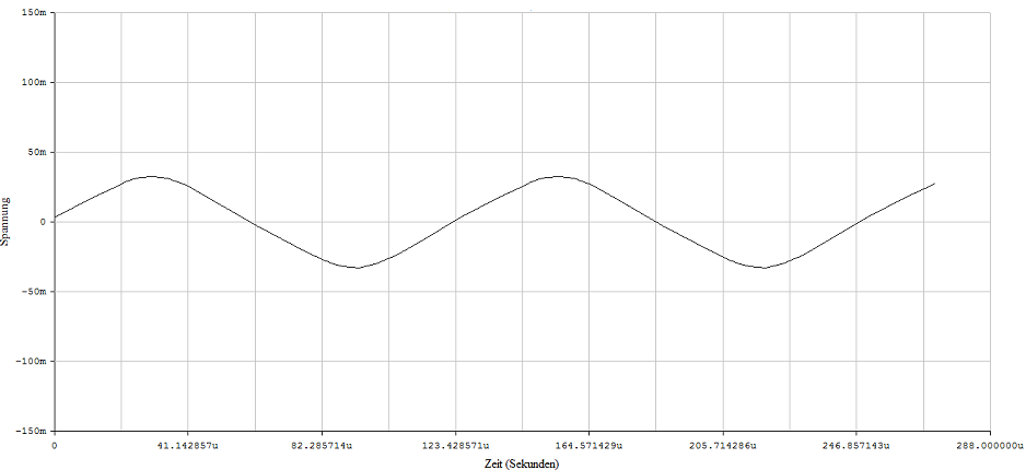

I have just made as precise measurement as I can of the "real" worst case click I was able to get from a vinyl record. Technics SL-1200MK2 turntable was used, with Ortofon 2m Blue cartridge. The signal from the cartridge was immediately amplified with 30dB linear gain amplifier, built around fast AD829 op-amp, the amp has 47k input impedance. To check the amp, below is the step response (140ns rise time, 50MHz sampling) and also a record of 1MHz sine wave (100MHz sampling):

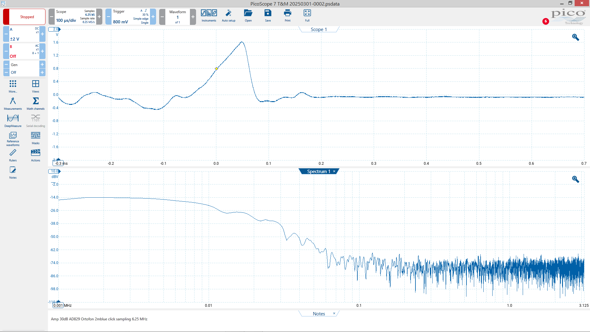

Now, the measured (amplified) click, with 6.25MHz sampling, looks like this:
Its peak amplitude is 50.6mV peak. Without any question the impulse is "slow" (even the fall rate is slow) and reprents absolutely no problem of saturation of a normally designed phono preamplifier. For those who disagree, show me your real measurements, well documented and scaled, to begin a discussion based on facts.
The impulse behind the cartridge cannot be faster than the RLC nature of the cartridge and laws of physics would allow for. There are no mysteries.
Talking about spectrum, it is definitely NOT wide and falls quickly above 10kHz.

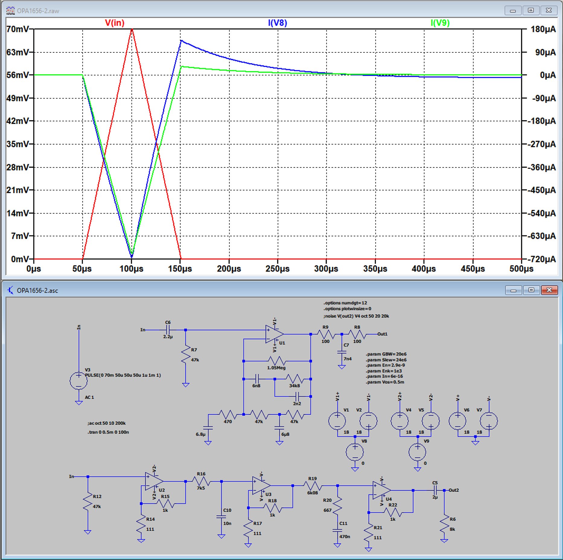

This is what was referred to in #154, varying ground currents, possibly interfering with and corrupting the signal gnd.
The circuit below, that I used to compare the response from the one opamp with active Riaa EQ version versus a three opamp version with passive Riaa EQ, shows the ground current caused by differing supply currents to the input opamps during the input pulse.
In Red the 70mV/100usec input pulse is shown
Blue shows the ground current caused by the differing +/-supply for the one opamp solution.
Green is the ground current to the first opamp taken in the same way.
As can be seen, the one opamp version may be causing more disruption to the audio signal as the passive solution.
In the simulation there is no feedback between signal ground and supply current, but in real life this may result in a longer disruption at the amp's output.

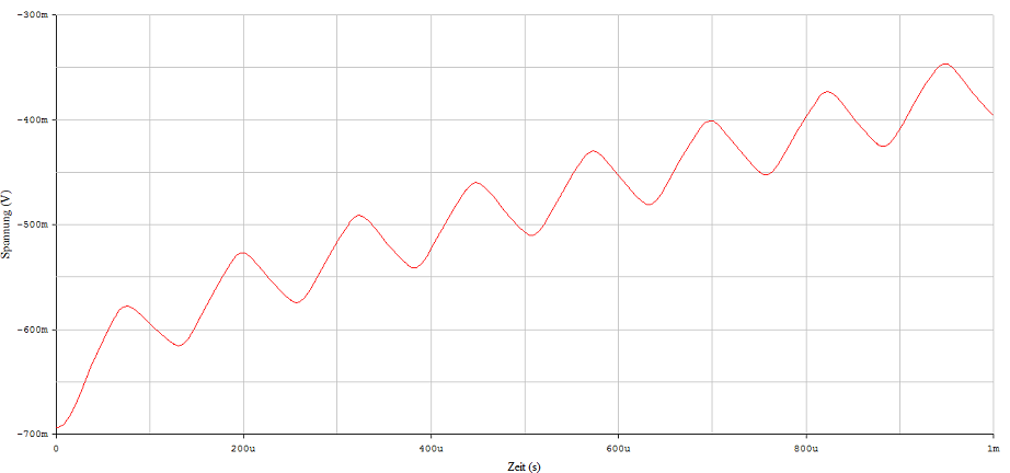

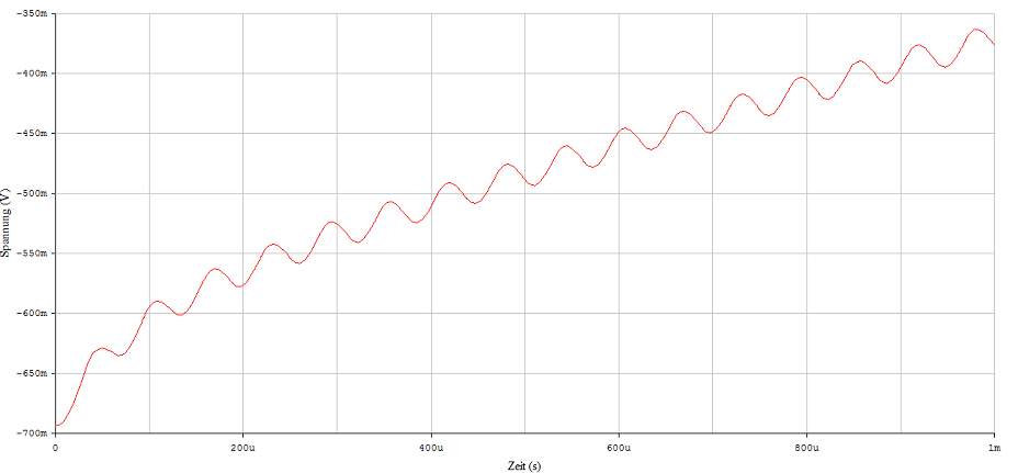

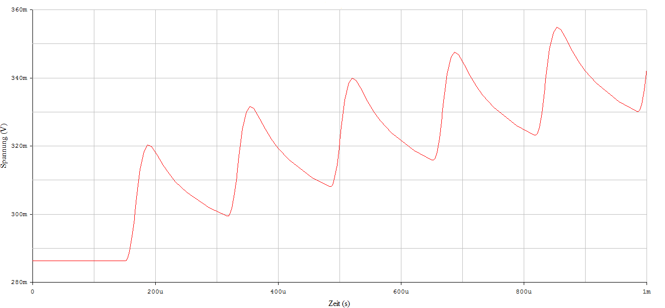

I'm in a bit of a hurry, but I'd still love to ...can you explain a little more about what you are showing (...)
a)
The first case should illustrate posting #118 and the simple laws. In other words, to make it clear that no infinitely large impulses can be given by clicks or pops, i.e. statements claiming that there are large voltage strokes (also in the further consequence) are not correct. It should make the working behavior of the “filter chain” more visible than descriptive words alone could.
We could also express all this with differential equations, but I wanted to get to the heart of the formation /shaping and inevitable signal attenuation.
My concern is the independent recognition of a situation, in this case I wanted to clarify a picture of what the linear signal amplifying modules actually have to process.
I hope you'll forgive me for knowing that reality can never be accurately depicted with this kind of methodical and didactic approach. But as soon as questions arise, the goal has already been achieved and a certain kind of analytical thinking and sensitization is recognizable. So it's a gain all along the line.
In short, the first graphs should invalidate the frivolous / lightly stated and usual statements and comments. Means "ohne Reflektion".
b)
The subsequent postings now process (virtually real, i.e. in a simulation) exactly the inherently resulting temporal signals. Here, however, with the so-called +1 error, i.e. it would now be possible, if there were fundamental changes in the signal processing, to also recognize the part [Zf(jOmega) + Zn(jOmega) ] / Zn(jOmega). However, we see absolutely no significant difference in the time behavior; on the contrary, the well-known charging and discharging behavior of capacitive energy storage devices becomes clear.
Transient analysis not transition, so the difference between a steady state and not "eingeschwungen".
Sorry for the (triggered) confusion,
I hope, as a non-native speaker, I have now been able to express myself more clearly.
greetings,
HBt.
