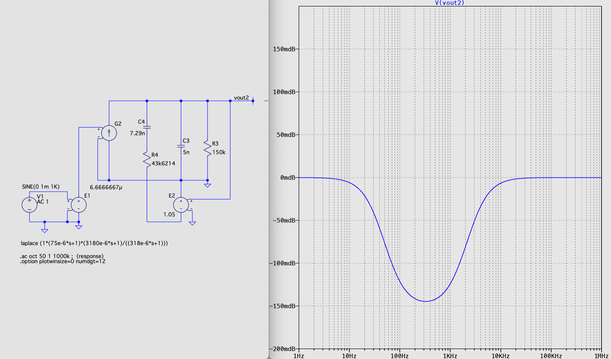

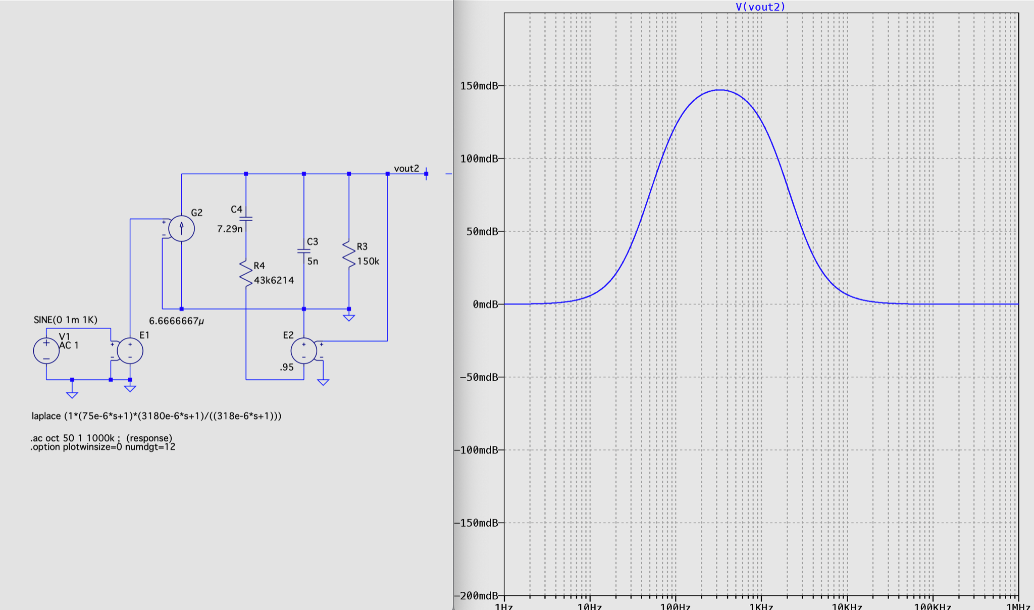

In the continuation from post #272 is shown the degree the RIAA is theoretically expected to change with frequency for a +/-5% change in the E2 voltage to voltage conversion. Note that E2 for 1.00 produces a flat RIAA. As E2 can be created in a physical reality to support continuous adjustment what can be imagined this offers, or is good for?
