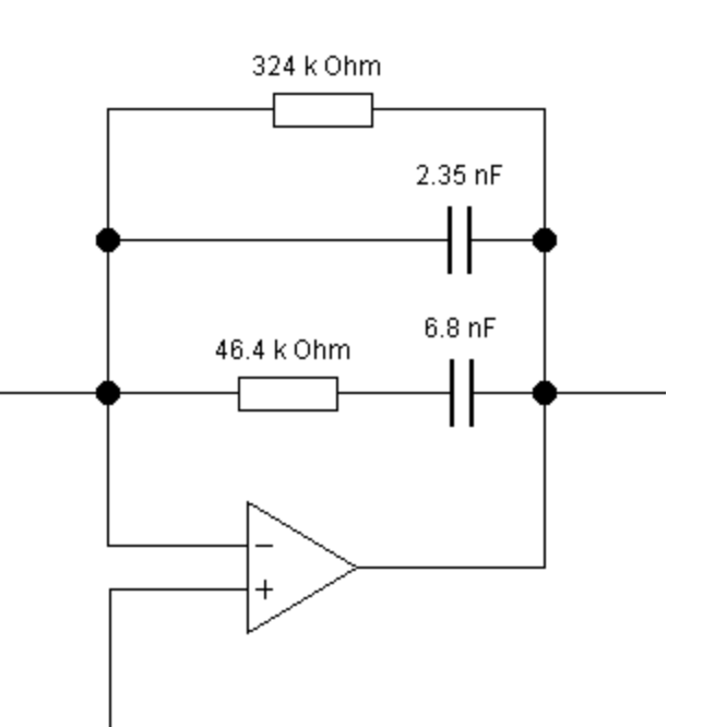

In Sample A the operational amplifier should deliver about 35 to 40 mA at full swing at 20 kHz into the 23.5 nF capacitor. Less current load is better IMHO.
Cool,
let's have a little bit fun.
Uout = 13Vpeak at f=20000 1/sec then Uin must be 1300Vpeak !
over the thumb:
-Iout = 13V / 324Ohm
the result is 40mA peakcurrent!

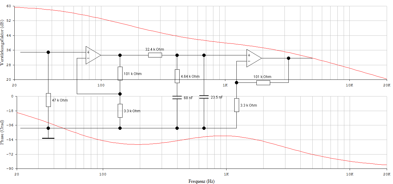

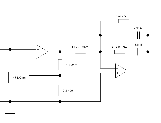

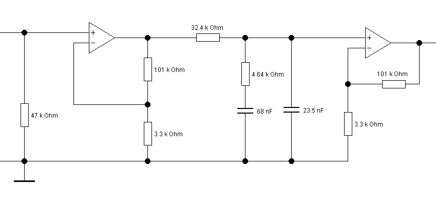

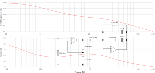

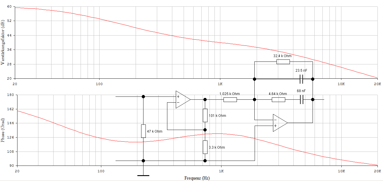

and activate both examples.
Which version is (now) the better one and why is that? Alternatively, the question could also be: what is the decisive difference in sound? The triangular symbol with the + and the - should be regarded as an ideal component, an ideal operational amplifier. The supply voltage is +/-15Vdc. We can output (swing) up to exactly 13Vp without clipping.

Theologians are still asleep, although two formidable interpretations (exegeses) of the Holy Scriptures are now finally available.
Both circuit examples have the same input stage, with completely identical data and behavior. In the following they differ as required by the two competing churches, but after the service one party is white and the other black, otherwise they have been indoctrinated in the same way.
Since we are a church that listens to its parishioners, because it is dependent on sheep, the desire for less burden should be fulfilled.

Well, the examples should finally shed some light on the darkness and put our comrades in a position where they no longer have to guess what might be hiding beneath the Earth's disk.
Example A amplifies up to f=20kHz without exception, while example B first amplifies (+30dB) and then attenuates the signal depending on the frequency (-20dB at 1kHz and -40dB at 20kHz, all of course only asymptotically) and then amplifies it again with +30dB.
Well,
that must inevitably sound different now - but which exegesis is the better one, i.e. the only true one?
And if they are considered equal in the testers' test field, the question of clicks and pops still remains unanswered. After all, we expect white or black to be different in some way.
HBt.

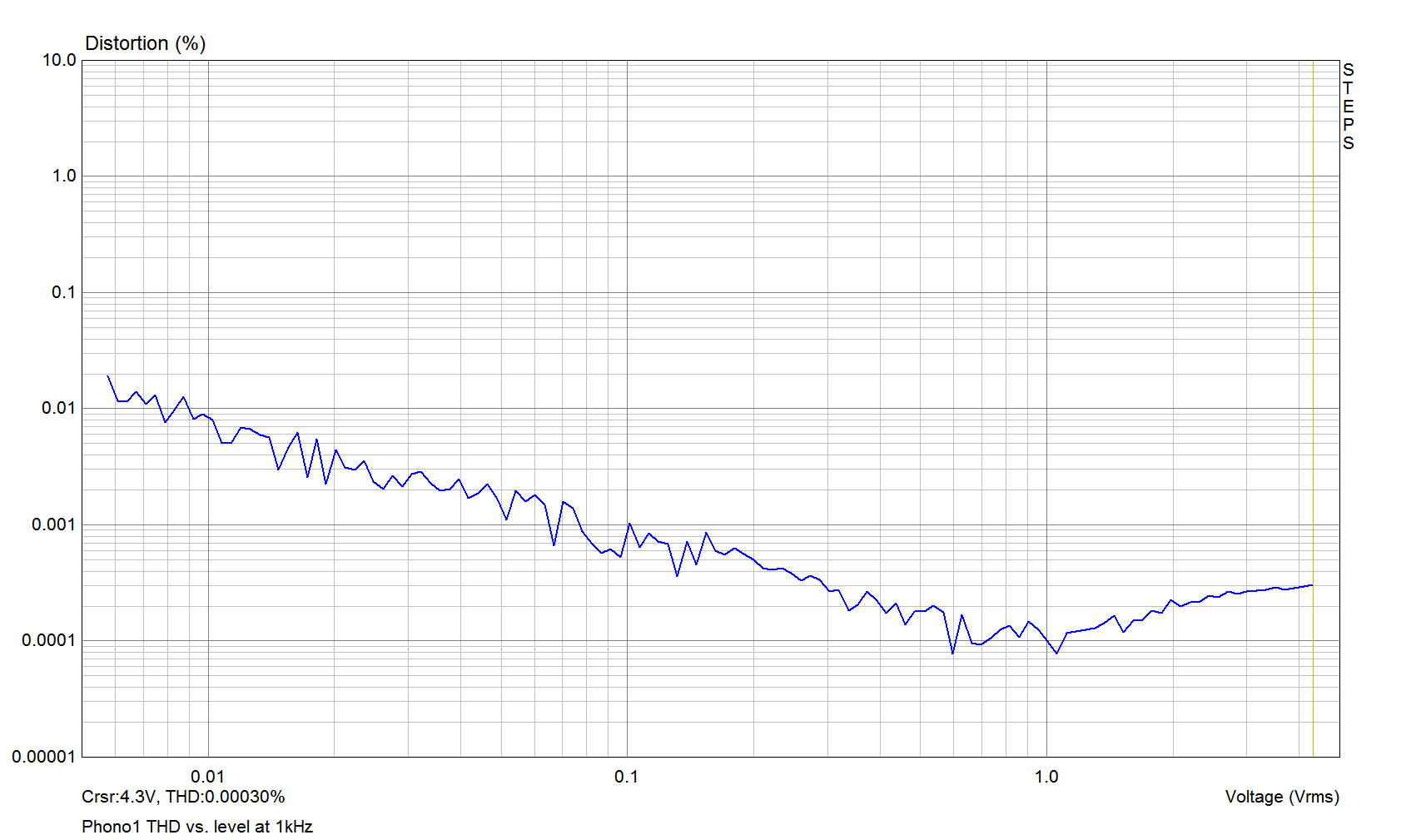

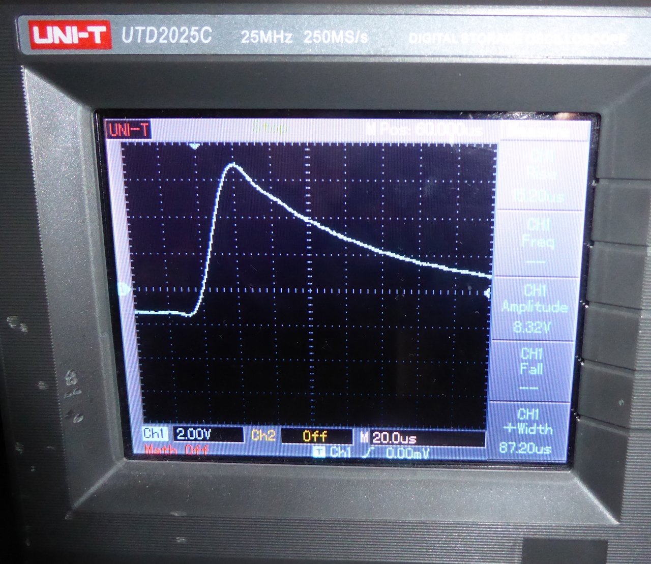

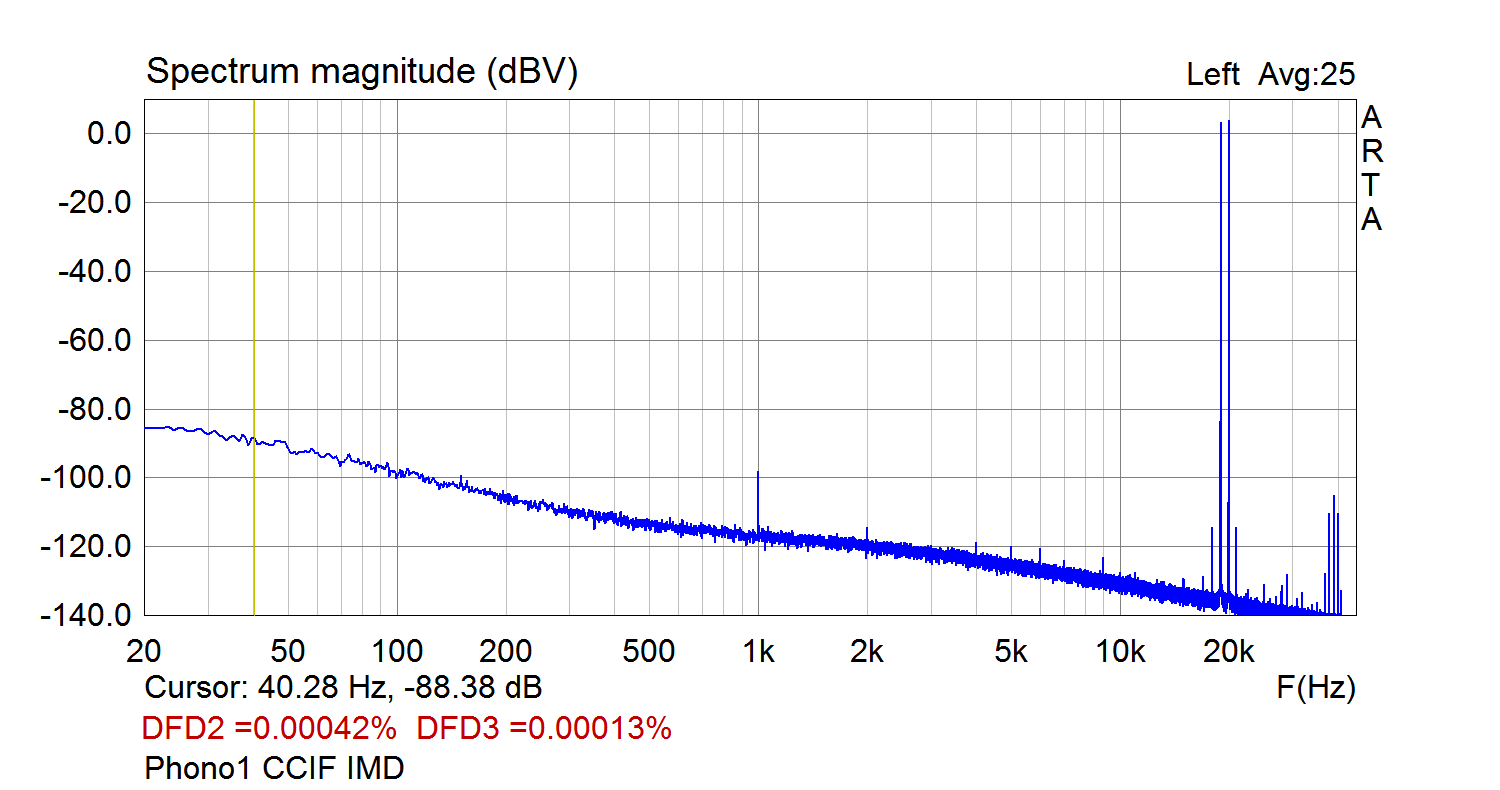

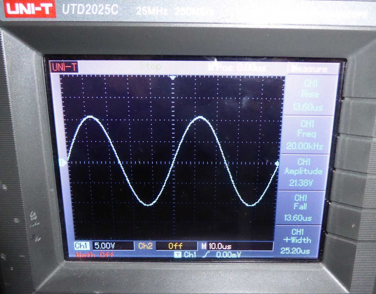

I still do not understand what are some of the contributors afraid of. Below are the shots from the simplest, 1-opamp phono preamp with feedback RIAA EQ. Input signals from the generator are absolutely unrealistic - big 20kHz sine and 1kHz 2% duty cycle square (short impulses with fast edges). There is no clipping, no dv/dt saturation, just the response of RIAA EQ circuit.
I have quickly built this simple phono pre this afternoon, just for the benefit of our dear readers.
P.S.: supply voltage is +/-13.5V, just what I had here.
  • Thank You
Reactions: Bonsai and hbtaudio

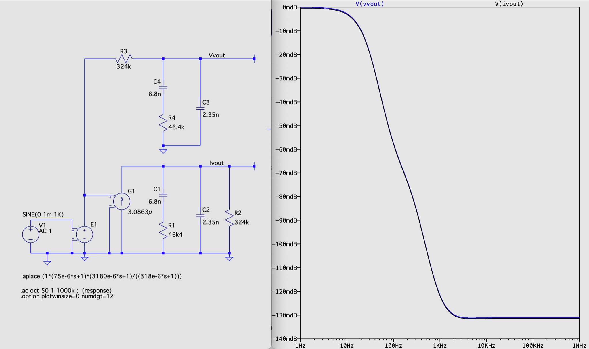

In arguments specific to the postulate that active RIAA networks are superior to passive RIAA networks is inherent flawed for reasons passive current RIAA's are not recognized. Using values for an active RIAA as per below left these values can be replicated for passive voltage and passive current RIAA networks in LTSpice, this without simulating active elements.
Screen Shot 2025-03-05 at 8.36.42 PM.png Screen Shot 2025-03-05 at 8.30.26 PM.png
The voltage and current RIAA derivatives in LTSpice are simply an AC translation in the movement of R2 to R3 or visa versa. The legitimacy of this AC translation is evidenced by the near identical overlap in the simulation results (the voltage to current translator being set slightly off to cause this to show up).
As considered self evident the active RIAA network depicted is current feedback RIAA network, hence of identical form in the connection of its elements to the passive current RIAA network, not the passive voltage RIAA. Hence to argue that active RIAA is superior to passive RIAA ought better to be conducted in equity of comparison whereupon both are operating in the current mode, one active and one passive. Currently there appears a fundamental misunderstanding of the nature of the comparison.
Hopefully clearer, current feeding the inverting terminal from some source is fed back through the RIAA network to set a virtual ground at the inverting terminal. The distinction between active RIAA and passive current RIAA is that the active has a virtual ground and the passive a real ground. This is what the comparison becomes.
To advance this further how is an active RIAA in comparison to passive voltage RIAA of significance variant from a comparison of passive current RIAA to passive voltage RIAA. Its passive voltage that's the problem, not because the RIAA happens to be active.
