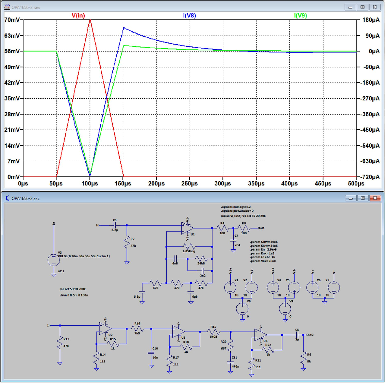

To be able to compare with and without the "+1 error". The MM system is again taken into account as a separate low-pass filter. A direct comparison with the postings #120,21,22 is immediately possible.
Are you feeding a 1Vpp squarewave into the RIAA preamps ? Or is it 2Vpp (+-1Vp) ?
What are the 'Transition' waveforms?

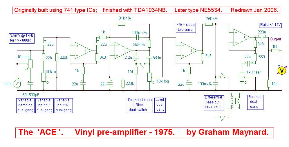

I'm watching this thread with interest. Repeatedly one article by late Graham Maynard popped up in my mind (no pun intended). If this was posted before, I'm very sorry, couldn't find. To my liking he went very practical and "anti audiophool" with this one, and accompanied it with -kinda- logic commentary, but without ANY measurements, nor simulations. So I will not defend or explain his ideas. Just for fun (which sadly periodically disappear from the discussion). So here you are:
https://bovan.net/gmweb2/the_ace.htm
Btw I didn't build it yet. But bought components already.
hbtaudio, I don't object to your manner which I rather like. But you haven't answered my questions.
@kgrlee
I assumed that basically everything is self-explanatory, but in a nutshell the answer is:
Amplitude 1V (no DC component) = 2 volts peak to peak
For the periodizing (square, not sinc or dirac ...) pulse 0V (DC reference potential) jumps to n volts ---> +2V.
In both examples (the pure cascaded filter function and a single-stage dc-coupled allInOne RIAA-EQ with G1k = +40dB) there is no high-pass or DC blocker. So no differentiating effect is possible.
The (red) Y(t) labeled “Transition” start at zero, so these are the transient analyses.
If there is a need for further clarification, please send me a PM.
All the best,
HBt.
All is now clear. The 2 Vpp single sided Square wave will certainly severely overload the 40dB@1kHz RIAA stage with 5532/4 at 1kHz, 'slightly' overload at 8kHz and probably not overload at 16kHz which just shows the HF filtering of RIAA.
Da 'transition' or transient waveforms show the start of these with the output moving up cos the DC in the single sided input.

"All is now clear. The 2 Vpp single sided Square wave will certainly severely overload the 40dB@1kHz RIAA stage with 5532/4 at 1kHz, 'slightly' overload at 8kHz and probably not overload at 16kHz which just shows the HF filtering of RIAA."
Likely 2V before the inverse RIAA network.
