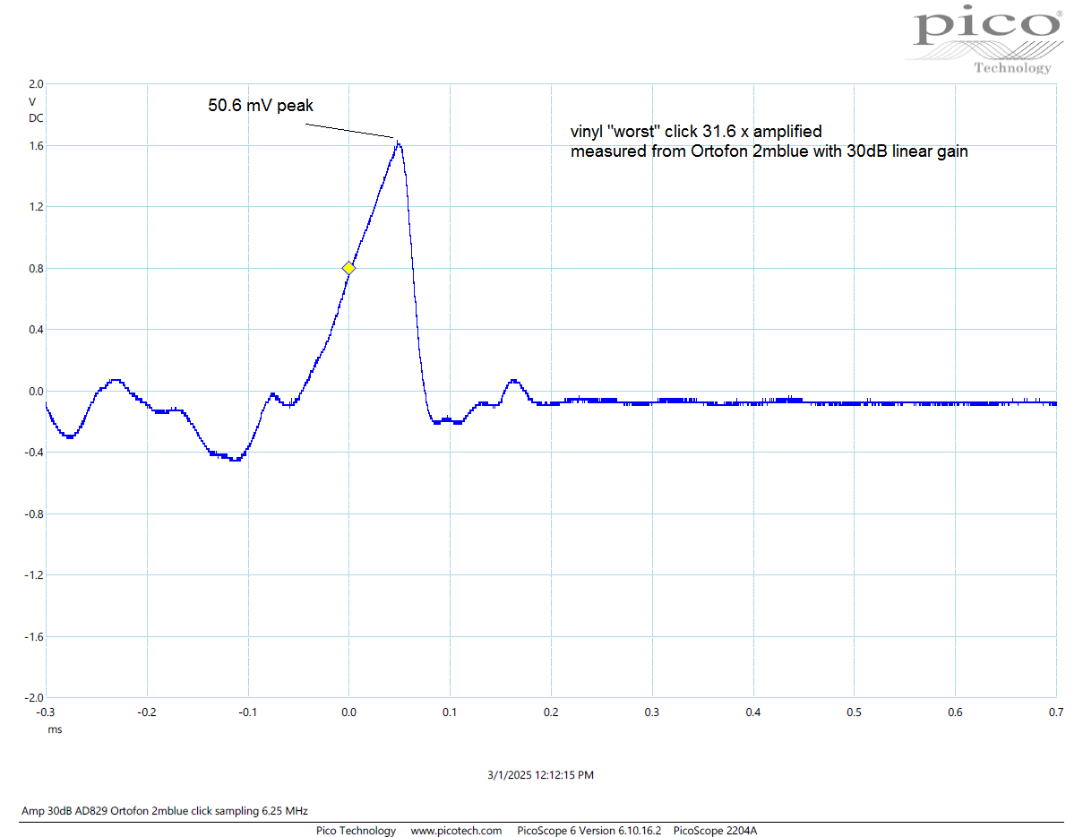

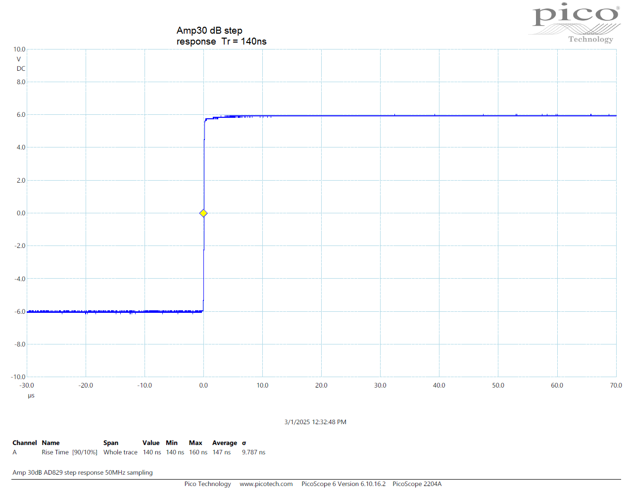

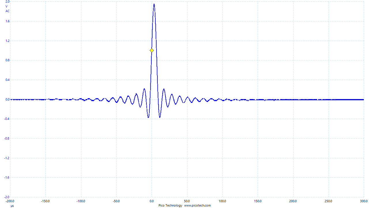

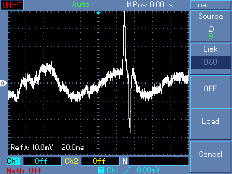

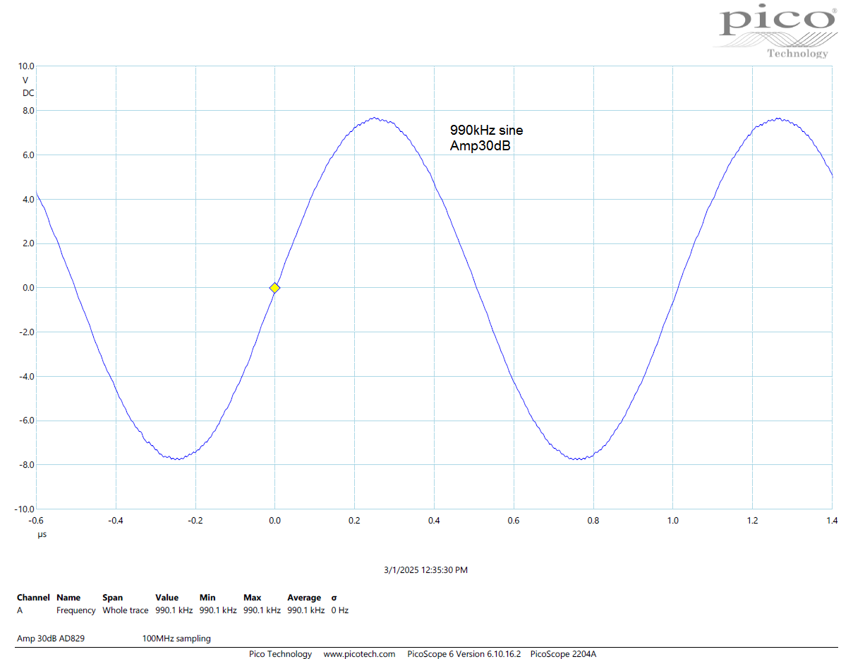

I have just made as precise measurement as I can of the "real" worst case click I was able to get from a vinyl record. Technics SL-1200MK2 turntable was used, with Ortofon 2m Blue cartridge. The signal from the cartridge was immediately amplified with 30dB linear gain amplifier, built around fast AD829 op-amp, the amp has 47k input impedance. To check the amp, below is the step response (140ns rise time, 50MHz sampling) and also a record of 1MHz sine wave (100MHz sampling):
View attachment 1429262 View attachment 1429263

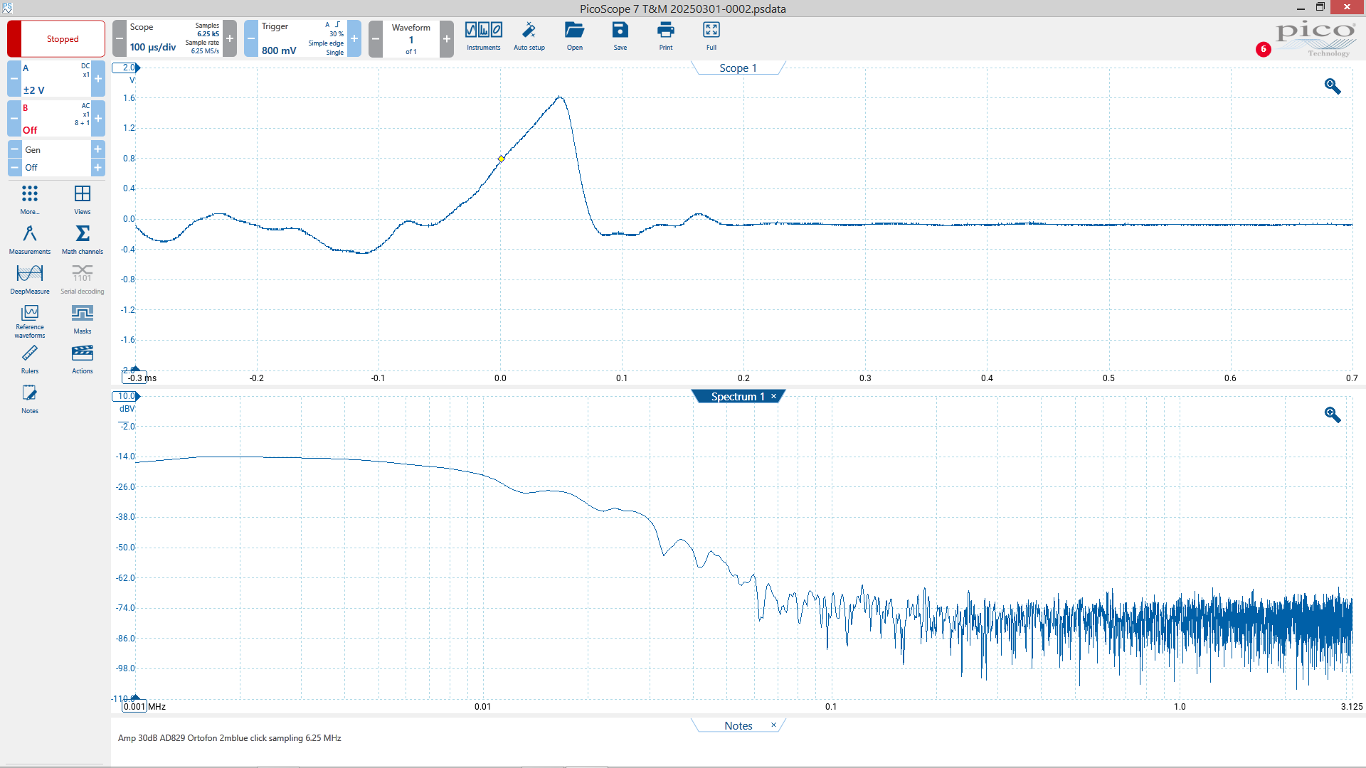

Now, the measured (amplified) click, with 6.25MHz sampling, looks like this:
Its peak amplitude is 50.6mV peak. Without any question the impulse is "slow" (even the fall rate is slow) and reprents absolutely no problem of saturation of a normally designed phono preamplifier. For those who disagree, show me your real measurements, well documented and scaled, to begin a discussion based on facts.
The impulse behind the cartridge cannot be faster than the RLC nature of the cartridge and laws of physics would allow for. There are no mysteries.
Talking about spectrum, it is definitely NOT wide and falls quickly above 10kHz.

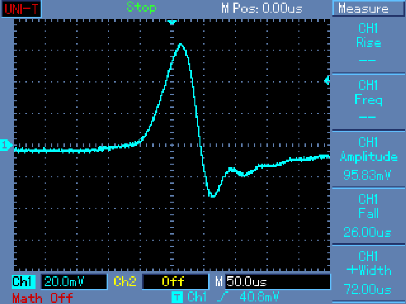

What's interesting for me is that the click pulse width (I am looking at -0.2 to +0.2 ms) is right in the mid band.
I think it depends on surface shape of the click. In that measurement we have 95us from zero to peak (rise) and 26us from peak to zero (fall). The fall time corresponds with impulse BW.

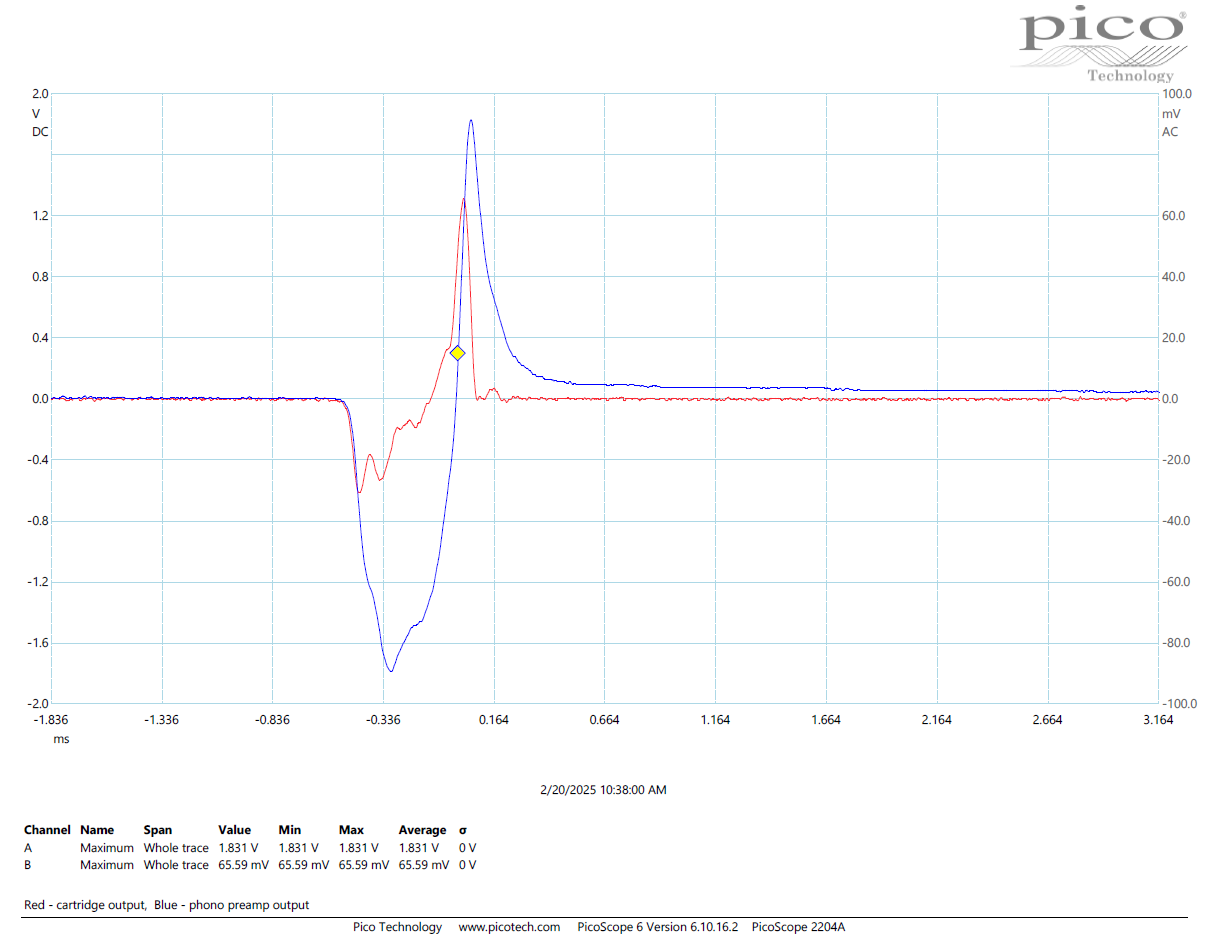

Those clicks may look a bit different, but the edges are of similar length. Below examples collected during years.
vinyl groove.PNG phono_surface.PNG catridge_vs_preamp_click2.png Ortofon_2mblue_worstclick.png
