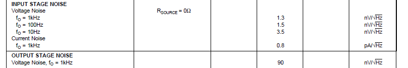

Nevertheless wanted to conclude on my gain vs noise statement. I'm mechanical, not electrical engineer, so many things to catch up. This one I must clarify.
I myself made confusion without saying that I only used INA amps as front end, not opamps.
INA has different specification and calculation; except input related noise, also output related voltage noise is introduced (and much larger in amplitude.
Formula is :
Total INAmp Noise, referred to input =
Usual input noise (as with opamp) is amplified with gain, but output refereed noise (eno) is not.
Here is screen shot from INA217 datasheet as example
ein = 1.3, eno =90nVsqrt/Hz

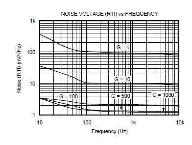

When it is calculated, this is input noise vs gain vs frequency graph:
Now I can shut up I guess 😎

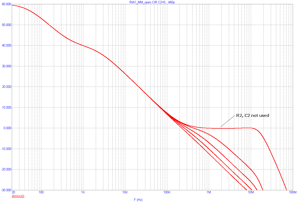

That's because it is a non-issue rather than a problem when the gain at 1 kHz is 40 dB or more. You then get an extra zero with a corner frequency above 200 kHz, while the record cutting machine and the cartridge roll off well below that.
Regarding click reproduction and overload, a passive post filter won't prevent the amplifier from clipping, as it is placed after the amplifier. It only puts an extra load on the output, which may reduce the clipping voltage a bit.
As long as nothing clips, you can get an impression of the effect of the + 1 term on the shape of the amplified click by adding both traces shown in post #2, https://www.diyaudio.com/community/...clicks-and-pops-unencoded.424462/post-7938189 Don't forget to scale down the cartridge signal by a factor of 20 because of the different vertical scales.
