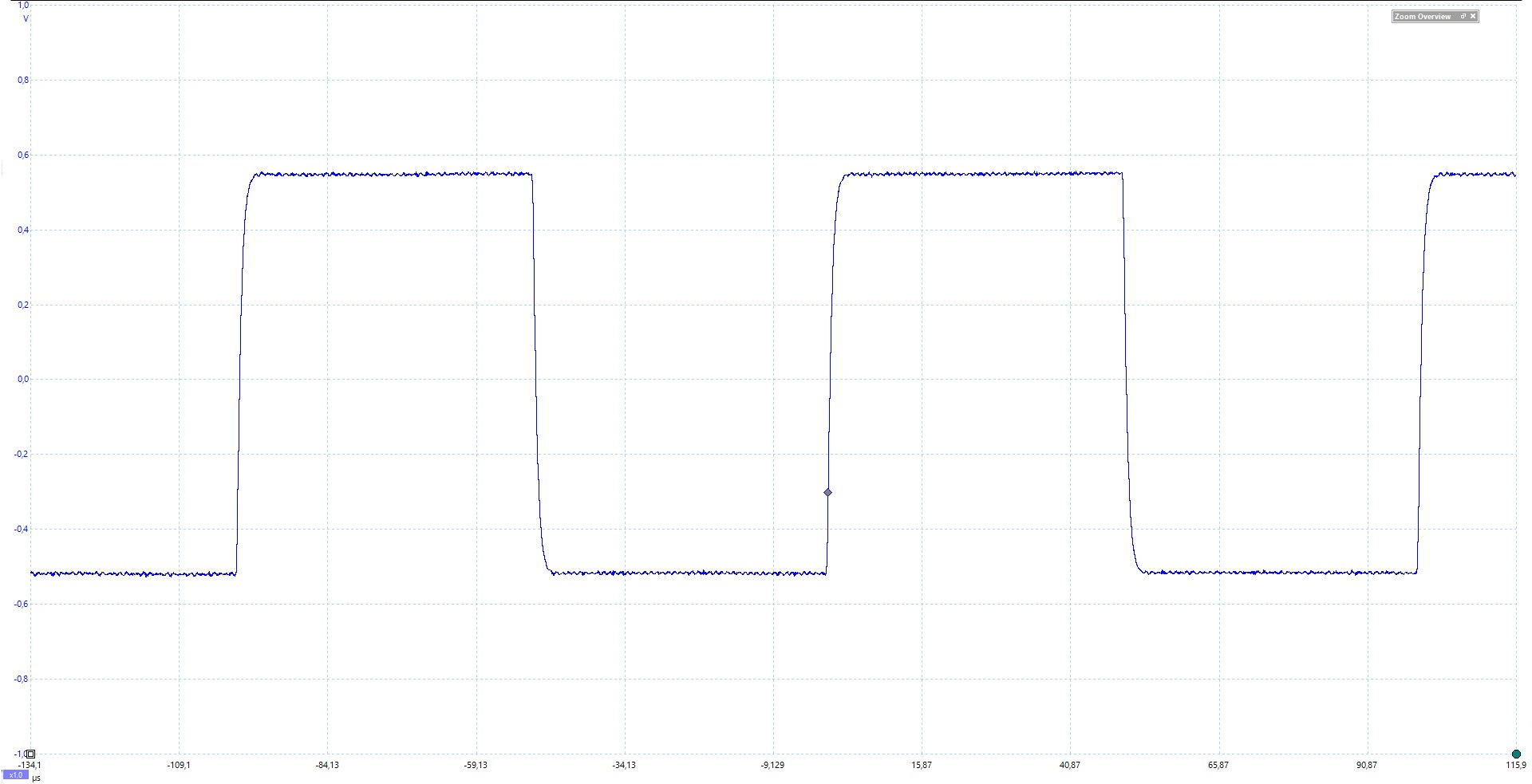

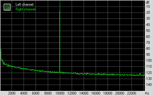

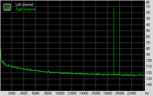

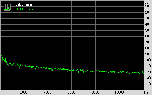

I measured Aikido Phono 1+ discrete JFET preamplifier with 48V single supply voltage. It is a 2 stage design with passive equalization.
https://www.audiosciencereview.com/forum/index.php?threads/aikido-phono-1-mm-preamp-review.60791/
It has considerably worse HF overload margin than my FB EQ Openamp. It also has much higher distortion. There are tons of myths in diyaudio.
To debunk some so called myths, here the distortion spectra recorded at resp 1Khz and 10Khz both at 1Vrms out.
Third image shows the 19+20Khz IMD response.
Fourth image shows a +/- 0.6V square wave with the preamp fed from an anti Riaa signal.

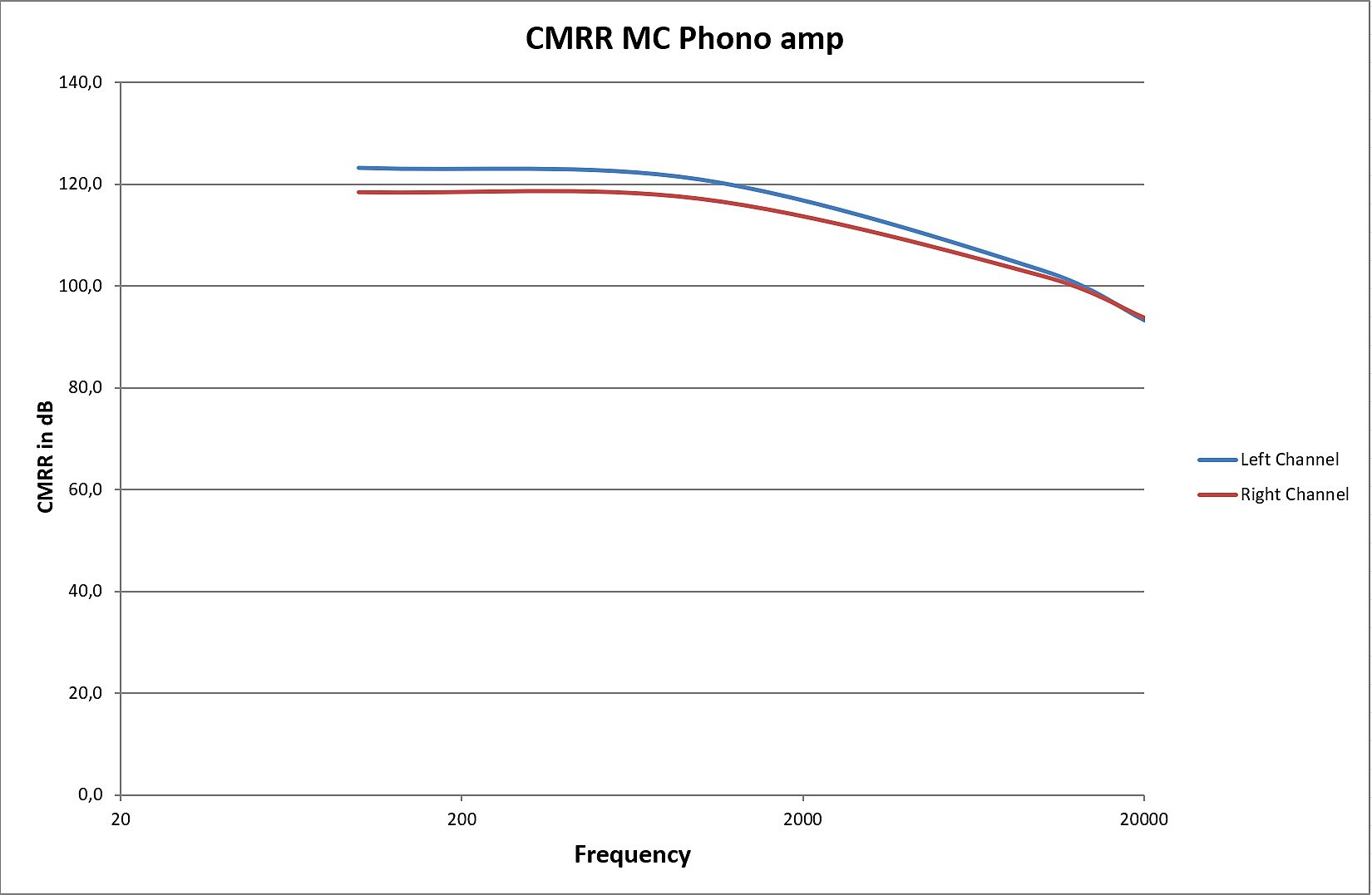

Fifth image shows the CMRR.
Fully differential Preamp has passive equalization.
These figures are as good as figures can be.
Hans

Reactions: lcsaszar and Drbulj

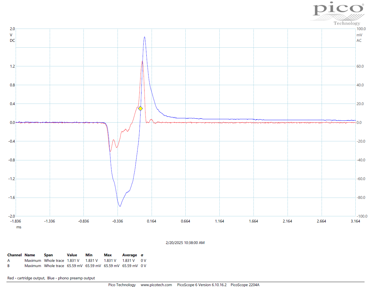

This is the same click in higher time resolution:
and I agree that for a competent phono preamp design it should be no problem. Integrating character of the RIAA EQ response helps a lot and the click should have been much broader to send the preamp to output saturation or internal saturation.
Frequency representation does not help much (IMO) to evaluate the click or mistracking effect.

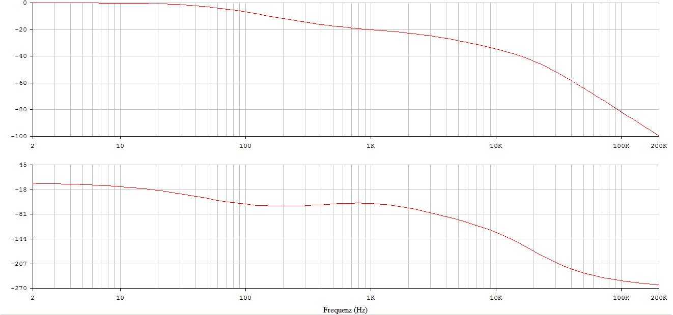

This is the entire three-stage combination, the typical MM pickup system (nominally) as a simple 2nd order low-pass filter with Q < 1 and posting #118.
We see the two components magnitude and angle, expressed as amplitude response and phase response, normalized we would talk about a so-called Bode diagram. Now we just have to excite this entire H(jOmega) with jumps and or pulses.
This can even be solved graphically, i.e. by drawing. Really by hand, a spectral synthesis or analysis also works by hand - my species had to practice this in college (when the dinosaurs were still alive).
