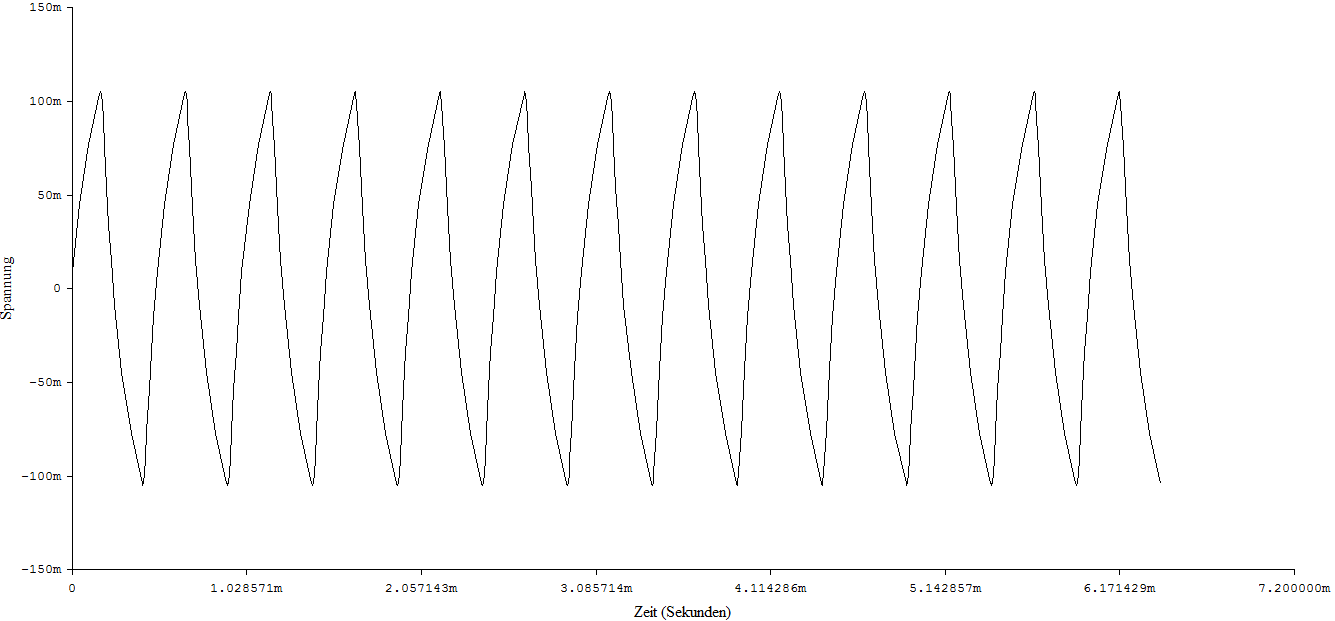

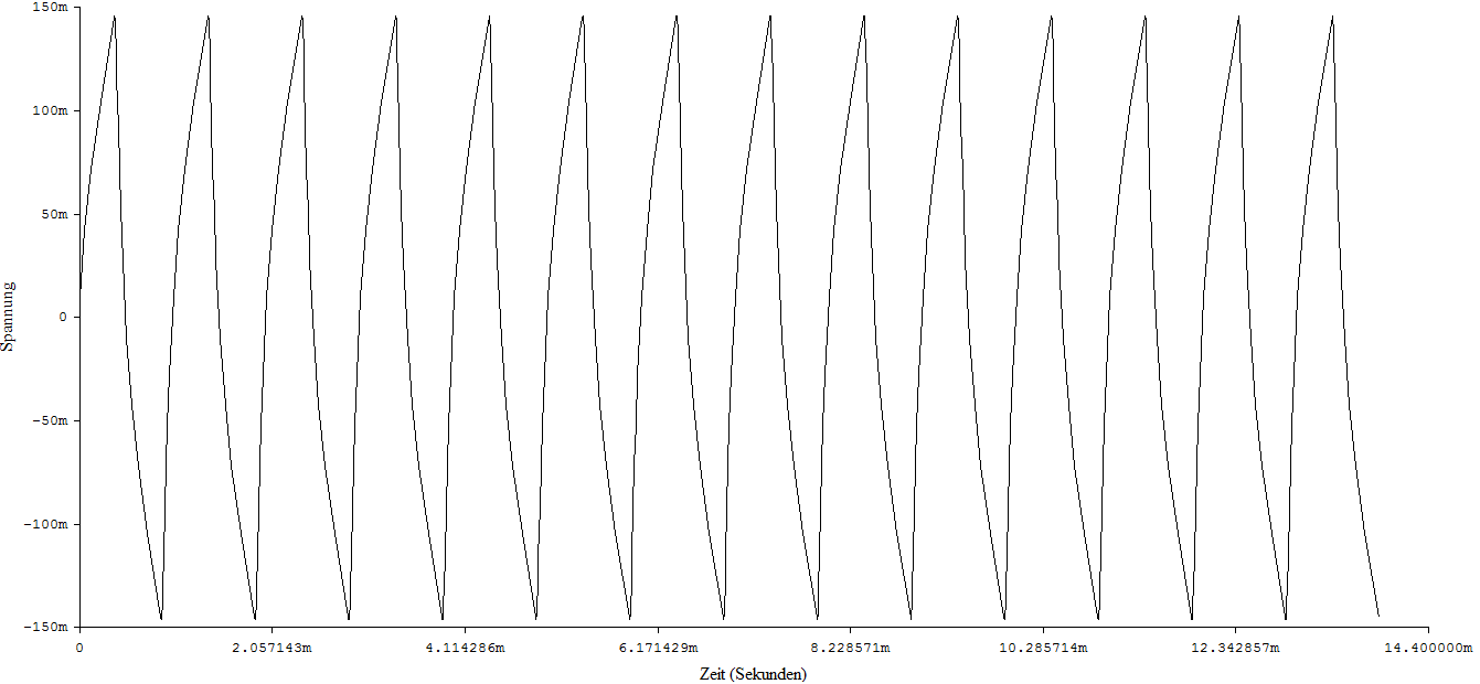

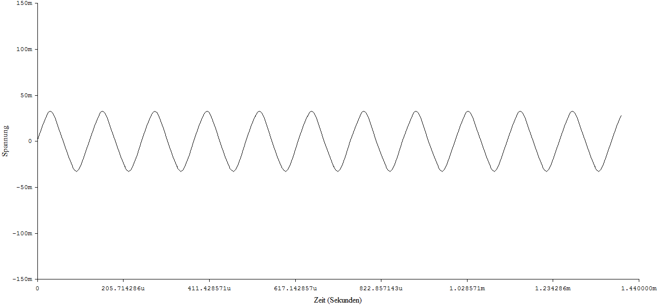

Since the topic was initially forfeited somehow with overmodulation, we look at the corresponding time characteristics - and make it easy for ourselves (methodically and didactically reduced), feeding in a periodizing jump (rectangle) with an amplitude of 1,
1V.
HBt.
1V.
HBt.

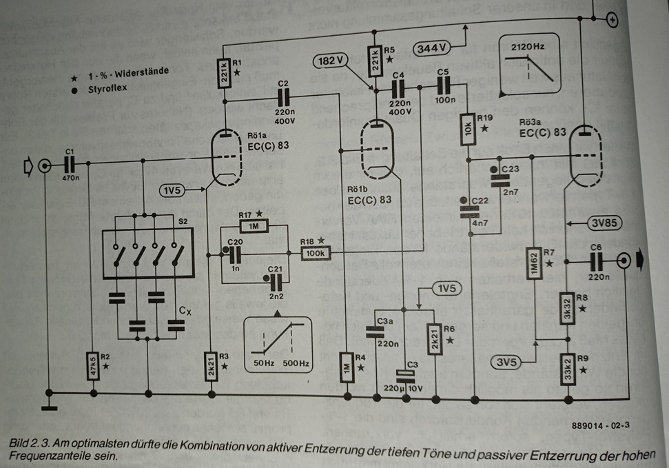

So let's stick with the following topology:
Gain block 1
loaded by the passive first order filter with two poles and a zero
followed by Gain block 2.
Many experts prefer this Lego brick composition. There is no question that this scenario can work perfectly - and in the majority of cases it does.
The only question that remains now is how to implement the two amplifier components. Perhaps also how to implement the equalizing low-pass filter.
In this context, one can make a multitude of mistakes.
I am happy to have a few concrete pieces of butter with the fish.

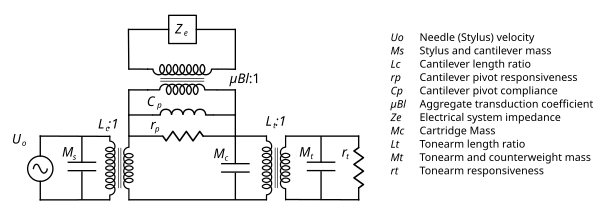

Hi,Gentlemen, surely we can move this discussion to fruitful topics which will help us design better RIAA preamps?
Have we got a 'repeatable' test that allows us to measure the effect of CpP (clicks or pop)? Can we simulate a CoP in LTspice with a simple impulse (we can add the effect of cartridges, loadings bla bla to taste)?
I'm a fan of simple feedback OPA designs like Bonsai but the last time I designed such a beast for a commercial product was the last Millenium.
But I'm really interested in how exotic beasts with passive EQ and zillion volt supplies perform compared to my simple farm animals.
Will the designers of da exotic beasts show us the end result of passing an impulse through their pets and compare the final result with simpler designs ... at least in SPICE world.
Which of the exotic beast should we use for this comparison?

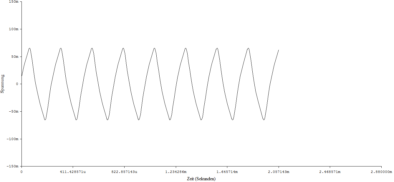

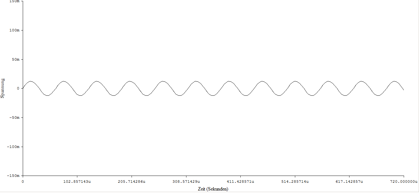

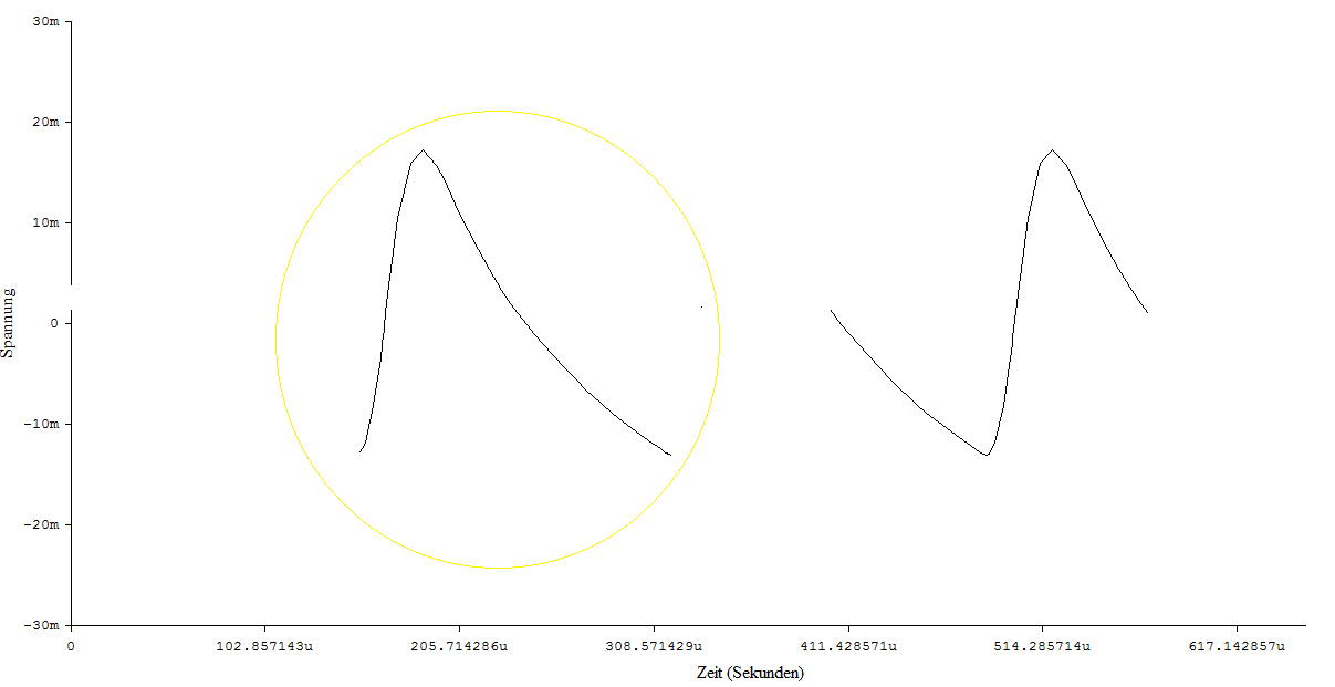

I simulated a single op amp with Riaa correction in the feedback versus a three stage design, each stage having a gain of 20dB with a 75usec passive filter after the first stage and a 3180usec/318usec passive filter after the second stage.
Both versions had the same 40dB@1kHz gain and about the same noise, all amps based on the OPA1656.
Stimulating was done with a 70mV 100usec wide triangle peak such as Bob Cordell has recorded in #8.
As almost to be expected, outcoming signal from both was identical. 🤣
Hans

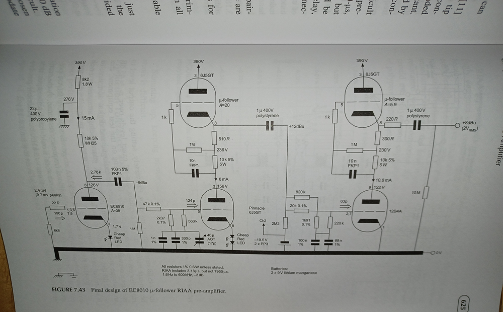

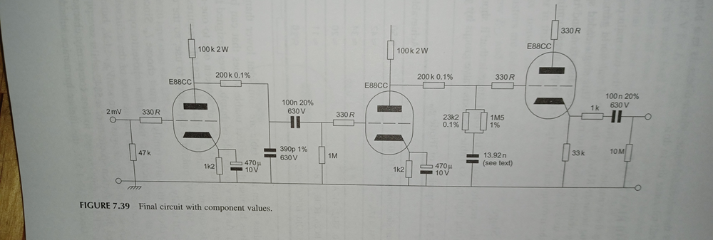

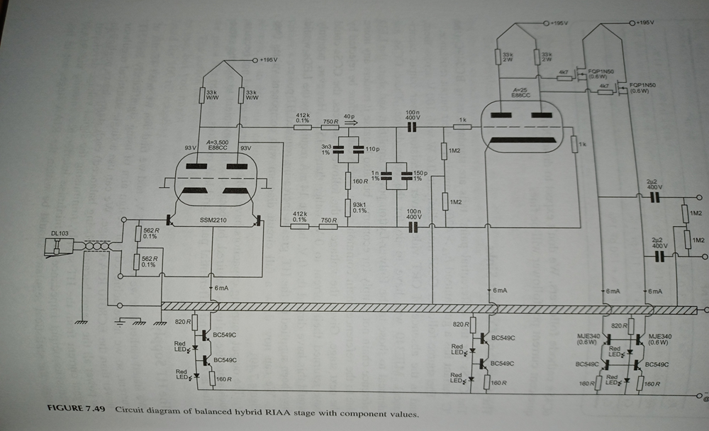

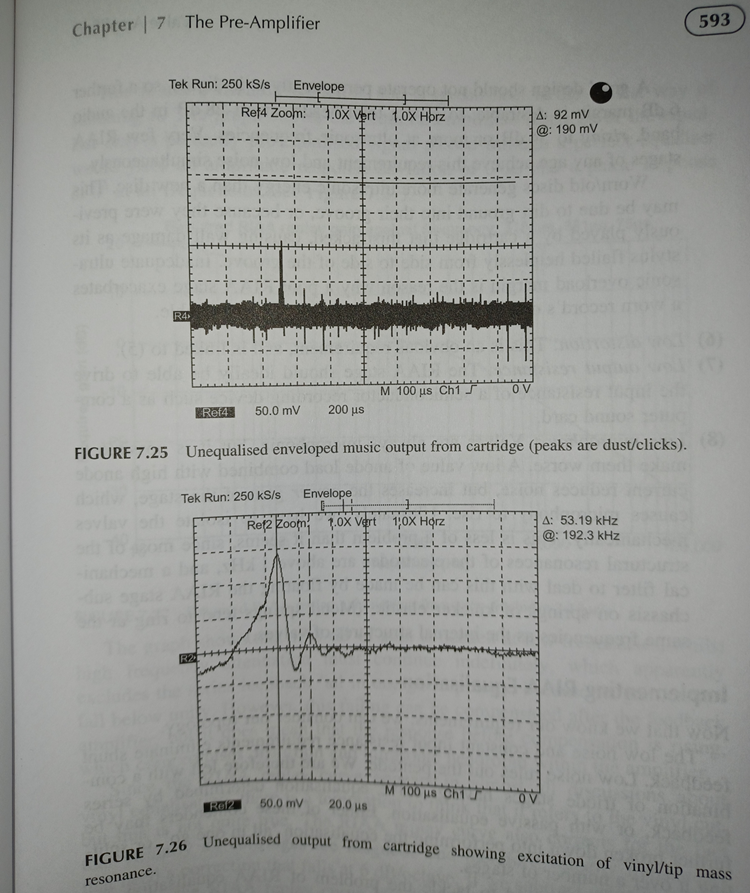

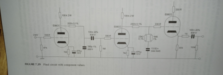

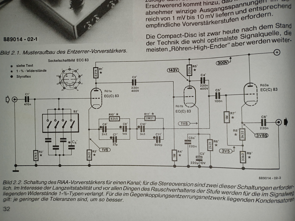

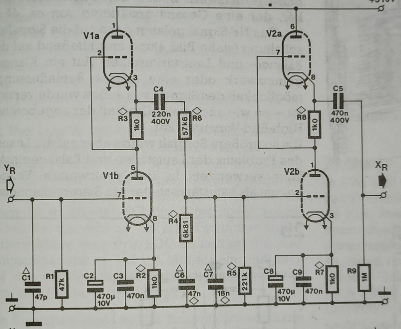

Let's saddle up:
A few quick snapshots from my shelf, Morgan Jones, R. zur Linde and J. P. Güls may forgive me.
- Analogue Source
- RIAA Overload Performance’ to Encoded Signals (i.e. the Music) and Response to Clicks and Pops (Unencoded)
