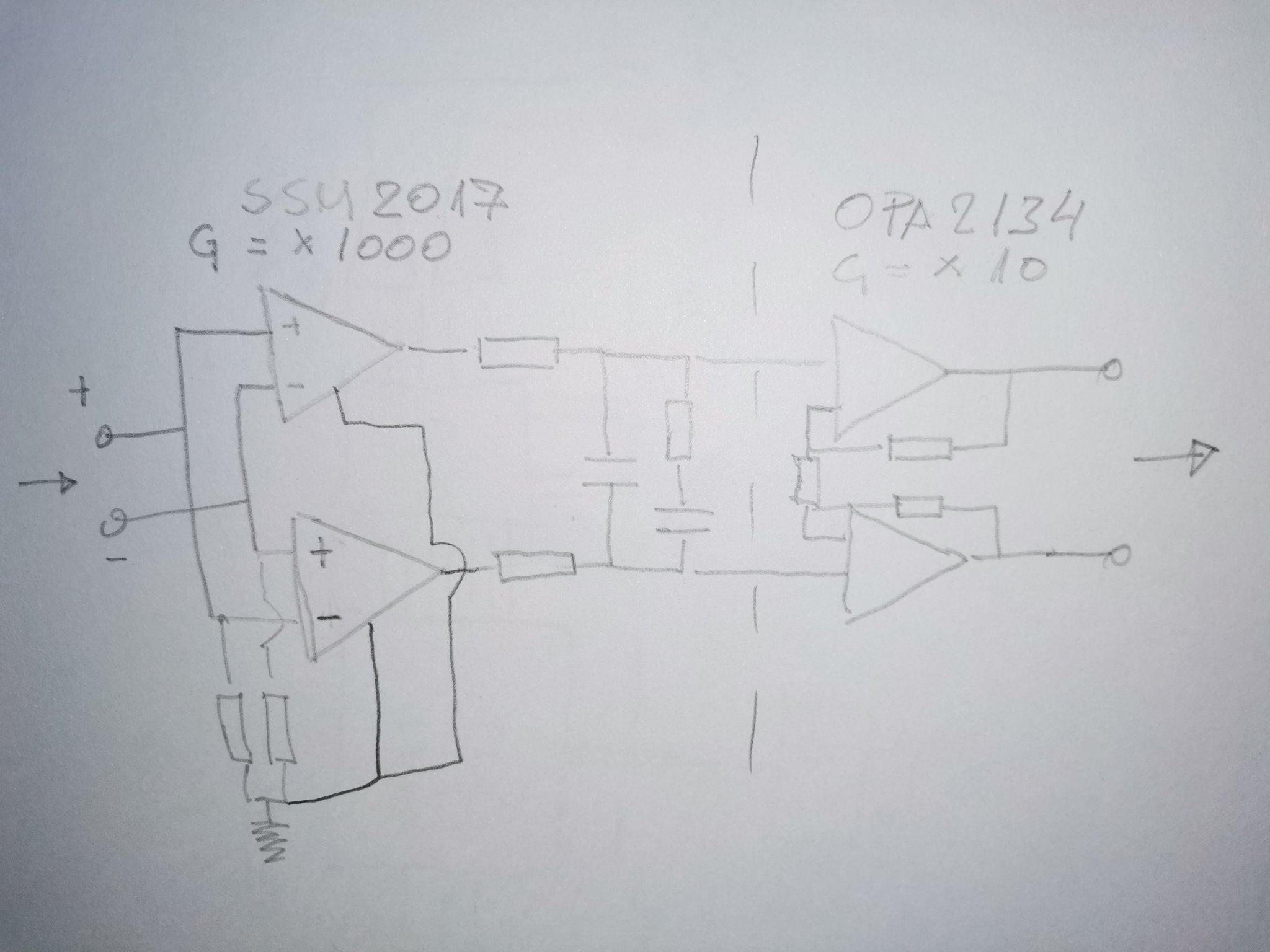

So I invite anyone to turn the heat on my old design that was already shown in 2 of my threads, about diy TT rebuilt and MC pream thoughts, many have seen it, but most did not I guess.
So, cart is Benz Ruby 2 , MC in this case, specified output 0.3mV @1kHz @ 3.54 cm/s. When measured with "standard" 5 cm/s @ 1 kHz it gives expected about 0.45 mV output @1kHz.
So, I amplify it with this:
PS rails are +-18V, minus say 3 V for opams it is 30 Vp-p achievable, but given it is fully balanced Vp-p is actually double, 60V. Lets say we can get 20V RMS out of it easily.
Now interesting, gain of each mic amp is set to 1000, since they are 2 and opposite polarity gain of first stage before RIAA is 66db, or x2000
Nominal output ruby in LF = 0.45 mV -20db (/10) * 2000 = 90 mV
Nominal output @ 1kHz = 0.45 - 0db x 2000 = 900 mV (about what scope says, this is measured and correct)
Nominal output @ 20kHz = 0.45 + 20 db x 2000 = 9 VRMS!
Signal after RIAA is so cool as passive riaa normalizes it to bass level (90mV) that is amplified with second stage. no issue.
But HF has 9VRMS nominal before RIAA and clipping comes at 20V RMS.... So what is the margin in db? Not very much isn't it? About 7db.
Still, in 20 years of using this set up me, neither anyone else, noticed any clipping what so ever....
If the record is messy and has clicks, pops and other nastiest, I'm not sure if I hear clipping or them nastiest, who cares, bad LP is bad....
