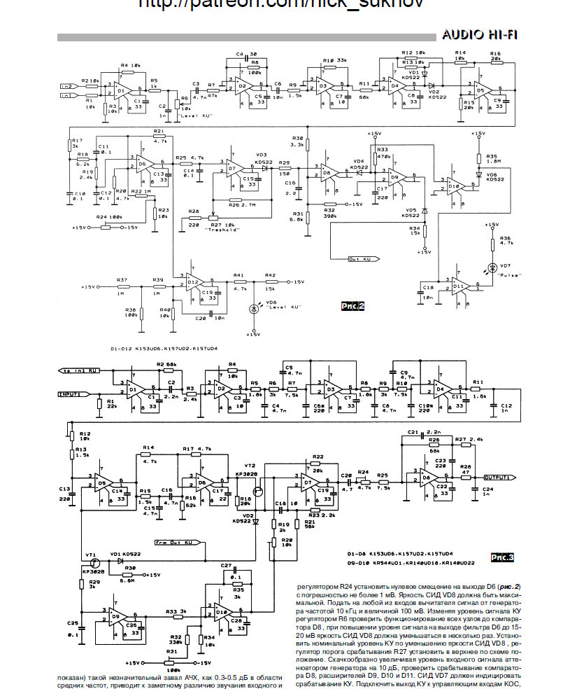

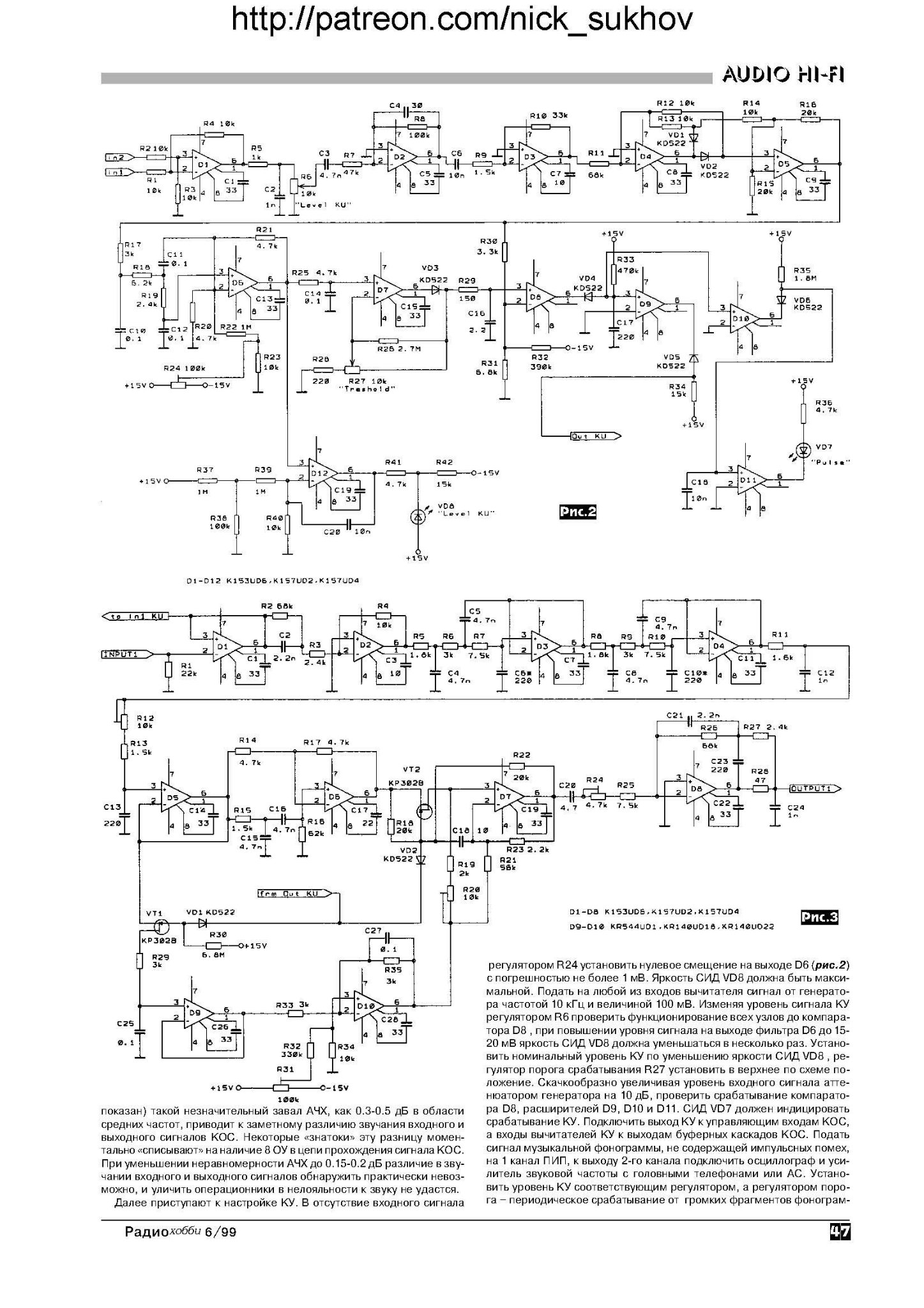

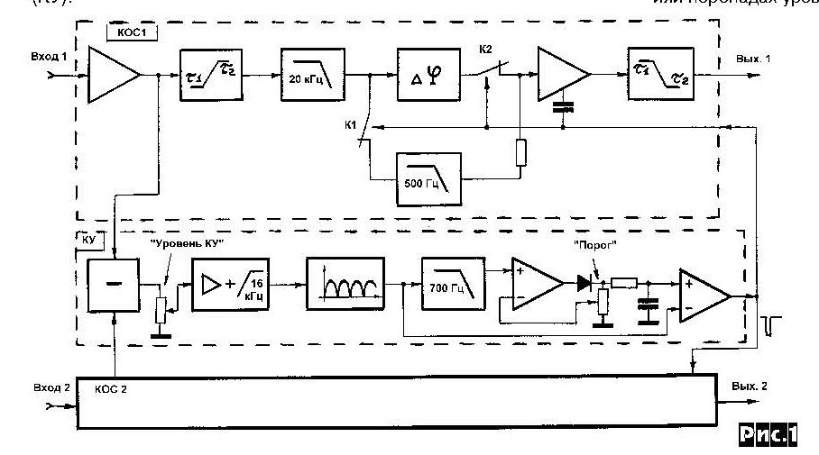

I am enclosing an pdf article from the Radiohobby magazine, I was the editor-in-chief at that time, which describes an analog gramophone click suppressor developed at the Kiev Research Institute of Electromechanical Devices by my friends at the request of the USSR audio archives. Fig. 1 is a block diagram of the device, Fig. 2 shows a diagram of the control channel, and Fig. 3 shows a signal processing channel. The operating principle = allocation by the control channel of the action time of the scratch pulse with "intelligent" interruption of the passage of the audio signal in the signal processing channel for this time by an improved sample-and-hold cascade on the VT2 field-effect transistor.

(...) at that time, which describes an analog gramophone click suppressor developed at the Kiev Research Institute of Electromechanical Devices by my friends at the request of the USSR audio archives. Fig. 1 is a block diagram of the device, Fig. 2 shows a diagram of the control channel, and Fig. 3 shows a signal processing channel. The operating principle = allocation by the control channel of the action time of the scratch pulse with "intelligent" interruption of the passage of the audio signal in the signal processing channel for this time by an improved sample-and-hold cascade on the VT2 field-effect transistor.
And your video impressively demonstrates how effective this (relatively simple) circuit (technology) is. Great. And your video impressively demonstrates how effective this (relatively simple) circuit is. Great. Dear Nick, please continue your work with great former colleagues and don't let yourselves be put off.

I remember similar circuits published several decades ago. But .....
do you find the circuit here above practical? (Risunok #3, 10 opamps in the signal path, filters, phase circuits and controlled gain or S/H) - I do not. I would say that doing the job in digital domain is much more effective and with much better results. And, as said several times, a competent preamp design does not have issues with vinyl glitches.
