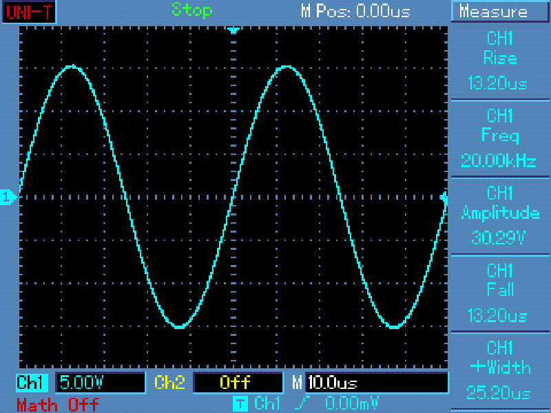

Overload margin less than 20dB, on my specimen it is exactly 15.66dB in relation to 5mVrms and G1k 100.
Everything is still set up, so let's get to work - no problems at all with jumps or impulses. Whether short or long, single or periodic - the Pearl processes everything according to theory, and in an exemplary manner.

30 dB overload at 20 kHz:-
At 1kHz the nominal input to the preamp is 5mV
At 20 kHz it is 20 dB higher at 50mV
To claim 30 dB overload the preamp must not clip at ~30x 50mV on the input
So the unclipped output at 20 kHz for this preamp is 30 x 50mV = 1.5V input at 20 kHz.
If you set your RIAA gain to 35dB at 1 kHz, that means the gain at 20 kHz will be 15 dB or circa 5 x
So the output will be 5 x 1.5V = 7.5 Volts out of the preamp at 20 kHz.
So 30 dB overload on +-15V rails is imminently achievable using all-active RIAA.
I tested my preamp and it gives >8V RMS output max.
Because it’s all active, the overload of 30 dB holds across the entire audio band.
Note, if you set the midband gain to greater than the 35 dB I usually do, you will trade some overload margin away, but that may make sense depending upon your specific noise and gain structure. It usually makes sense to put the most gain up front for noise purposes, but that’s something the designer has to decide on.

Similar testI tested my preamp and it gives >8V RMS output max.
https://pmacura.cz/openphono.htm
40dB/1kHz gain. Rails about 2 x 17V.
