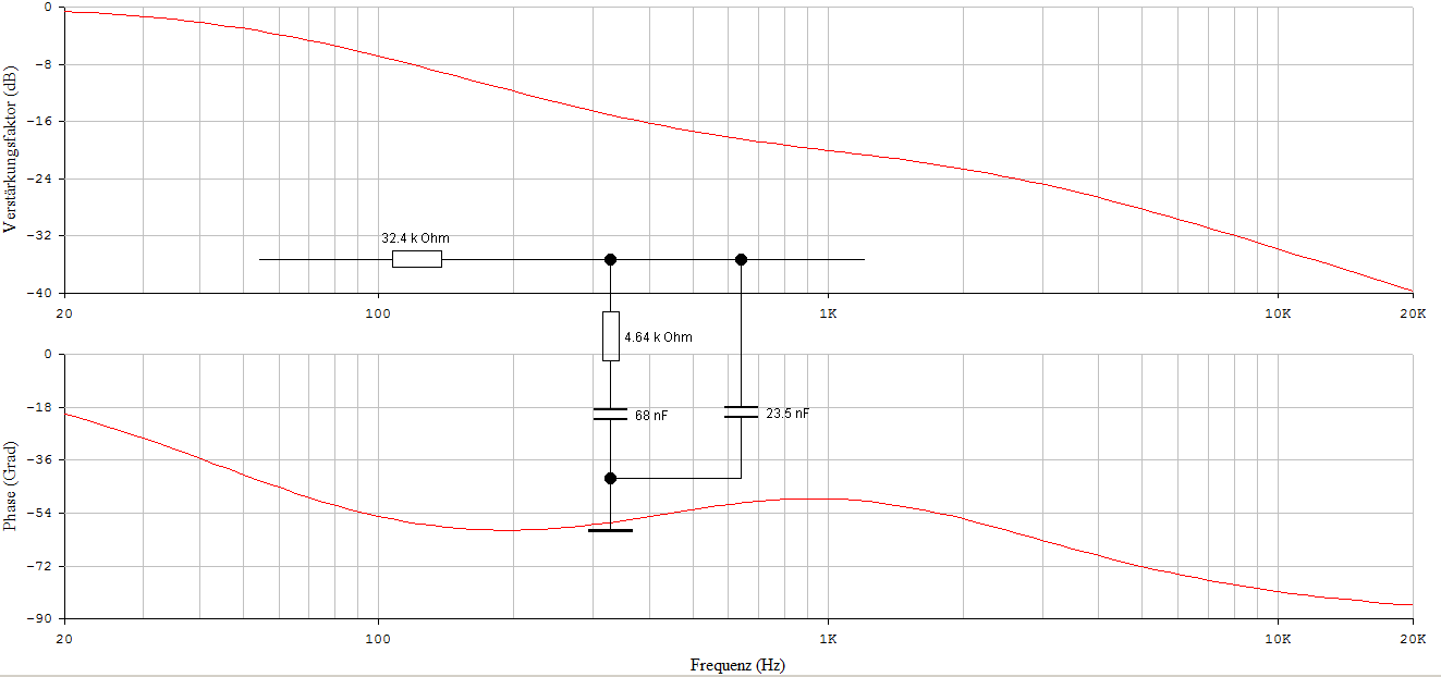

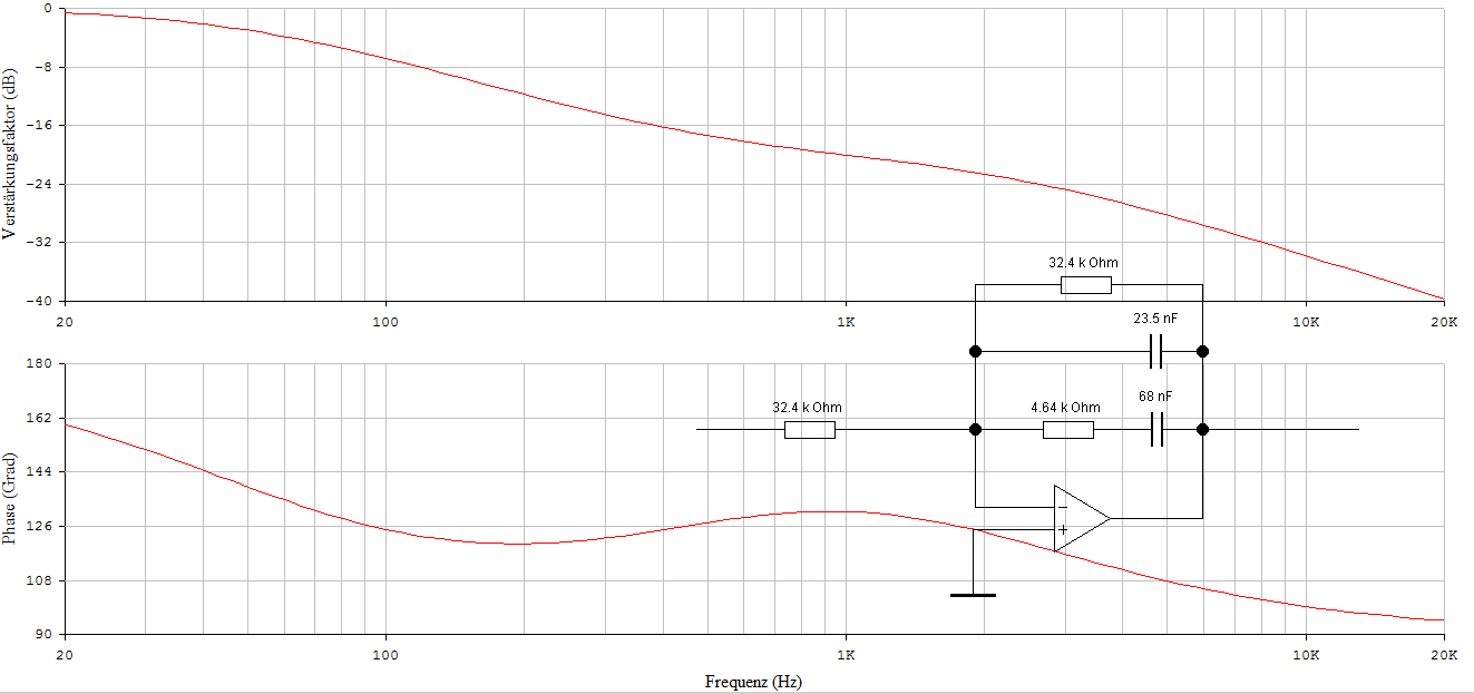

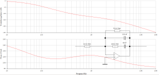

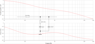

The current question of faith seems to be all about passive vs. active and no longer the question of what is better, because this question is ultimately unanswerable without context (and to make matters worse, the word "better" is not defined in the non-given context!), but what sounds better to the ears of a single individual, where the definition of the word "better" is now also not given.
In the meantime, this discussion thread has become a very profound and intellectually demanding thread.
Let's put the cart before the horse and look at A & B. Which version is the better one and why is that? Alternatively, the question could also be: what is the decisive difference in sound?
HBt.
