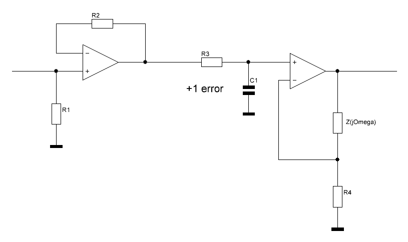

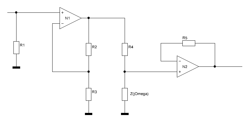

But let's stop counting peas and come to a conclusion. We could use the circuits below as a blueprint. As desired, everything now refers to the reference potential labeled GND or 0V.
Right (may we get started)
refers to this (following) statement alone, without insisting on the correctness of all given statements.

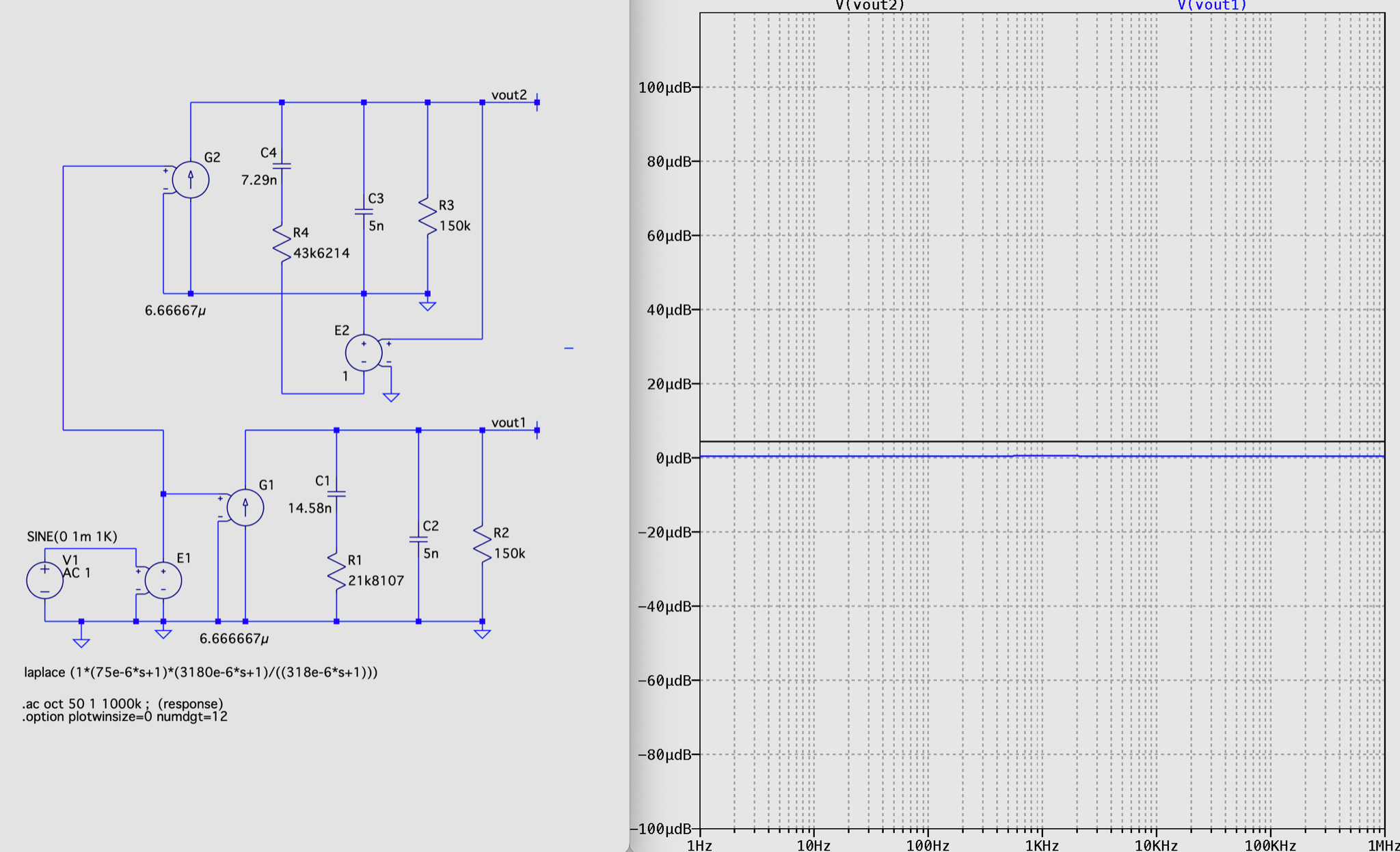

In the analysis of passive current RIAA's (being used in my present phono stage), the manner of its behaviour led to a recent investigation into the way RIAA values can be determined. In order to prove the reality of this with more certainty, all active devices were removed that could influence the result in an LTSpice simulation. By implementing this mechanism of calculation the RIAA flatness extended in the uDB levels as indicated in the two examples shown below (note the lines were deliberately shifted by a slight change in the voltage to current translations of G1 and G2 to support the observation).
The manner of calculation uses only two RC time constants, 318uSec and 750uSec, along with a ratio-metric relationship of the actual values specific to capacitors present in those two time constants, whereupon R2C2 = 750usec, R1C1 = 318usec and C1/C2 = 2.916. This empirical conclusion was also verified mathematically by Hans Polak. In my examination of his work... after about 3 seconds my head started to hurt... so I gave up trying to understand it...
Anyway... the upper network is a simplistic variant using the same principles. In this case the inclusion of the voltage/voltage converter E2 generates a unity gain inversion of the present value of the output, hence always increases the value across R4C4 by a factor of 2. As can be calculated the R4C4 time constant remains at 318uSec. The difference being that the magnitude of the ratio of C4/C3 must be reduced to 1/2 previously or to 1.458 to support the flatness.
As mentioned somewhere before, by the inclusion of physical voltage/voltage amplifier this permits selection of standard values of capacitors to be used, that in conjunction with resistors to support the 318uSec time constant can easily be tuned for flatness, or alternatively support potentiometric variabilty of tuning around the 500Hz pole by about +/- 2dB in the present implementation.
