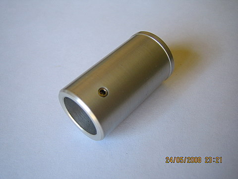

That is what I had in mind when I said making a bush/collar, only, depending on VTA requirements, I might even add the spacer/washer that might be needed for that purpose, for a similar item ...
Thanks,
Java
bulgin said:Hi Java & All
Here's an image of a spacer or step-up bush I made for my Grace G-727 Gyro Master arm. I wanted to show you how it fits on the arm but it's in use, but you'll get the idea.
bulgin
