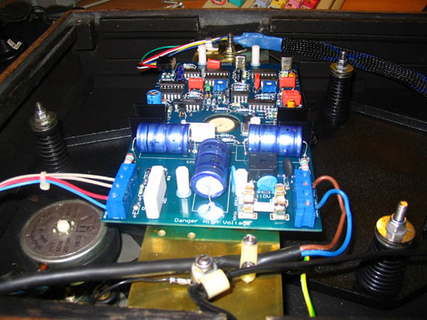

Well i have finally received all my parts and have reassembled my turntable(twice).
The list of mods i've done is fairly extensive.
I also ordered one of those Hercules11 power supplies,but while i was waiting for it i wanted to hear what all my other mods would do to the quality of the audio.
I have to tell you i was blown away by the difference they made.
Its like i have a different turntable.
With all my mods,but without the Hercules, the sound from the Ariston, is to my ears at least, vastly superior to its previous state.
I'm hoping people might be interested in the results of all this modifying but I'm not good at expressing in Hi-Fi speak the differences i can detect,but here goes.Please excuse any incorrect use of terminology.
The most immediate thing i noticed was that various instruments seemed to emanate from quite discernible places in the soundstage.This soundstage seemed to take on what i would call a "three dimensionality".Voices are in distinctly different spaces to instruments.
The second thing i noticed was that the bass and mid bass seems to be much more tightly controlled.Lots of "slam" too, on the right albums dare i say.
The various bass frequencies are quite discernible,and without any 'looseness' or 'woolyness'. and reach down much deeper without losing control.
What also seems to have gone is what i would call the warm midrange. At first i felt the TT had lost something i liked,but after further listening i realised that the midrange now seemed 'more realistic or accurate'.Its hard for me to describe this one.I need to listen more to try and articulate what i'm hearing here.
Then this morning the specially modified switch for the Hercules power supply i had received a few days earlier arrived and i eagerly assembled it on to the deck.
This was reasonably straight forward,but did need a few modifications to fit. I must say i am mightily impressed with Gordon and Edmund from Stamford Audio where i bought the Hercules from.As you know the Hercules was originally designed for the Linn,but as the Ariston is almost identical except for an opposite switch position ,its a small matter to make it work on the Ariston.
The only major problem was getting the length of the cable from the switch to the Hercules board the correct length.The first cable they sent was a fraction too short and strained the connections.Quick as a flash they fabricated up another longer one and dispatched it to me in a matter of a few days.It was great service.Its an impressively built device.Ooses quality.
How does it sound with the Hercules11?.
I thought the mods i did were good,but the Hercules mod is spectacular.Together they have totally transformed my turntable to a whole new level.
The most obvious thing i noticed with the fitting of the Hercules is the quieter background noise.Sure i still gets the clicks and pops on some of my more 'partied' albums,but the absence of noise generally is most apparent.I suppose as a result of this,music now appears to have better dynamic range.I know it probably doesnt in reality,but the effect is there none the less.
Another thing i'm picking up is that the timing or rhythm of the music seems to somehow be better,easier to follow. Sades' voice for example seems to follow the tempo of the song better.The tone of her voice is strong and solid and crystal clear.I know that probably sounds a bit wacky but i'm sorry i cant explain this one well yet either.
After a while i also became aware that i'm now getting lots more detail and information from the groove.I played the track "Mysterious Thing" by Ice house on an album i used to play regularly,and honestly i didn't recognise the start of the track,so much more was i hearing than previously.
The Hercules seems to have taken all the effects i heard earlier and improved them yet again.
The very first track i played when i first assembled the deck was the Police' "Spirits in a Material World".I was in such a hurry to sit down and listen i forgot to turn on one of my two subs.When the track began it actually startled me,it was so clear,so shimmery.The bass was so good i didnt even miss the absent sub.
I cheerfully listened away to the album until my wife came in and pointed out that i had only one sub turned on.
Overall i'm extremely happy with the result of all the mods.If you own an Ariston these mods clearly can make a huge difference to your listening.I used to prefer my CD player because it had detail,bass and definition,but the Ariston now is clearly the better source.I'm enjoying my albums as if it is the first time i'm hearing them.
I'll tell you about my grounding problem next time.I'm off to listen to some more music.

Motor gone
OK,now i'm really depressed.
The clutch is not the problem.Its the motor i think.
When i switch on the motor it hasnt got enough torque to start the platter rolling,in fact even without the platter on, the motor wont begin to spin without me turning it a little first.
As well as that,if i hold the pulley while it is running the motor shaft stops and wont start turning again by itself.
It reminds me of a problem we used to experience with slot car motors back in the 60's.Sometimes we had to remove the armature and do a procedure called undercutting the commutator.
I've got no idea what this Premotec motor looks like inside, or if this procedure is even possible.Or if it is the actual problem.
Seems strange if the motor is worn out.Even though the deck is 25 years old, it wasnt used that much.
I suppose most people would just recommend a new motor.
But the DIY'er in me always wants to at least have a go at fixing the problem first before throwing in the towel.
The big question is, if i do have to replace the motor,where do i get one?
Before that though i would be grateful if anyone has some ideas on whats wrong with the motor,or if its possible to dismantle it in such a way that it can be put back together again.

The Hercules power supply is brand new and is a design commissioned by Stanford Audio in the UK and built by a guy in Hong Kong.It uses very high quality components and is also finished to a very professional standard.
It was originally built as a better option than the Valhalla PS for the Linn Sondek LP12 and in fact, is said in some circles,to be better than the Lingo as well.
I had them adapt it to fit my Ariston RD11S as the Linn and RD11S use virtually the same Premotec AC synchronous motor.
I havn't measured the output voltage as i am not sure exactly what it should be.Nor do i know which wires to measure it across.
I assume it would be across one of the grey wires and either the blue or red wire.
