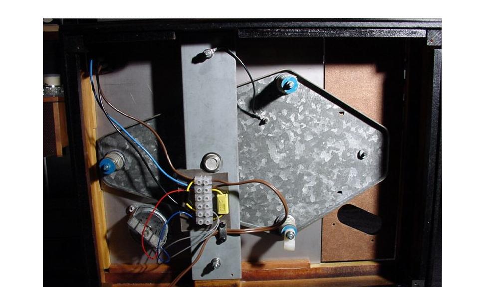

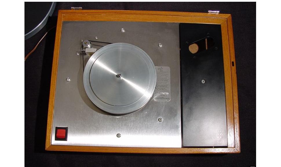

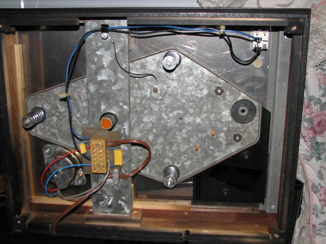

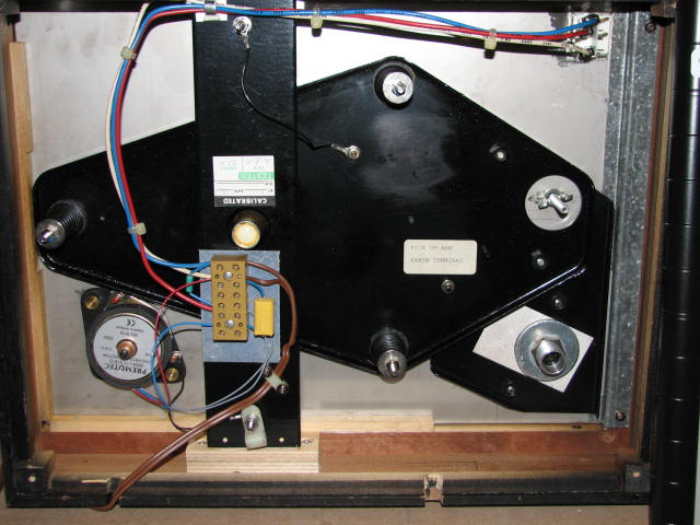

In response to ATAVID I will attempt to post 2 photos - 1 each of the undersides of my 2 Ariston RD11s 'tables. Some background is in order.
The first photo shows the underside of a RD11s for which the top plate identifying label indicates "RD11s", the company is Ariston Audio Ltd (top of label), serial # 003129 CDN, and Dunlopwestayr Limited, Ayrshire, Scotland further down. Note, the galvanized steel/unpainted chassis. The platter spindle has a concaved end - riding on a loose ball bearing.
The second photo shows my second table with a top plate label that indicates RD11 (no "s"), Ariston Audio at the top of the label, serial # 003940, and no further company or address info at the bottom. Note fully smooth, painted and finished chassis. The spindle slightly tapers - but ends with a FLAT end. The bearing is a captive (not loose) ball bearing.
Some observations: Both turntables have a base with is stamped on the underside with a manufacture date of June, 1974. Both plinths have on the front a "badge" that says Ariston Audio, both top plates have "RD11s" above the power switch (which is on the right side) and a round tonearm board. DIFFERENCE - you can see that the outrigger tonearm platform is not shaped the same for the 2 tables. Without taking the chassis out of the base I can only say that both arm platforms appear to be just bolted to the kite shaped sub-chassis. I suppose they could also be spot welded - but I cannot tell from the underside.
I know from some research through the internet that Hamish Robertson left Ariston - the company he started - in 1973. That is when Dunlp Westayr Ltd bought the company. Dunlop later sold the company to John Carrick. John now designs audio cables for Atlas Cables/Scotland.
I am interested in the HISTORY of the turntables – meaning turntable models came first and which second. Was the RD11s before or after OR at the same time as the RD11 (no “s”)?? Anyone know???

Good on you,thanks Torens for posting those pics,i do appreciate it.
Its always interesting to see the variations in what is basically the same model.
I now know what the big hole in the subchassis was designed for(a tonearm rest mounting in the top plate above it).
I see that you appear to have fitted one of the later Linn Premotec motors with the bearing end cap fitted,whereas the motor on your earlier deck(galvanised chassis) has a motor very similiar to the early Linn decks.
I found the label that was attached to the top plate of my RD11S in my little box of bits and pieces.Mine too only says it is an RD11 not an RD11S, which it clearly is.
They probably just had a lot of them left over from what was, i believe, the earlier model, the RD11.
If i recall, when i ordered my deck back in the very early 80's,i originally asked for the RD11,but the dealer came back and told me it had been superseded by the better/later deck, the RD11S. I also recall him telling me it was very similiar in tonal qualities to the Linn at the time.
I had a friend who had a brand spanking new LP12, and a side by side comparison, left me a little disappointed. It wasn't that the RD11S was bad,i felt it was pretty close in sound,but just sounded a little "too lush" without the "detail" of the Linn is my recollection. Mind you,it was a hell of a lot better than a lot of the other decks around at the time.I remember a comparison with a Dual for example.
If you look at an RD11 it is identical in every way to the early Linn with a full length arm board attached with 3 small self tappers as per the Linn,an identical on/off switch to the Linn in the same position, and what looks like the same motor/pulley/guide and mounting arrangement as the early Linn.
Your info about the two bearing types is interesting as i believe that the later design used in the RD11S ,but used earlier by Linn in its deck was the thing that set the Linn apart sonically from its competitors,and really distinguished the LP12 from the RD11.
I have some images of the RD11 from one that sold recently on Ebay.You can clearly see the similarities to the Linn.
