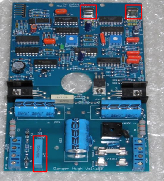

Does anyone know how I can get a 50 Hz pulley for an Ariston RD11 ?
I am in the US and have a 60Hz pulley but I am installing a Hercules 2 power supply and do not want to change the xtals on the board so I am looking for a 50 Hz pulley.
HELP!!
I have a 60Hz Ariston RD11 for which I am getting a Hercules board. I do not want to change the crystal on the board and therefore want to machine my own 50Hz brass pulley since it has been next to impossible to find one anywhere.
My belt is 2 mm SQUARE. I want a V groove pulley since the belt nicely fits into it and there is minimal chance of belt slipping off the pulley. I intend to make the inside of the V greater than 90 degrees so the belt is not piched or squeezed.
Am I correct to assume that the INSIDE diameter (bottom of the groove) is the effective diameter since that is the closest to the pulley that moves and starts the motion ?
By that logic, as long as the groove angle is MORE than 90 degrees, there should be no belt squeeze or pinch and the above logic should stand.
So, therefore the INSIDE diameter of the 50Hz pulley should be:
d = 33.3 x subplatter diameter / 250 rpm
From the above, d = 33.3 x 164.44 / 250 = 21.9 mm
I presume this is the INSIDE diameter of the pulley. The outside diameter is irrelevant since the belt contacts the pulley at the bottom of the V and that is what should be the effective diameter.
Is my logic correct ?
Comments ?
Included the hercules mods to make it work with 60 Hz. The components to be changed are indicated with a red rectangle.

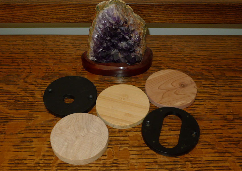

I purchased an RD-11 from a guy in Canada, while I wait for it to arrive I am getting my mods lined up. First up is trying a few different wood species for an armboard. I had a couple of old armboards from RD-11's that I had modified and sold before so I had templates.
From left to right the wood types are spalted maple, stranded woven bamboo (the hardest wood on the Janka scale) and aromatic cedar.

I have used ebony armboards on many a table, I do like it... not to mention it looks great too. It is very hard to get now & have used cocobolo quite a bit lately.
