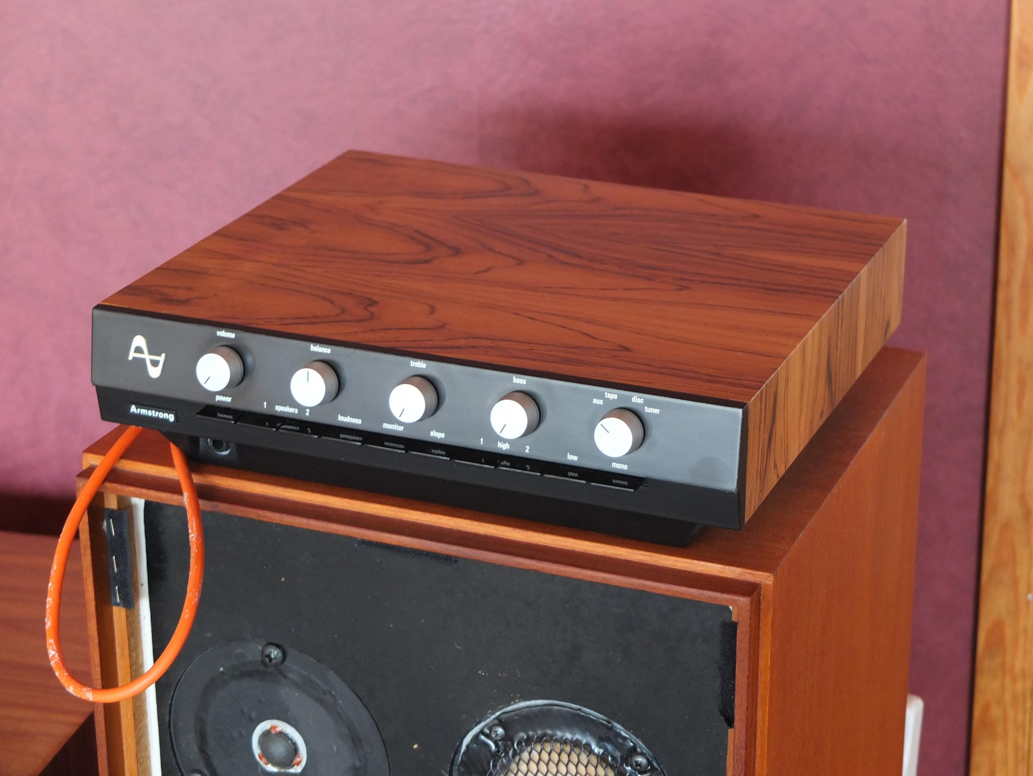

I have story about high current capability of amplifier. Last spring I did Armstrong 621 rebuilt, you can read it from here Armstrong 621 rebuild - Members Pictures - Speakers, Electronics, etc. - The Classic Speaker Pages Discussion Forums
When I received the amplifier, thermal switch was open all the time. This switch was supposed to short circuit 1 watt 47 ohm resistor between transformer secondary and diode bridge that powered 3300 uf/100V main reservoir cap. 47 ohm resistor protected 1A diodes from surge, when amplifier was powered up. If you think that there was 47 ohm 1 watt resistor in series to two 8 ohm speakers in parallel, max long term output was less than 100 mW, more than this was available on short term basis from 3300 uf main reservoir. Yet amplifier sounded OK with low volume. Of course there was no way to exceed available long term power, but 100 mW can deliver reasonable SPL with 90dB/1W speakers anyway. Moral of this a bit funny story is: Too much power or amperage is not needed for 80 dB SPL with fairly efficient speakers, but with difficult impedance in inefficient speaker nothing seems to be enough if your goal is high volume in large room.

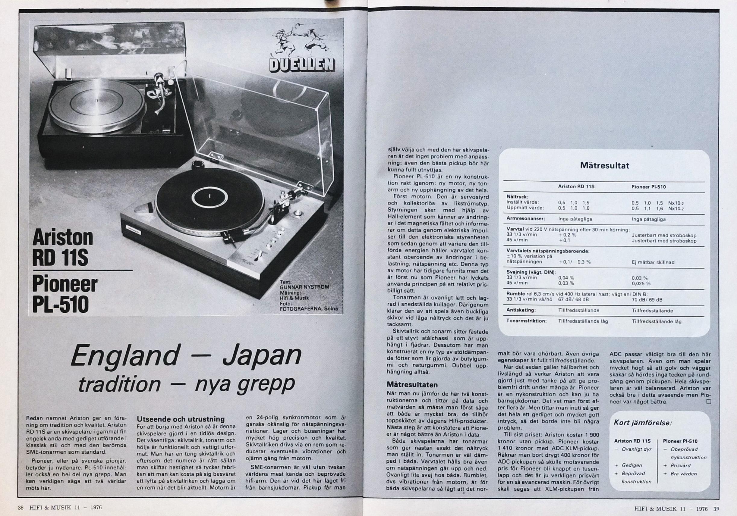

There is something fishy in your 1971-73 RD11s timeline. I am enclosing scan of Ariston RD11s vs. Pioneer PL-510 review in November 1976 issue of Swedish Hifi & Music. You may note that platter is different than in my RD11s, this one does have two rubber rings to support LP... how about 7" and 10" records? Your idea that manufacturing year was somehow coded in serial number would most likely mean, that 007795 serial number was made in 1977 if one or two first numbers indicate build date. If last number is the date code build year would be 1975. Motor seems to have 4179 date code, this would mean 1979 build date but motor may be replaced due failure. I must check if there are any date codes printed on spark or motor run caps, whenever I open the hood next time.
In Vinyl Engine was mentioned that RD11 Superieur was priced 350 GBP in 1983 and 1984 Hifi Choice. RD11s with SME3009S2 was priced 1900 SEK in 11/1976 issue of Hifi & Musik, LP12 was priced 1490 SEK and Grace G-707 was 585 SEK in the same magazine. So... RD11s was sold for slightly less money than LP12 in Sweden too.
