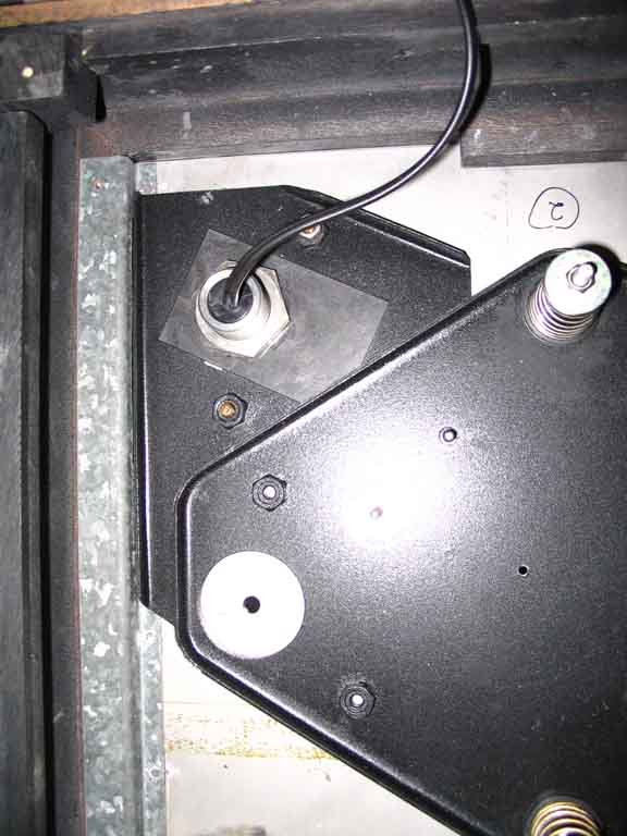

Modifying RD11s
I've had more time to delve deeper into the RD11s and i notice that where that second piece of pressed steel is spot welded to the main subchassis there is a fair amount of flex between the two pieces.
That does not seem like a good thing to me so i have applied araldite at the edges trying to get it to run down and set between the two pieces and make it (hopefully) a little more rigid.
Another thing i notice is that the rubber grommets that isolate the motor from the top plate are not very soft or pliable.Should they be? Would it help if they were a softer compound?
Also the flat rubber gasket fitted between the motor and its mounting plate looks (from the visible edge at least) to be going brittle and hard with obvious cracks around the outside edge.
Should i look at perhaps replacing this gasket, again with something softer?
The whole plinth and top plate assembly is like a bell.One tap and it rings away quite badly.I notice Ariston have applied some sound deadener to the inside of the plinth,but it is very minimal and obviously ineffectual.I have some 'spray on' rubberised sound deadener and am going to mask up the underside of the top plate in key areas and spray both it and the inside of the plinth(fingers crossed).
Lastly i want to lubricate the motor bushes.The pulley end is easy enough to get at but the other end seems to be sealed with some kind of nylon device that appears to only be removable from inside the motor housing.Has anyone had experience with this?Is there some way of getting lubricant to that end bush?

Kevin, I've nearly done as much as i can do to the TT now.Its looking good!Hope its going to sound even better.So far i've done the following:
Replaced all nuts bolts and screws with Stainless steel variety.(Couldnt get full length threaded bolts in High Tensile)
Made a new bottom cross bracing plate out of 8mm brass instead of the flimsly thin tin original unit. Gives the whole top plate a more solid feel when its bolted down to it now.Again dont know if it will help or just look good! Polished up beautifully too.
Sprayed the whole underside of the top plate and the inside of the plinth with a rubber compound after adding some more bracing to sides.Much more inert now.
On the subchassis i have removed the two 'welded on' surplus nuts(left overs from some previous incarnation of the subchassis.
I have epoxy glued the two sections together,and put a bead of epoxy around the joint of the main bearing to the subchassis.
I've put tight fitting plastic tubing over the long spring bolts and lubricated the spring rubber washers with silicone to allow easy rotation and adjustment when setting up the suspension.
I checked how flat the armboard mounting section was(not very) and then sanded it down on glass to get it flat and smooth.Then did the same thing to the armboard itself.(its circular on the RD11S)
While i was at it i shaved a little metal off the side of the subchassis where it almost touches the underside of the top plate hold down bracket.I remember when setting up the suspension in the past it would be too close for comfort when i had the armboard centered. A good 3-4mm clearance now
I've then given the whole subchassis a couple of fresh coats of the original style wrinkle finish paint to help dampen it. Works well too!
After much searching i found some nice soft rubber grommets for the motor mounts.They work well,but i've modified them a little so they stick up proud of the internal female screw receptors (thingys) so there is more pressure exerted on the grommets and top plate when the motor screws are tightened up.The motor shaft now sits a little off vertical until the belt is fitted and turning the platter,then it is enough to just pull it into the vertical position.
I've cleaned out my main bearing which had solidified dried up gunk in it, and now spins nicely.Only put sewing machine oil in it at this stage but will try heavier stuff later.
I managed to lubricate the motor bushes and it runs almost completely silent now.No more 'woop woop' noise as it spins.
I pulled apart the motor clutch mechanism and cleaned and relubricated the felt washer and other bits.Also got all the talc powder residue out of the pulley grooves.
One of the last things i want to do is fit some sort of rubber band around the motor,just to dampen it a little more.Have to see what i can find around town for that one,unless anyone has some suggestions .
The suspension is set up just roughly at the moment as i am going to fashion up a jig to allow me make all the adjustments while the table is sitting flat.I've spun the whole table up and it is running really smoothly and as quiet as i can ever remember. Now i'm just deciding if i will get the RB300 rewired with Cardas cable(bloody expensive over here) or the Van Den Hul rewire kit. I've also ordered an adjustable VTA unit for the RB300 too.But i think i will refit the arm and listen without the rewire first so i can ascertain what differences my mods have made.
