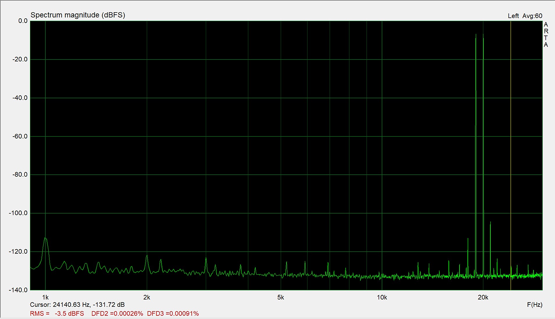

Image 1) The IMD from the current Shift Register Firdac, both 19&20Khz signals at -6dB.
The two 3rd order products are quite different.
Image 2) IMD from your Solid State DAC, taken with both 19&20Khz at -16dB.
Image 3) IMD from the Solid State DAC with both 19&20Khz at -6dB.
A huge difference between 2) and 3) but the third order products have equal amplitude in both cases.
So maybe the current shift register Firdac should also be given a try at -10dB because the drop in IMD is significant.

I have the following to comment on the figures.
In Arta's manual I can find:
second order IMD in percent is: 100* I(f2-f1)/I(f1+f2)
third order IMD in percent is: 100* I(2f1-f2)+ I(2f2-f1)/I(f1+f2)
In my IMD measurement:
I(f2-f1) = -119.27dB or 1.08768e-6
I(2f2-f1) = -109.43dB or 3.37676e-6
I(2f1-f2) = -119.27dB 0r 1.08768e-6
Rms level according to Arta was -3.5dBrms, so both f1 and f2 are at -6.5dB.
I(f1+f2) = Power(10;-3.5/20) = 0,668344
Applying the above figures gives:
IMD second order at 0,00016% or -115,8dB (Arta mentions 0,00026% ??)
IMD third order at 0,00067% or at -103,5dB (Arta mentions 0,00091% ??)

I may have done something that may cause the difference between Arta's and mine calculation, roughly a sqrt(2) but by using the same calculation, Bohrok's figures and mine are 1:1 comparable.
What can be seen is that both our third order IMD with resp. -103.5 and -103.9 are within 0.4dB !!
However Bohrok's second order IMD is 19.2dB below mine with -135,0dB versus -115.8dB.
This could well be caused by my Lynx A/D converter having a specified dynamic range of 117dB.
Hans
After all Arta was fully correct and reproduceable because I made a silly error in the scale factor of my graph, but not in Bohroks calculation.
Now I get the same figures as Arta calculated, IMD2 = 0.00026% or -111.7 dB and IMD3 = 0.00091%. or -100.8dB.
This means that Bohrok measures 23.3 dB less IMD2 and 3.1 dB less IMD3.
His A/D converter must be far superior to my Lynx.
Hans

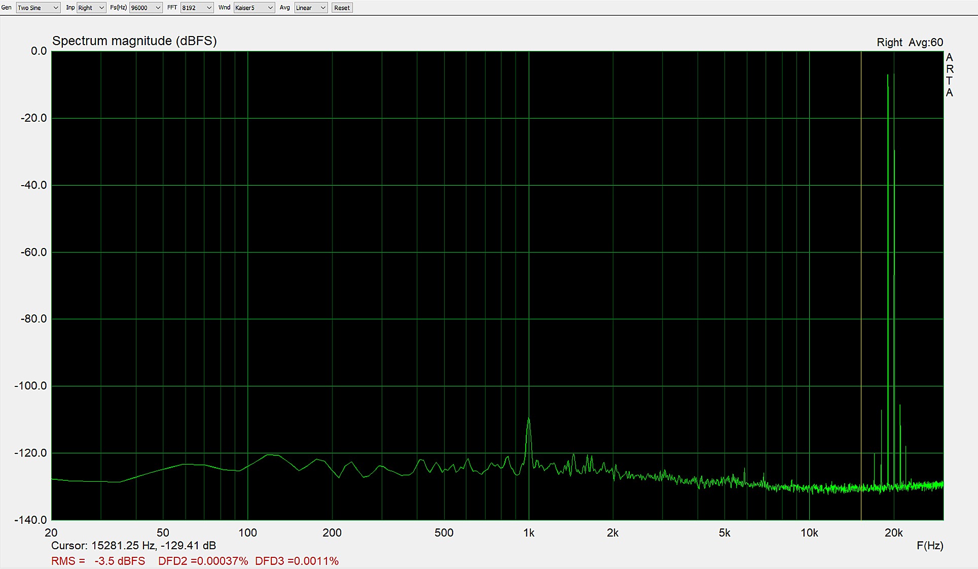

Just to show that the relatively large differences between the two third-order product are purely caused by the Shift Register Firdac circuit, here are:

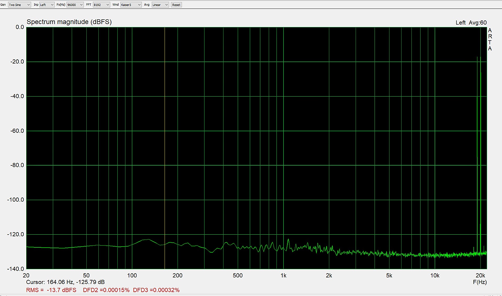

Theoretically, a 10 dB signal reduction should reduce the third-order products by 30 dB and increase the distance to the tones by 20 dB. That applies as long as higher-order distortion doesn't cause substantial distortion products that fall on top of the third-order products.
True, but my Lynx could never display such a large dynamic range.
With only 117dB I don’t know whether the 1Khz product is from the Firdac or from the Lynx.

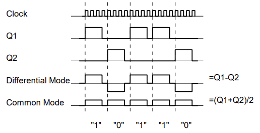

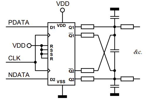

By switching noise of RTZ is that random or correlated noise?
By inherent nature, RTZ DAC's switch a full cycle for every H.
This creates common mode "clock subharmonics or clock feedthrough (not harmonics, as we are always at frequencies at or below the clock for fundamentals), if we want to persnickety)" compared to a NRZ DAC.

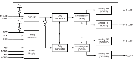

Here an example of a NRZ DAC with 75% duty cycle (common in commercial DAC's, e.g. Burr Brown DSD1700:
The differential mode signal, as considered by the filter, can be seen to have one “+1” state, one “-1” state and one “neutral” position which is assumed for one quarter of the bit time. Unfortunately, the common mode signal is not zero. While it is true that it doesn’t contain any information, it is a rather hefty HF signal. This signal is supplied unattenuated to the first pair of op-amps which are required to attenuate it without exhibiting significant nonlinearities to affect the wanted signal. Only the best jfet op-amp will do here (the OPA627). Another high-quality op-amp (MAX427) was found to produce spectacular amounts of noise and distortion (0.1%).
Note here in the DSD1700 block diagram the "Duty Generator":
So we have a lot of common mode noise caused by the DAC switching at the update clock.
The noise is not correlated with the audio, but correlated with the clock and noise shaper.
With NRZ the level of this steady state noise at the FIR clock frequency is equal to full scale.

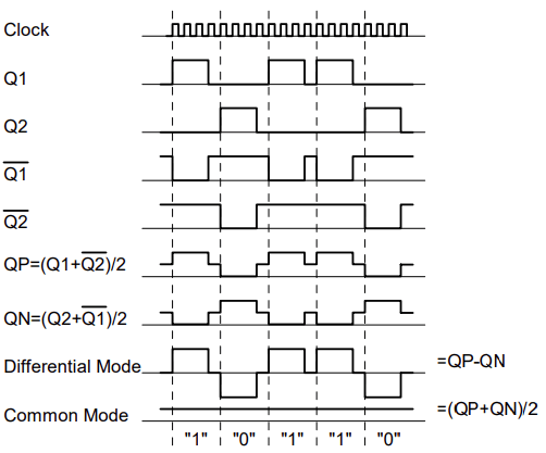

I would instead suggest a mitigation strategy for MvG's DAC, that is kind of trivial to implement, at the cost of doubling up the DAC devices.
I cannot claim credit, it is in principle found here in Bruno Putzney's paper:
https://www.researchgate.net/public...s_for_high-performance_discrete_AD_converters
MvG's DAC has 50% duty Cycle. Let us say we add a second complete DAC section, operated with opposite polarity RTZ clock. So whenever the main DAC has a Zero following a One, the auxiliary DAC has a One following a Zero.
The resultant combined waveform substantially resembles an NRZ DAC, with much lower glitch energy from NRZ. Using illustrations from Bruno's article again:
The common-mode component is now clean, save for any spikes caused by unequal rise and fall times. These spikes are so short (<1ns) that supplementing the first filter capacitor with a pair of much smaller ground-referenced ones will rid the signal completely of common-mode.
