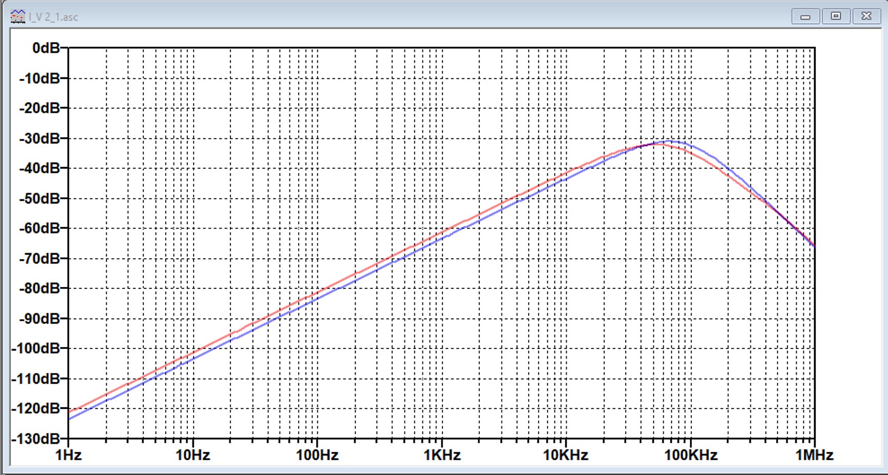

While still not excluding the possibility that the perceived sound improves when disabling the CM servo for audio frequencies, I came to a surprising result while simulating the sensitivity for the components accuracy.
Varying the tolerance for each component showed totally different effects on CMRR, so it is just not possible to tune one of the two 2K servo resistors to optimize CMRR.
I gave all resistors on the upper differential side of the first stage including the compound 376.25R Firdac resistor a 0.2% tolerance and 2% for the two caps. The lower differential side was unaffected by changes in tolerance.
Now I measured CMRR at the differential output of the first stage with
1) the original servo components 2*2K and 15pF and
2) with 2*1Meg and 10uF.
The attached curve in red is for the 2*2K+15pF and the blue curve for 2*1Meg+10uF.
To my big surprise the servo disabled for audio has an even better CMRR as the original one.
This was just one attempt and with tolerances even closer as in Marcel's circuit diagram !!
So I tend to believe the possibility that perceived sound can improve when using the servo only for DC restore purpose and not for CMRR.
Hans
