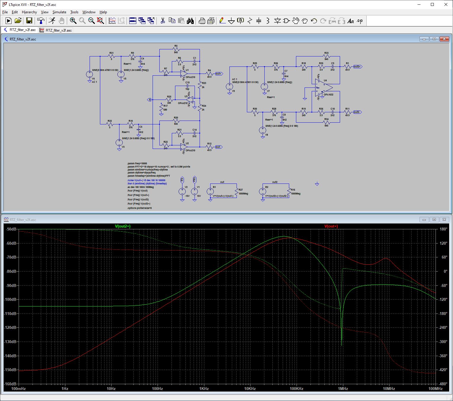

Here you are. Something odd in OPA1632 model as there is strange resonance.

Slowing down the CM loop supposedly improved sound by helping to retrieve more detail. This is what happens to CMRR.
This is exacly what Mark did in SE with all CM content still available in the signal.
So he obviously favoured the Signal + CM.
When you want to compare both circuits you have to use Out and Out2, because with the second circuit the SE output is made from the differential input, so when just looking at SE outputs you can’t compare them.
Hans

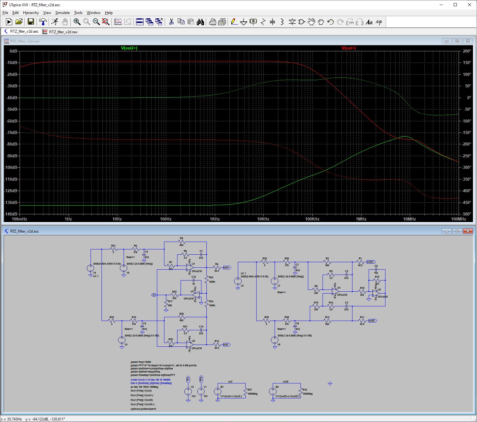

Looking at SE output was to see the CMRR of both circuits. Looking at differential output the impact of e.g. one cap being 8n4 is about the same in both circuits so the servo does little to help with that.
One thing that stands out in these simulations is that the divider at CM servo opamp output has an impact on CMRR. Stock filter with 3k9/680 divider does not seem to be optimal. But that does not explain why differential output is impacted.
The OPA1632 that you used has a GBW of 40Mhz and a slew rate of 72V/usec versus 18Mhz and only 6.4V/usec for the OPA2210, so you are seemingly comparing different topologies with unequal op-amps.
I just tried OPA992 as CM servo opamp. It has slew rate of 32V/us but GBW of only 10.6MHz so it is not "faster" but has slew boost. Almost identical result at 10kHz as OPA210 so no change for the better.
As already mentioned, in Marcel’s circuit DM and CM are treated separately.
So when forcing both Firdacs to produce the same output, CMRR can be tuned to compensate for tolerance differences with one of the two 2K resistors without affecting the DM gain.
