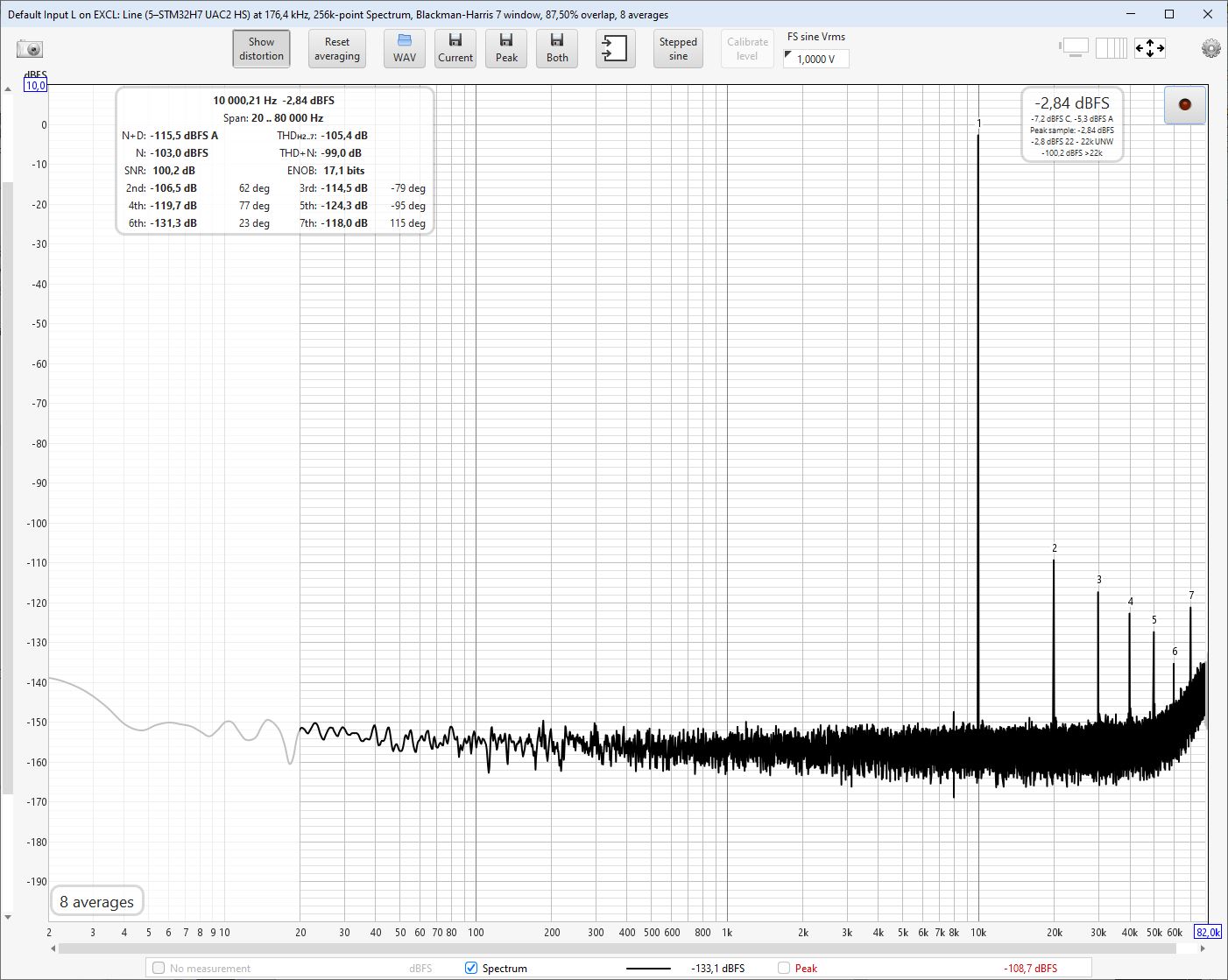

Bin width is shown in my measurement (ADC fs 176.4kHz, FFT size 256k).
What was the bin width you used in the measurements in your report?
I don’t have the info on bin width available since I’m on holiday at the moment, but what I can say is that my differential LNA preamp had 130pV/rtHz noise, but added to that the two 50R output resistors from the Dac already increased this to 1.4nV/rtHz.
Teminating the input of the LNA with two 50R resistors, gave a noise level that was at least 20dB below the noise with the Dac connected.
So the noise in my spectrum is just noise from Firdac and Filter.
Hans

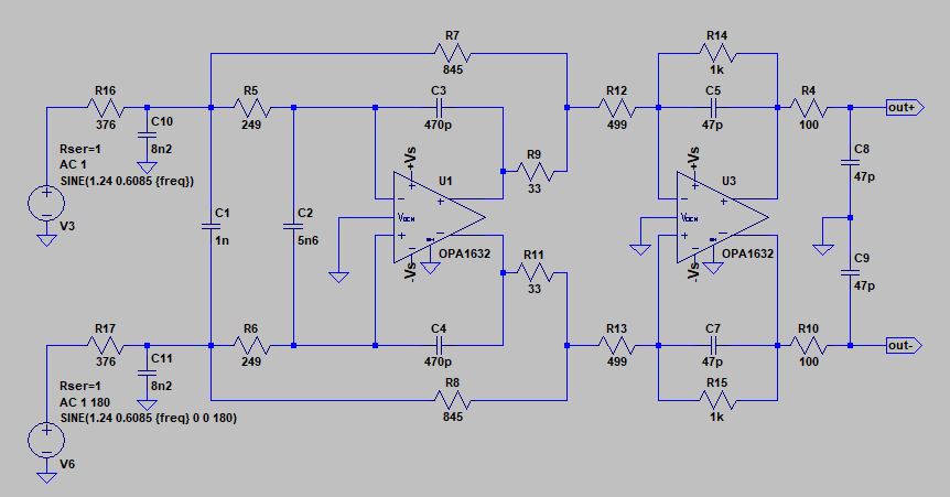

I made a very quick & dirty test with a bog-standard output stage in post #2125 by hooking RTZ shift register output to the output stage of one of my AKM dacs with jumper wires.
This is the actual circuit.
Here is 10kHz differential distortion of that setup.
So even with this rudimentary setup clearly better than stock filter. And no DC offset at single-ended output.

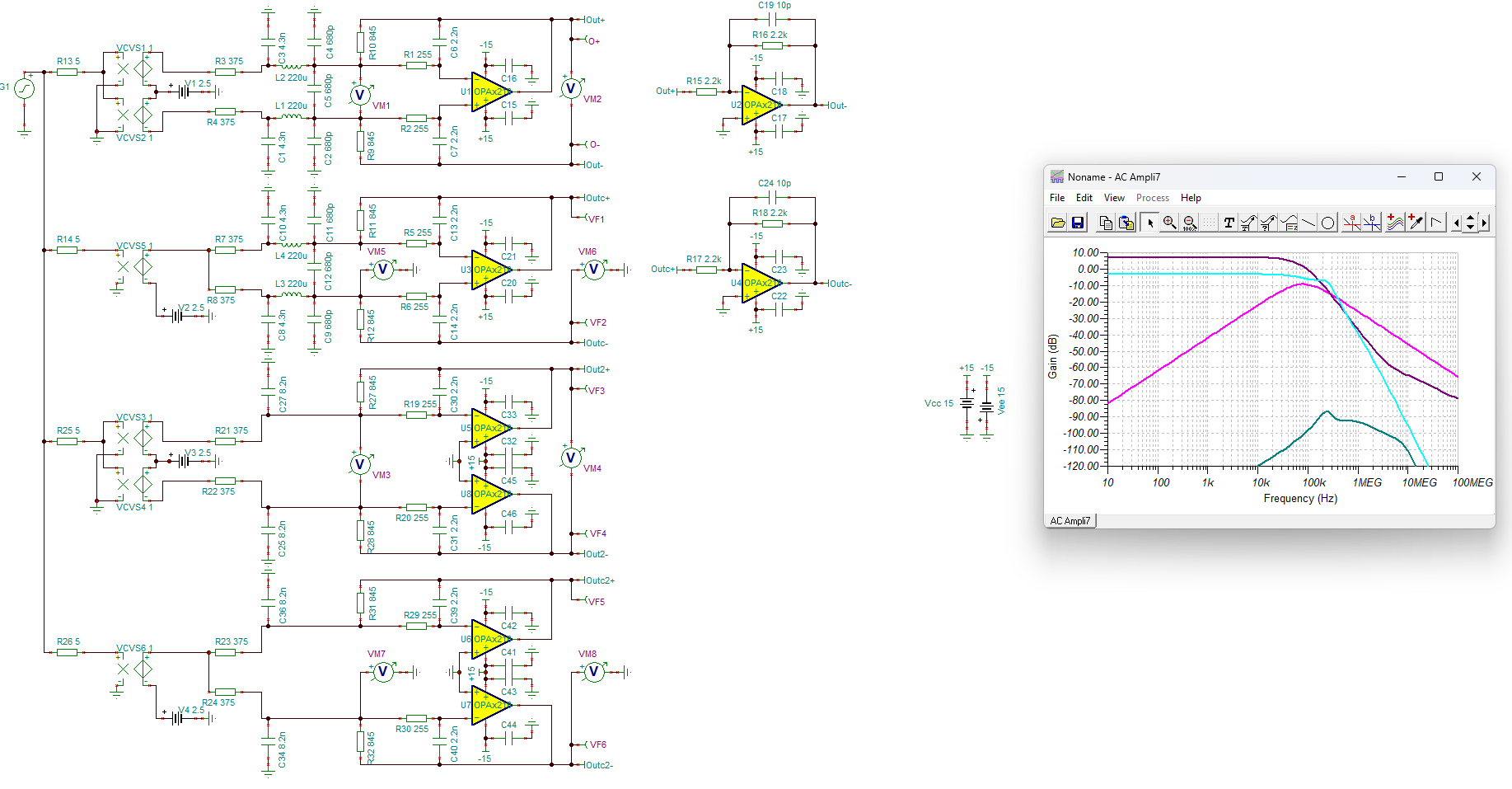

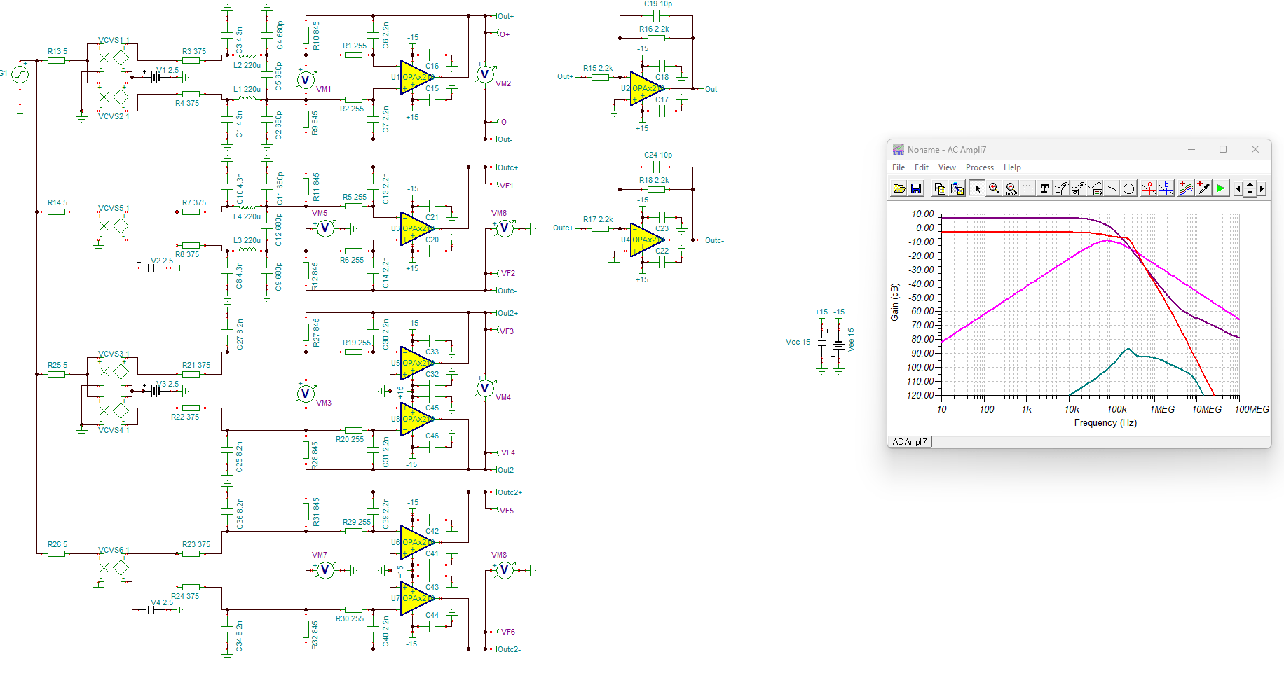

Here my frontend suggestion compared to the original WITHOUT common mode servo:
Purple and Fucsia are the respective common mode MvG test circuit's output (Purple) and normal I/U conversion virtual ground node.
Light Blue is the common mode input on my suggestion and Teal is the common mode output.
Differential (and SE Out) match pretty closely, the extra filtering in my circuit adds0.1dB 20kHz attenuation to orignal design.
Improvement in common mode rejection at I/U conversion out at 100kHz is 90dB, 55dB at 1MHz and 45dB at 10MHz.
Noise at input of the I/U conversion at 10Mhz is improved by 50dB.
And no common mode servo is needed yet DC at the I/U conversion output is 0V.

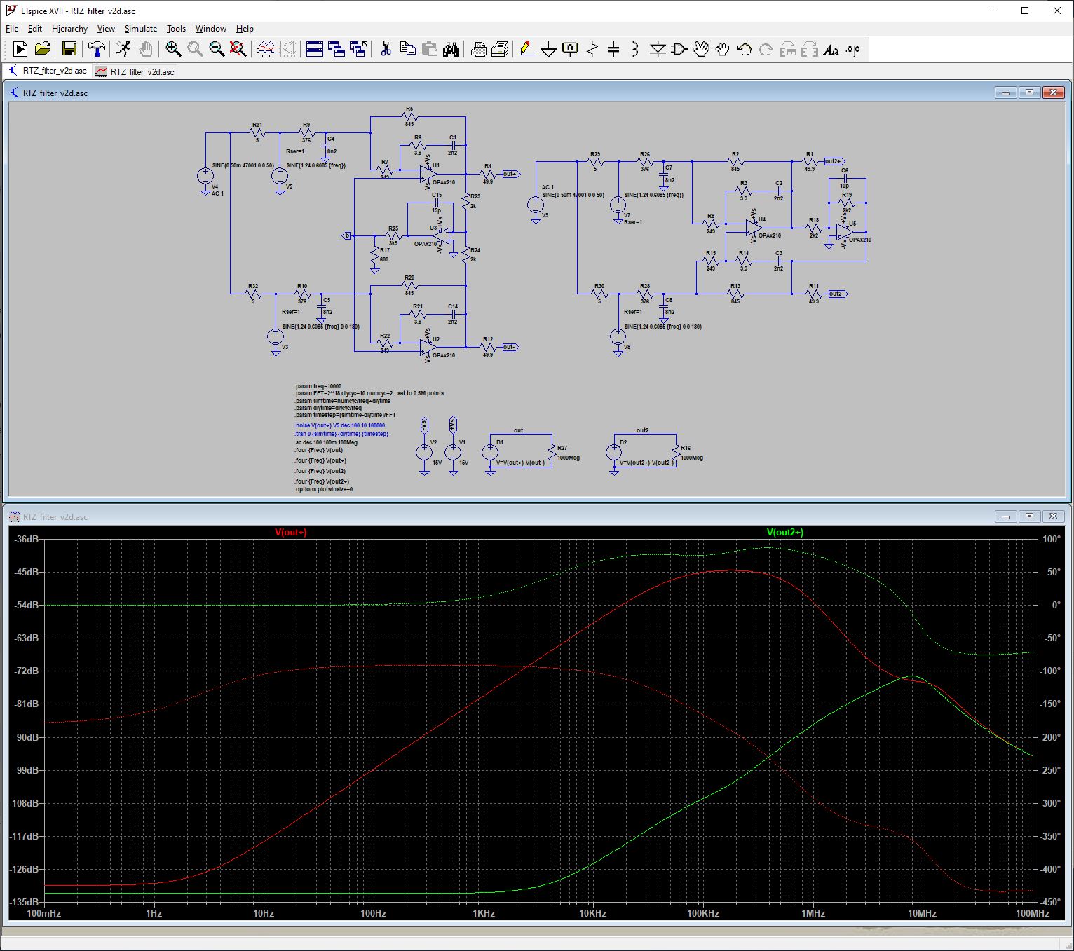

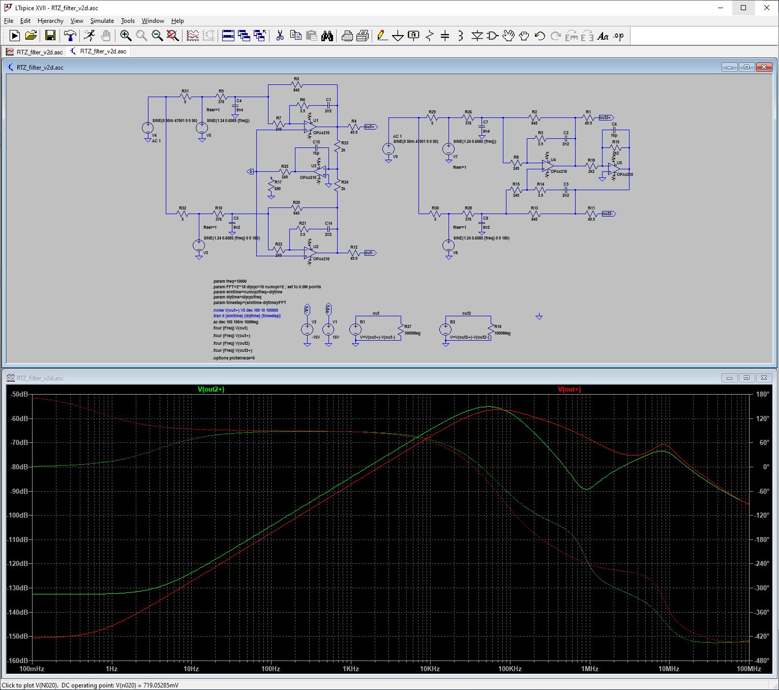

Here is my take on simulating the CMRR of stock (red) vs. Thor's (green).
That’s a rather substantial improvement of almost 20dB in the audio band.
But yes, the other circuit performs even better.
Replacing the two opamps in the second circuit by one OPA1632 would probably even furthe improve CMRR.
However keep in mind that this is with components that are absolutely ideal.
To start with, the Firdacs will have tolerances and so have the caps and the resistors.
So how realistic is this idealistic image.
Just make one 8n2 cap on both circuit 1% larger to 8n282 and see what happens.
Hans
P.s. reducing C15, the 15pF cap might improve the CMRR of Marcel’s circuit even more.
P.s2 probably even 1% is totally unrealistic and should be higher.
Reactions: LTK

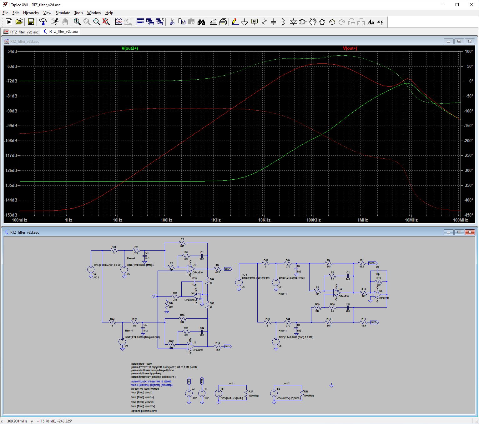

Now you are definitely on to something. Increasing one cap to 8n4 and CMRRs are similar so Marcel's CM loop has clear edge against tolerances. But whether or not that is also true in practice is the question. My test with OPA1632 stage seems to prove the opposite.
