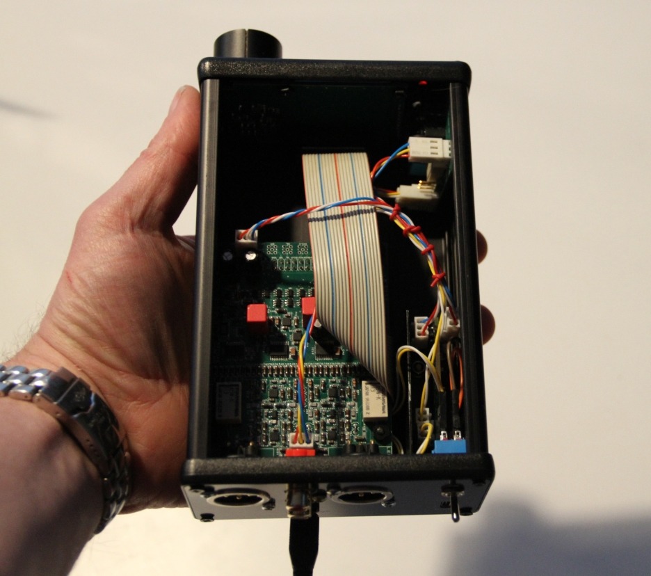

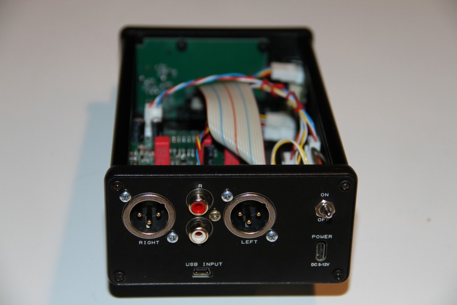

On a more positive note, as I explained in post #1979 my plan was to put this in a 160x100mm Hammond box. Actually I managed with plenty of room to spare so even a 120x100mm would have been sufficient. But the height of the sandwiched RTZ+USB-DSD board is the issue as it is almost 50mm.
Here are some pictures of the result.

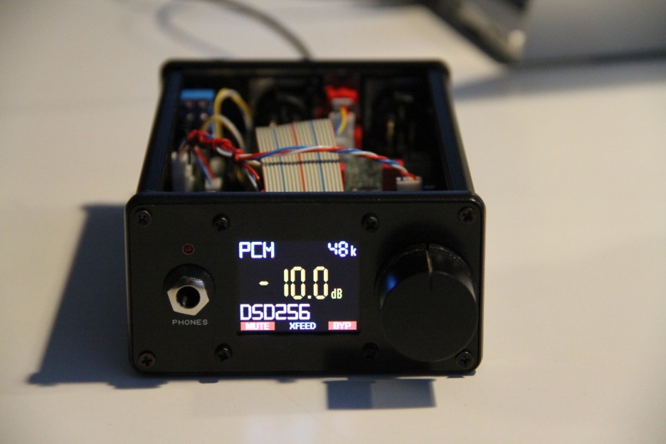

The box contains RTZ dac board, USB-DSD board (STM32F723+PCM2DSD), DC-DC converter (my "SilentSwitcher" using TPS7A39), front panel control board (with display, rotary encoder and IR led) and a headphone amp with switchable crossfeed.
As can be seen from the front display I've added a software based digital volume control. This operates on PCM input from USB so it uses 32 bits. I intend to use it only for the built-in headphone amp and fine tuning the output for my main amp which has 3dB stepped volume control.
Front and back panels are black PCBs. Not the best looking but fit for purpose.
All my other DAC boards (AK4490, AK4493, ES9038Q2M, ES9039Q2M) have the same layout so I can use the same box and panels for them as well.
And the volume knob is temporary 🙂

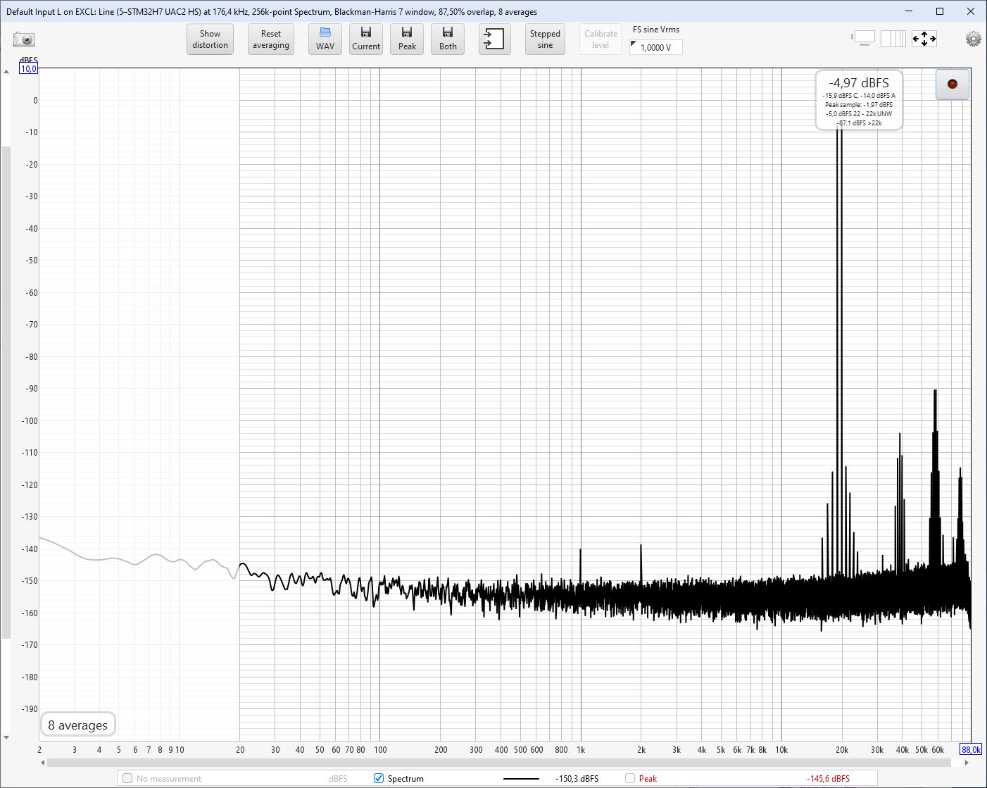

Here is mine with "stock" filter.

You are right that IMD at these frequencies are not the optimum for the issue at 10Khz that you mentioned, but IMD and THD are different expressions caused by the same non linear behaviour so in this case with the even higher frequencies it could give a fair impression.I'm not sure if CCIF IMD is a proper measurement for this issue.
Allow me to comment on your results.
With -4.97dBFs, you could have increased the sum of both signals to 0dBFs, which is what I did to get the most critical situation.
The 2nd order product f2-f1 and the first two 3rd order product 2f2-f1 and 2f1-f2 are usually having roughly the same amplitude, which was true in my case but with ca. 25dB between them not at all in your image, altough we were at the same level with the first two 3rd order products.
https://www.diyaudio.com/community/threads/return-to-zero-shift-register-firdac.379406/post-7403333
So the question is: how can these large differences be explained. When I remember correctly, in my case the filter was equiped with the OPA2210, what amps did you use ?
And does the used DSD frequency make a difference for the 10Khz distortion that you measured, I made my measurement at DSD256.

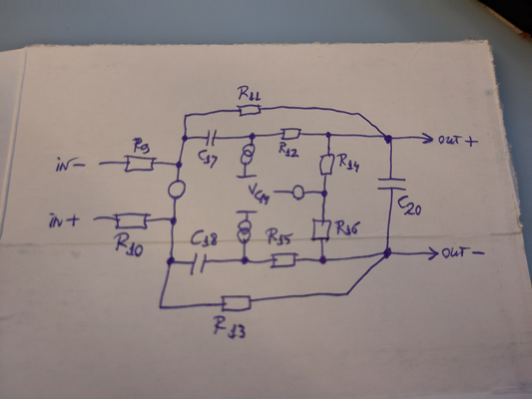

I was not familiar with the Birt circuit. It looks quite asymmetrical, although it becomes symmetrical when you replace the op-amps with nullators and norators. A nullator is a network element with 0 voltage across it and 0 current through it, essentially a model for an ideal op-amp input stage. It is drawn as single circles in my sketch. A norator is a network element that can have any voltage across it and any current through it, essentially a model for an ideal op-amp output stage. It is drawn as double circles.
I see one advantage and one disadvantage compared to the circuit in my filter. The advantage is that there is only op-amp input stage contributing to the differential noise and the disadvantage the asymmetry you get when the op-amps are not ideal.
I have no idea whether this will solve the 10 kHz distortion issue (to the extent that there is an issue at all, the distortion bohrok2610 measured at 10 kHz is larger than at 1 kHz, but not excessively large).
